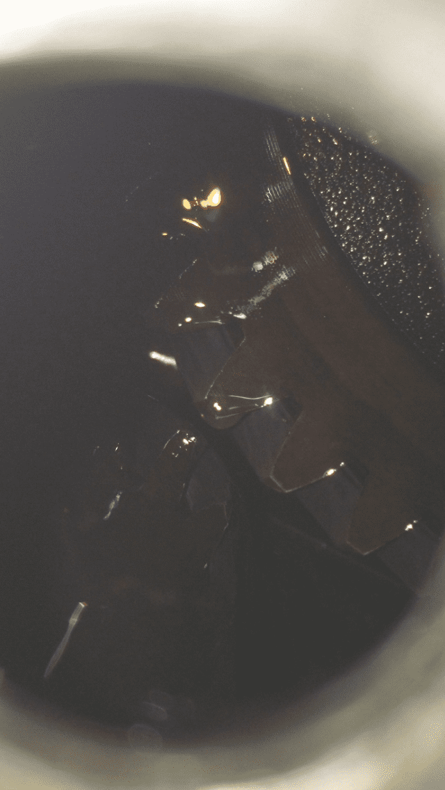

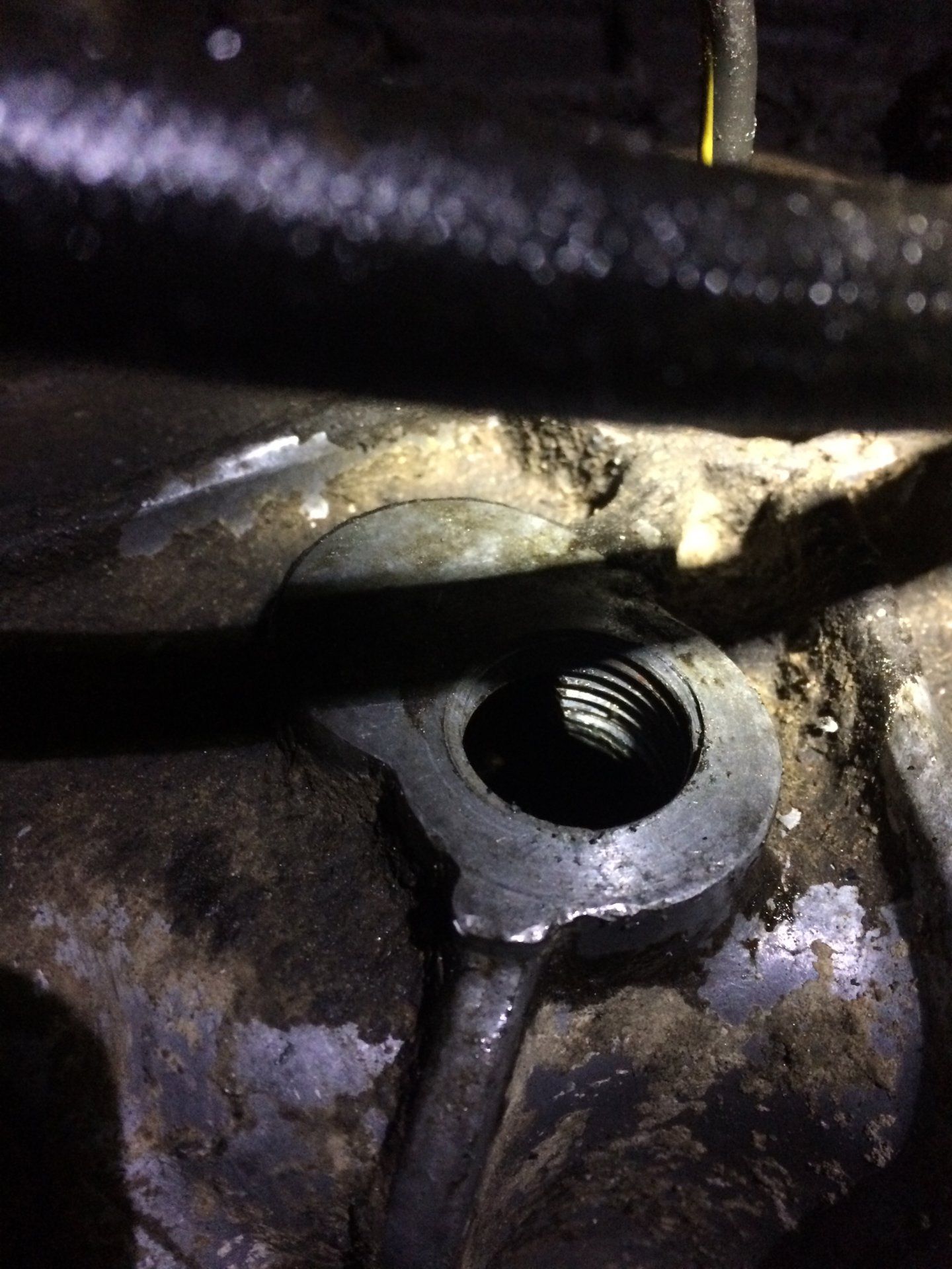

Scrunched myself under the truck and pulled that ugly plug out of the tcase filler hole. I don’t have any idea what it was other than a bolt backward stuffed into a rubbery plug held by a washer and a nut. Talk about shady. Looking into the hole, should there be that big gap? Seen in first pic.

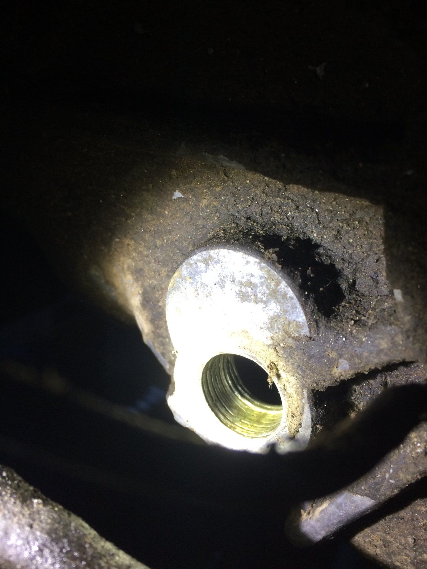

And the threads I could see were basically flat. I tapped it w/ a 1/2npt, held by a 5/8th socket held by my 3/8 ratchet. I can pretty much sit under the truck in that space do it wasn’t the worst position to do it in.

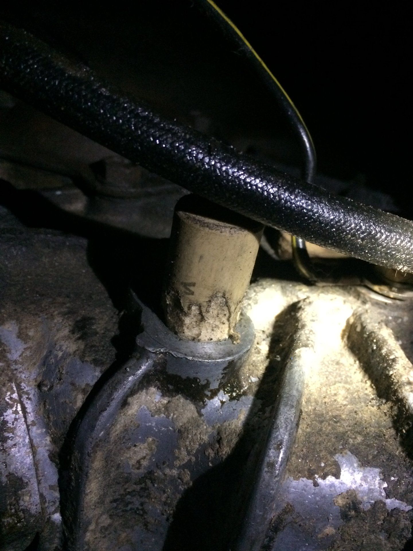

Threads much better now but realised the plug I grabbed is straight and won’t go in. So she’s been stuffed w/ a wine cork temporarily.
Fluid was no where near where I could touch so I added some as well. Got a few cool pics before my battery died.
Ok so looks like the threads were def stripped so you made the right move. Looks like a nice job tapping threads as well.
Not sure what you mean by a straight plug. Did you buy a 1/2" NPT plug? T stands for taper.
In any event nice work. Get the plug to match your threads and you're good to go.

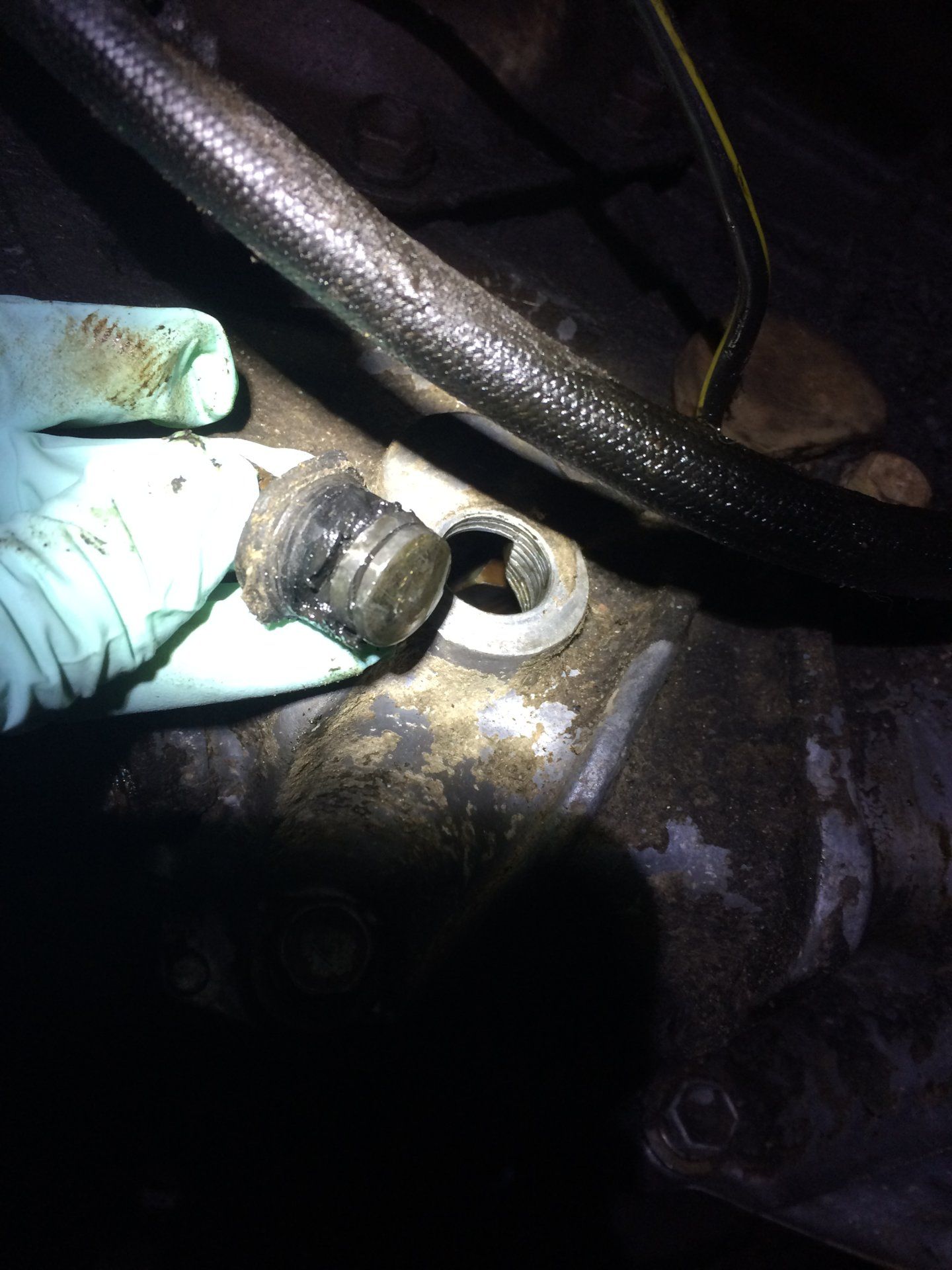

Yeah I think I simply grabbed the wrong one. I went by eye, saw 1/2 and didn’t read further. The guy in the store was a tad flabbergasted that I needed a tap as big as the plug I was holding so I didn’t go back and verify what I had in hand.
They’ll swap it.

Ok good. Yeah if you tapped for 1/2 NPT then you want a 1/2 National Pipe thread Taper plug.
As soon as I pulled the plug it came pouring out in a steady stream. I added the plug immediately. Cat like reflexes... have I said that?

BTW-I bet yours is not the first transfer case with a wine cork for a fill plug!
