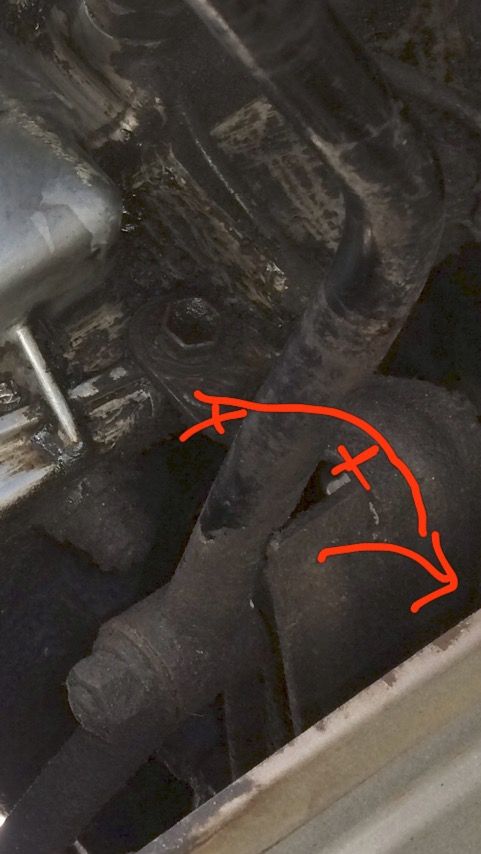

In the thread some say to take the entire bracket/gate thing off? Seems like that might make the most sense. His pixs don’t help me much w/ how much he trimmed off. Do you have a photo or would taking it off make more sense?
Trim and bend backward like this if I keep it @mwebfj60?
I personally don't see the point in the 2lo mod. 4lo with the hubs unlocked is essentially 2lo. Driving short distances with the front axle engaged and the hubs unlocked is not going to hurt anything. A friend of mine has his FJ73 modded for 2lo and he was having trouble getting up a steep hill in the rocks at Uwharrie. Front wheels would not engage. It turns out that he had his in "modified" 2lo by mistake. It's an easy mistake to make too because the shift knob is not marked and if you look down, you see the lever leaning to the right like it should be. He wishes he had never done the mod. Sometimes, "because I can" is not the best reason to do something.

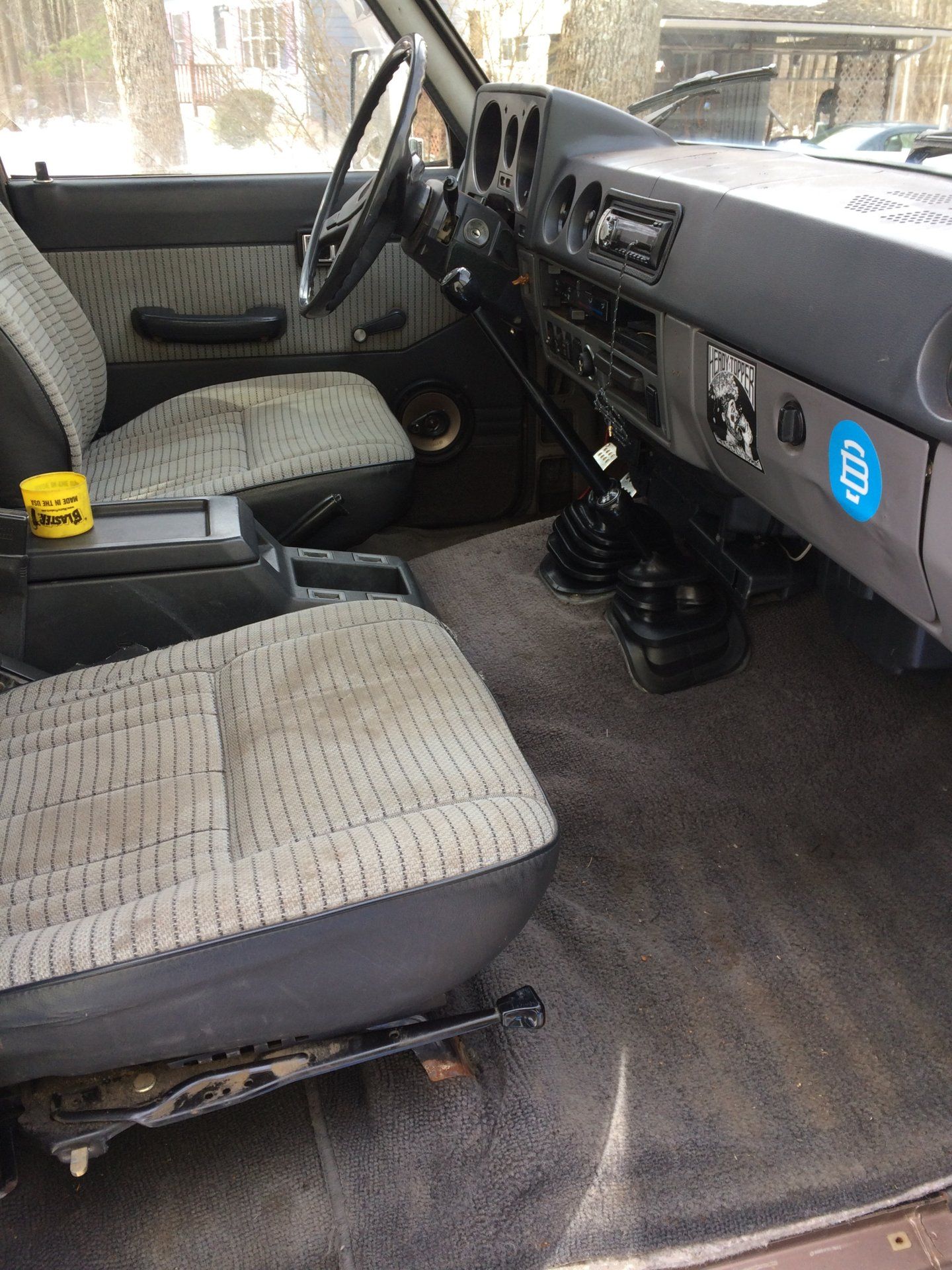

Seats are back in. Swapped right for left since the driver had a hole in the outer corner and the foam was all worn so it leaned. Flip flopped the runners or gliders as well. Might pull the worn seat (now that I know how to do it) at some point later and I’ll pull the fabric, add some foam and patch the fabric. Clean console is in as well.

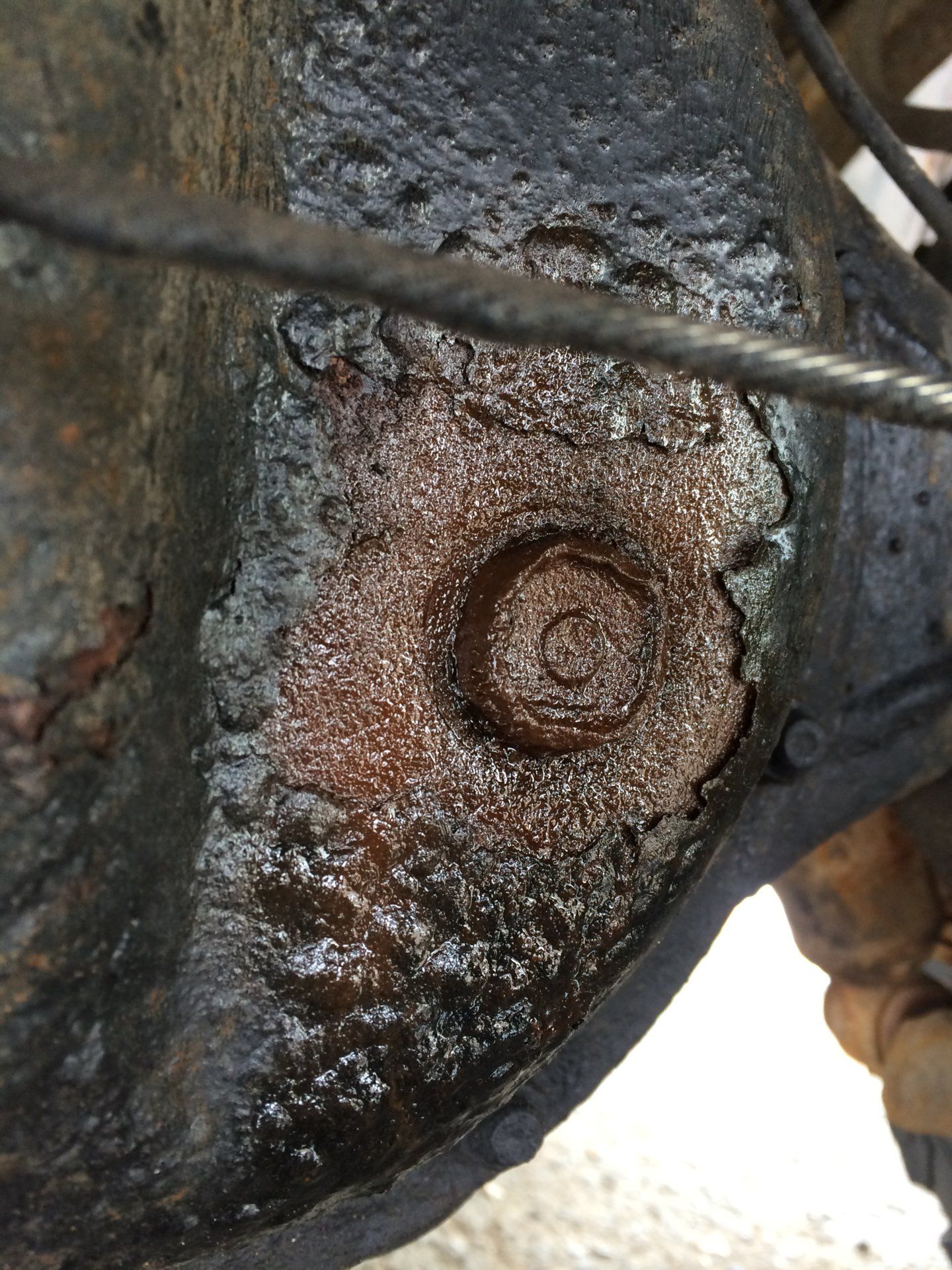

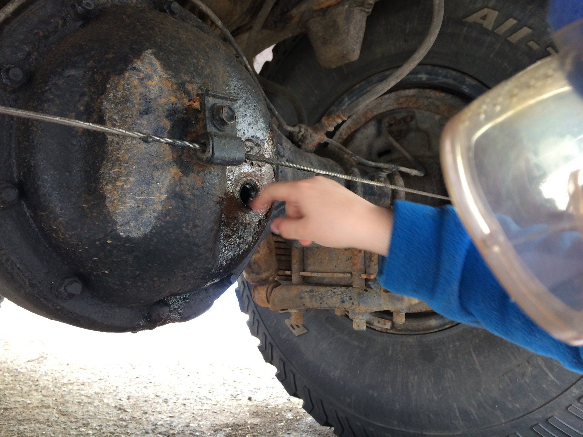

Yeah my rear is rounded but I’ll see if a pair of vice grips can get a grab. I’ve got replacement plugs. Course it’s only freaking 24 degrees right now!
My sweet little boy had to remind me as I whacked the vice grips on the rear diff fill plug w/ a sand mallet... “lefty loosen Mama, you going the wrong way!” And man did he have a fit seeing me check the level and I tried to tell him he couldn’t. Talk about unfair! So there he is checking the level w/ his own little kid finger.

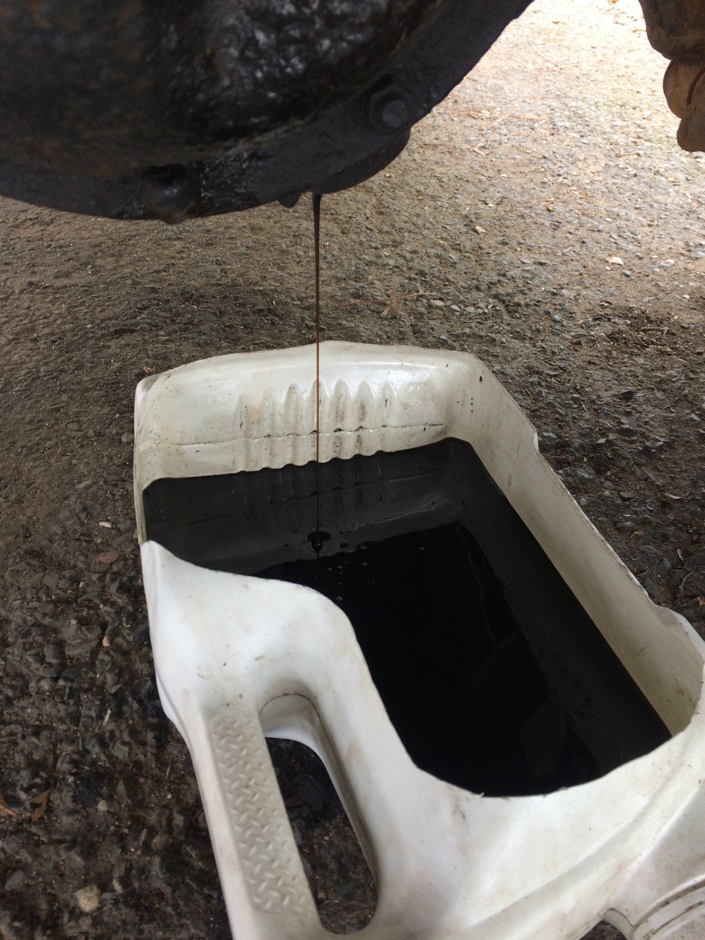

Plug came off easily. Cover is a wicked mess under there. Got the drain plug out too. Fluid was quite low and nasty dark in color.
Glad to hear you a going to wheel the beast. Remember to take pics, or it didn't happen:).
Rear diff drained and filled. I bought a cheap funnel at advance auto yesterday. Knew it wasn’t gonna be a smooth fill but I made it work w/ a price of wire hooked over the rear cross member.

Seats in swapped w/ carpet cleaned. Plastic sill (I’m just guessing in terminology) covers for each door left to install.
