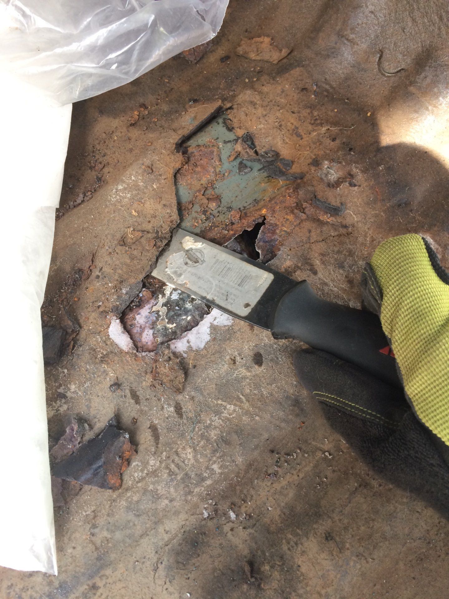

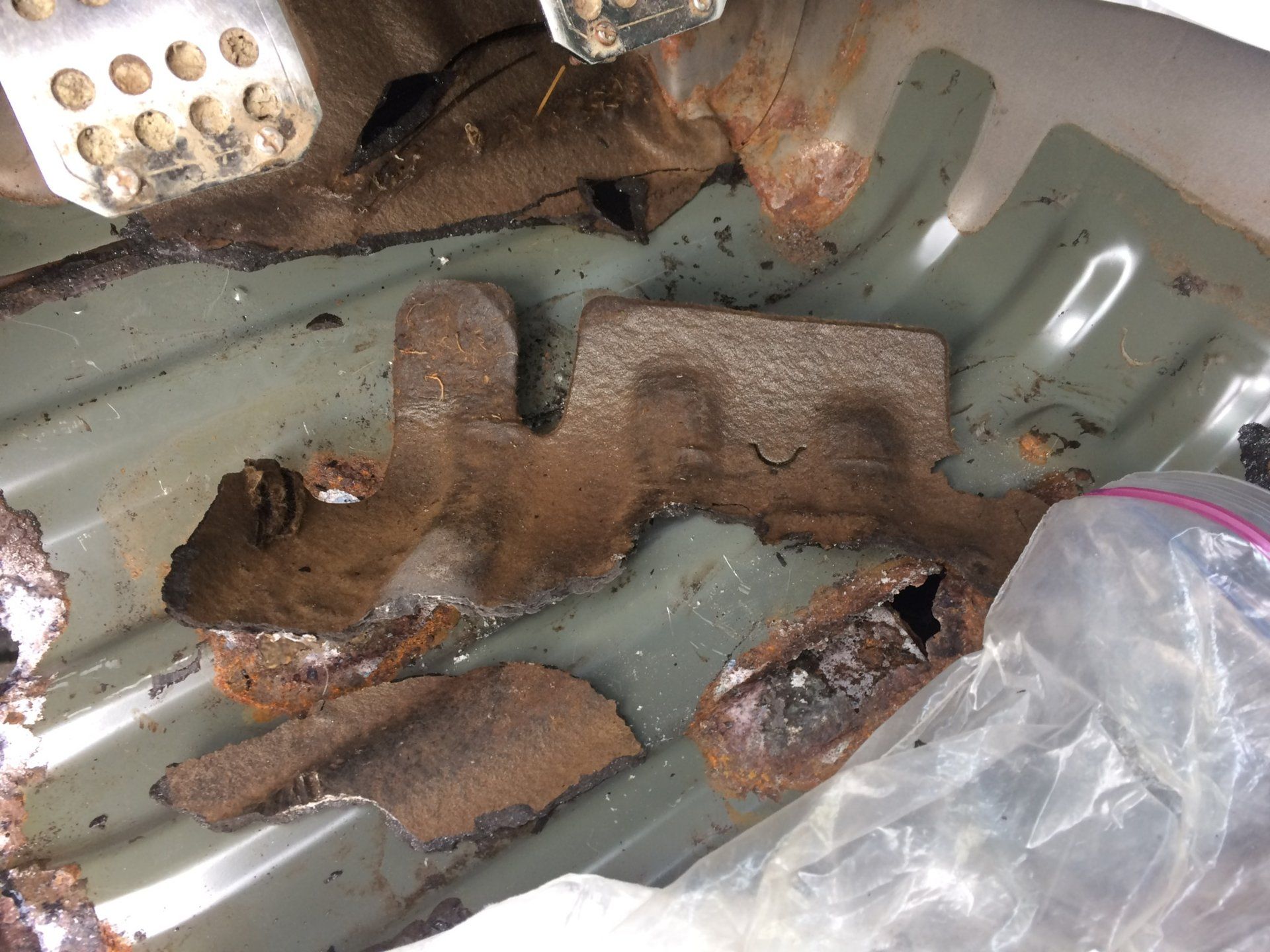

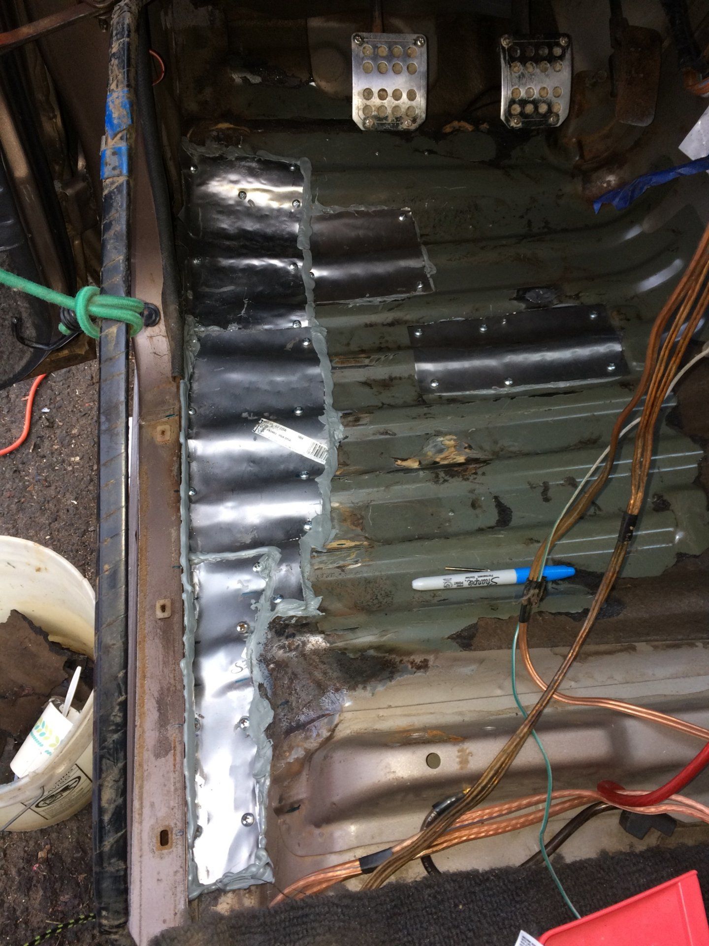

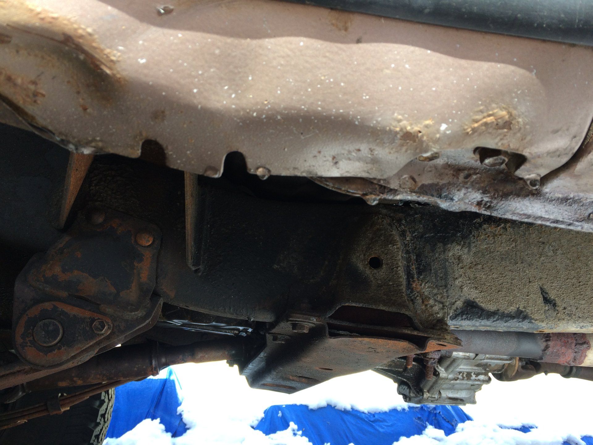

Hack job rust patches. Dry ice to the driver side bed liner. Came right up w/ a paint scraper. Cut out the edges of two holes and flap wheeled down some mini spots. Got up close and personal w/ my new tool. A Milwaukee angle grinder. Even took the handle off like someone said I might. My impatience got the best of me and I didn’t take as much time as I should have. Lesson learned. Underneath she ain’t pretty. Used self drilling screws through 24g steel.
A welder will be sooner in my future as this is crap work and I know I’ll need to be back in there sooner than later. Used Napa seam sealer along the edges of each patch.
Photos are all mixed up but you all can get the drift.
Noticed a guy on Facebook who used a template and contoured metal to make a floor for his 40. I followed his work and eyeballed my own.
I’ve since gone under and trimmed all the ends of the screws I could reach w/ my dremel.

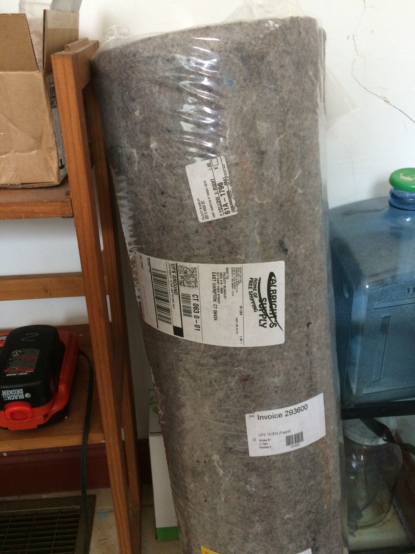

Spent a day or so listening to a bunch of you tell me about replacing the sound and heat barriers.
Sound dampener/heat insulators
Have decided to go w/ a non stick option so I can peek under after time and check out my shoddy patches.
Bought foil bubble wrap from HD, will add Frost kind foam/foil stick duct heat insulator on to the wrap and top it w/ a 40oz layer or two of jute I bought from a place out west for $5.50/yd.

I love how polite the you all are... a pin could be heard over the silence surrounding how ugly my patches are. :)
Haha... that’s awesome Felicity. I like the triage/trauma nurse approach to keeping your cruiser alive. Just patch it up and get it going. It might be ugly, but it’s functional. Two thumbs up from me!
Believe me my welds dont look much prettier when they aren't ground down. Like @CaptClose said, ugly but effective, that is what my tennis coach in HS used to say about my form and still took state championships 3yrs in a row.
You were fearless, as usual, to post up those pics.
Yours look like works of art compared to the roof flashing pieces I screwed and siliconed into my 40 some years ago.
You do what you can and move forward. Nothing you do on these vehicles last forever, good or bad.
