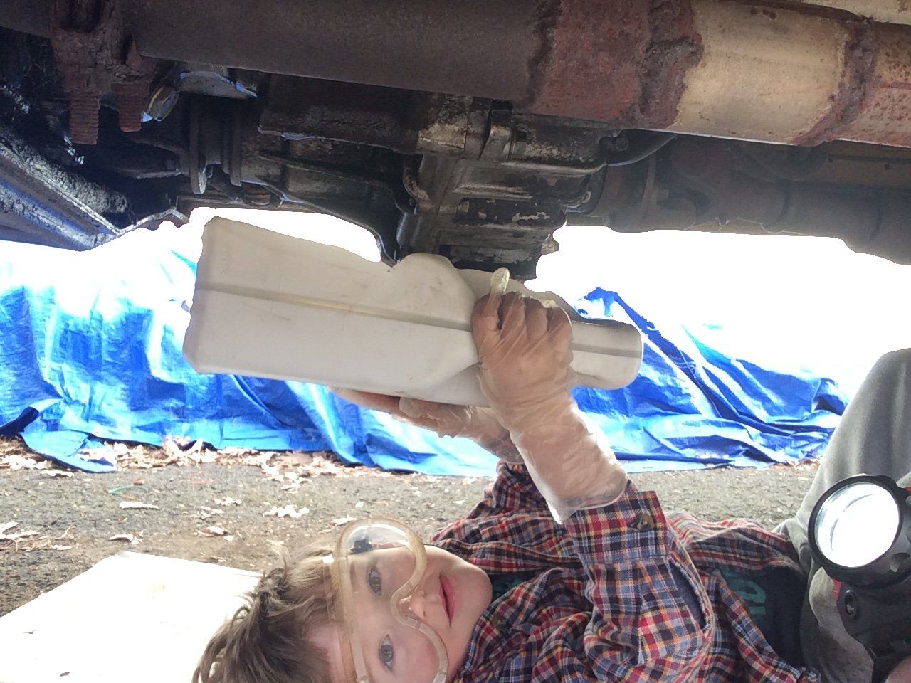

My assistant was ready to catch! Can’t do much now till he’s napping. And rain is coming later today thru tmrw so not sure how far I’ll get.

Good job with the ppe for the kid!

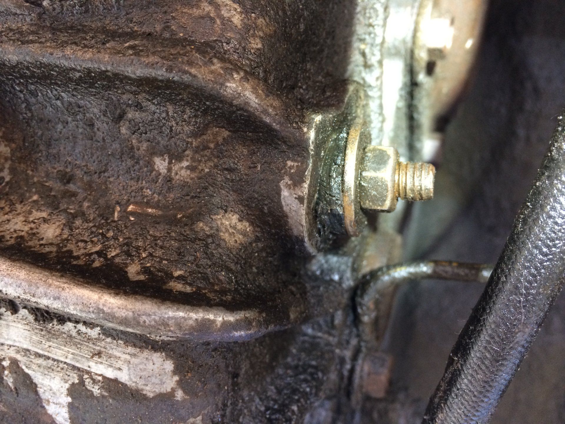

Ok so real quick before I read all ya comments. I’ve cleaned the top of the case pretty good. Tad angst when one bolts washers spin freely... (pix below I’m pointing to it).

Drained out basically a 1/2 gallon of fluid from the trans. Plug that is in there is a magnetic one and def had a layer of shavings on it. Did my best to clean it and waited till the stream pretty much stopped and plugged her back up.
And I now stink. I chuckle at what my kid relates me to when it comes to scents. Used to be patchouli and now it’s truck fluids!
