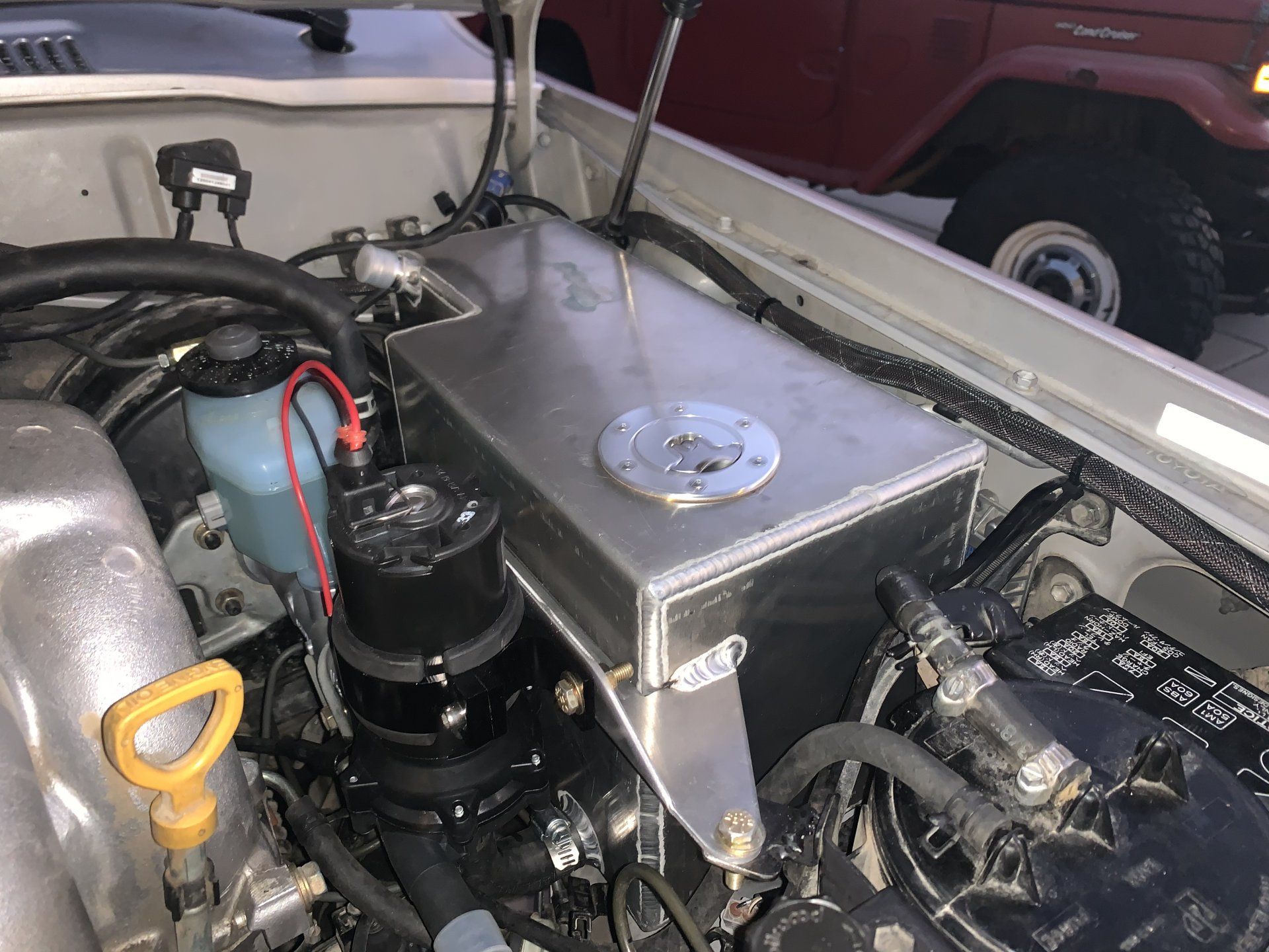

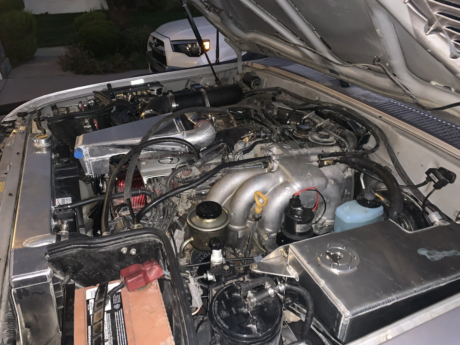

A lot of progress has been made on my Air to Water intercooler system.
The expansion tank / Meth tank holds about 3.5 gallons of fluid and uses up all the available space where the ABS pump was back to the firewall. There is still enough room to get my arm in to change the oil filter though. I had an -4AN bung welded in and capped off for future Meth Injection use. The Inlet/outlets are all -10AN.

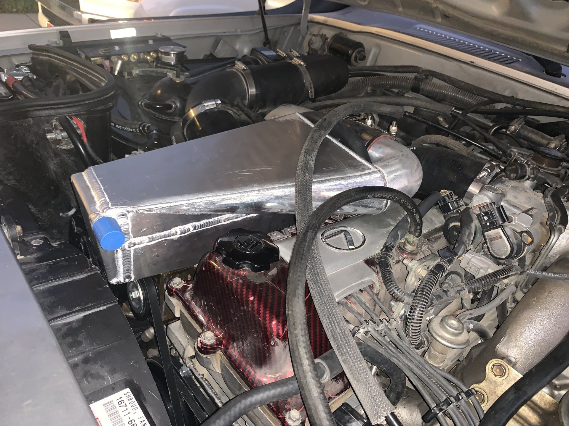

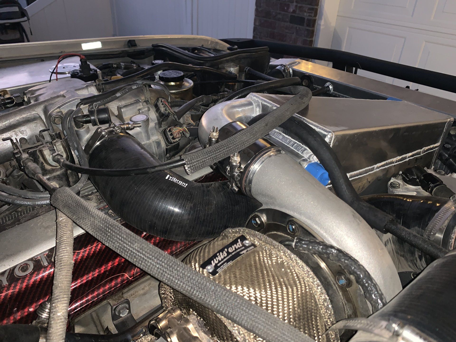

The original plan was to place the intercooler on top of the valve cover with simple short end tanks made in line with turbo outlet and intake manifold, but hood clearance became an issue. I am sure this could still work if you are using a smaller IC core. The Garrtet core I am using is good for 750hp, so it’s not small.

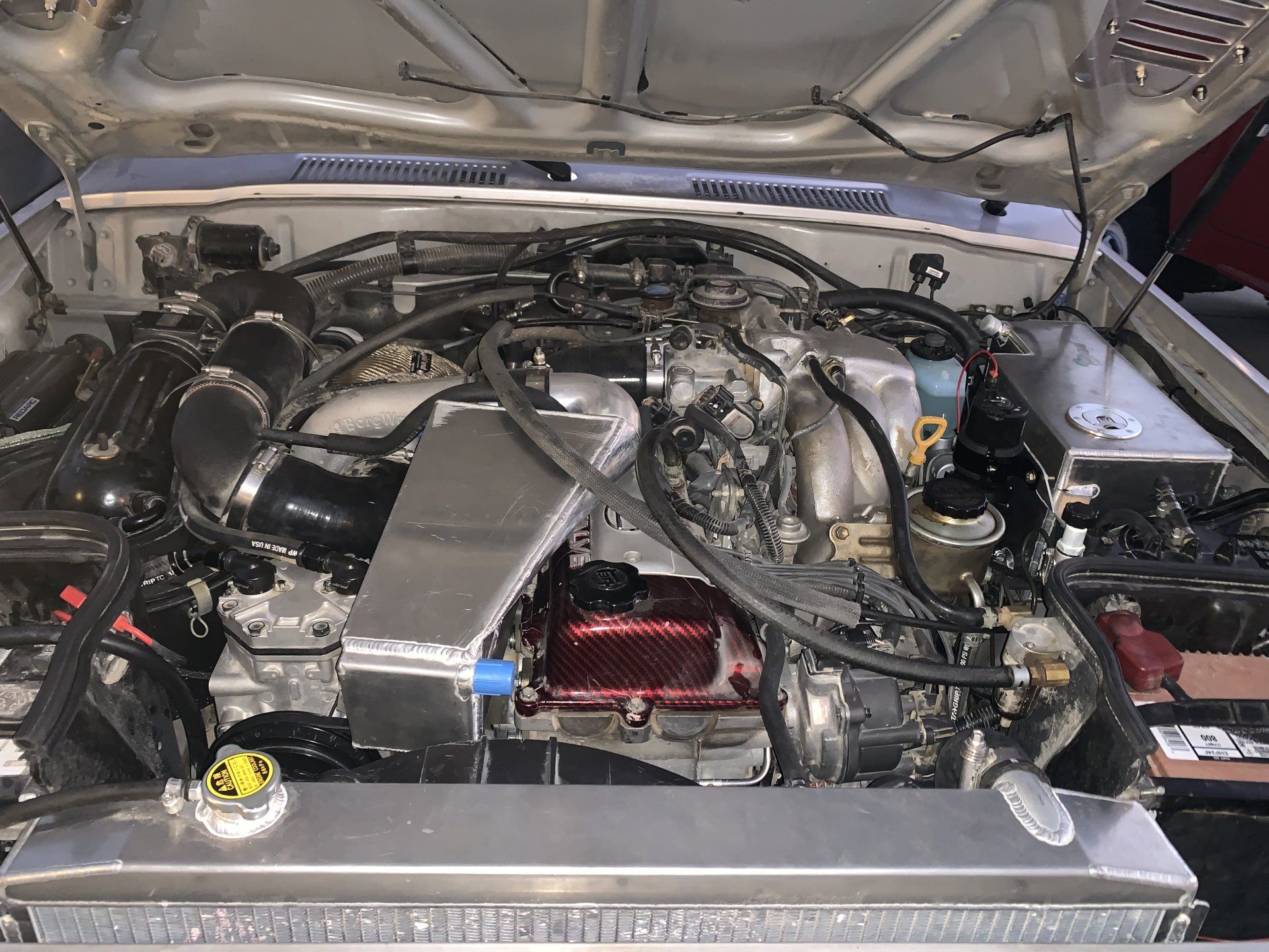

The new plan was to put it in front of the turbo between the York and valve cover with some more complex end tanks. To accomplish this, the York bracket needed to be cut and dropped 1.5” and a new Heater bypass tube had to be made to take advantage of that created space.
I am definitely taking advantage of every last ounce of space under this hood, but I am really happy with how this is coming together. I still need to run the fluid lines and wire up the pump and heat exchanger fan that is mounted in front of the condenser on the passenger side.
