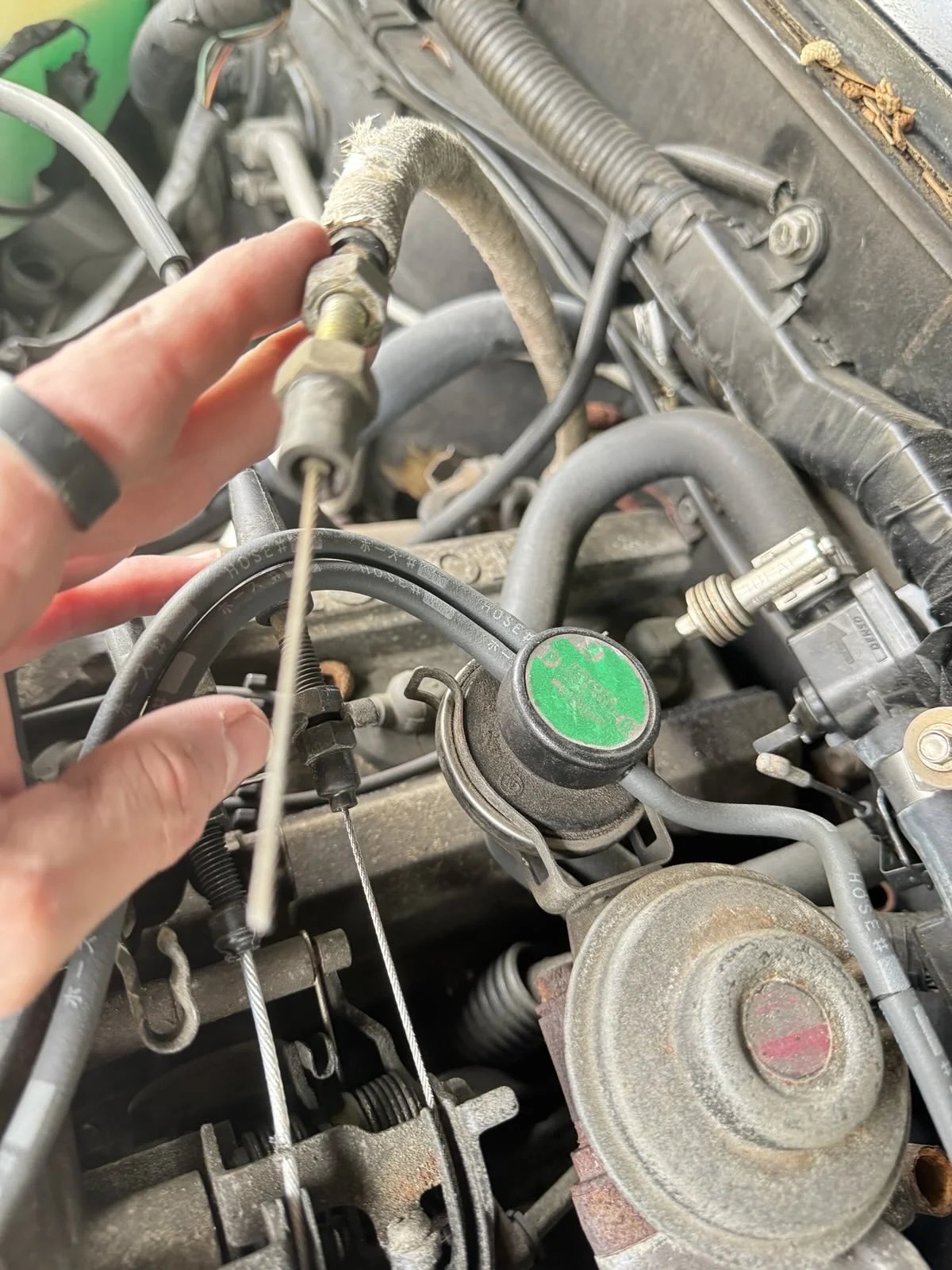

Does anyone have a picture of what the end of this cable should look like?
I've seen a number of A440F pictures but not the A343F.
And does anyone know if I were to find a new end connector, would splicing work?
I believe the part I need is NLA and the A440F cable is too short.

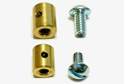

@florida95fzj : There's a few options if you want to fix the barrel fitting/stop:
Dimensions of the cable stop/fitting:
(from above) 10mm x 4.5mm = 3/8" x 3/16" = 0.39" x 0.177"
Throttle (Transmission) Cable diameter ~ 0.06"to 0.07" = ~1.5 to 1.7mm (diameter of hole needed in repair stop/fitting)
Some different sizes/types of repair fittings/stops:
IMHO if you use one of the quick repair stops with a screw to pinch the wire consider adding a drop of solder to secure it all together
Some methods to make your own barrel stop/lug:

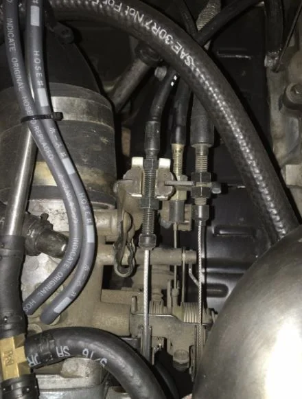

So, what is the best way to install the barrel into the throttle body?
It looks like the cable is routed underneath unlike the cruise and accelerator cable.
I haven’t found a great position to get the best access. I think it goes in at a notch at the firewall side but doesn’t really fit that way.

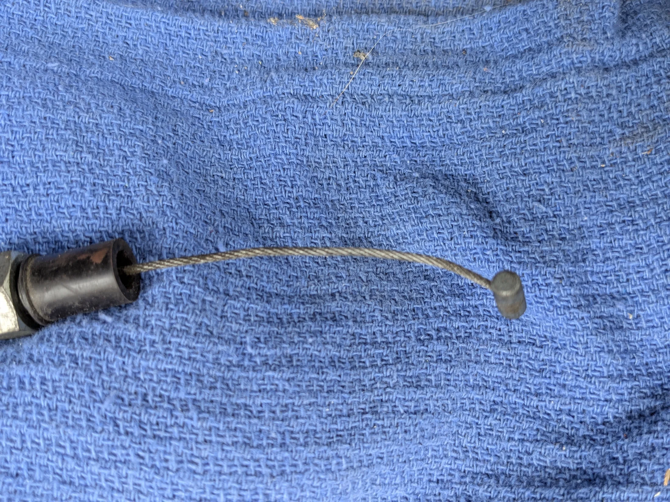

This pic has the broken barrel still installed that I have since removed to compare to the new cable end from a T100. Identical size.
Edit: the barrel is installed vertically here but I am wondering if it should be installed horizontally through the circular cutout that faces the firewall. Either way, I could not get the new barrel to fit after trying a few hours. Access to the area is a challenge.

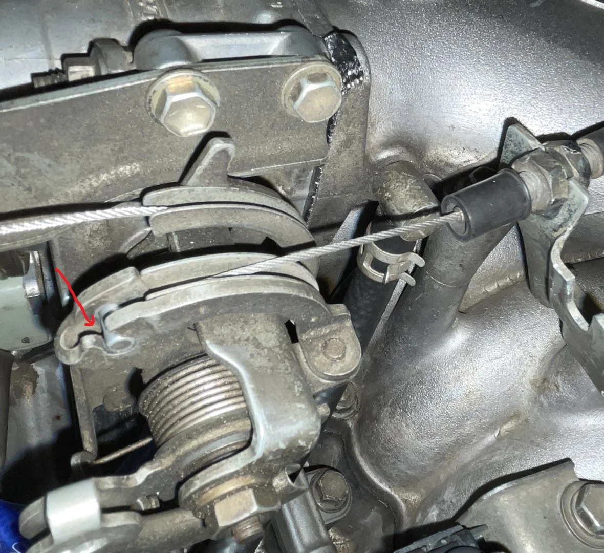

IIRC you have to move the cable end past the hole where the stop fits into (there's a slot for the cable to slide into from the side) or rotate the throttle linkage until you can push the stop into the slot then ensure the cable lays into the curved groove thingy. It's hard to describe, study it awhile. Might be easier if you unbolted the TB from the intake but IIRC that's not necessary.
_________________________________________________________________________________________________________________________________________________
Photo below is not from a FZJ80, just added it to show how a cable stop or barrel end fits into the slot on a Toyota Throttle body
Approaching from the side you first have to rotate the barrel end/stop and cable in line with the slot (see red arrow), then push barrel end in where the slot is, then direct the cable into the groove.
