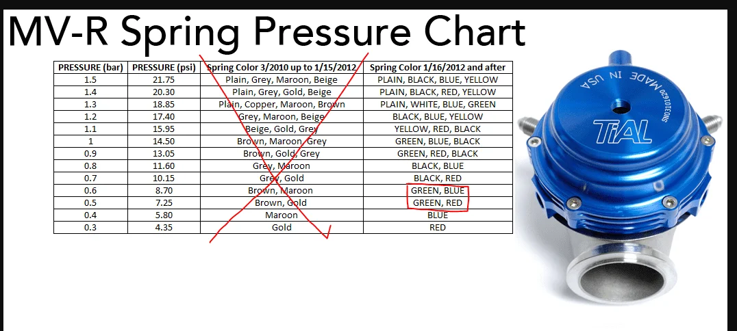

I'm running 2 boost gauges. OEM TRD (aka autometer manual gauge) and a PLX digital mutli gauge. I doubt it's the gauges leaking as there's been a few members also with my same boost readings. Like I've said in other messages and same with Scott. Boost readings will vary with age of cats. I'm using factory 180k cats and that could be my restriction for slight loss of boost. I'm not at the point I want to get rid of my factory cats and get Magnaflows yet.
I have zero leaks and using the correct spring pack. I've done an extensive writeup and build thread on my truck. Everything except for the Cats are brand new and/or rebuilt.
I am using 172k stock cats with Flowmaster 70 series. When I had the exhaust redone during the build, I pulled the cats and looked them over. No flow restrictions in them so I had the reinstalled by the exhaust shop, but had them moved up tighter into the space next to the frame rail.
I'm not getting 5psi and the only thing that's restrictive in my exh system could be the Bosal muffler, which is less than ten years old. Other than that, the single high flow magnaflow cat is the same age, mandrel bend 2.5" piping up and over frame rail and all that.
I checked my springs and they're in fact the correct color combo green+red.
Boost leak could be possible but not in the elbow feeding the TBI and I'm not sure where else to check.

It seems that several owners of this kit are not seeing the 7 PSI boost that myself and others are. I like to keep things simple when troubleshooting, leaving the really complex failure modes until the simple stuff is ruled out.
The simplest explanation is that the boost gauge is reading incorrectly. I bought a cheep manual gauge two weeks ago to verify the boost on my rig, and it correlates to what the 14 in one gauge is telling me. 7+ PSI max (saw 7.6 PSI under full acceleration over the weekend, for just a second)
The next simple explanation is a boost leak. The compressor housing to the center housing is a possible leak path. There are only four connections after the turbo before the TB. Then you have the TB gasket to the upper intake, then the upper intake to the lower intake, then the lower intake to the head. There are numerous ports in those assemblies to look at, including the EGR, brake booster (should have a check valve from kit), and the PCV valve . The PCV should act like a check valve under boost. It could possibly be leaking at higher boost levels and dumping the boost into the valve cover? Then it flows back to the intake side of the turbo?
(Side question, with a large boost leak, isn't the turbo being turned at higher RPM's due to the wastegate not opening, as it is not seeing a pressure signal to open? Is over speeding the turbo a risk with a boost leak?)
Another simple explanation is that the wastegate is opening too soon. You verified you have the correct springs. The next step would be to pressurize the wastegate manually and verify that it is opening at the correct pressure. Probably not likely that the correct springs are out of spec, but, maybe?
On the exhaust side of the turbo, as you looked into, a restriction could be putting to much backpressure on the turbo, causing lower flow, lower turbo RPM's and less boost. You could also have a large exhaust leak, but, I think you would notice that.

Thanks Mike, good writeup.
I was thinking of getting a Blue spring from eBay and combine that with the Green spring to see if I get past 5psi before I start looking for leaks and such. This will be a TEMP solution as I don't want to lean out the engine due to lack of fueling. Just a thought for now...
