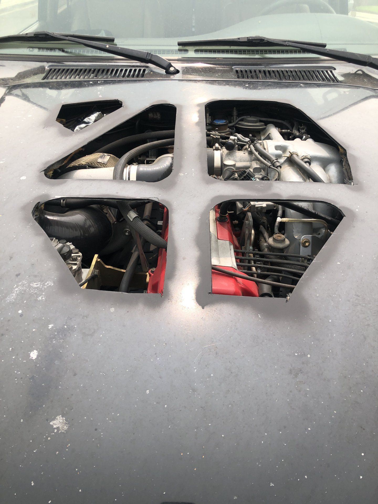

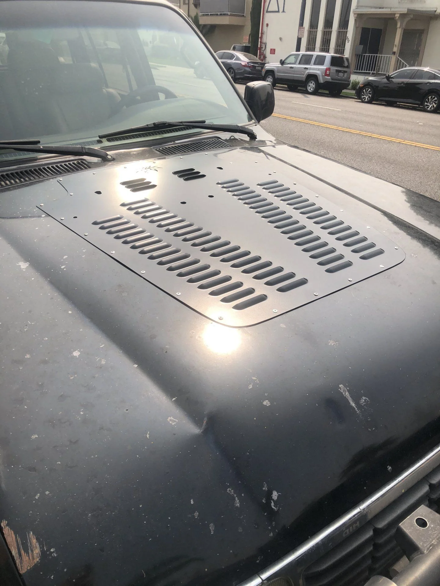

I finally got around to installing my louvered hood panel.
I don’t anticipate it making my engine run any cooler, but more to evacuate heat from under the hood. With the extra piping for the turbo under the hood, this should help lower engine bay temps.
All of my rubber, plastic, wiring, etc should be happier with the cooler temperatures.
install was a breeze. I used the provided paper template to cut the under-hood insulation with scissors.
Once that was removed, I used an angle grinder & jigsaw to cut away the exposed sheet metal sections, but not cutting through the hood bracing.
I drilled the holes and installed the provided screws. A few of the bolt holes lined up & went into the hood bracing. Those few holes I used rivets to secure.
