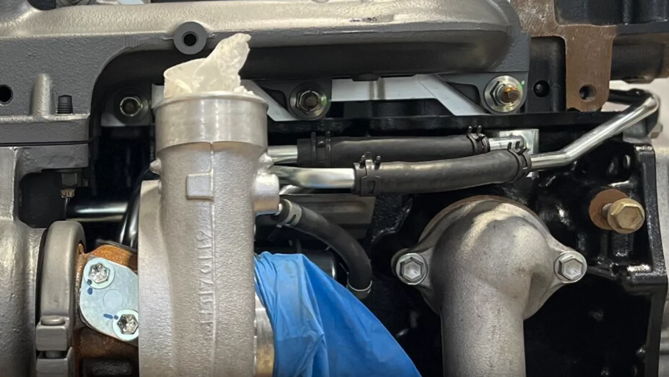

PIC 1
which hose is water inlet/return

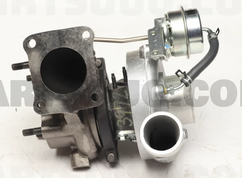

PIC 2
what and what should that little push on connector go to on a hdt engine?
and would making that arm adjustable(turnbuckel style) limit the boost provided?

You can shorten the waste gate rod to increase boost you get before the waste gate opens, but the scope for this is very limited. If you want to mess around with boost level, get an aftermarket adjustable waste gate actuator. Kinugawa or mambatek are two sources for bolt on stuff.
There's a boost pressure signal nipple on the front of the turbo compressor housing, this gets connected to the house nipple on the waste gate actuator.

Find the Diesel Tech section of the ih8mud forums, go searching for pics in there
