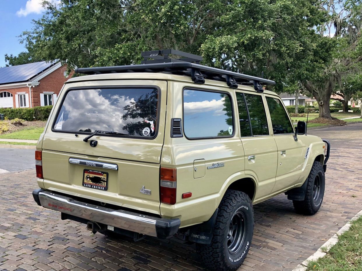

Anyone have experience with Vision HD 70 Mod Series Silver Wheels HM70SM-6683? Ironic that they have "70" and "series" in the name! I don't like the look at all but I'm thinking of getting one to use as a spare. 16x6 with 3.5BS Bore listed on summit is apparently incorrect Vision's website lists 108mm. I'm going to be running 285/75r16s on my MT Classics so can't really use a stocker as a spare and don't want to do 5-wheel rotations or spend the extra money on a wheel and tire which will rarely see use.

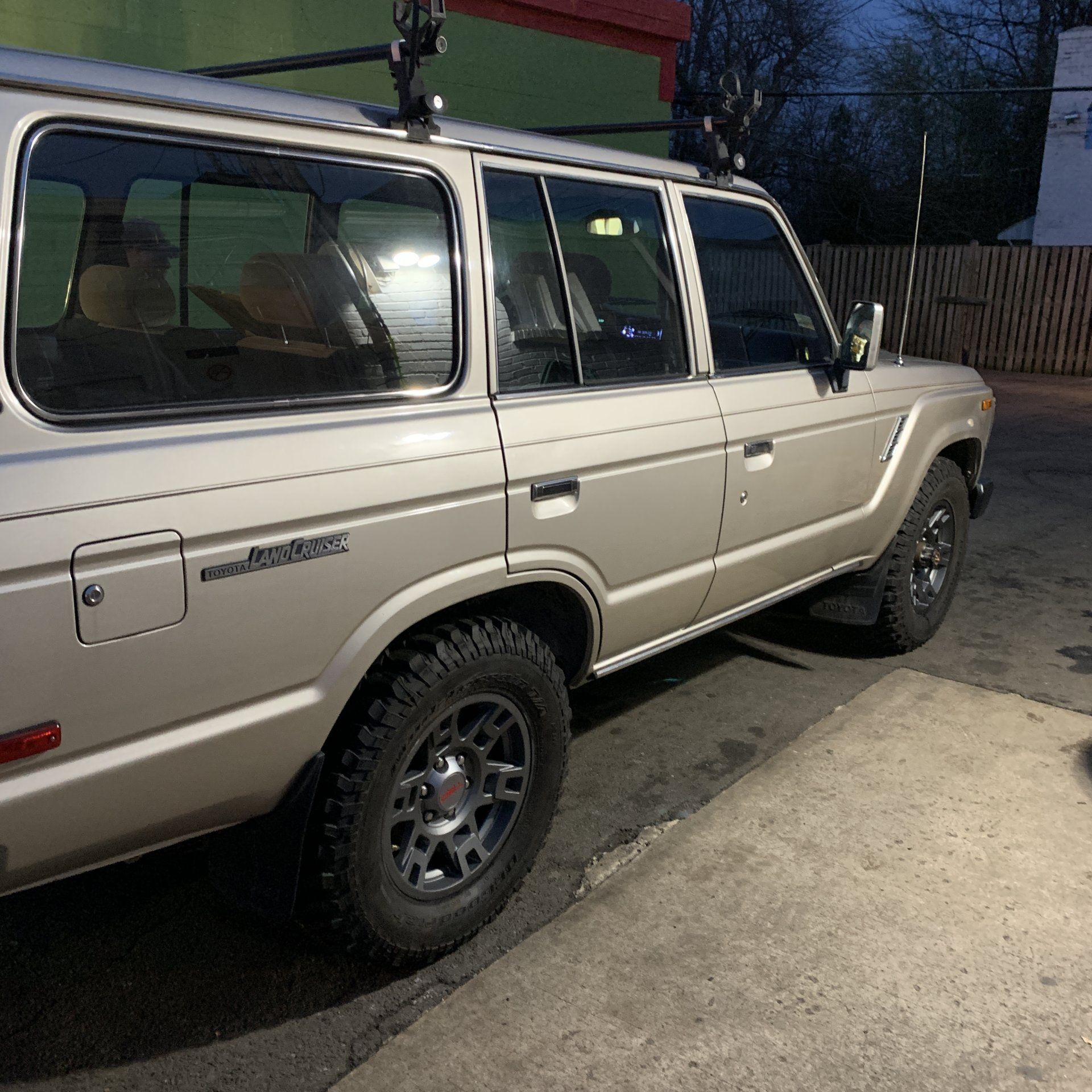

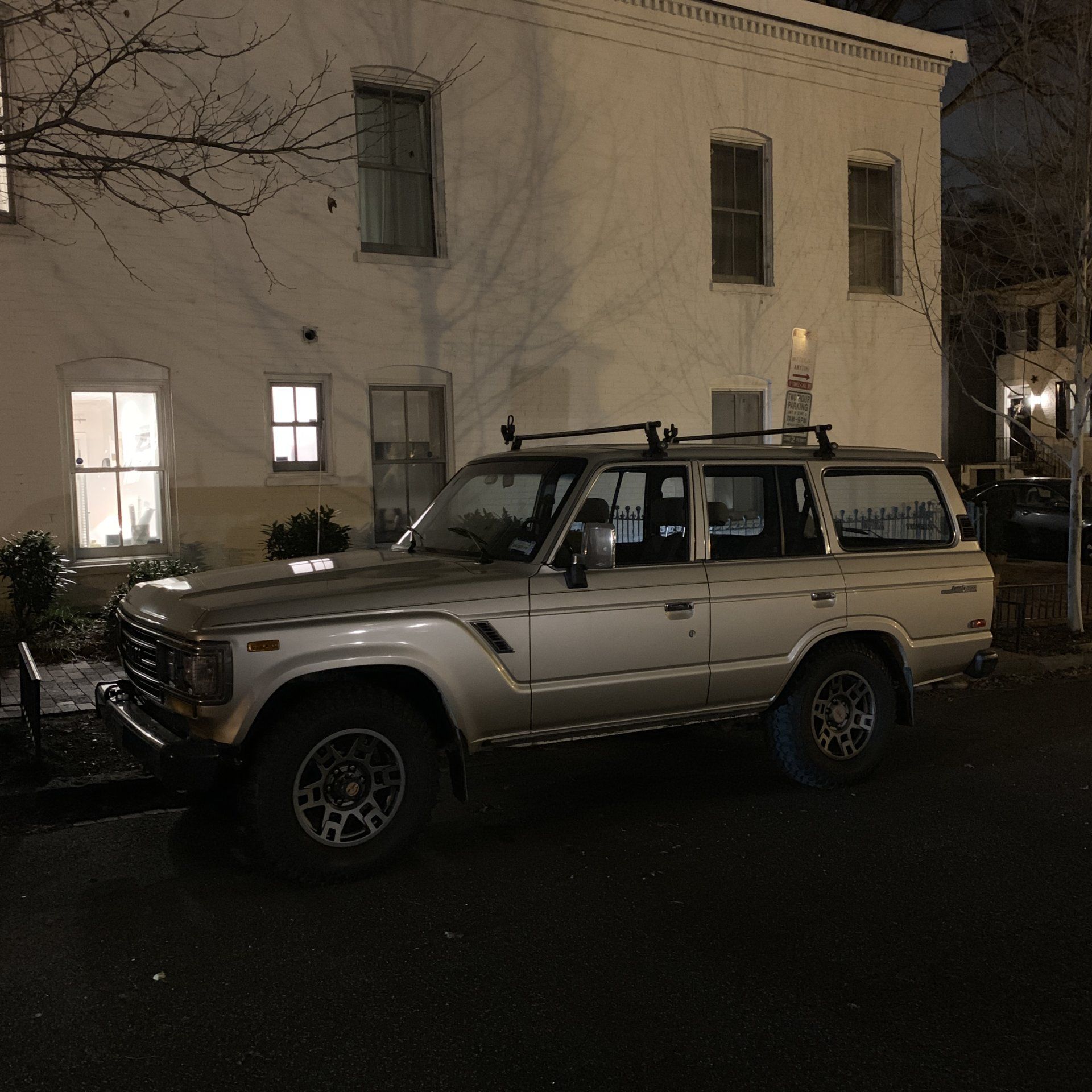

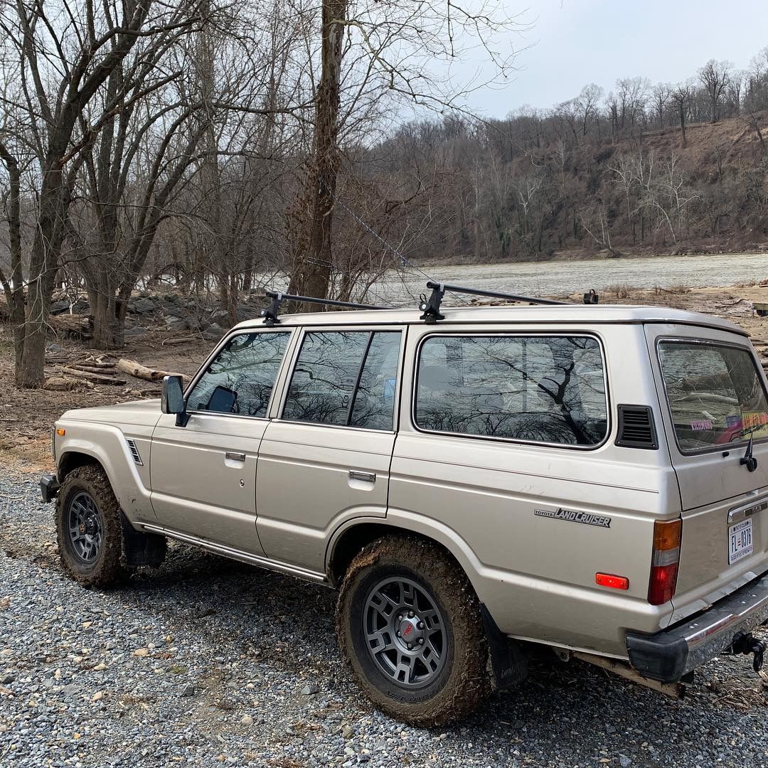

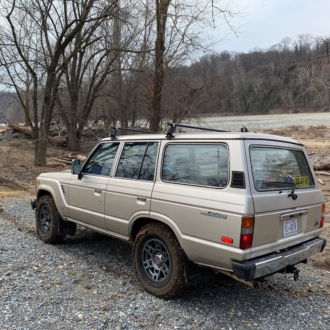

I wanted TRD Pro wheels ever since I saw them on @torfab ‘s 62— it’s the only 60 series I’ve seen with them. I pestered him about fit and learned he runs the Tundra brake upgrade and an 80 axle in rear so he’s got extra clearance. I knew most 4runner wheels don’t fit without spacers on stock 60 axles so thought I was SOL.
I’ve read this thread several times and looked at wheel options for probably 2 years. I wanted something modern, understated, not 16”, suitable for a pizza cutter tire, and that allowed for a wide tire selection for the forseable future.
I didn’t want 16” because I swore off E load tires after they ruined the ride on my Discovery 1 I owned several years ago and there are little to no options for a 16”/non-E.
After market wheels that would tuck in the fender, were alloy, would fit without spacers, weren’t black, and didn’t have fake beadlocks/rivets were non-existent at this point except for the FN Wheels Countersteer Type X. They’re featured earlier in this thread and were my realistic choice. For some reason, I didn’t 100% love them though. Also, they recommend machining the hub bore so more $$.
Then I realized the TRD Pro wheels’ specs weren’t that different from the Countersteer. 17x7” (fine width for my goals) and offset of +5mm/4.2” backspace. Regular 4Runner wheels are more like +20mm/4.5” backspace. So I went on a quest to test fit them and managed to get in touch with a willing local TRD pro owner. The test fit was a success despite 15 degree weather! However, I didn’t want to torque lug nuts on his wheel or put weight on it just in case.
Then I ordered my own single wheel and fit one of the tires I had scored. They are brand new BFG MT takeoffs from a Jeep JK Rubicon. All 5 for $350. Tested it out and even drove it around the neighborhood like a doofus to make sure the tie rod didn’t hit. After seeing so many issues on this thread I was really, probably overly, cautious.

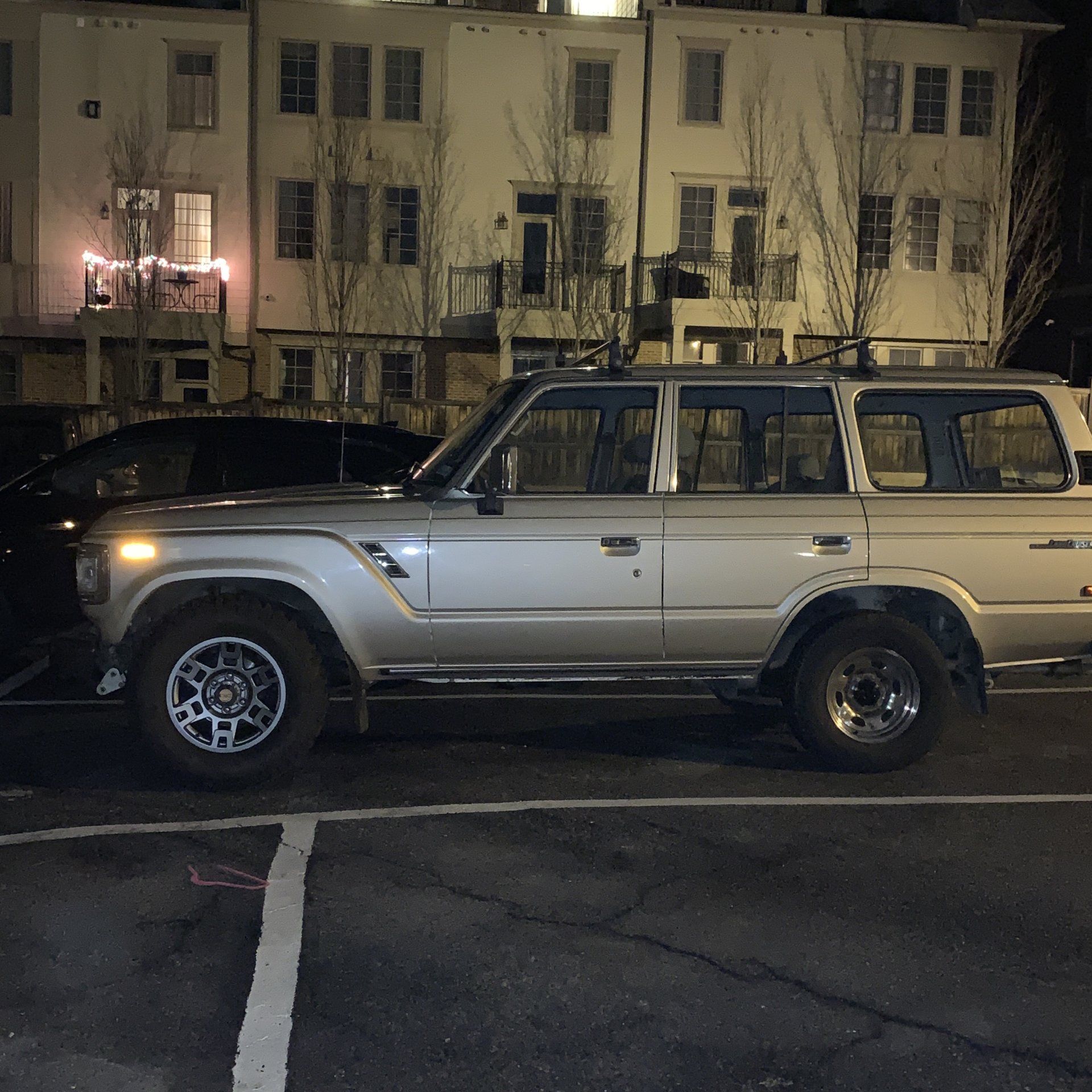

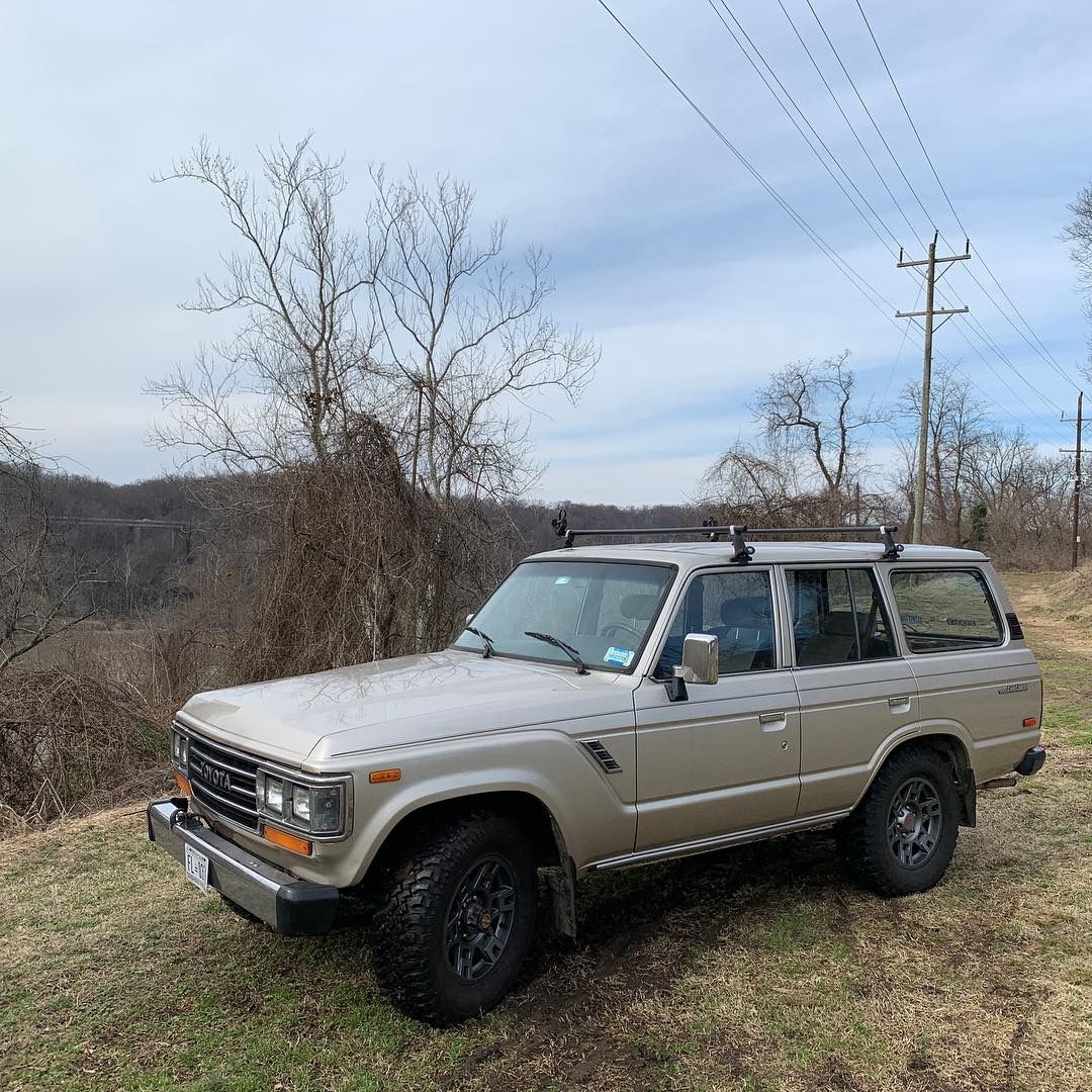

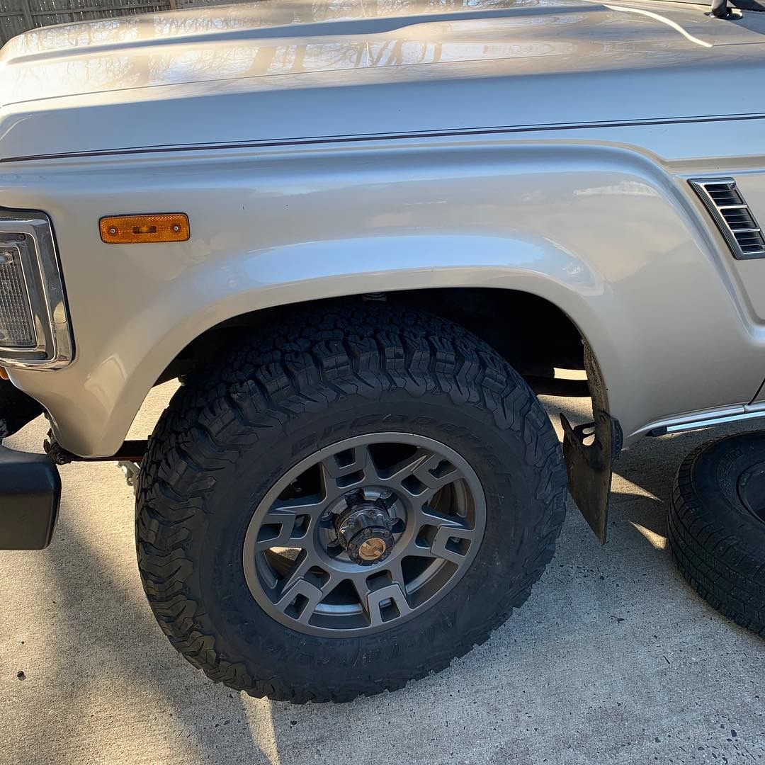

Great news! Got the remaining wheels in Wednesday night and had everything mounted up tonight. Might run the rear cap-less, don’t love the red TRD. They fit perfect and drive great! If Toyota remade the 60 today this is how it should come from the factory.
Wheels: OEM TRD Pro 4Runner wheels, PTR20-35110-GR (also available in black)
Lug nuts: OEM 4runner/Tacoma, 90084-94002
Tire size: 255/75r17, ~32.1x10.0”
Spacers or other wheel modifications: none
Lift: good condition stock springs with Old Man Emu greasable shackles
First test fit (remember to paint your 555 TREs before installing :rolleyes:)

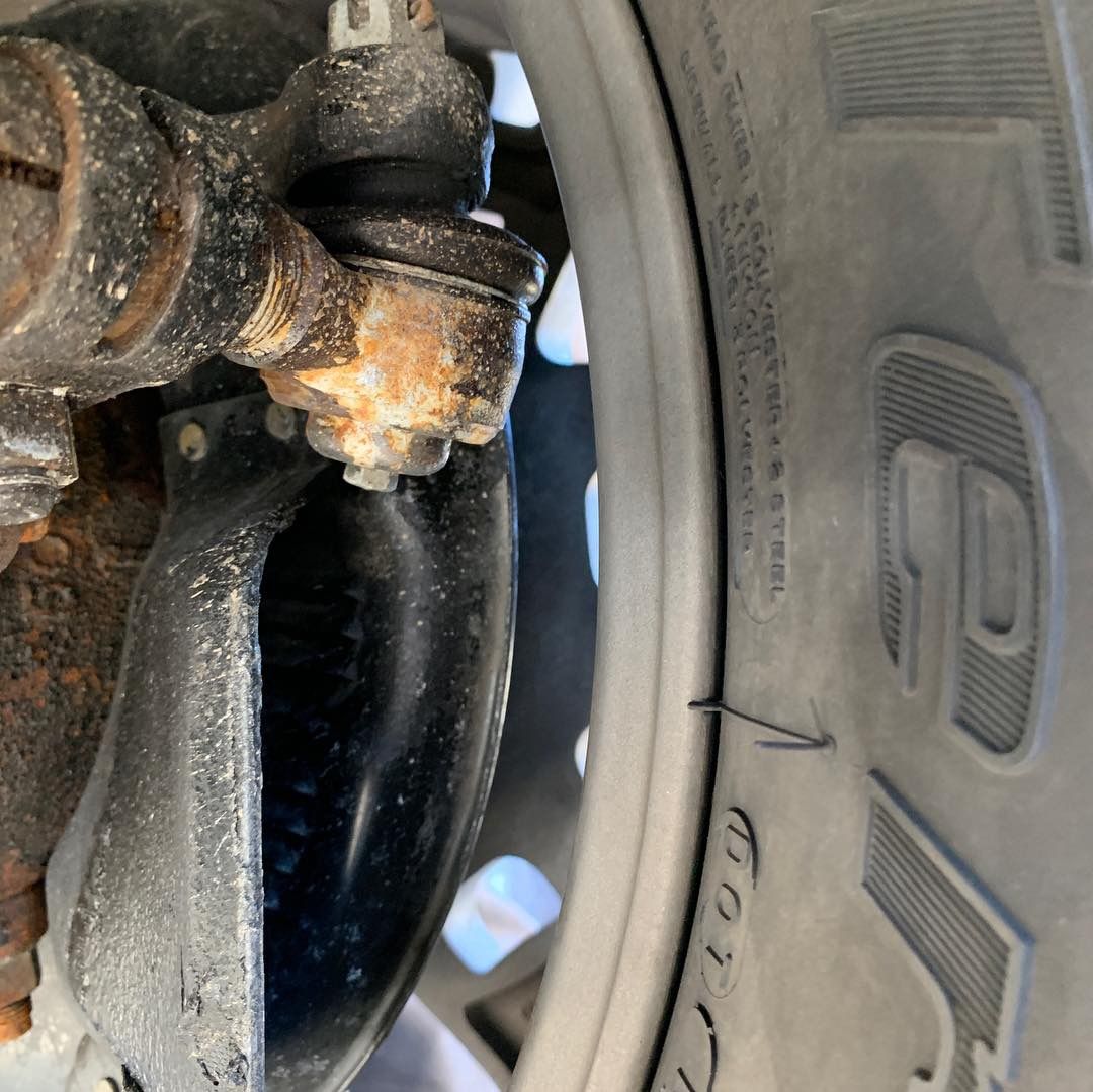

Second test

Final product!

@NearJetties OH MAN, those are gorgeous. Love the grey on grey. I too ruled these out assuming I’d need spacers, I ran SR5 5th Gen 4Runner wheels for a bit with 1/4” spacers before going back to stock wheels...but due to your writeup here I may have to go get a set. Thanks a lot.
Your rear axle is stock?

Great post, looks super!
Red TRD looks fine, or get ahold of a paint pen.
100% stock

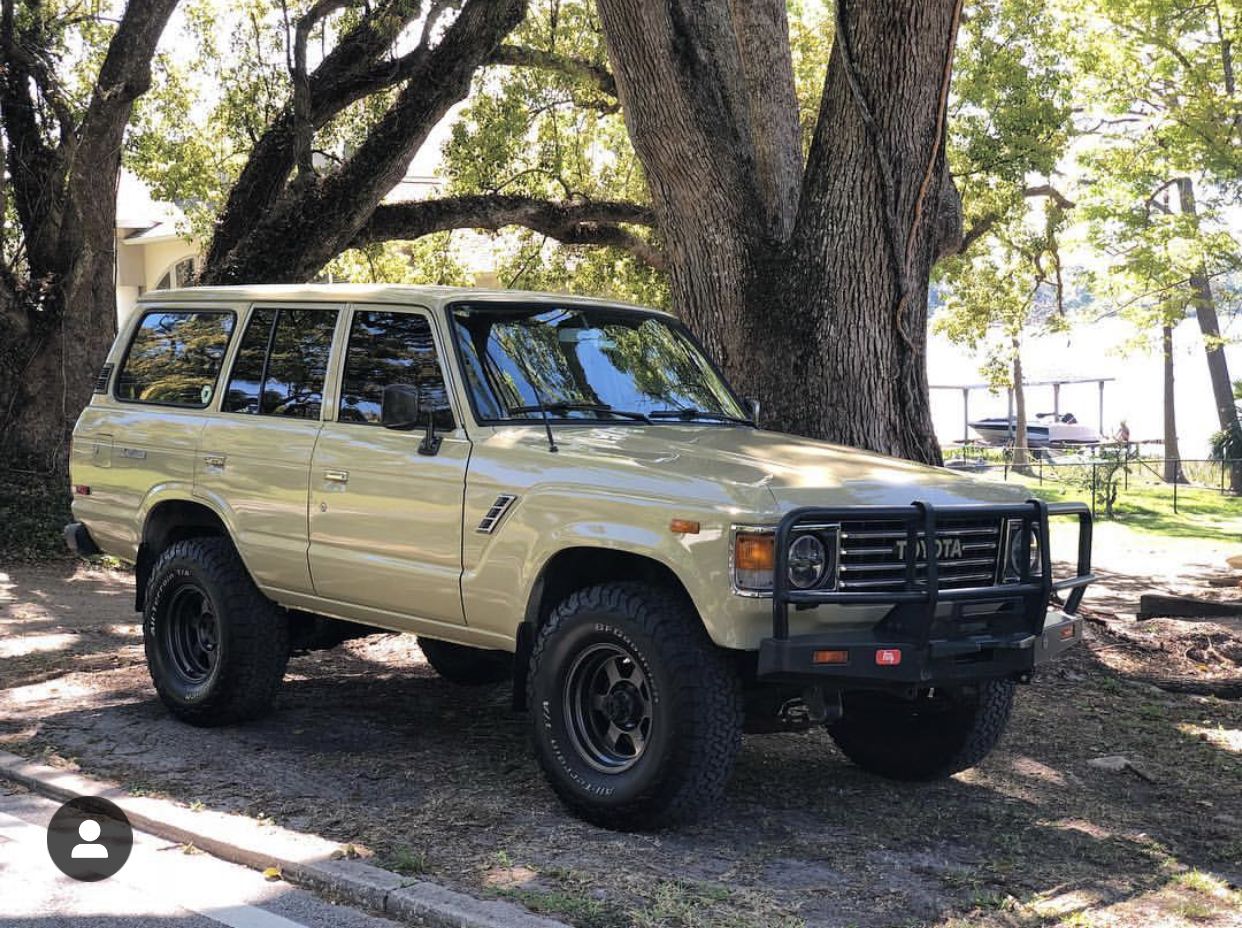

Good to know, but I already bought 16X7 US Wheel steel wheels with a custom 3.5” backspace and BFG 33X11.5. The wheels are in the shop to be powdercoated. I’ll have them mounted hopefully late next week. I’ll post pics then.

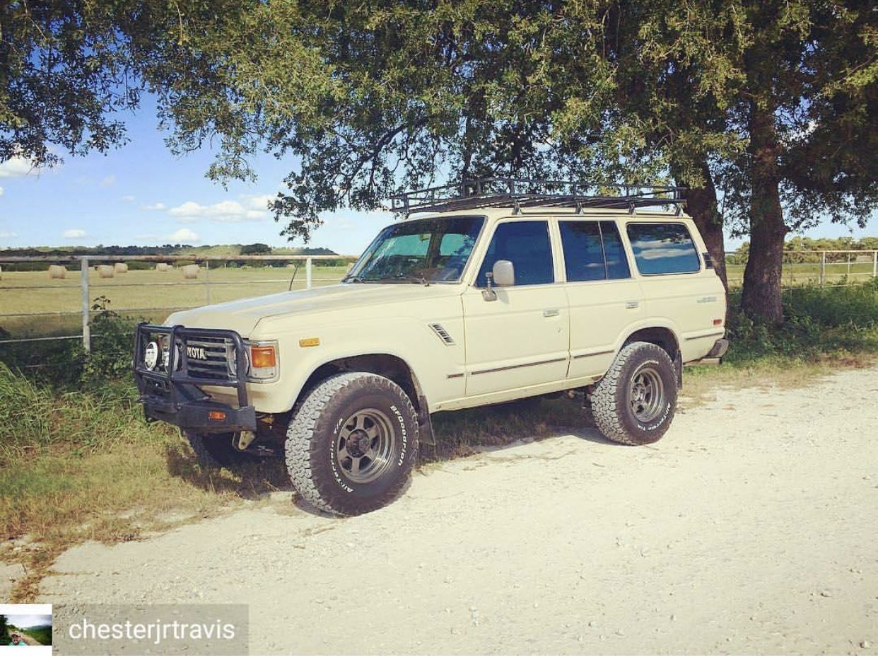

John, apologies, I never got back with you on my US wheel specifics. It was just a few days ago I found my paperwork on those. Mine are 16x8 with 3.5" bs. They are a dirt simple wagon wheel, but I like that old school basic look on these trucks. I powder coated black, my 62 is the dark charcoal gray and I find it difficult to match certain shades of gray/silver etc.. to this paint color. Decided to go with the 'dark' look, my windows are tinted as well. Looks good with the 285/75/16 Duratracs.
Look forward to some photos when you get them on.
