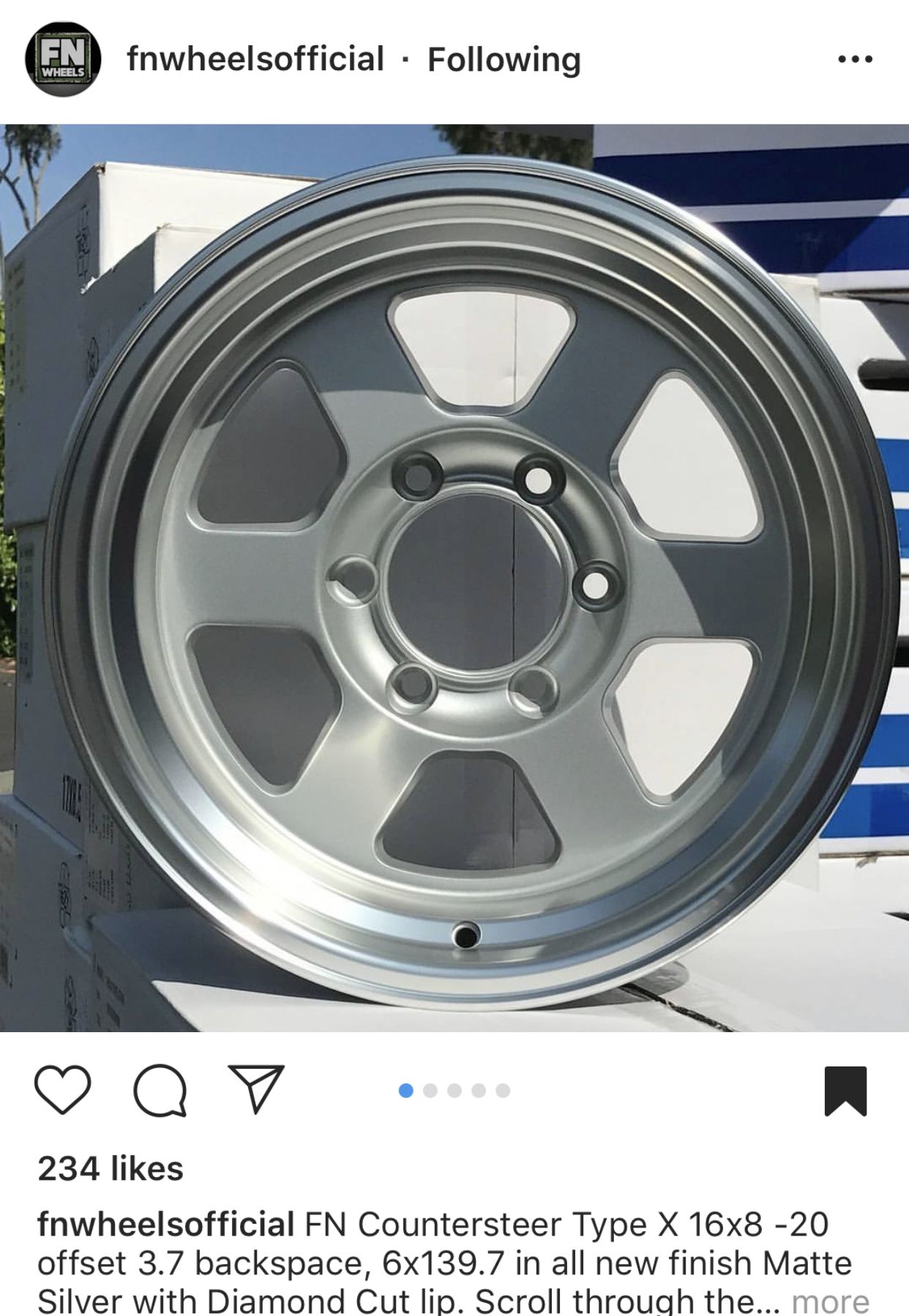

Sounds like you’re a candidate for FN Wheels countersteer Type X. They only list a 16 4.5” backspace on their website (not sure why) but if you call or email they have version that fits with without spacers.
Konig Countersteer Type X
Diameter: 16"
Width: 8"
Offset: -20mm
Backspacing: 3.71"
They’re in this thread somewhere (as are the 17” version) but here’s a pic. These will likely end up on my truck. Think they have bronze, silver, charcoal, and black.
Diameter: 16"
Width: 8"
Offset: -20mm
Backspacing: 3.71"
Thanks, They’re something to consider. They deviate a little too far from the stock look for my taste, but the matte silver doesn’t look too bad...

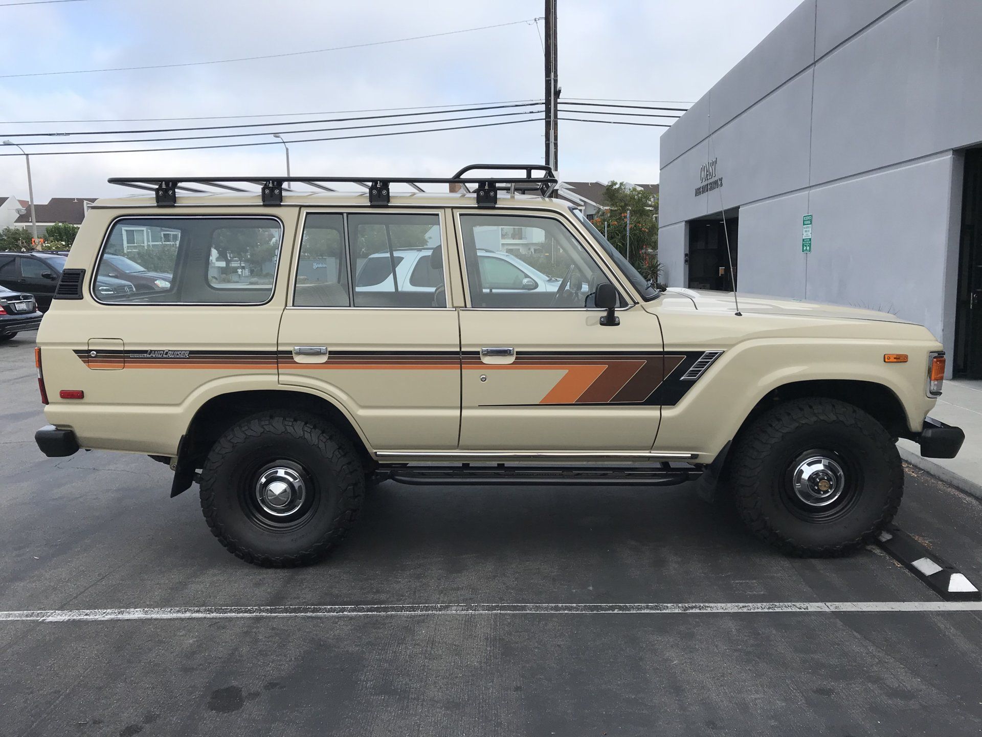

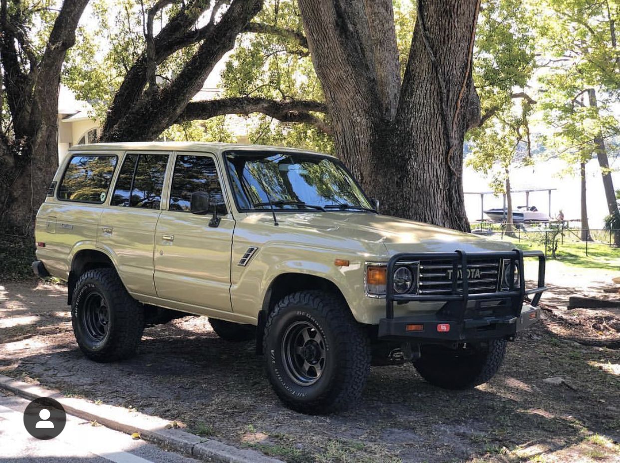

You might want to consider these Toyota 70-Series Land Cruiser 16" wheels:
fj60-lift-1-jpg.1733373
BFG LT235/85R16 ATs, ~32" tall.
I have looked at those. The problem is that they’re only 6” wide, despite what a few have written earlier on this thread. I’m looking for a wider tire, like a 265/75R16. I know others have mounted this tire on the wheel you’re suggesting, but the specs for that tire says the minimum wheel width is 7”.
