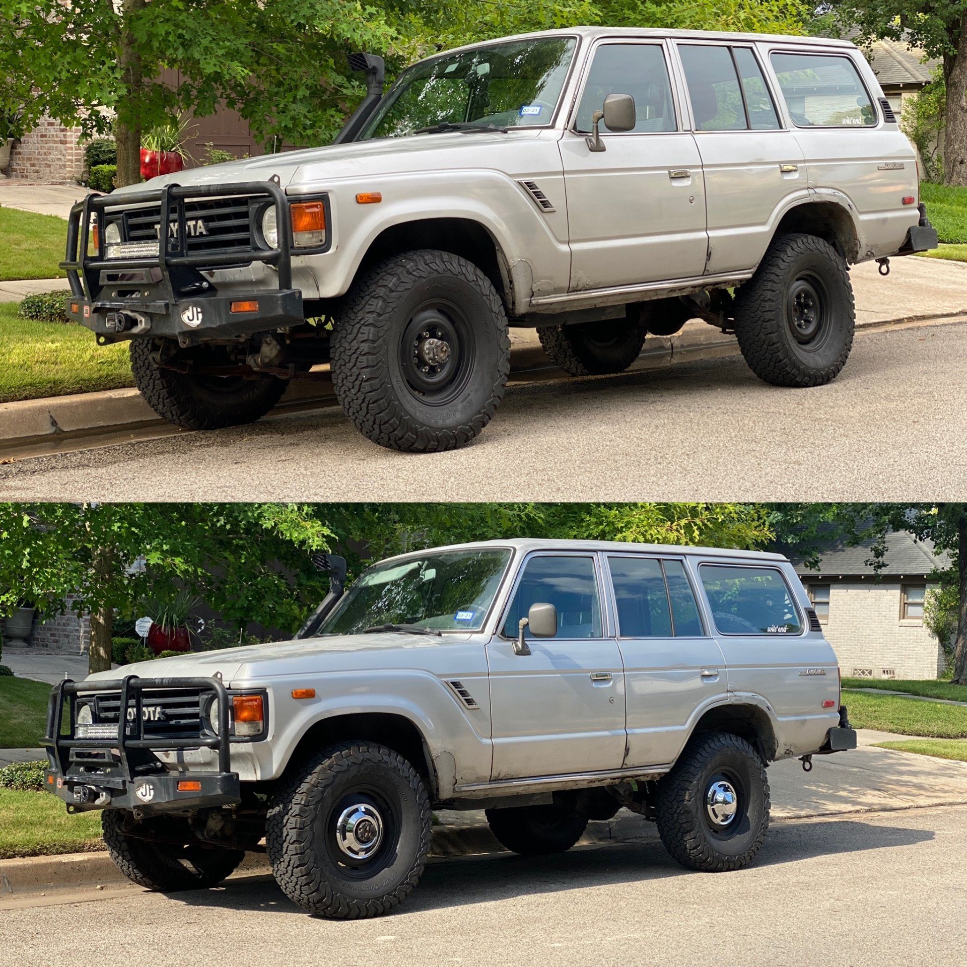

I finally got these on my rig. Here’s a before and after. The tires are 285/70 R17 KO2s.

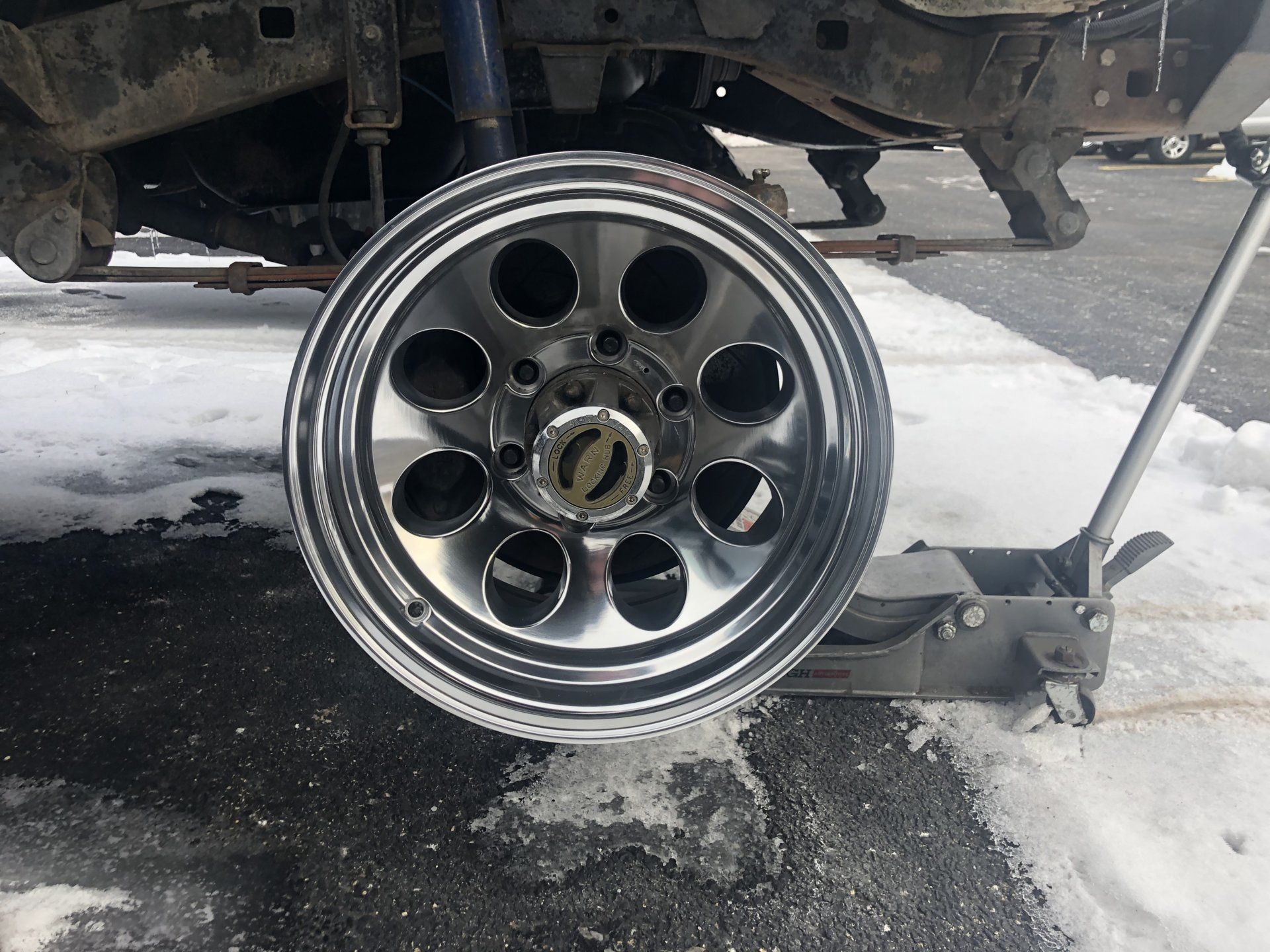

I successfully test fitted a Ion Alloy 171-5883P on an FJ60 today. 15x8 with 3.44” backspace.
They are available in Polished (171-5883P), Matte Black (171-5883MB), and Black with Polished Lip (171-5883B). Link to website. Obviously the center caps don’t work on the front axle but would on the rear. They attached with allen head screws, not a slip through cap from the rear. I imagine you could cut/trim the caps to fit the front if desired.
Just wanted to add to this thread. I haven’t even priced the wheels. Just more options for us!
Polished wheel pictured below.

that's a good lookin' rim
View attachment 2182444View attachment 2182427

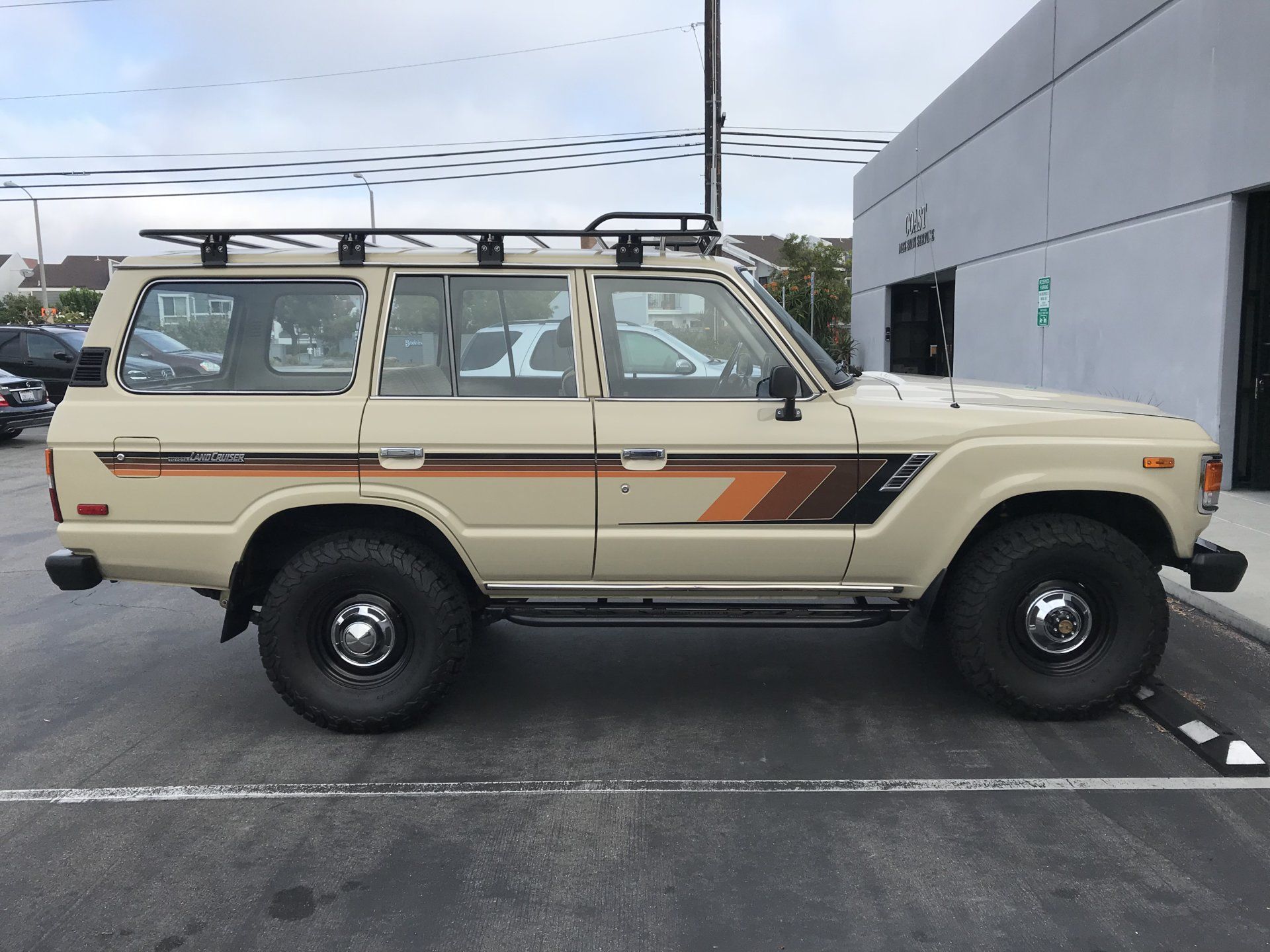

A loaner set of FJ company wheels in 16x6 with a 285/75-16 on my 60.
