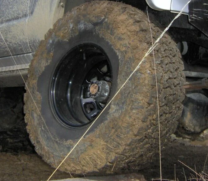

    Rock Crawler by Pro Comp 15x10-5.5" REV 2.5" BS. Part #51-5183R2.5.
    Reverse backspacing that really put the wheel out there. Flares would be recommended. Slight touch at caliper, but it was so slight I just ran them and let it work itself in rather than trying to grind the caliper.
    Running 35x12.5 BFG A/T's on them.
