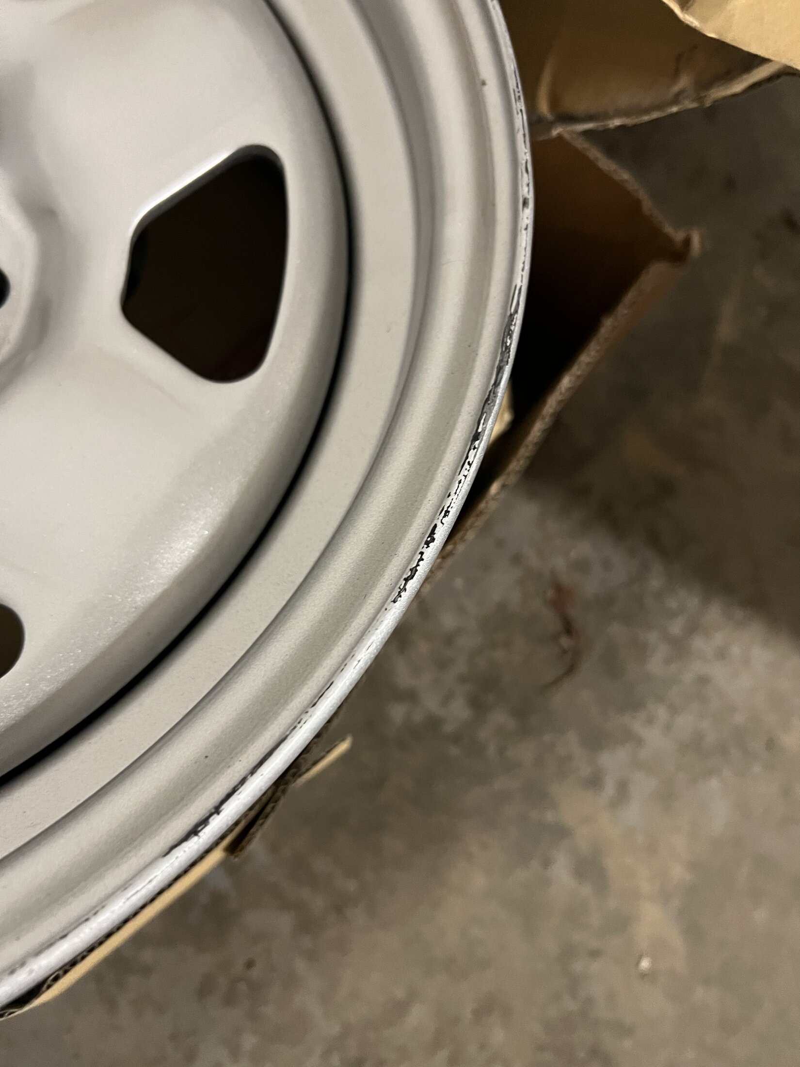

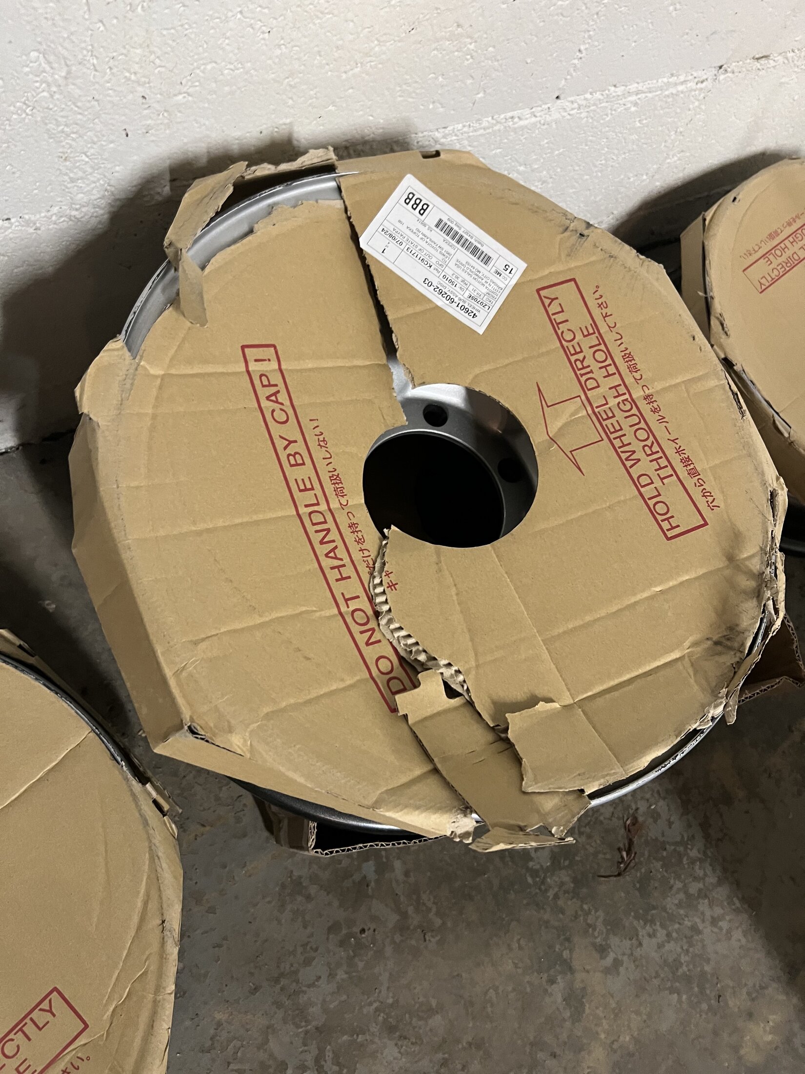

I thought they shipped in individual boxes. Two of mine had a dent in the lip.Mine arrived (from another vendor) in similar condition/chippingpaint chipping or rubbing off on the outer edge. *The metal lip is not damaged.
Watching for ideas of a good touch up paint…

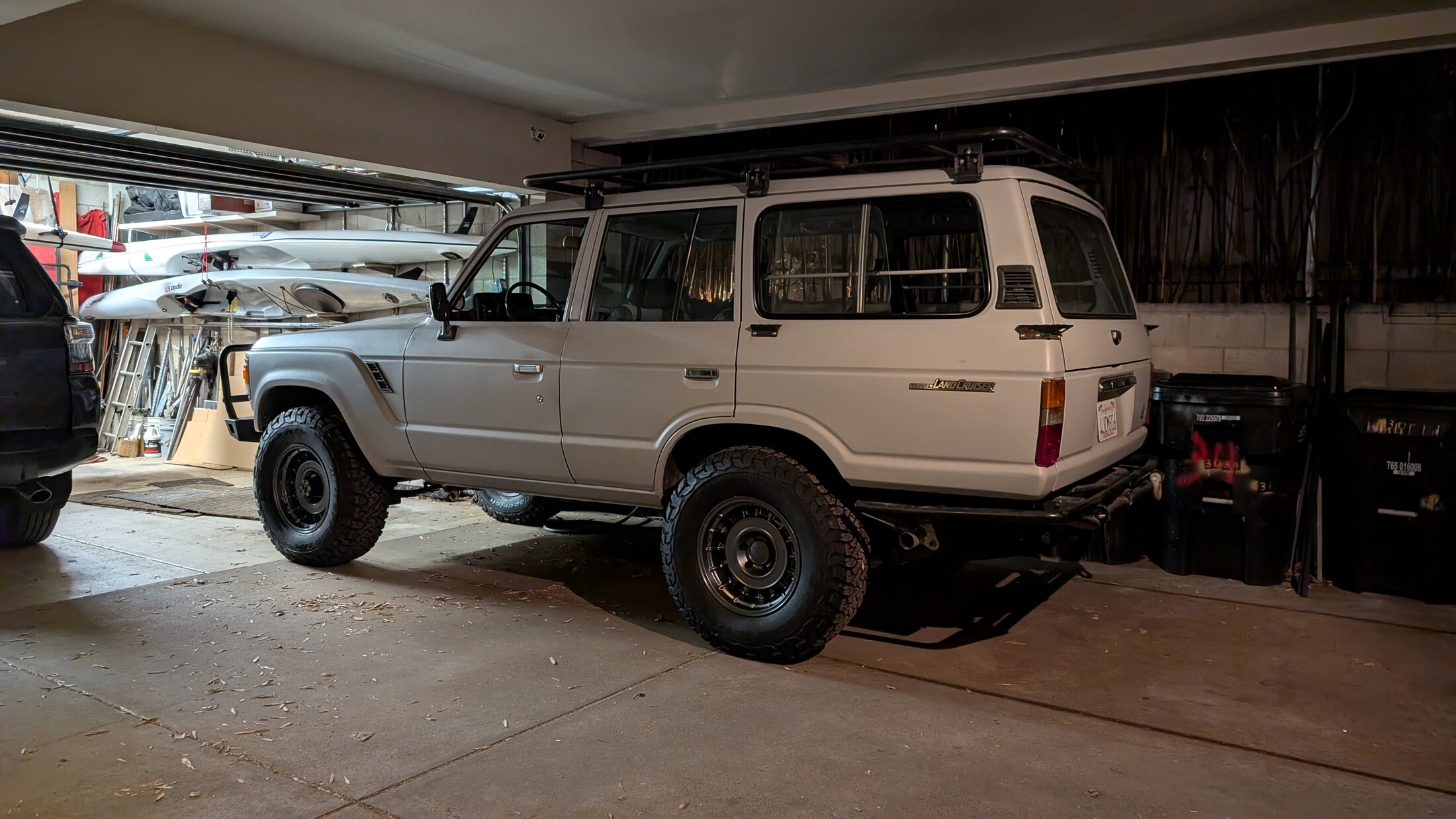

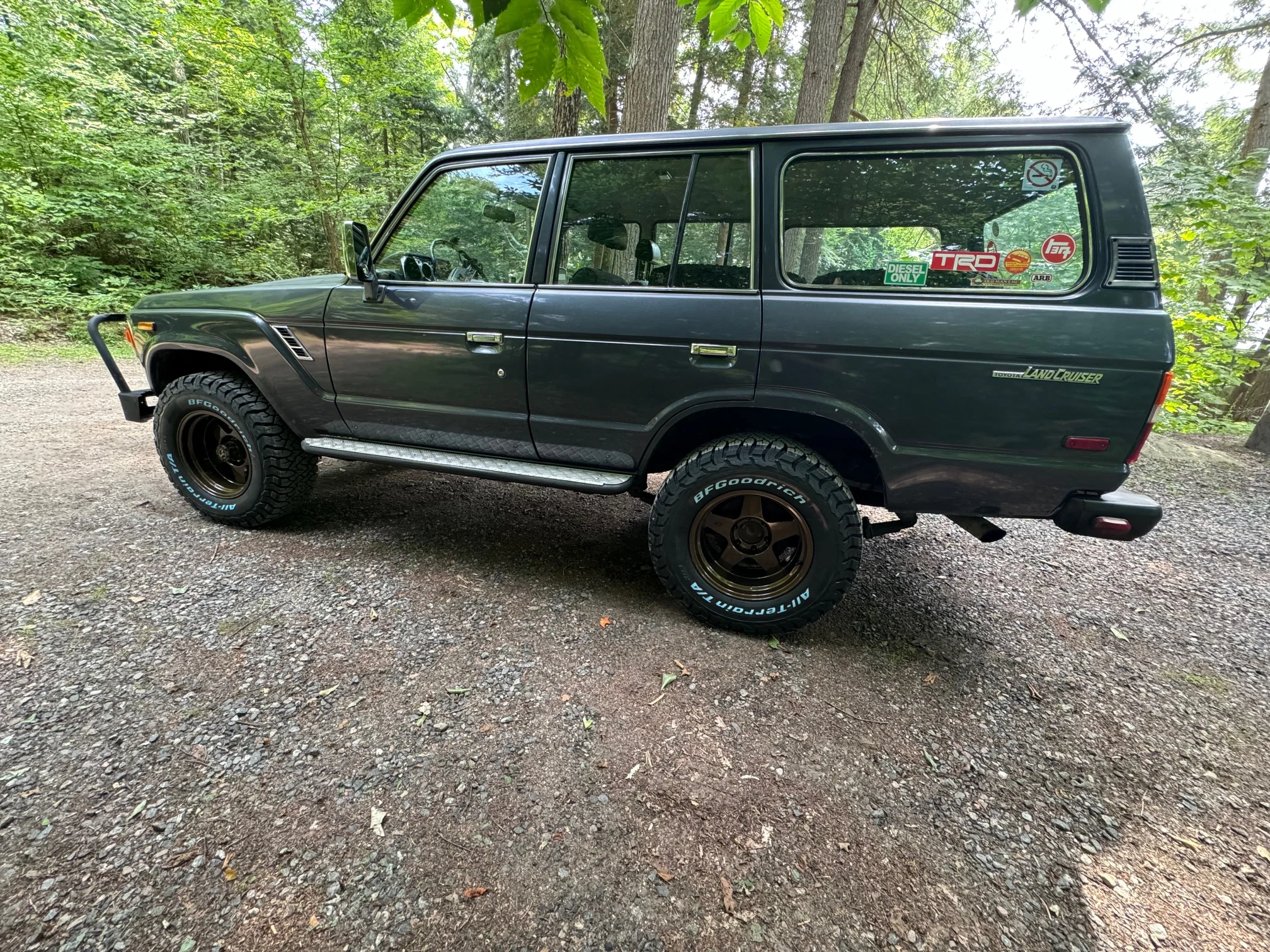

That's got old-school dish to it. Nice! Didn't realize they had added a design. No idea what that colour is, butAnother shout for SCS wheels. Inspired by @cruiserpilot I went a slightly different route with the Gen5 wheels vs the F5. This was in large part due to availability where I am, but I'm very happy with the look. Details are: 9"x17" 3.5"BS (-38mm offset) wrapped in 285/70R17 KO3s. Vehicle is sitting on a OME lift (previous owner), though I don't know the specs.View attachment 3735004
Thanks! I think SCS calls the colour "Gloss Bronze".That's got old-school dish to it. Nice! Didn't realize they had added a design. No idea what that colour is, but
very cool!
Love the wheels!! do you have spacers?Another shout for SCS wheels. Inspired by @cruiserpilot I went a slightly different route with the Gen5 wheels vs the F5. This was in large part due to availability where I am, but I'm very happy with the look. Details are: 9"x17" 3.5"BS (-38mm offset) wrapped in 285/70R17 KO3s. Vehicle is sitting on a OME lift (previous owner), though I don't know the specs.View attachment 3735004
did you have to re-gear given these are 17's and 70" tall tires?

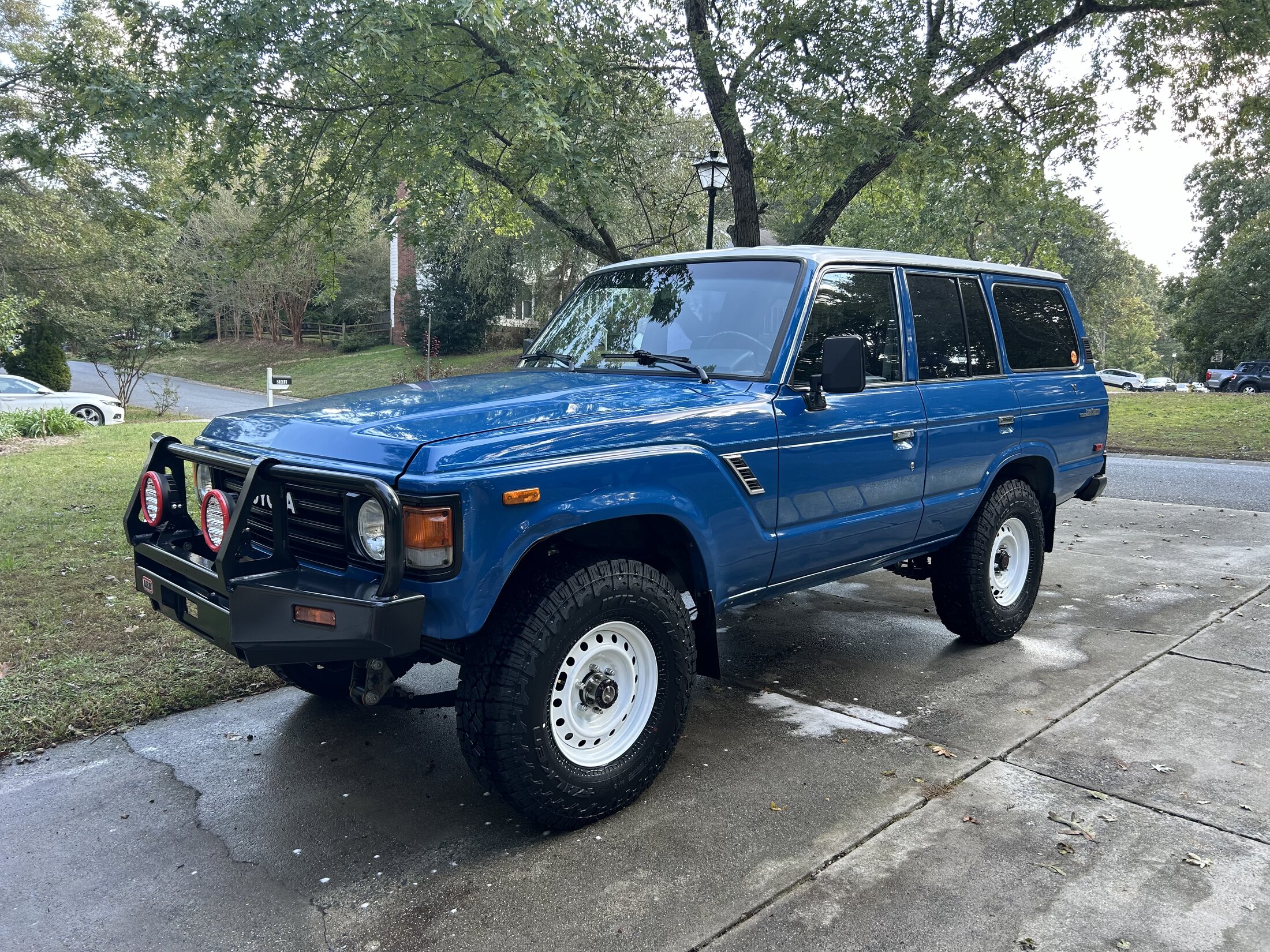

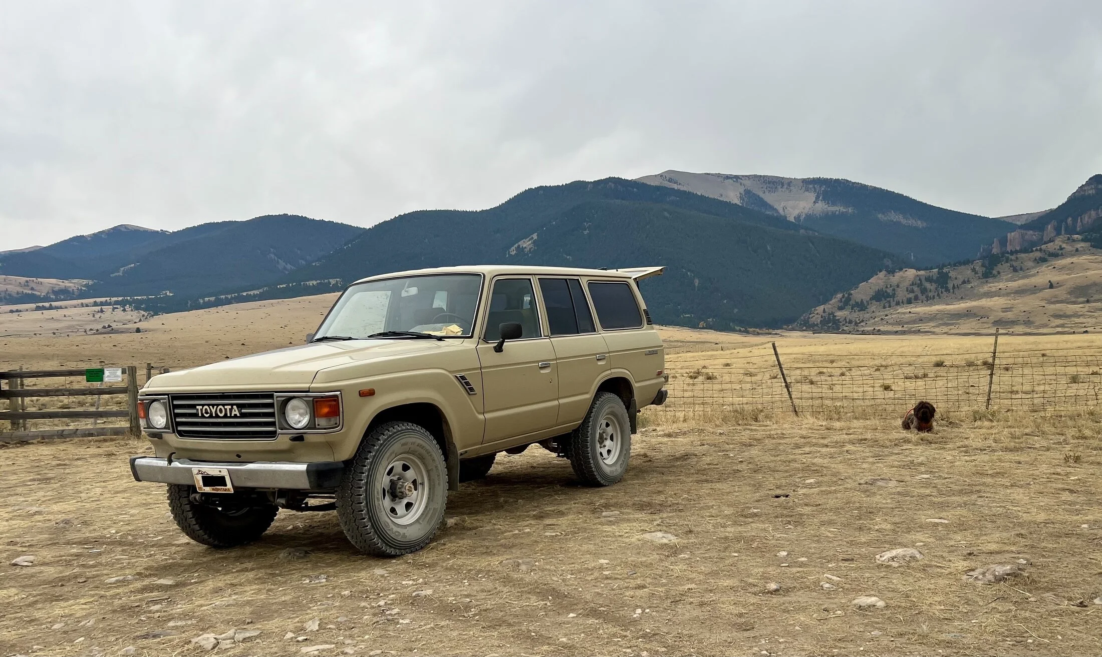

These look great.I took a chance on a set of 16” steelies from a 2017 Tacoma. Research showed the modern truck 106mm hub bore wouldn’t be enough to clear the front hubs, but when I mounted them up, all 5 cleared. Snug, but fit.
Not sure if a QC issue or most modern steelies are actually measuring larger than factory on the hub bore, so take at face value here.

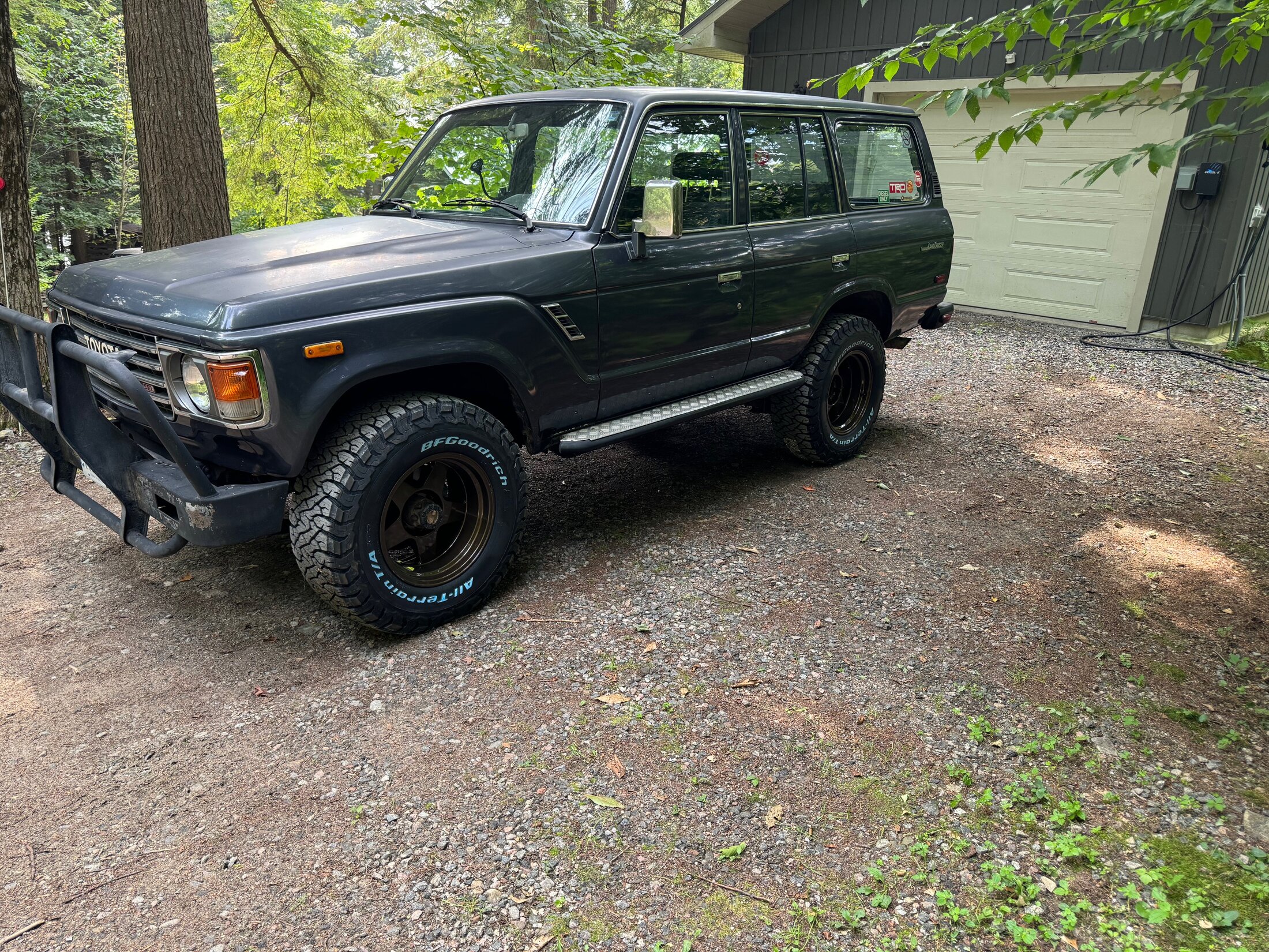

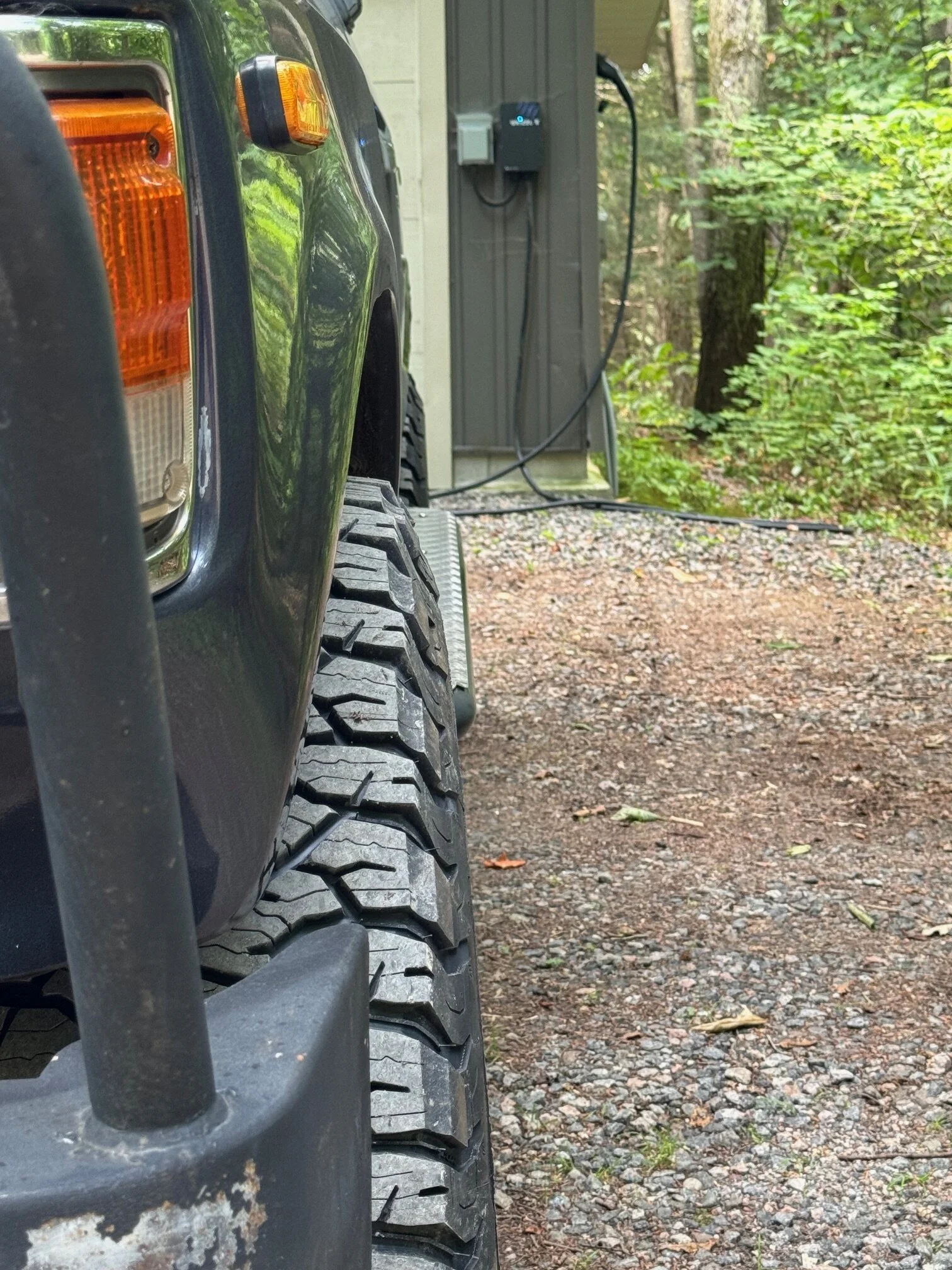

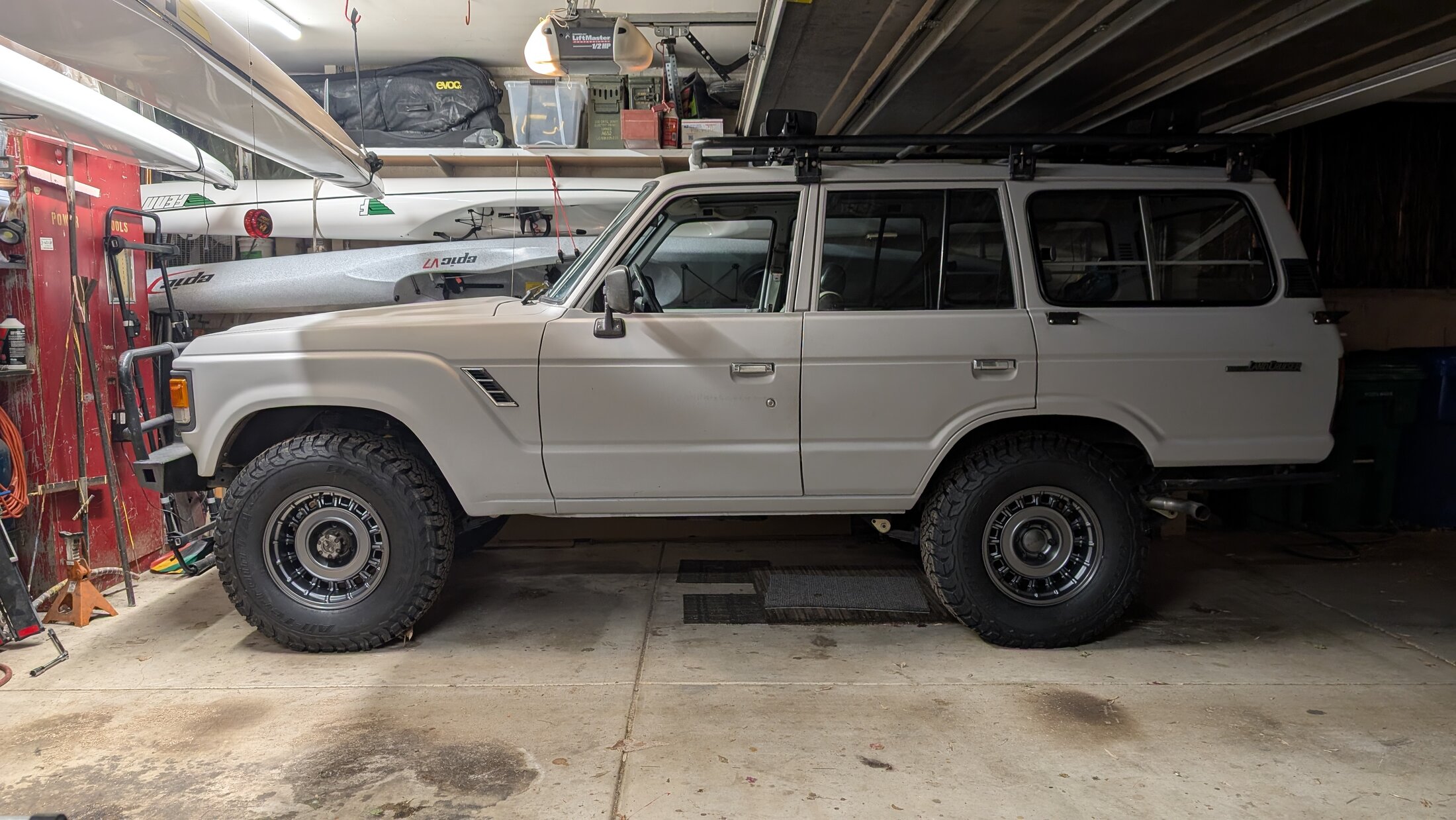

those look really good! nice findHere are the Nomad Arvo 17 x 8.5 -25 rims. I have stock axles, no spacers and no modificaations to the width. The tires are 285/75 r17 BFG All Terrain KO3. My suspension is a new OME heavy / heavy.
This tire is 33.8" x 11.3" per BFG
Shop All Terrain T/A KO3 Tires | BFGoodrich Tires
Even in the worst of conditions, the BFGoodrich All-Terrain T/A KO3 tire is made to grip. The serrated shoulder design and mud-phobic bars improve upon KO2 tire’s legendary mud and snow traction.www.bfgoodrichtires.com
502SB Arvo Satin Black – Nomad Wheels
Patent #D1036343 • Heritage inspired vented window design• Color matched snap-on cap with debossed Nomad logo• FORMLITE construction out of A356-T6 aluminum for increased weight savings• Available in Satin Black for most truck fitments and Dusk finish for Subaru and other CUV fitments• Available...www.nomadwheels.com
I would have preffered a simple steel rim but this is really the only wheel I could find with the extreem by todays standards offset.
