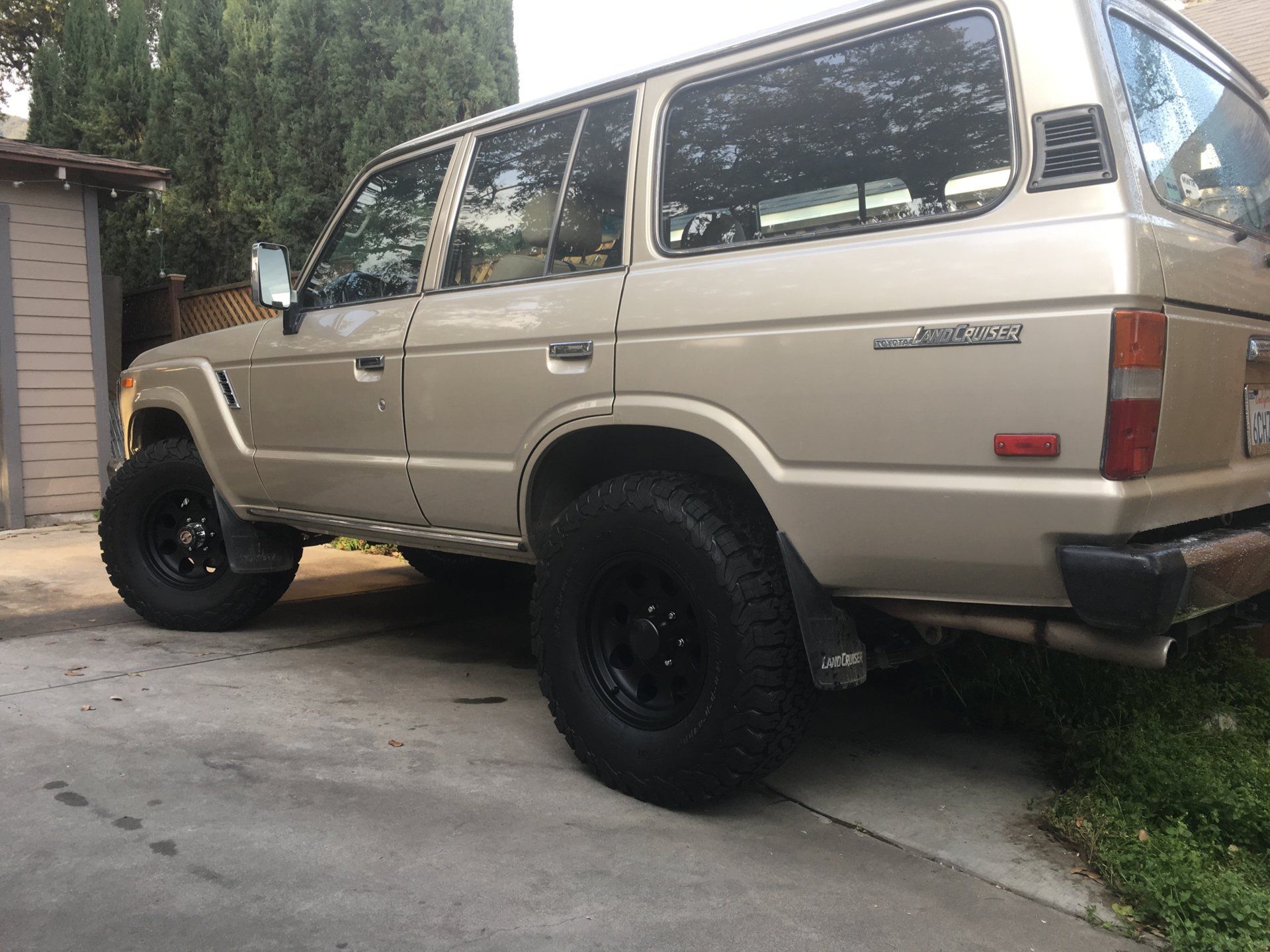

After months of searching for a black alloy rims that would fit without any spacers, I gave up and just purchased the silver polished Level 8 Tracker rims. They were available in black several years ago and sourced on several builds here on mud including Bean's here.
The silver ones are probably going to be gone soon since the rim has been completely discontinued. They are currently available at several online retailers but seem to be going fast - I purchased mine on Ebay. Since I was looking for black rims, I had them powder coated locally and just got them mounted yesterday.
I can confirm they fit perfectly without spacers and provide about 1/4 - 1/2" of space to TRE's, no rubbing at all. On another note, my old tires looked like they were in great shape - almost "new-like" tread on them but the tire shop confirmed they were sixteen years old! YIKES! The ride is so much nicer on the KO2's so I'm assuming those old tires were rock hard- check your tire manufacturer dates!

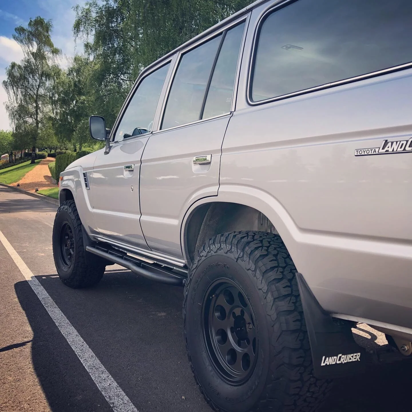

Looks great! How much of the tyre bulge is outside the fender?
A friend has a 61 with flares, might work well with this setup!

@TLC Norway - I tried to take a pic that shows the very slight, if any, bulge outside fender but there is barely any tire sticking out beyond the side of the 60. I'd agree with @Skniper that this size is good compromise and looks great for a "slightly" bigger / less skinny look.
Also, you can search the 60 forum for 285/75/16's as i think several people have asked so there should be multiple pics with better angles out there. thanks!

Your’s looks very much like mine with regard to “bulge”. See post #256.

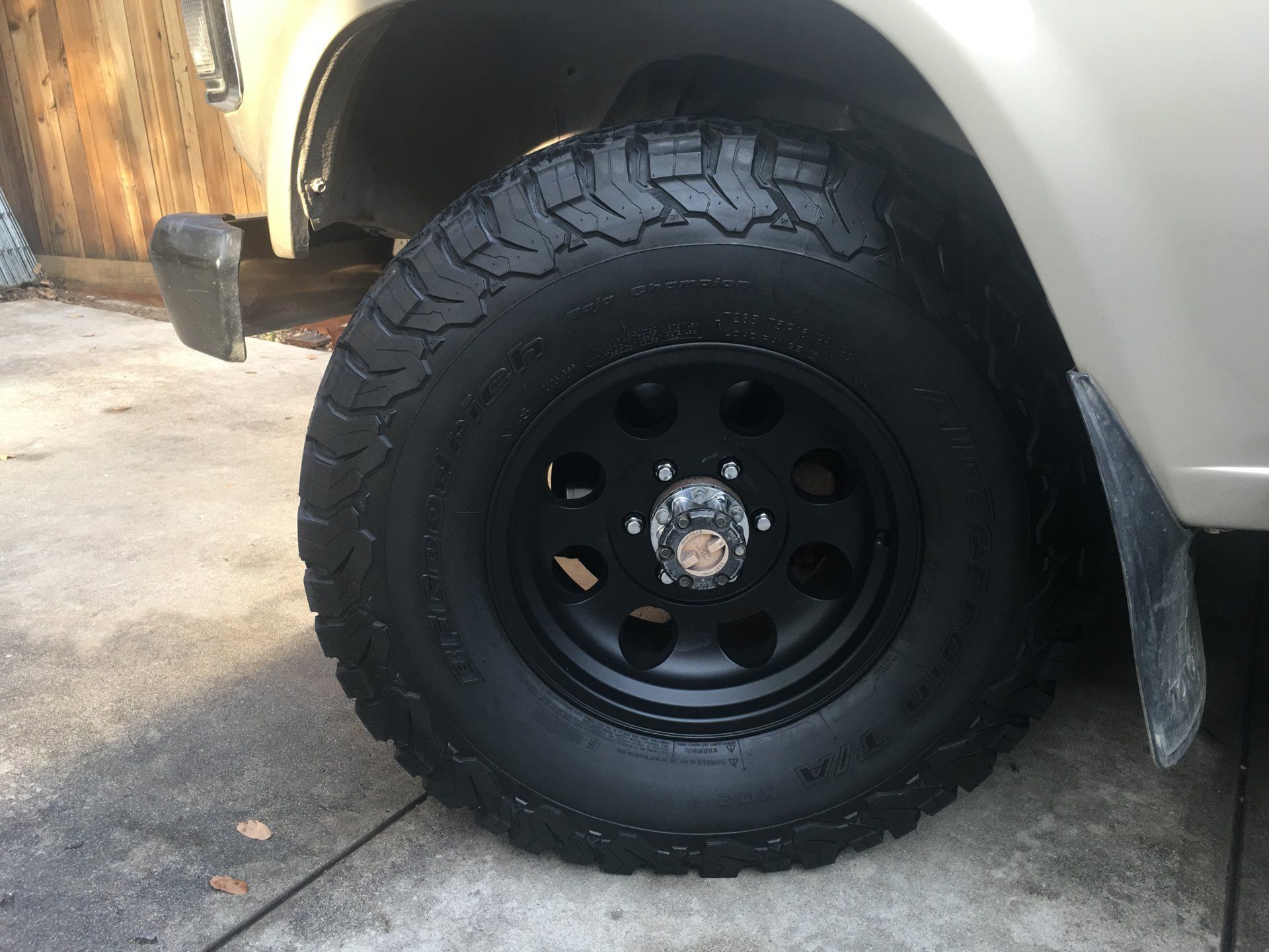

Got all the wheels in and found a farmer here locally who had just pulled a set of five matching 285/70R17 Cooper Discoverer AT3s off of his 80-series. Just got them mounted up, and everything fits well. I couldn't be happier with the new look. The Pro Comp Series 97s (PN 977983S3.5) are 17x9 with 3.5" backspacing. If you're after the pizza cutter look - these aren't the parts you want to use. As you can see, everything sits flush and has a full, balanced look. Haven't stuffed everything into the fenders yet, but there are several inches clearance of all nearby components at full lock in each direction.
Ended up getting a set of the same pro comp wheels and BFG All terrains in 275/70r17 from 4 wheel parts. Still waiting on them to get mounted and balanced but I did test fit one wheel on my buddy’s 85 FJ60 and can confirm they fit the without any spacers or grinding on the front calipers.
