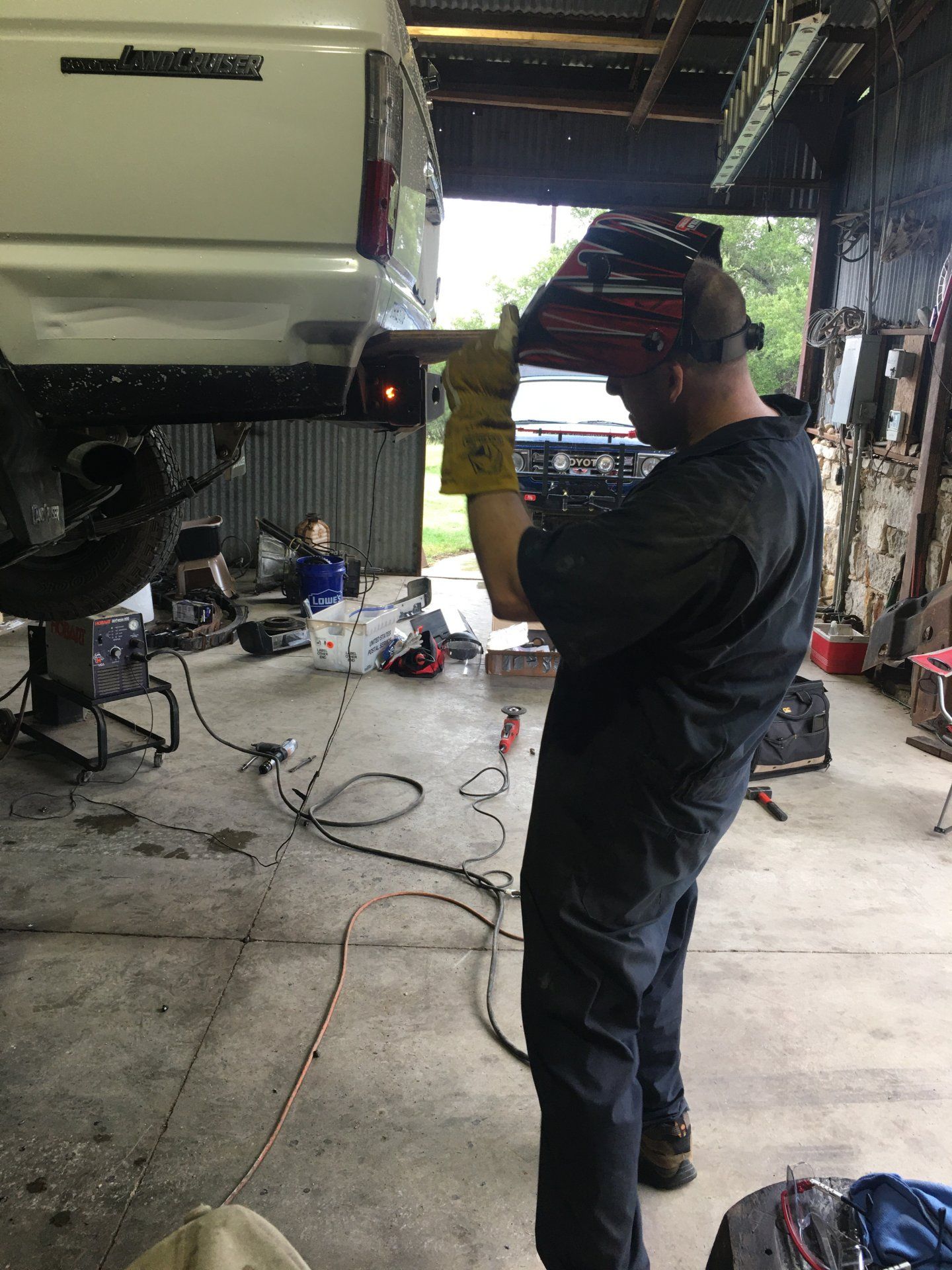

It’s coming together. Unfortunately I found more hardware (spare tire carrier clamp) and one sleeve that we were shorted. Frustrating cause the ladder won’t get powder coated until we get a sleeve shipped to us. The ladder is a pain in the arse. A lot of grinding requires to get things aligned.
Makes me think I’m not buying a kit. I’m not sure I will trust my welding at this point in my life. Yours looks great, however.

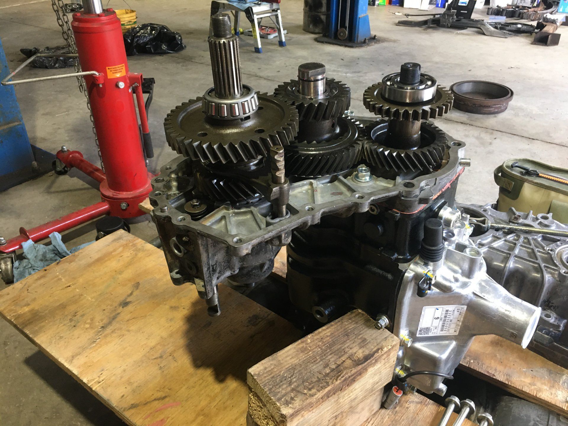

Was great having you out this last weekend Ben. You have a very nice 62 and definitely throwing some tasteful upgrades at her. The T-case will be done once we get a shim kit. Only able to get just over 1newton meter on the backlash. There’s been two occasions where trans shops (previous owner) have been into this case. And boy did they lay down some cement for gaskets. Never experienced this before. Finally took a soft wire wheel on my drill to remove them. Looking forward to getting the trans in and starting on the rear axle. New (used) 4:11 diff with an ARB along with wheel bearings, seals and new brakes. This is a fun job and appreciate you trusting me with it. Jimmy.

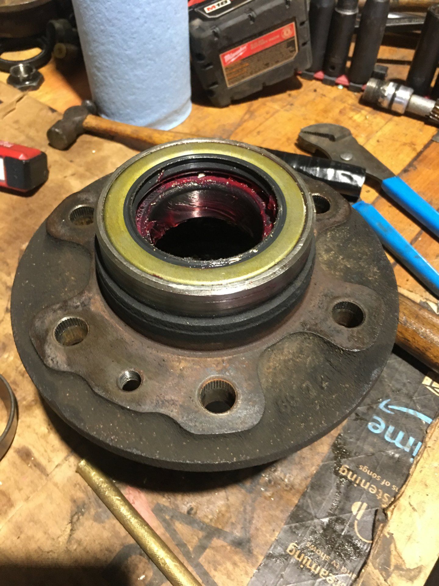

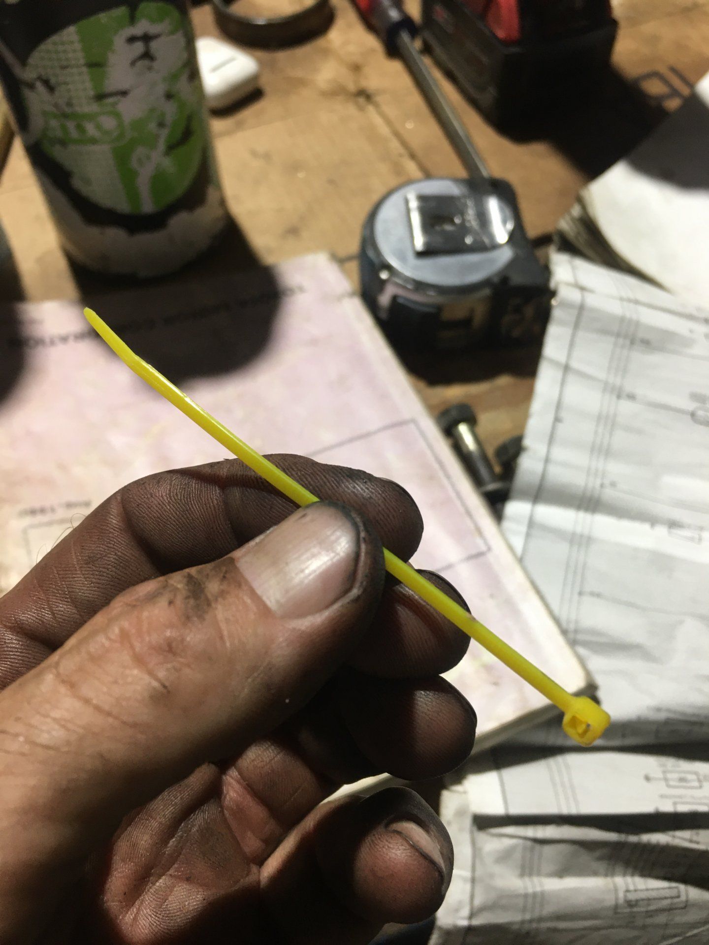

So I learned something today about Napa. They (at least my local one) have the wrong part # in their system for a 90 FJ62 rotor. What they sent was a 11.5” rotor with threaded holes for the wheel studs. Something has changed here because I’ve bought rotors from them for a few other 60’s in the past. I ended up getting them from Oriellys and they are a good match for what I’m replacing. Also hung the bellhousing, flywheel & clutch. Did the RMS and oil pan gasket as well. I’ve done several pan baskets and always followed the FSM applying RTV in the 4 corners. Today I read a few threads and decided to apply RTV in the saddles as well. IMO that was a mistake. Was a mess to work with and started setting up quicker than I work :). Ended up the gasket was not aligned well in the rear. Had to pull the pan down again and manipulate things to make it work. I’ve never had a pan leak so not sure why I tried a new process. With small zip ties I’m able to control the alignment of the gasket. I know there’s several opinions on this but I like how I’ve done it in the past. And done right it should not leak.
I prefer to tie the oil pan gasket up w/ dental floss in four spots, then bring the pan up to it. Both times tho the block has been bone dry when I did them. It’s never made sense to me to attach it to the pan first like the sticky describes.

Was great having you out this last weekend Ben. You have a very nice 62 and definitely throwing some tasteful upgrades at her. The T-case will be done once we get a shim kit. Only able to get just over 1newton meter on the backlash. There’s been two occasions where trans shops (previous owner) have been into this case. And boy did they lay down some cement for gaskets. Never experienced this before. Finally took a soft wire wheel on my drill to remove them. Looking forward to getting the trans in and starting on the rear axle. New (used) 4:11 diff with an ARB along with wheel bearings, seals and new brakes. This is a fun job and appreciate you trusting me with it. Jimmy. View attachment 2437123View attachment 2437124View attachment 2437125
The soul of the cruiser on the table ready to be oiled and massaged.
