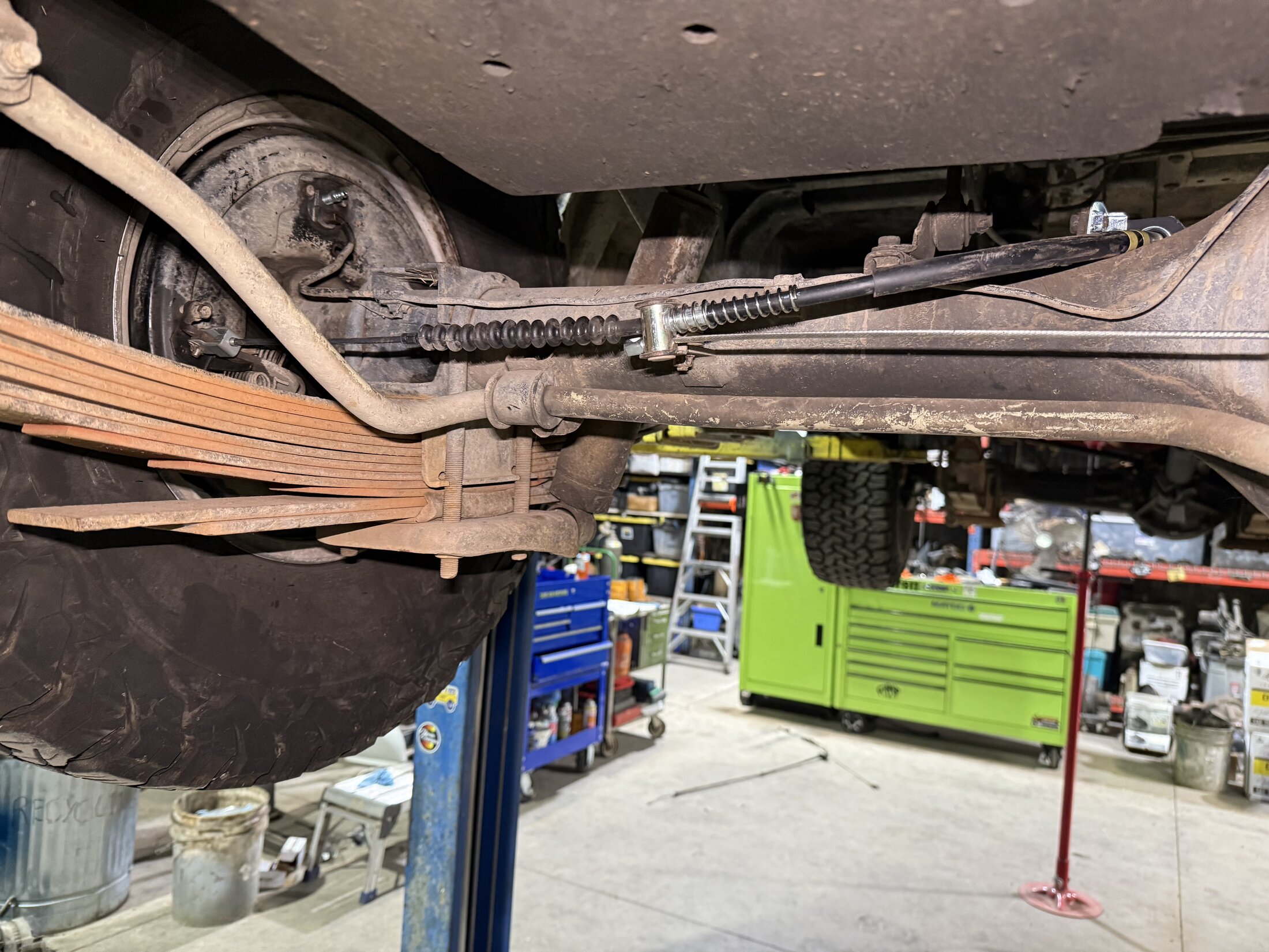

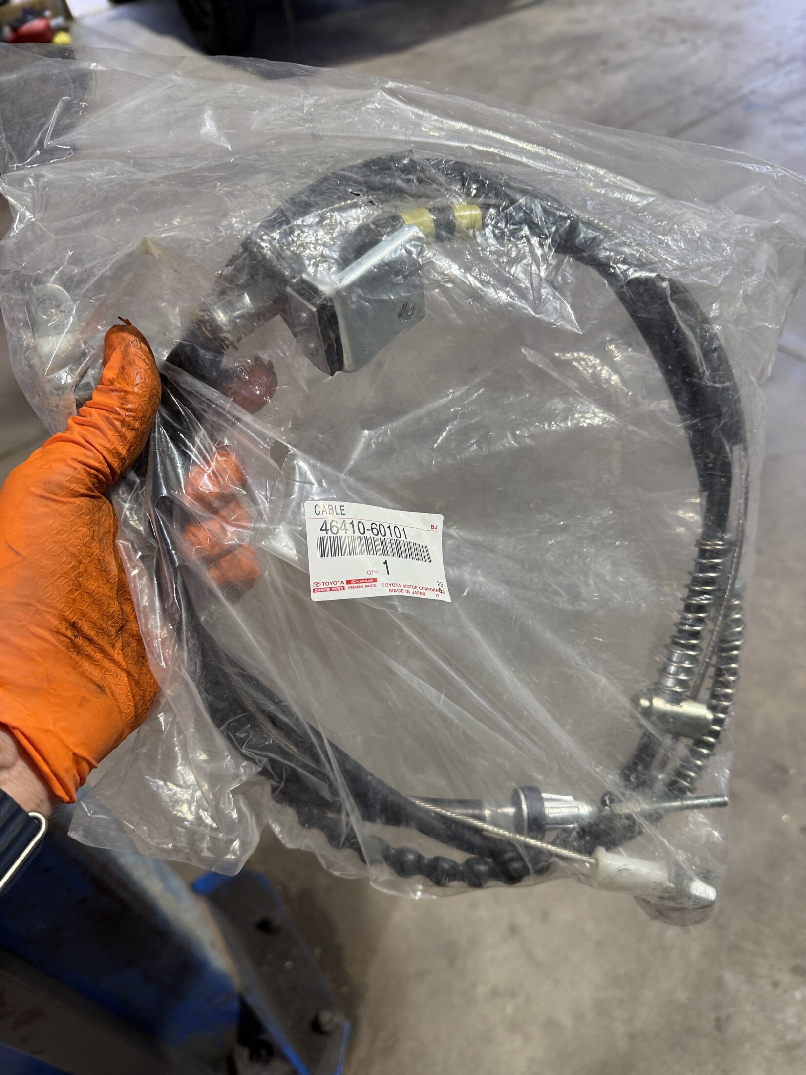

@CenTXFJ60 I should update my parking brake cable. Is that part number for a 60, or is it also an early 80 Series thing? Looks great!
There is a difference between early and late 60 series parking brake cables regarding the bracket mount on the rear axle. When you order through Toyota, I always include the VIN. This has saved me a couple times.

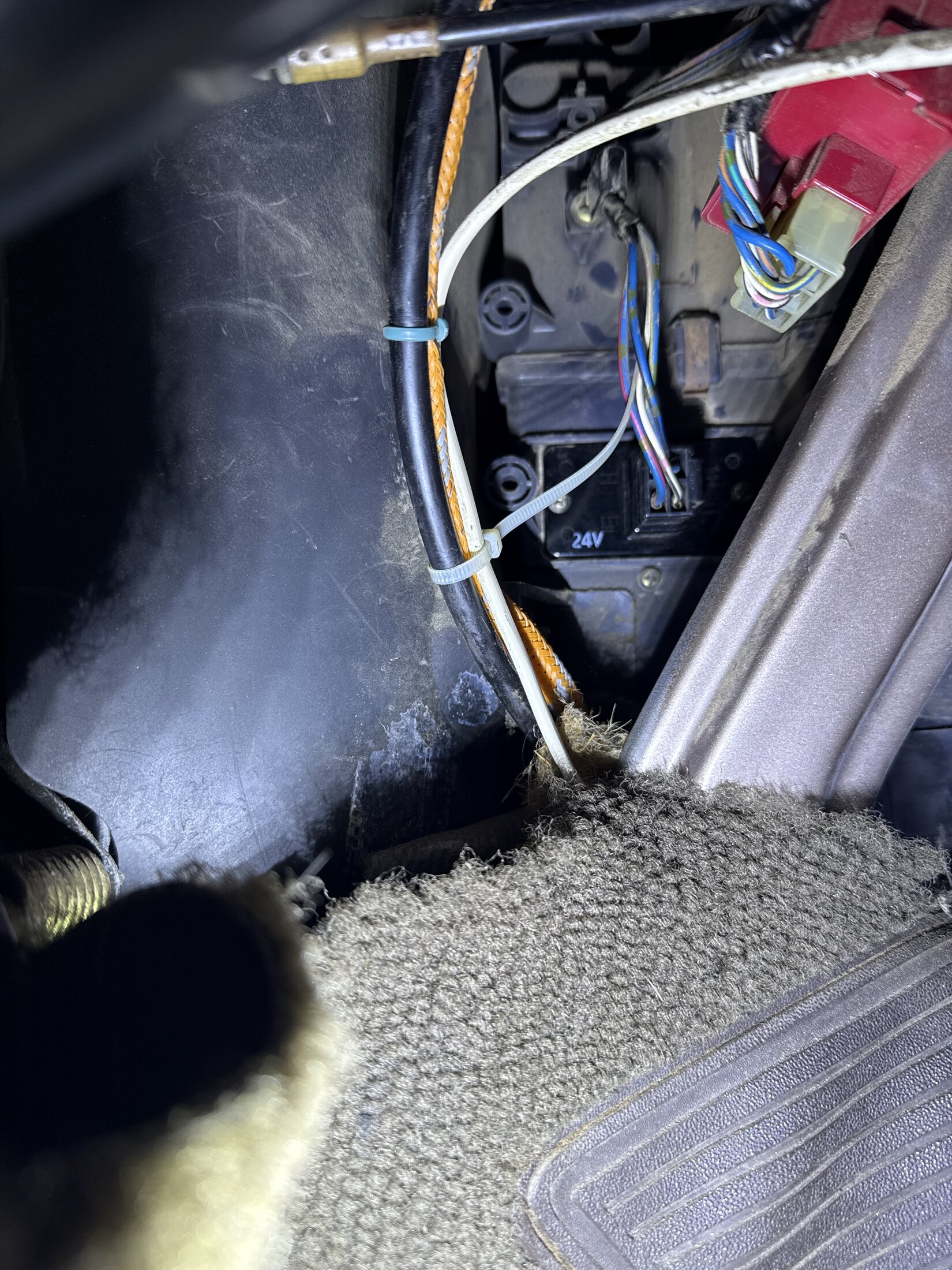

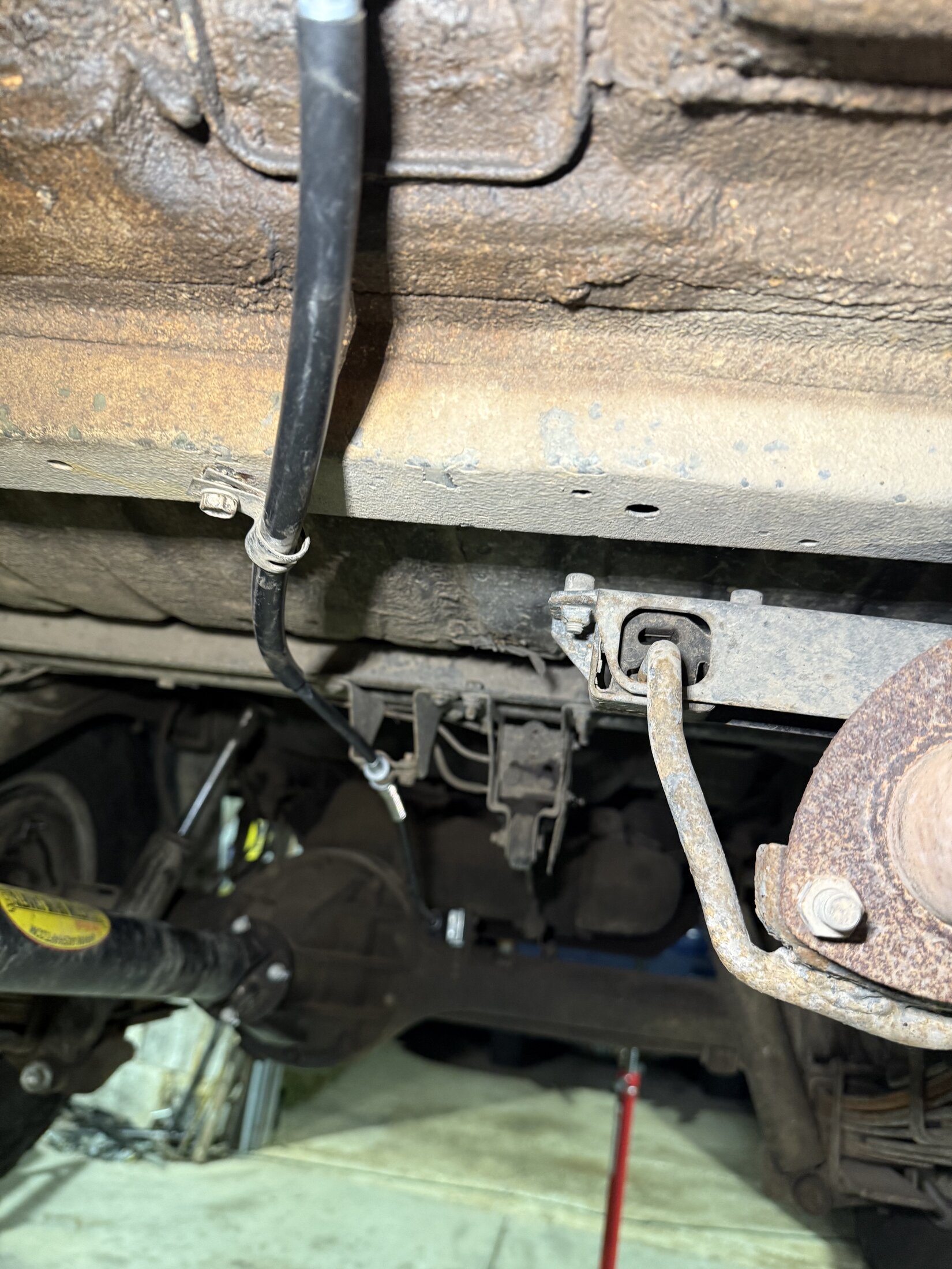

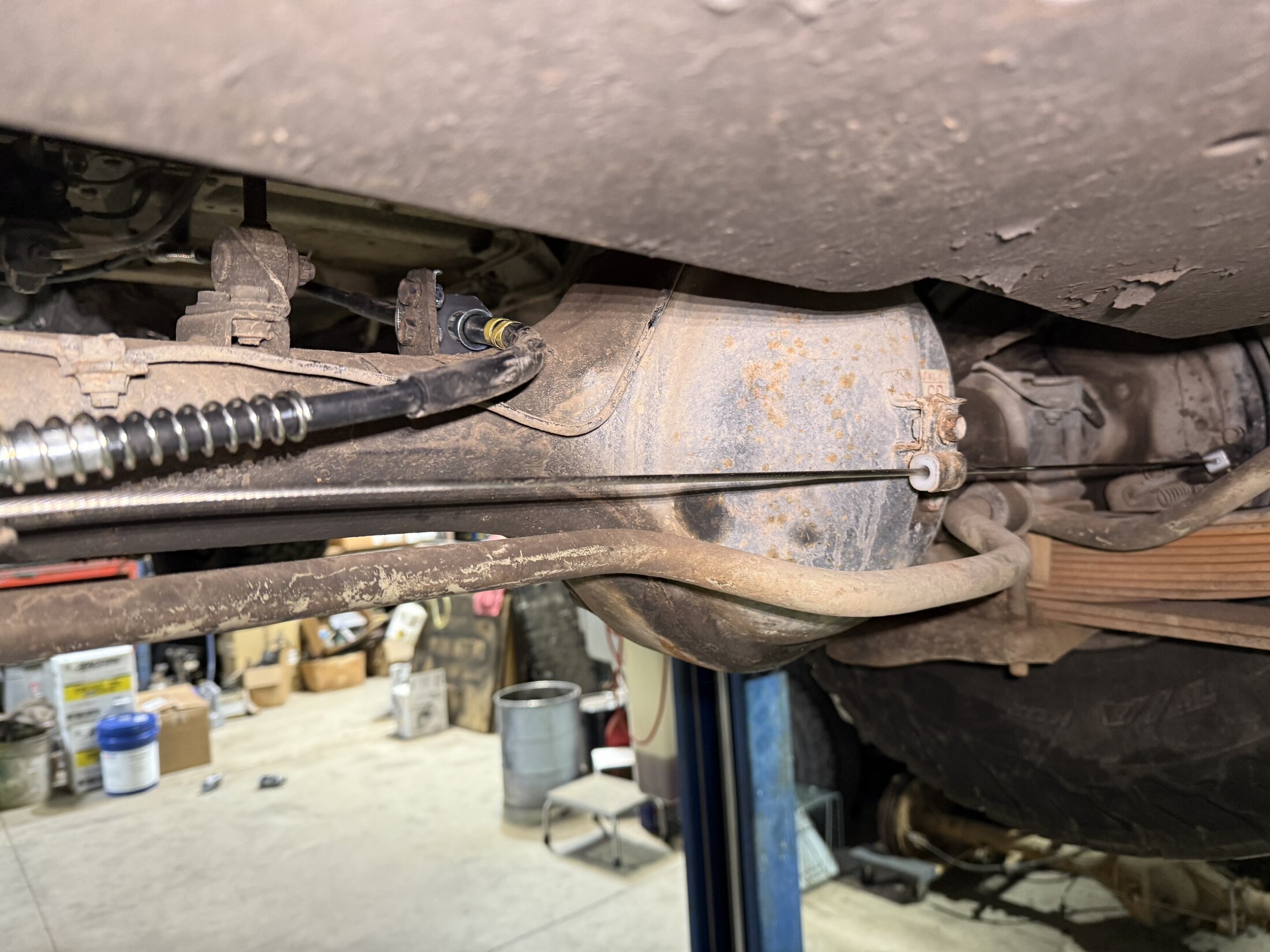

Sharing a video I sent to the owner. I could not adjust the new rear brakes due to the broken parking brake handle. I discovered his cable was bad as well so a complete refresh of the parking brake system and she’s now good
Five bucks says this is the work of a set of tire chains slipping off.
That's what happened on mine, bent the break line exactly like this, and ruined the parking brake linkage on the back of the drum. Actually pulled the parking brake lever into the floor a bit when it wrapped around the cable.
My OSHA senses are tingling!
Might be time to order some new drums with that free shipping. I'm really out here sticking it to the man.
Edit: $297 shipped for two drums and the shoe kit. Hmmmm....
Hey Jim. That part # I have in the pic is for the 60. The truck I’m working on is a 87 model. I as @Dr Rock stated, there may be a split between early and late 60

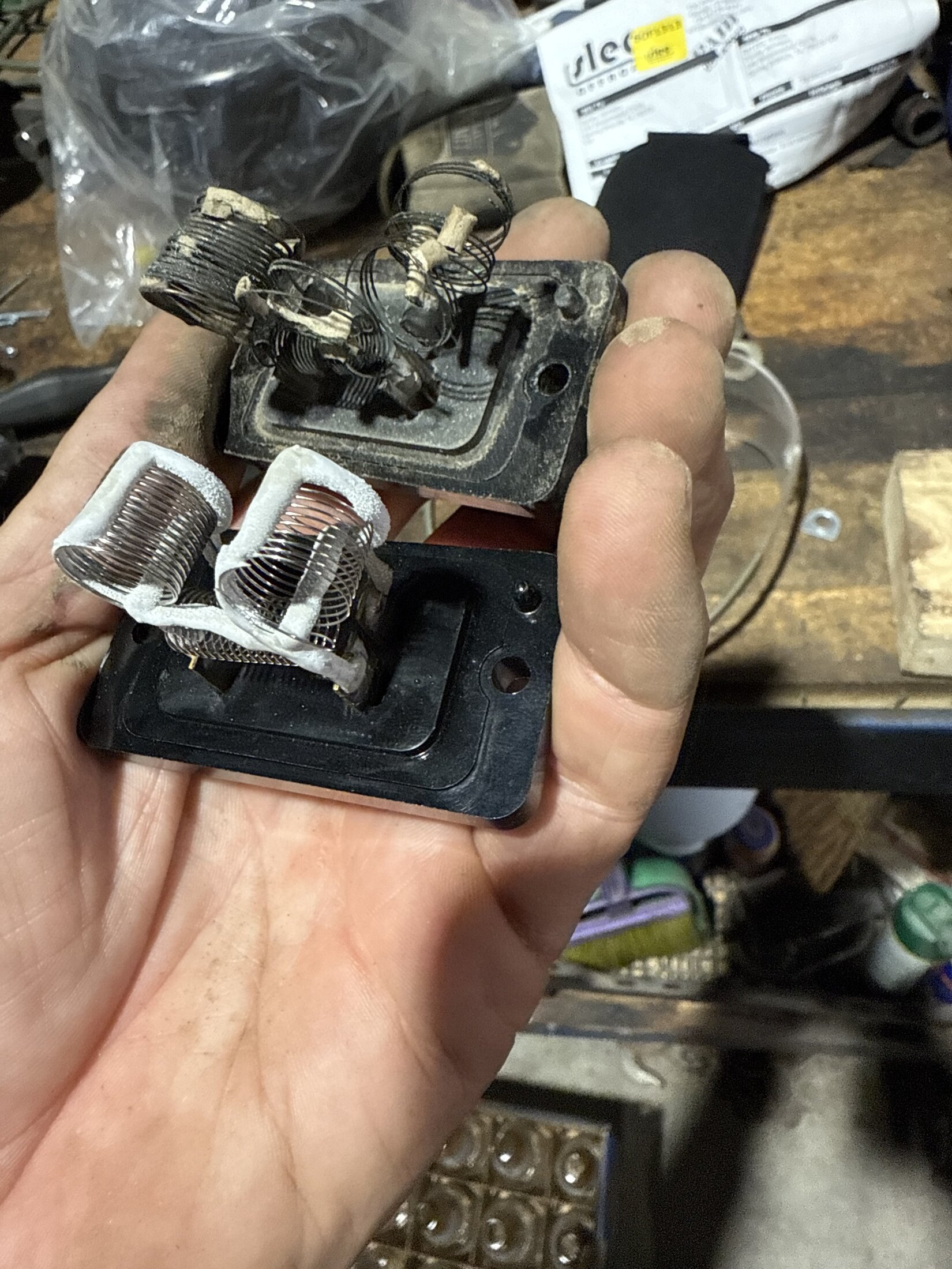

Adjusted the brakes a bit and bled them a second round. Should have looked under the screen the first time but found a lot of junk in the master reservoir. Gonna pick up some more fluid tomorrow and suction this reservoir out and do a final bleed. Also noticed driving the truck today that this aftermarket AC was freezing me out so I switched to fan speed 2 and found that both 1 & 2 do not work. And low and behold…I had a new resistor switch in house. Quick swap (PITA to reach) and all 4 fan speeds now work.

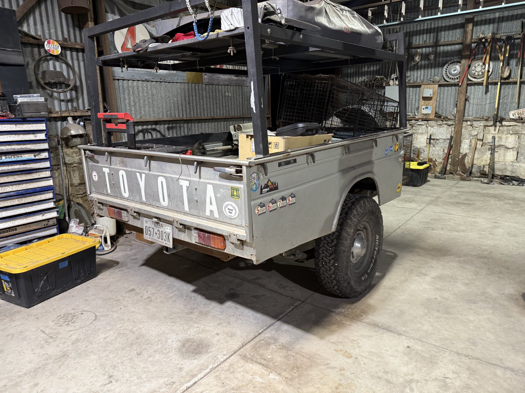

Something on my punch list since putting a Dobinsons lift on my truck this time last year was to put a lift on my camping trailer. When I built it I threw on a set of old 60 springs which I have several sets to choose from in my scrap pile. Both @BigHighBlue and I did the Dobinsons last year so both our OME systems were sitting in a 60 tub in the woods. I used a set of rear heavies and cut them from 9 leafs to 6 with the help of @LETSROLLEM who killed some time in the barn today. Turned out both my tongue and hitch are right at 24” from the ground now. Hooking it up will be the final test but even 1/2” off will be better than where I was with the trailer choppering down the highway.

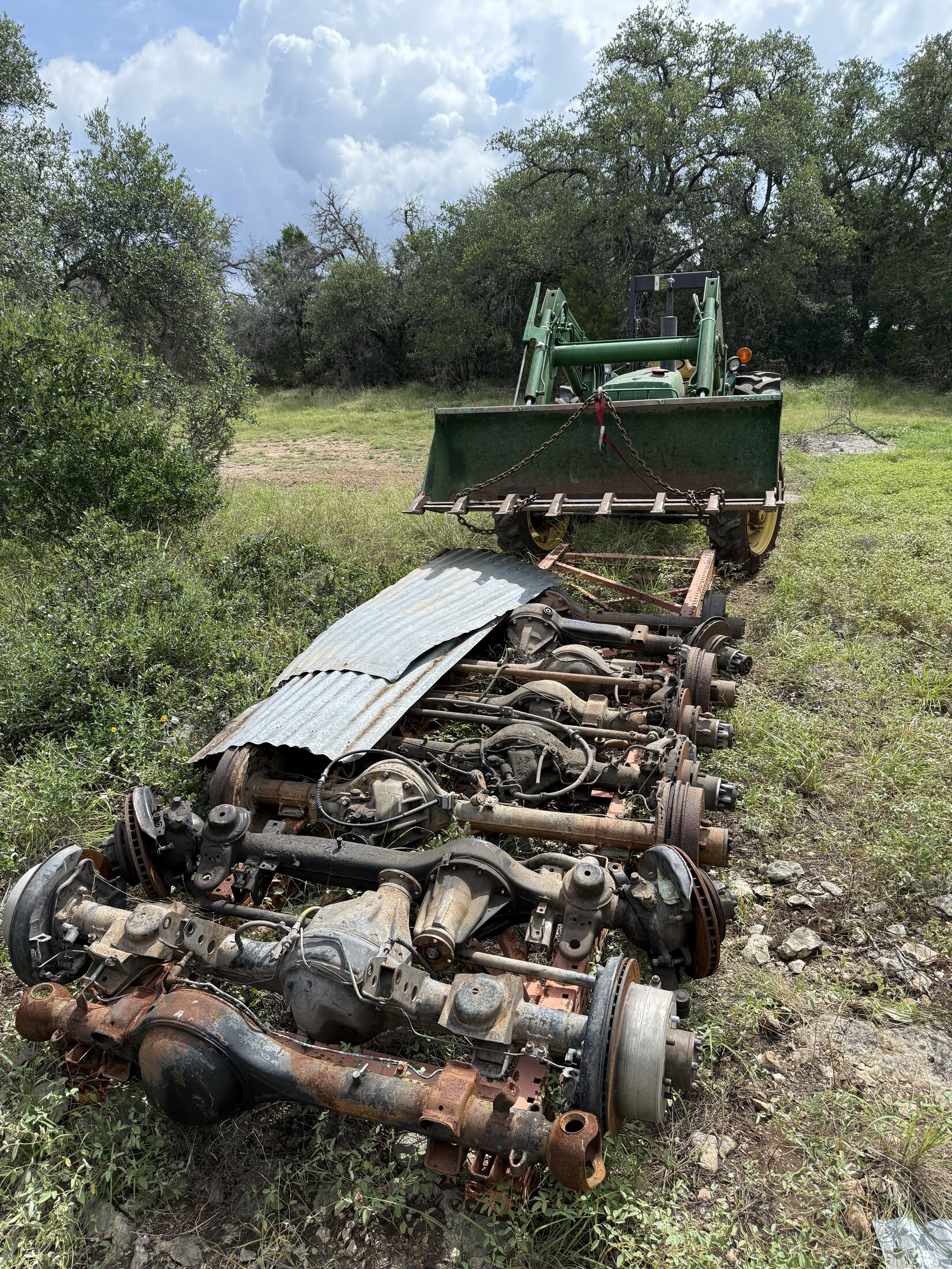

Yes sir. There’s a few cable sets in there. One set belongs to a good friend. The 80 axles are not locked. The set closest to the tractor are from a 70 series with the perch’s reset to accommodate the 40 frame. Gives me front disc, rear FF and the parking brake in the drum for a future 45 build. And they are actually factory locked housings. The previous owner kept the diffs though :(. I’ll find a solution for the day when I start that build.
