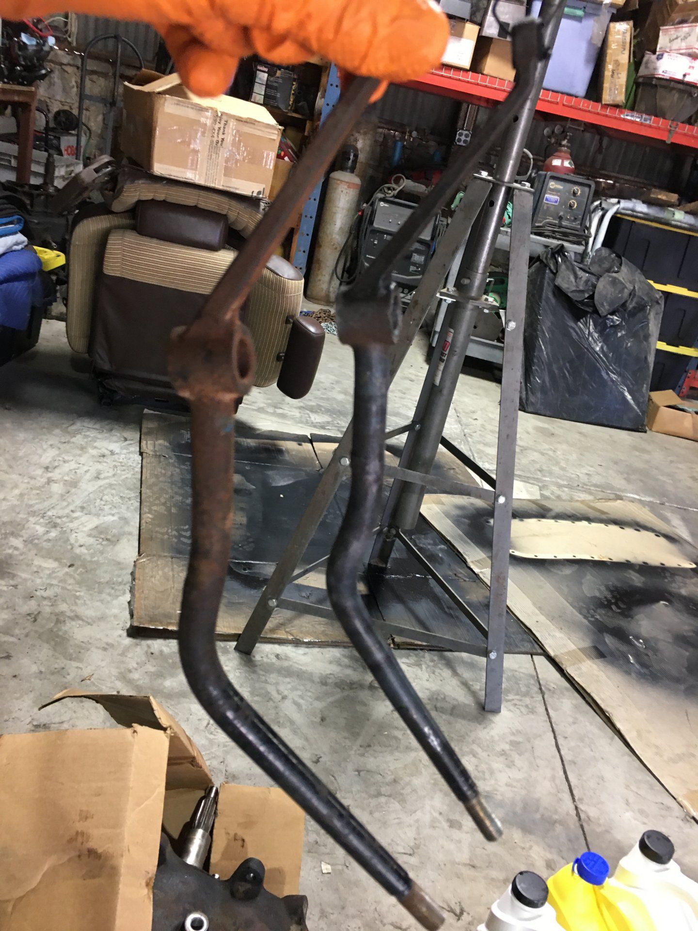

With the help of Coop we got the last non roller all dried in and steering. Actually, I was his shop bit*h :). Guy works faster than anyone I’ve seen.

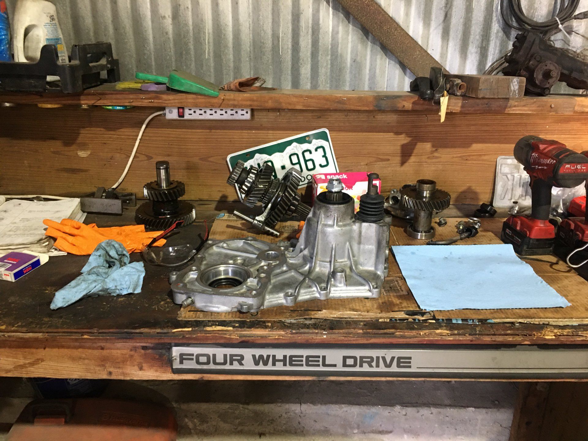

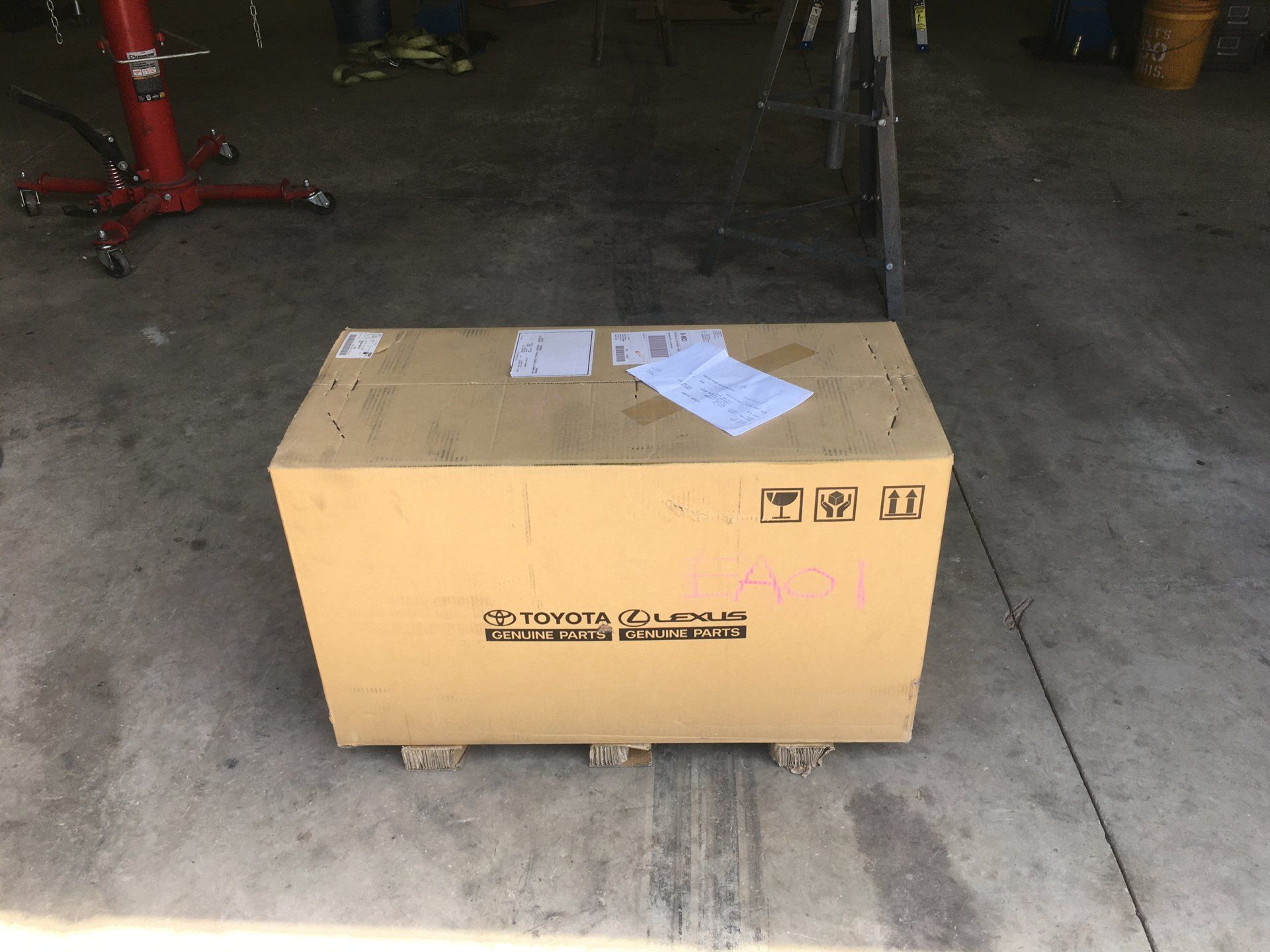

My brother @iCruiser drove his ultra clean 83 down from KC. Working through a 5-speed conversion. Should be a good experience as I’ve never done this on an early 60. Really don’t like that bracket/shield crap around the output shaft on the front driveshaft. Don’t see why I won’t be able to delete that for him. Really don’t want to finagle that back into place.

H55 conversion in the 83 was a success. Ended up using one of my T-case brackets off another 5-speed I have. Was able to heat and bend the T-case shifter so it’s about identical to the later one. One trick I figured out mating the back half of the T-Case was to use the old idler shaft as a guide (at least I’ve never seen this before). All the other cases I’ve done I always have to re-stab the case several times as the outside washer (that you stick to the inside with grease) seems to move once I lower the case and try to center the new idler shaft in the hole. Inevitably I am off center knocking the washer out of place as I can’t see it once I lower the case. If anyone else has this challenge then hopefully this trick will work for you as well. Doing this I nailed it on the first attempt. I’ve seen Georg’s video and he does enough of these jobs that he knows exactly where to clock the outer washer on the idler shaft eliminating the whole issue. Maybe when I grow up :).
Two weeks later with 1k miles added, new transmission still attached! Totally different experience driving the 800 miles back to KC with freshly installed H55. Averaged 61mph down and 72 mph on the way home hitting 80 mph occasionally when not paying attention. Nice work Jimmy!
