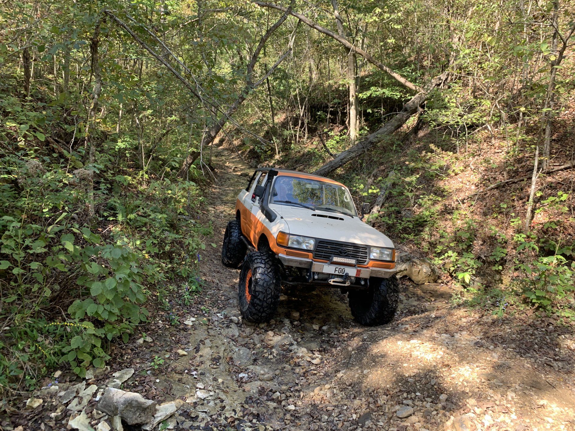

Guess I was driving too much to take some good action pictures.....

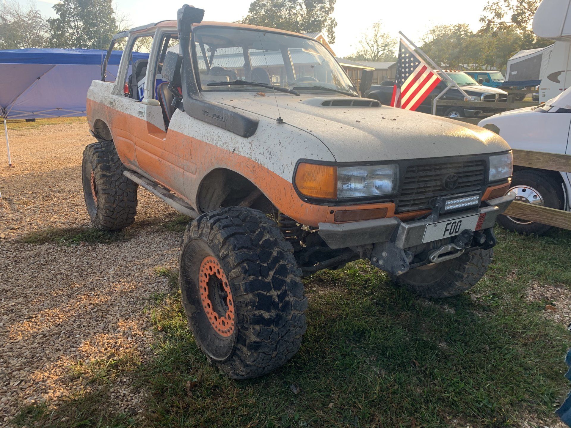

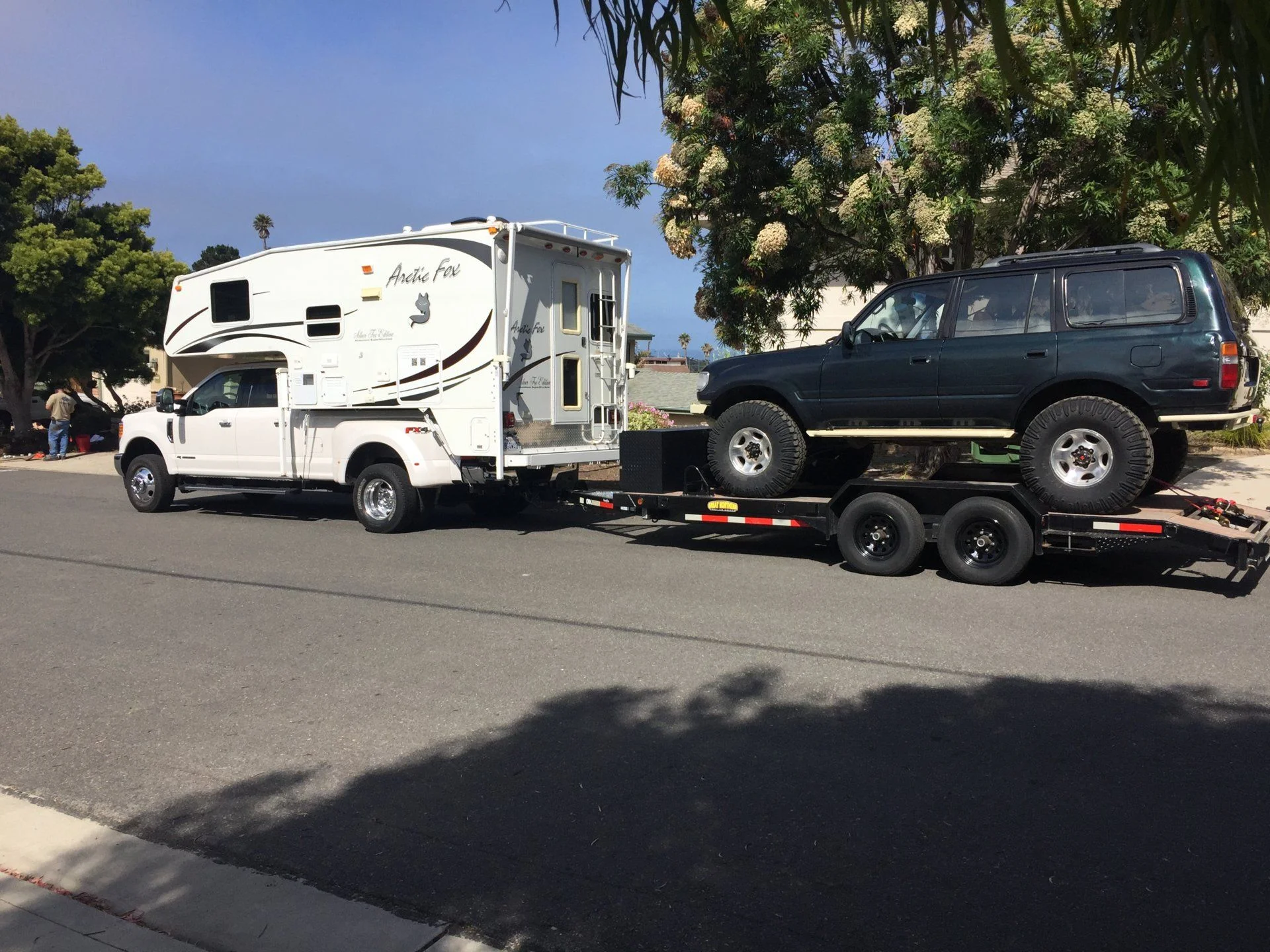

Lots of questions on why I use a trailer. Several reasons. Lets play with the scouting reasons....
1. We live about 3 hours from any good off road park. I like to wheel hard AND we wheel with people that wheel hard, so it is a safety net for my car and for friends. I have driven Foo back before and my friend used my truck to pull his injured rig back, so this is our way to have options. A scout it prepared! A scout is helpful!
2. My truck gets about 16 mpg pulling my rig that gets about 11mpg. I actually save money pulling it. A scout is thrifty.
3. When I wheel, I find that I take the harder trails when I know that the rig will only have to make it back to the trailer. In this immediate case, I pretzeled my steering arm (tie rod) trying to climb the waterfall at SMORR. Bottom line is that I am less concerned with damage. A scout is Brave.
4. In Foo's case, it's max speed is just over 45MPH. Just not safe on a highway for the others on the road. A scout is courteous and Kind! Probably illegal too. A scout is obedient!
5. Finally weather is the final point. When you have a roadster.... this is not a convertible as the top does not pop back on... you are exposed to the elements. I have to work to afford this addiction, so I can't hang out waiting for Kansas/Missouri weather to clear up.... A scout is clean (not soaking wet).

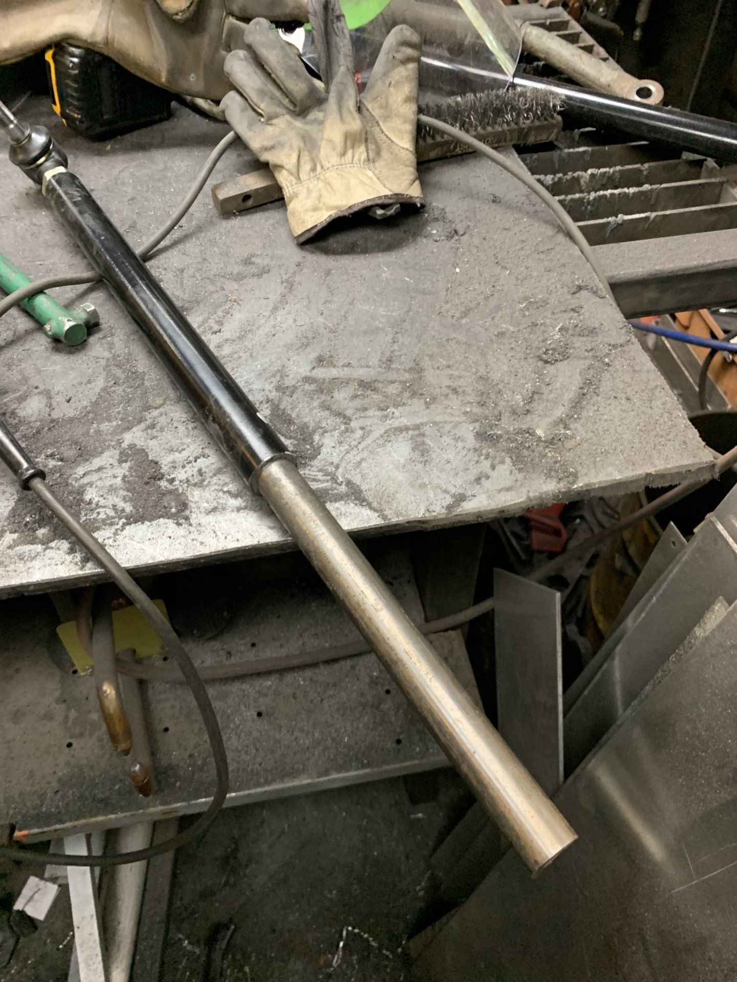

Straightish....

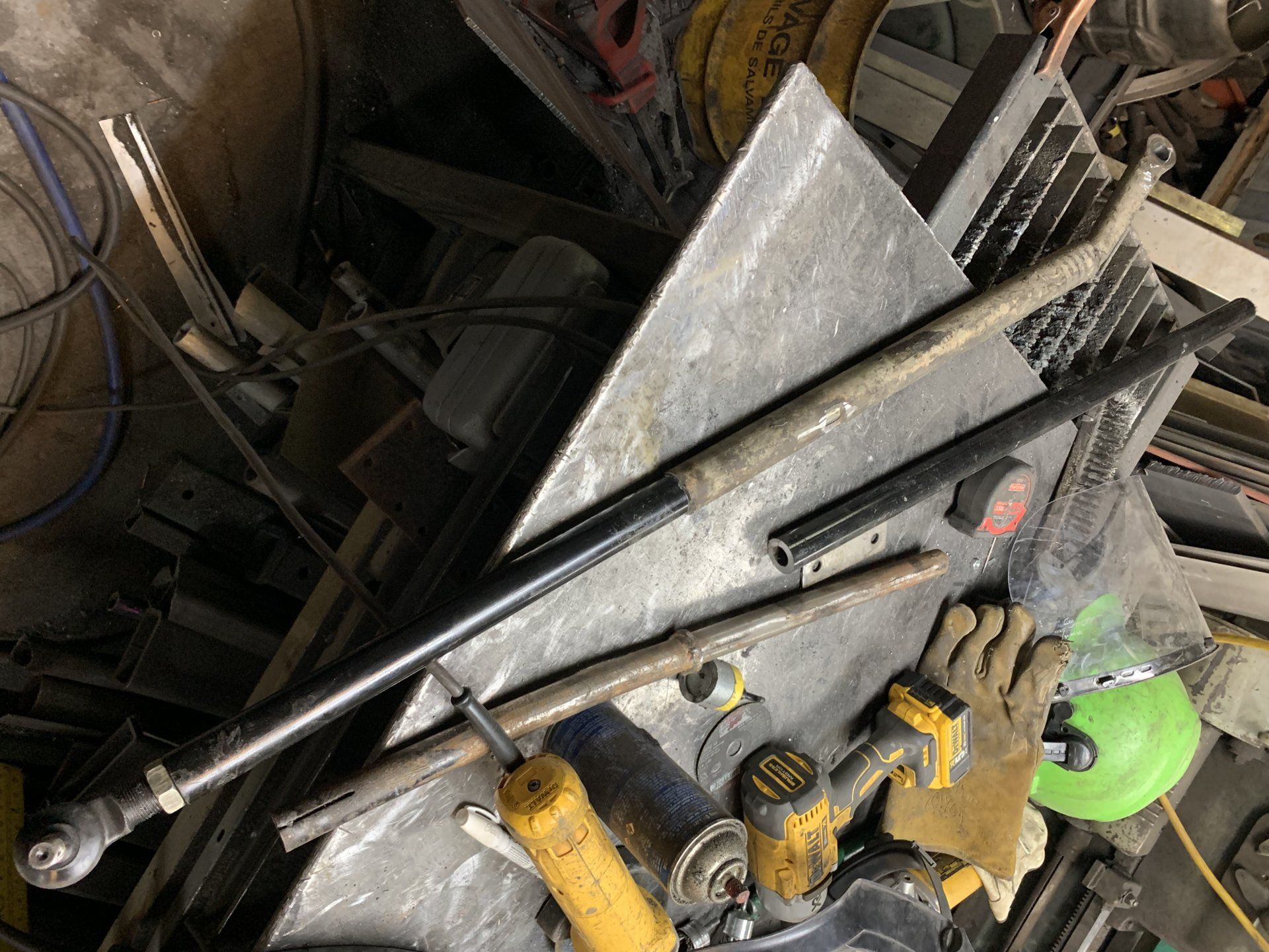

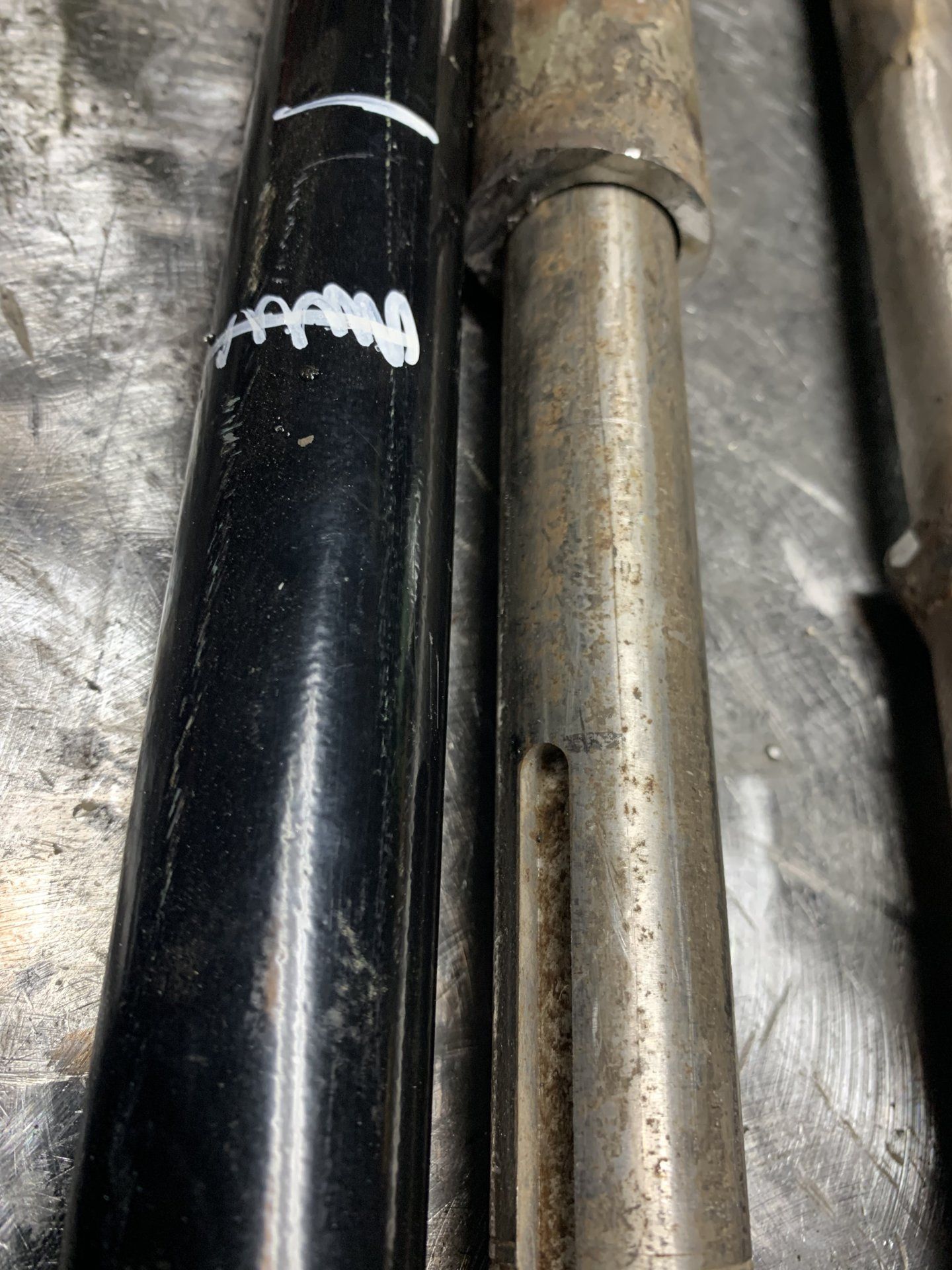

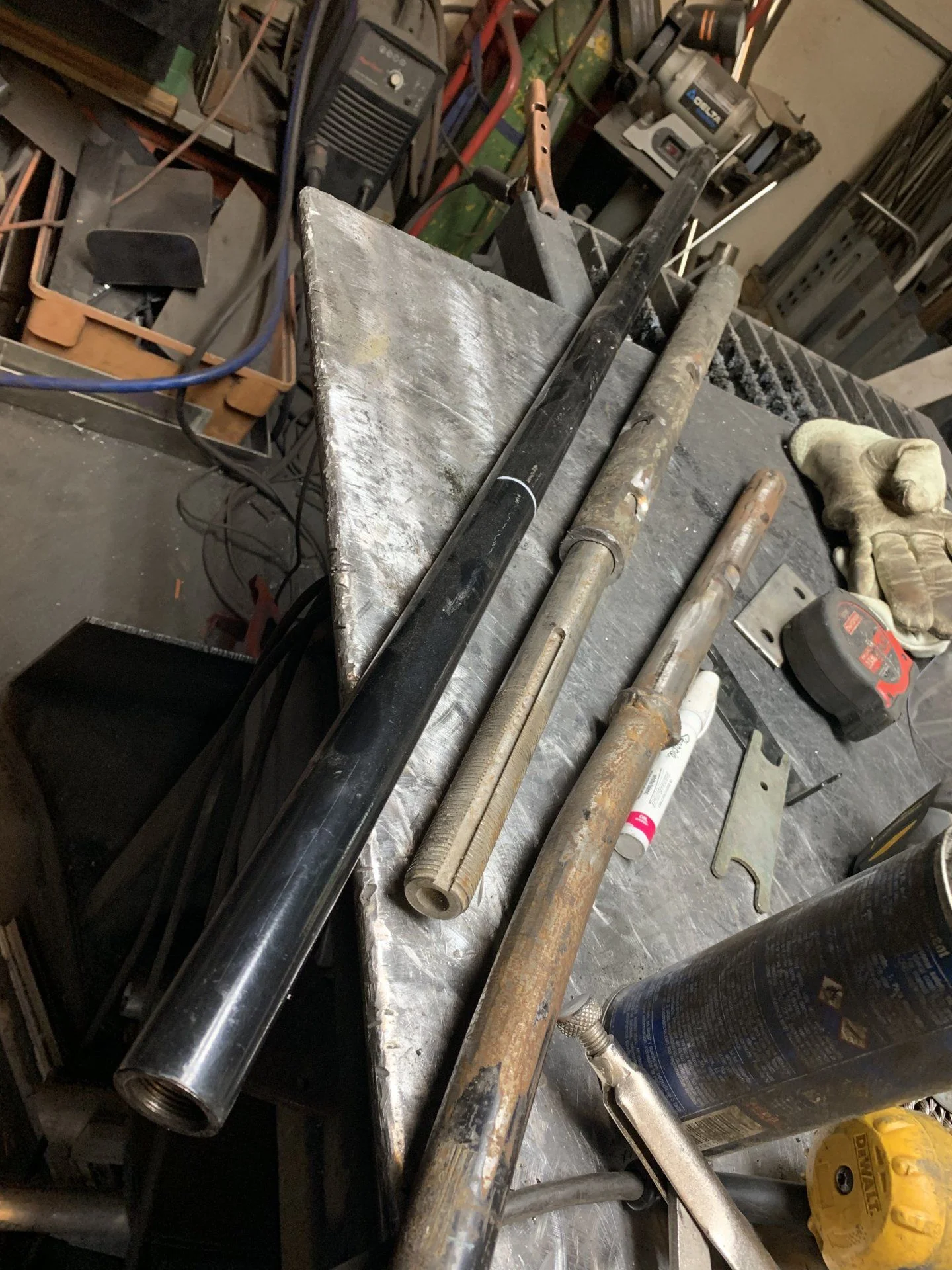

I have an idea on the tire rod.....
So the Volvo original tire rod end is DOM quarter inch wall 1 inch ID.... I have a heavy duty drag link that has about .8 ID

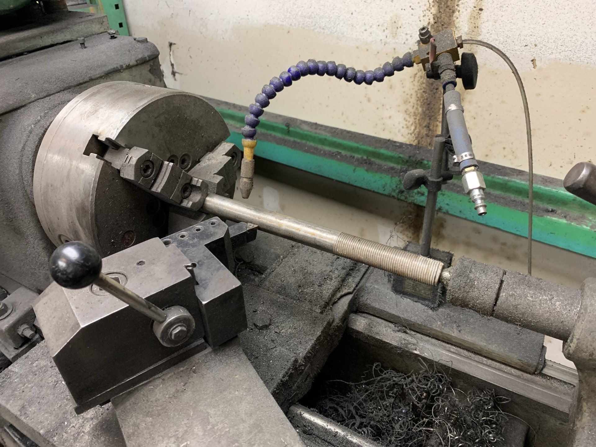

I have some 1 inch solid stainless steel that I’m thinking about putting inside of the Volvo and inside of this drag link. I will have to chuck it up in my lathe and mill it down to .8 inch OD for the side that will go inside of the new smaller section.
What does the peanut gallery say? Will that work or do I need to plan on sleeve in the outside also?

You're going to turn down a 3-4 foot 1" stainless rod to .8"? I'd just make a new tie rod altogether.
No, just a foot. The half sliding in the Volvo side is the correct od. To be clear, because of the end that attaches to the Volvo portal axle, really can’t make a new one. It has a specific bend to the end to work around the portal scrub

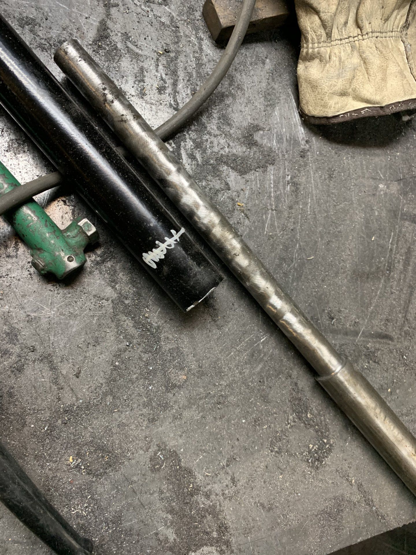

I preheated tube before TIG welding and use stainless rod. Took a lot of heat, and my machine isn’t rated for more than 10 minutes per hour Burning in that hot.... ended up pretty good, can always put a DOM sleeve over that joint.... however, don’t see how this will bend very easily... that trail gear DOM was pretty thick walled!!!! Only three-quarter inch ID... next up is I think I figured out how I can add Hydro assist... going to be a basically a skid plate

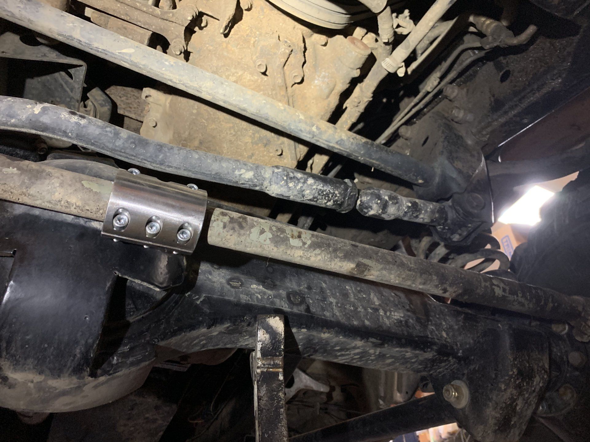

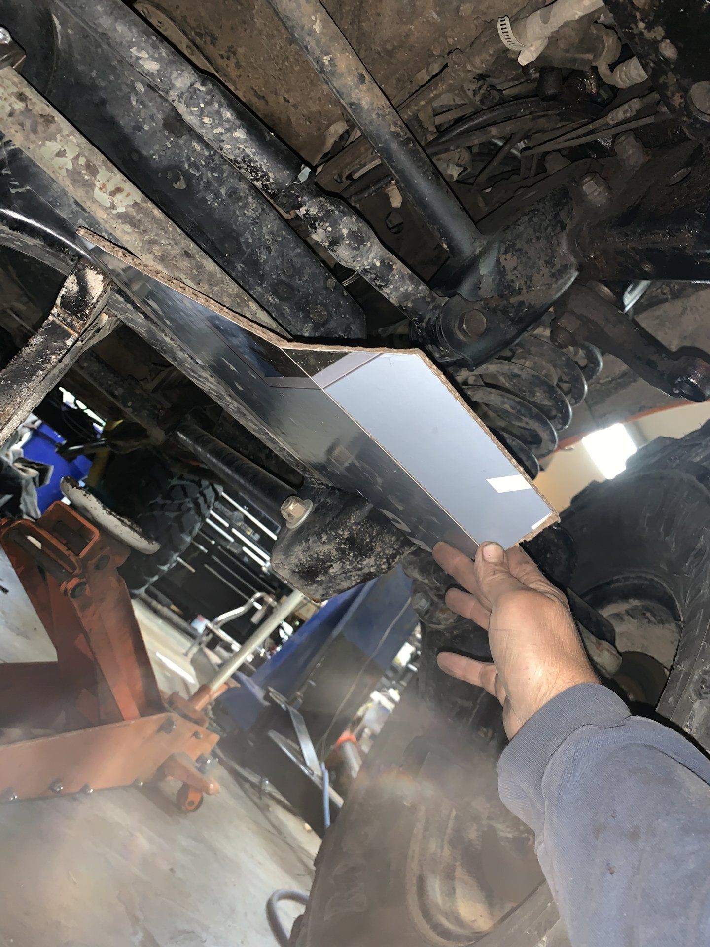

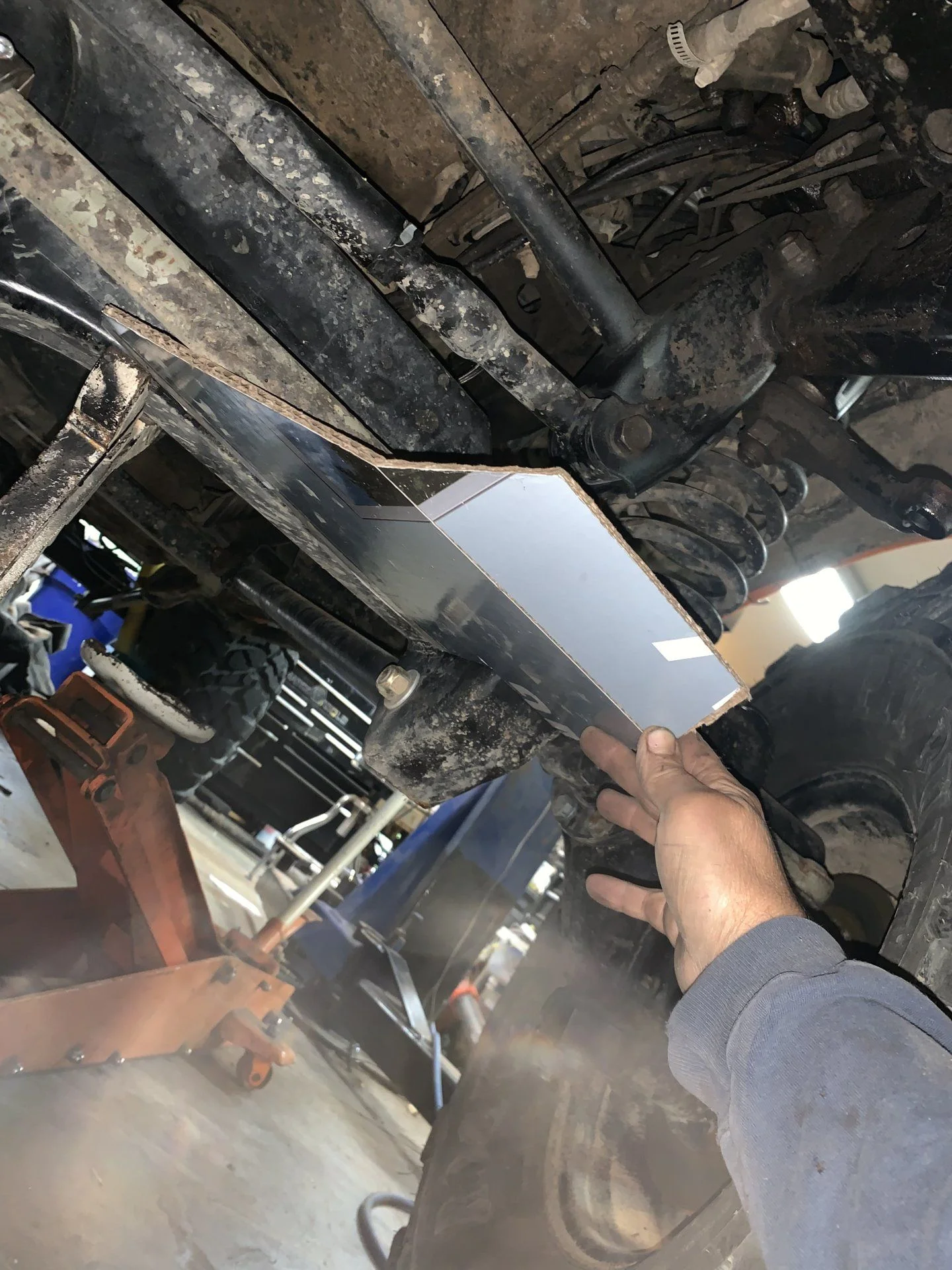

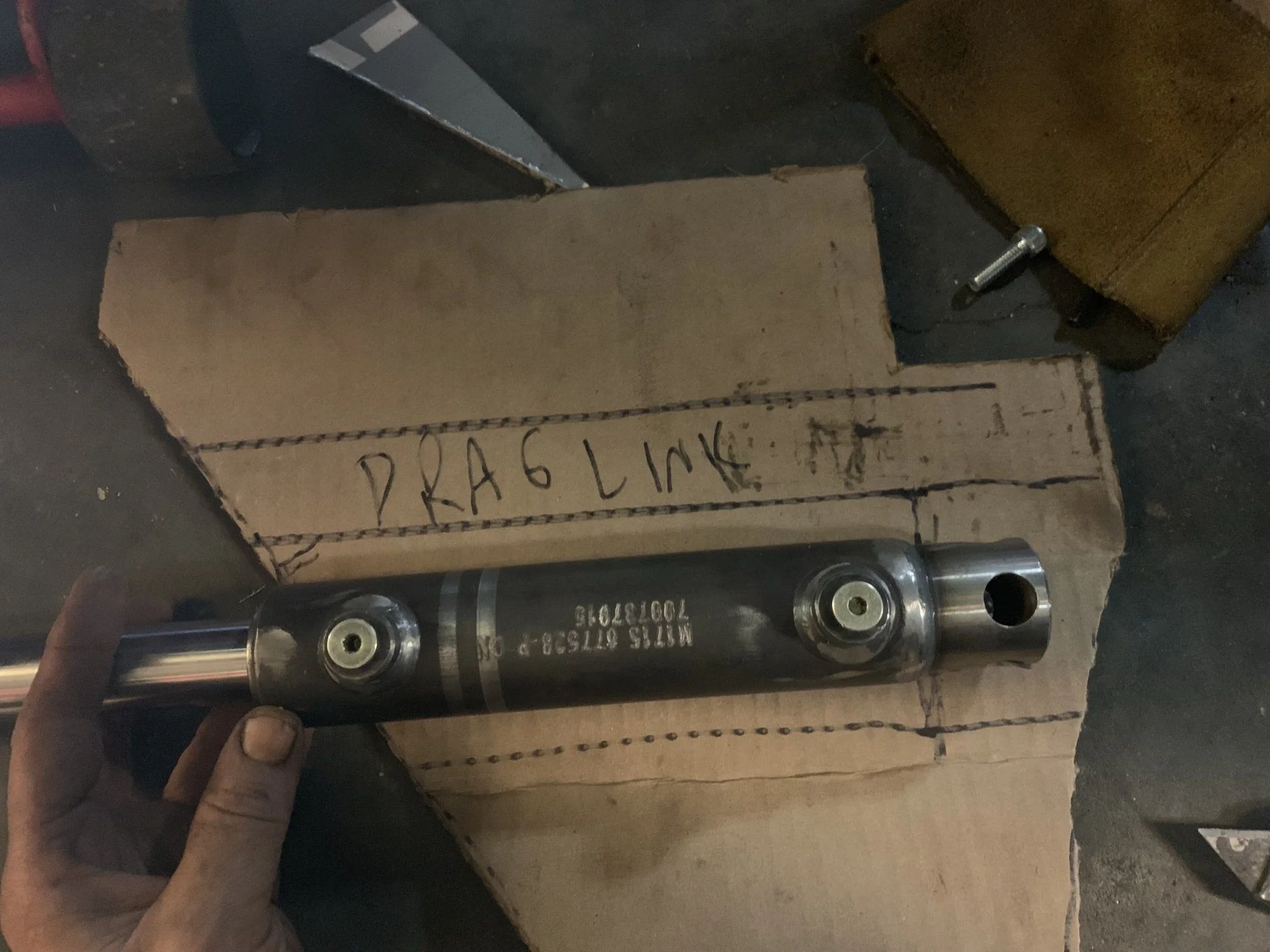

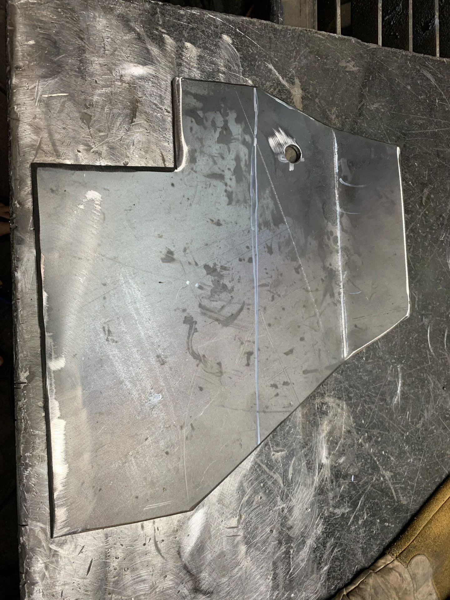

OK, here is my plan to be able to add Hydro assist. The only spot I can have the ram is in front of the drag link so making a big plate for the bottom and then a smaller plate for the top and brace them together First picture you can see where I’ve bought a clamp the right od for the Volvo stock drag link. Recall this is 1.4” od. 1/4 wall dom.

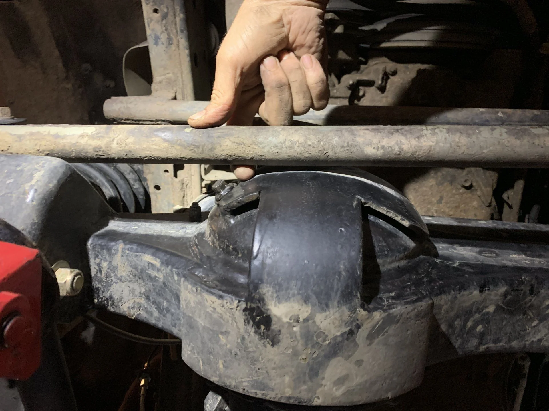

There is 1/4” clearance behind the differential to the drag link
Here is an image of the cardboard cut out coming from the bottom of the axle out pass the drag link

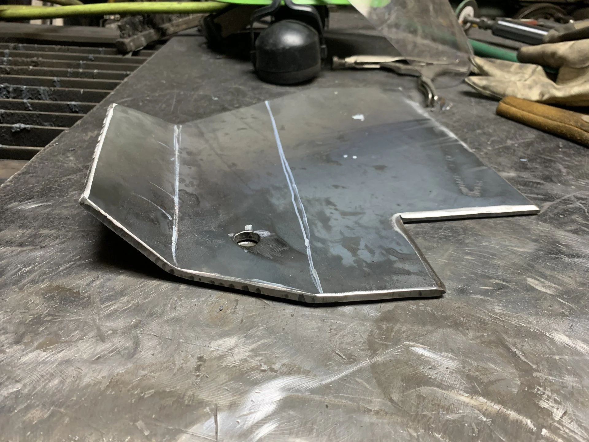

Then do a slight bend on the front to act like a sort of skid plate
Main piece cut
