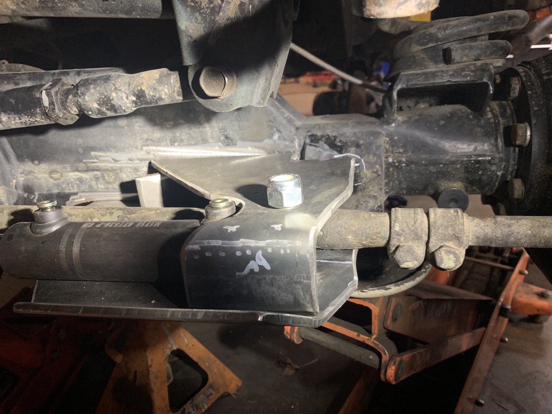

Yes, I tend to overbuild..... GUILTY. I built a deck years ago and the building inspector said the house would blow over before the deck ever moved. As I am typing this I am trying to figure out how I can brace this bracket for the ram so if it ever hits a rock, it won't bend up. Again overbuild the snot out of it....

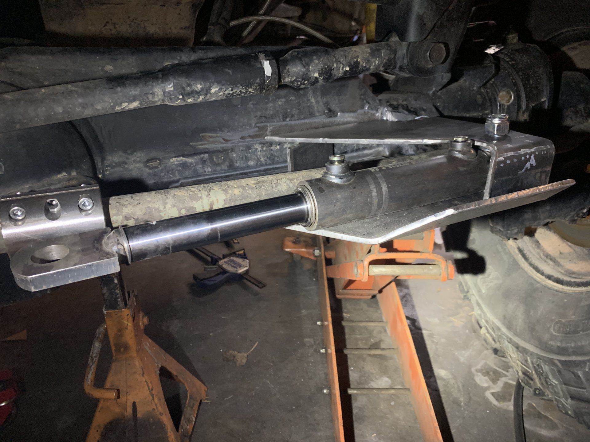

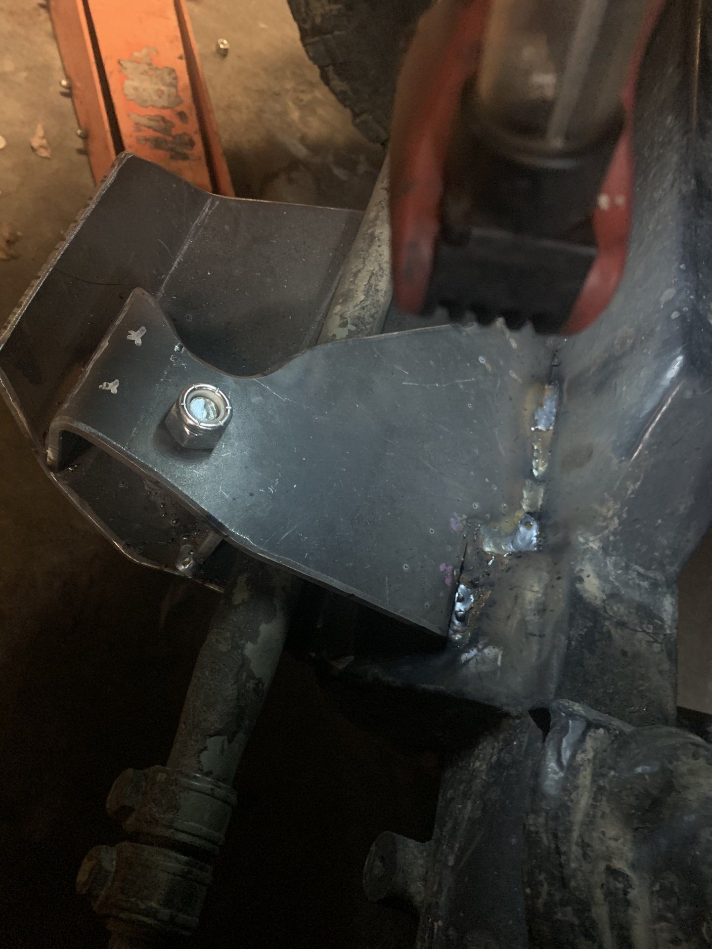

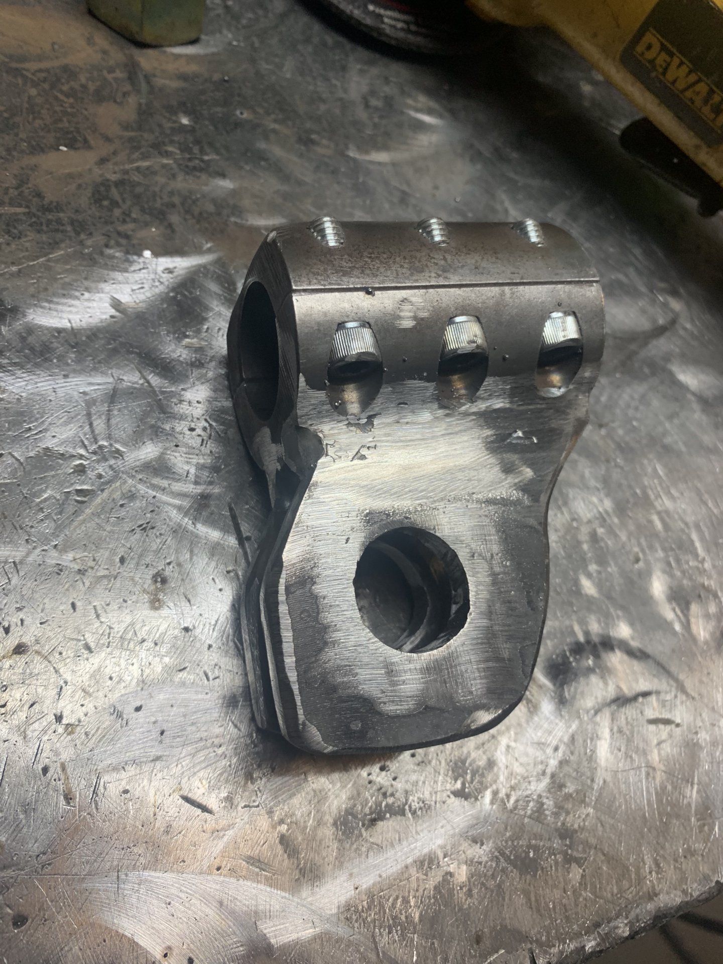

Progress. Got the bottom plate tacked in place then started working on the top plate. Ended up bending the front edge of it down 99 degrees and will weld it to the bottom plate. I will also add spacers to add additional bracing to the front axle tube welded to the plates
Looking good, do you have a brake for bending the plate ?

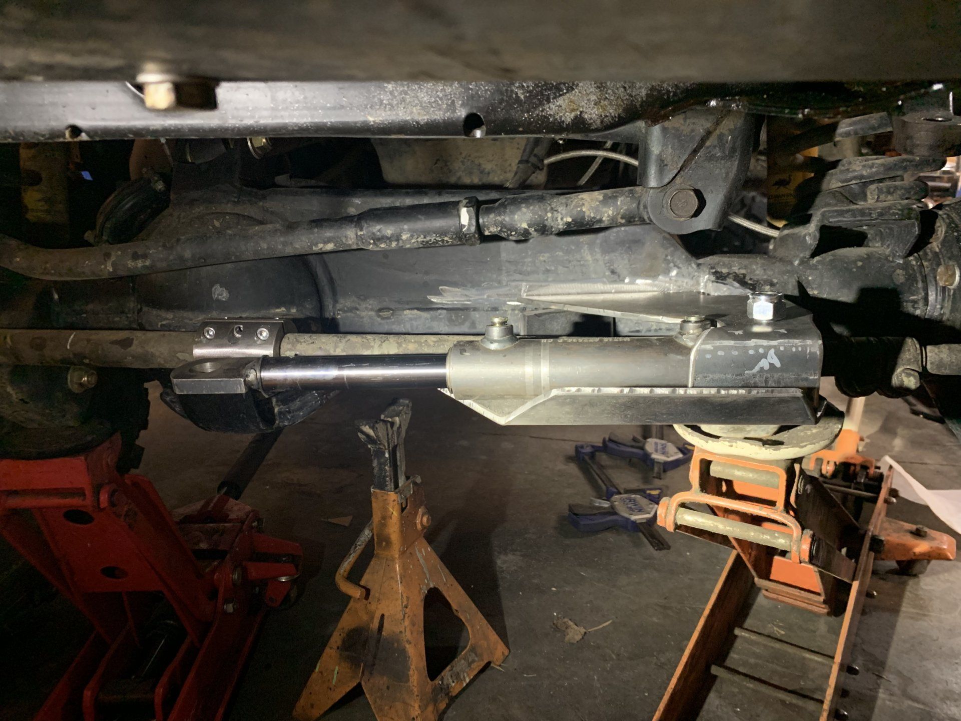

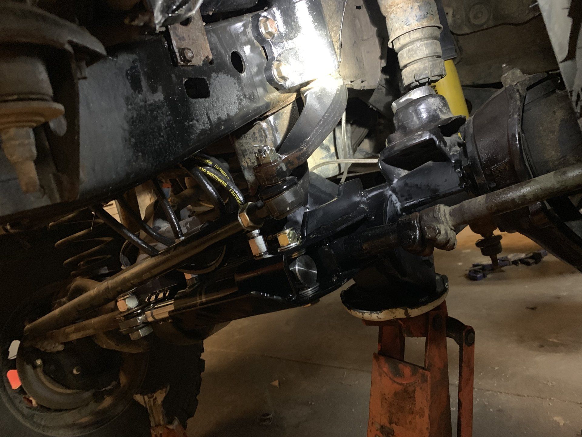

Before I burn this in forever, I need to put the drag link back on and pull the springs and check for clearance.
Nice I half to heat with a torch and beat with a hammer
That little press brake made out of scrap steel has been one of the best little things in my shop.... I just made a dimple die for it to make floor panels. Only issue is the width of the press.
We have clearance from Clarence.... 1/16 inch.
Just following along, That looks to close to me. when the bump stop compress you may have contact. When I set mine up I thought I had plenty of clearance, and there was for rock crawling but when I went to the dunes the bump stop compressed enough to put the ram into the oil pan severing the hydro line and puting a hole in the pan. And put a end to my wheeling day.
Just following along, That looks to close to me. when the bump stop compress you may have contact. When I set mine up I thought I had plenty of clearance, and there was for rock crawling but when I went to the dunes the bump stop compressed enough to put the ram into the oil pan severing the hydro line and puting a hole in the pan. And put a ned to my wheeling day.
Good point. As I have no other way to go with the ram, I was thinking about adding to the bump stop to limit that chance.... you just solidified that need.

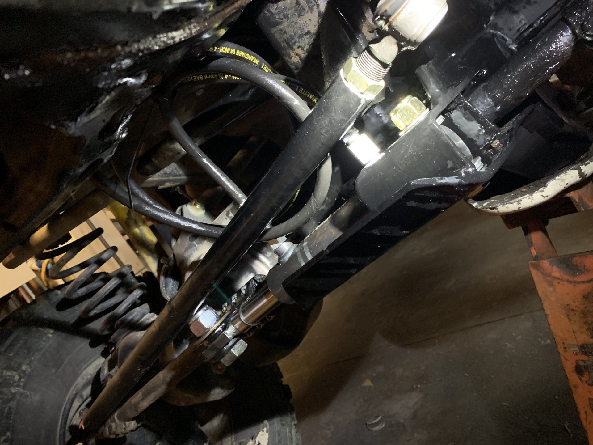

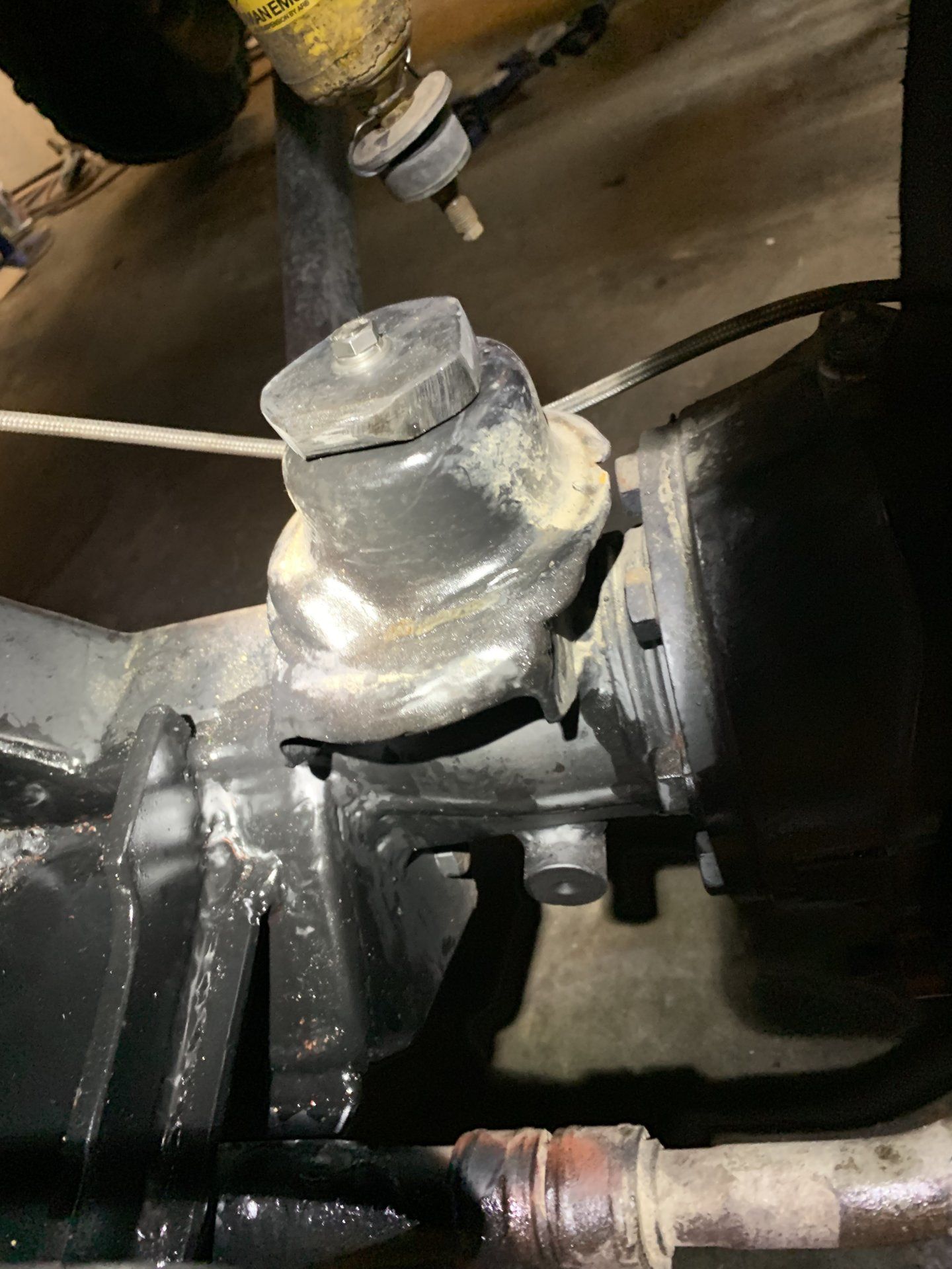

Rebuilt the power steering gearbox....thanks @StucknKS
Replaced the pump also, so everything is new on the steering system..... got the ram installed, and we have Hydro assist steering !!!
I’m a little worried about the hoses, there’s about an inch of clearance on each side of them. Definitely need to figure out how to make sure they never get bound up in all of the moving parts...
Add a half inch spacer to the Front left side for insurance that it will never hit anything

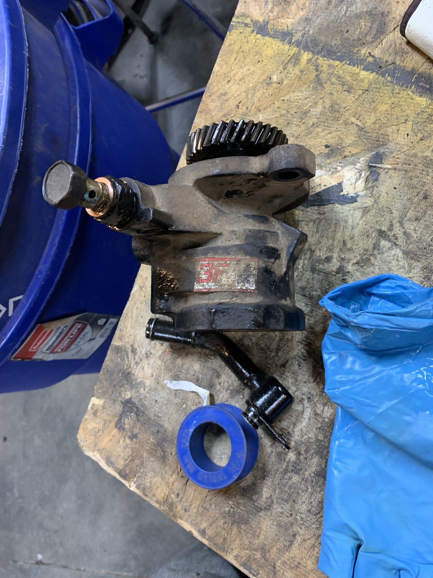

Here’s the not so old pump that was ruined by running those 40 inch tires for a weekend without Hydro....

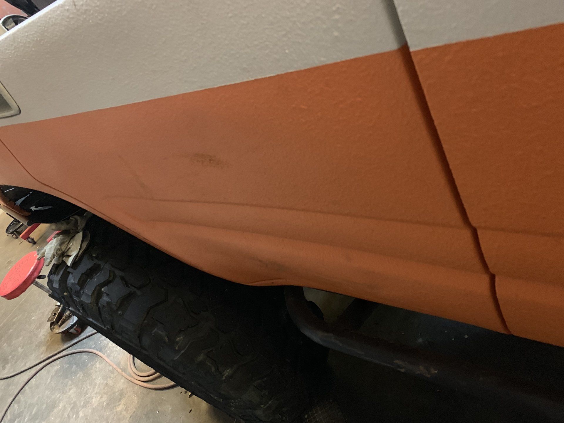

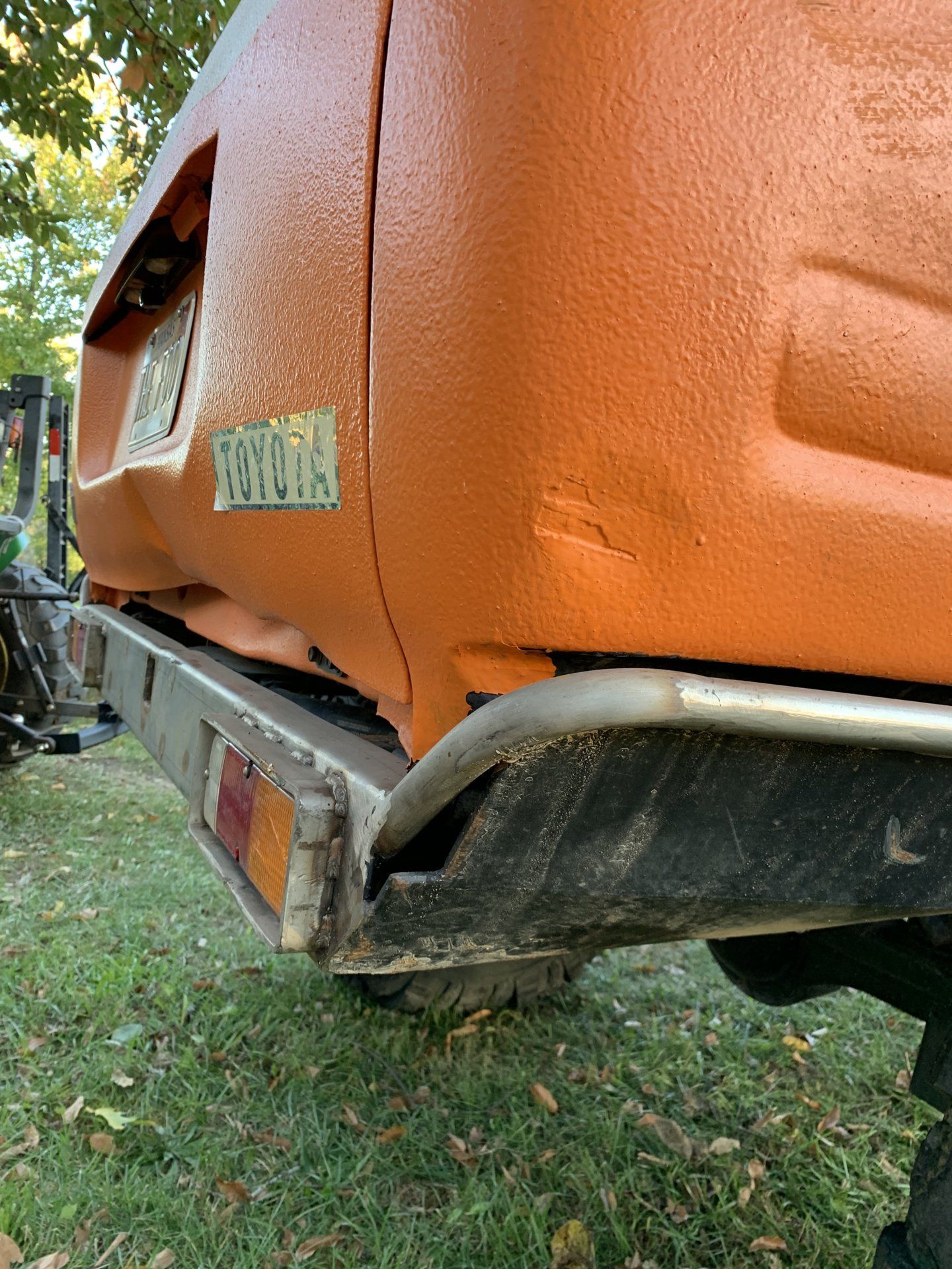

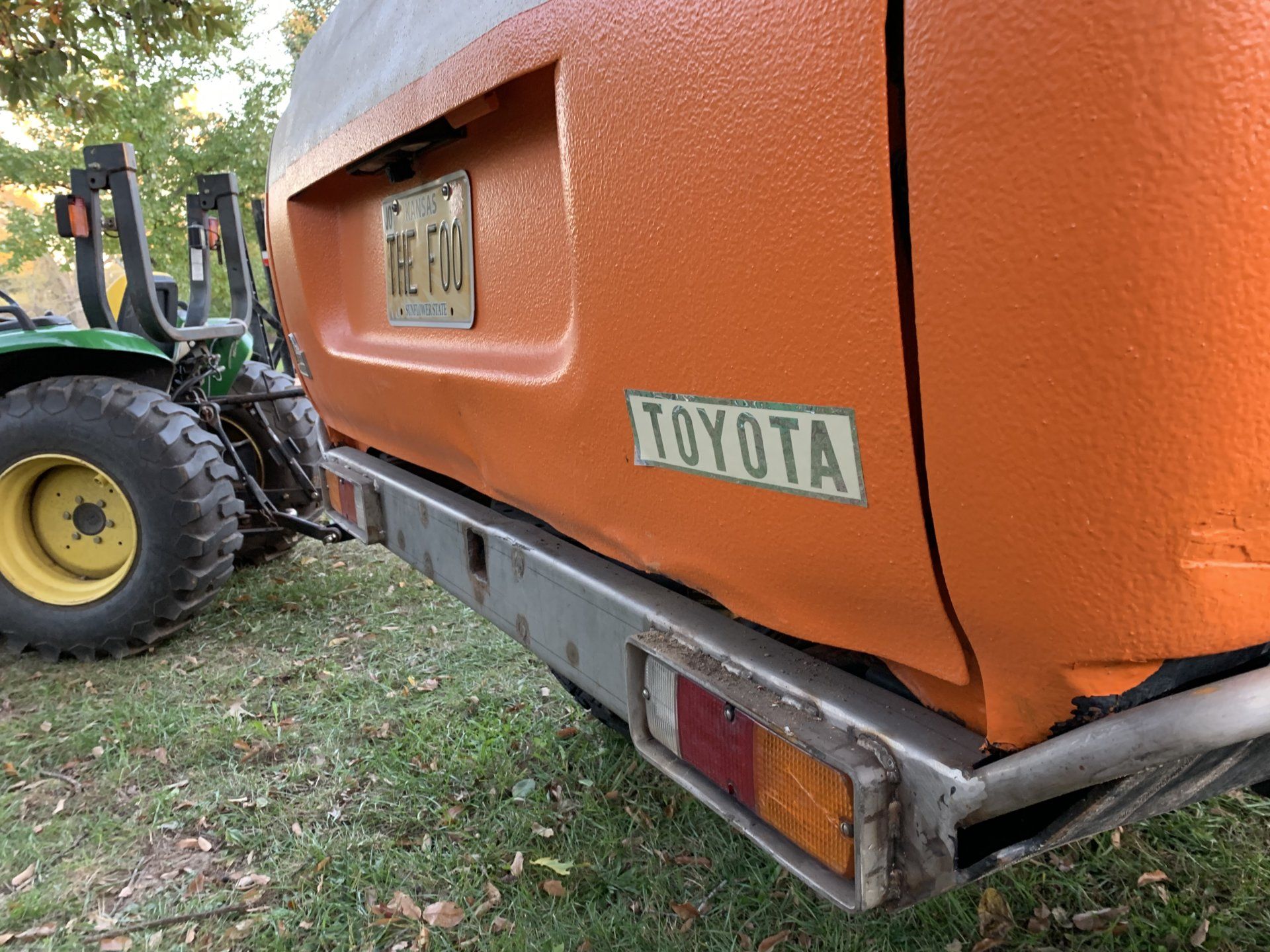

We slid down and hit the rear door on rocker knocker at Smorr a few weeks ago.... gotta love monstaliner, hit everything out and looks great..

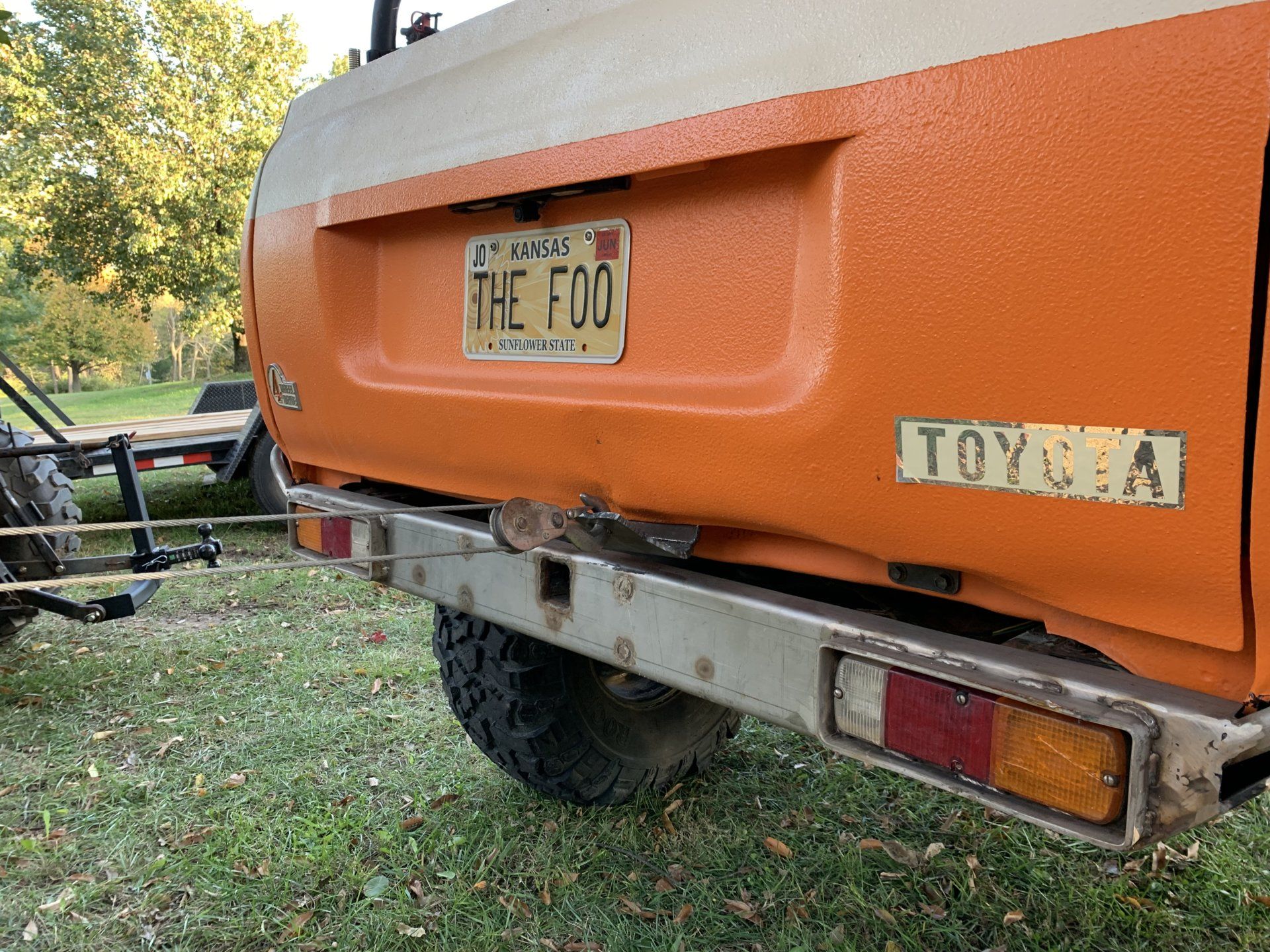

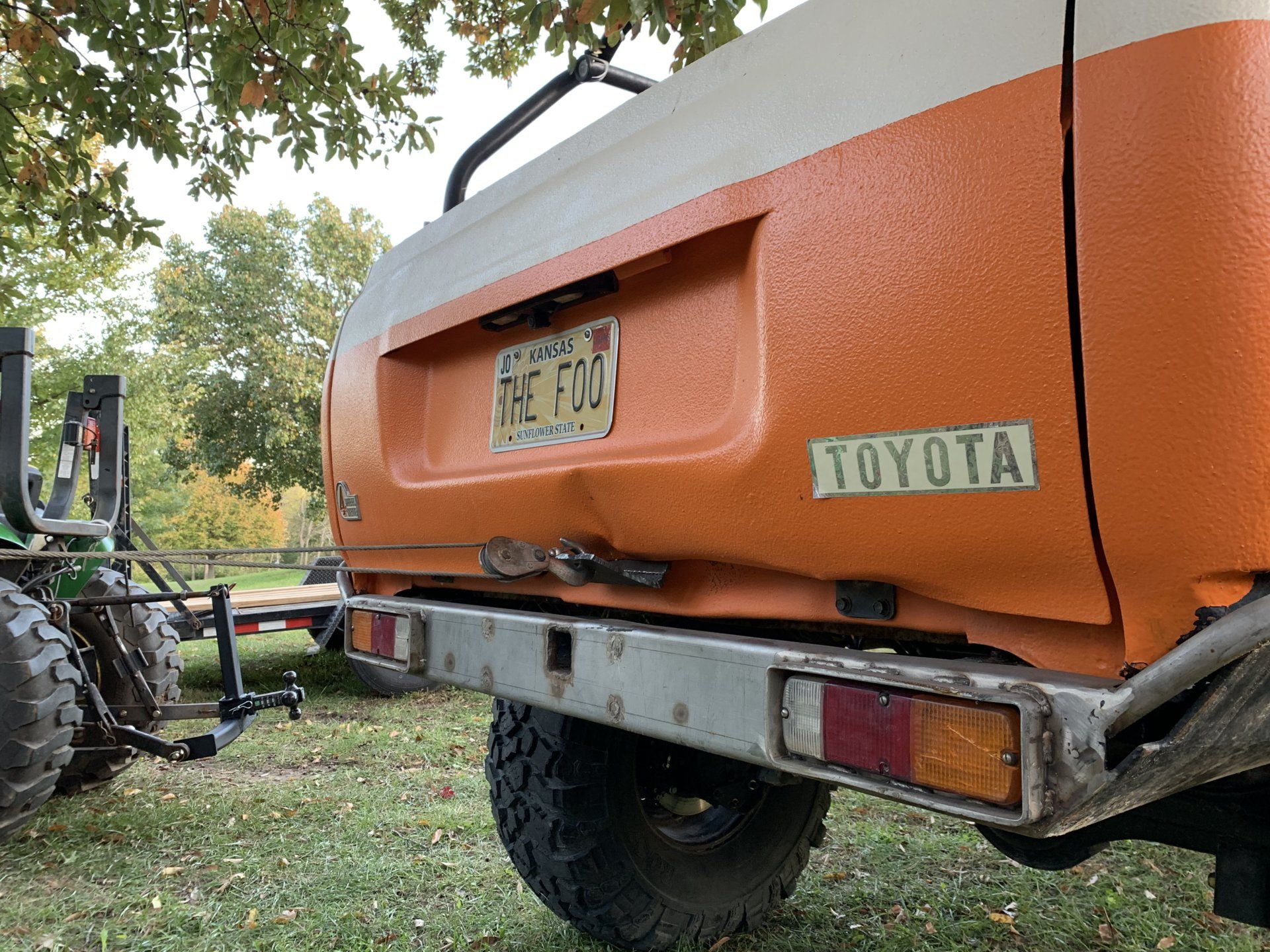

More bodywork... had a close encounter with a 80 io the trails.
That tree has pulled out so many bumpers and body panels!

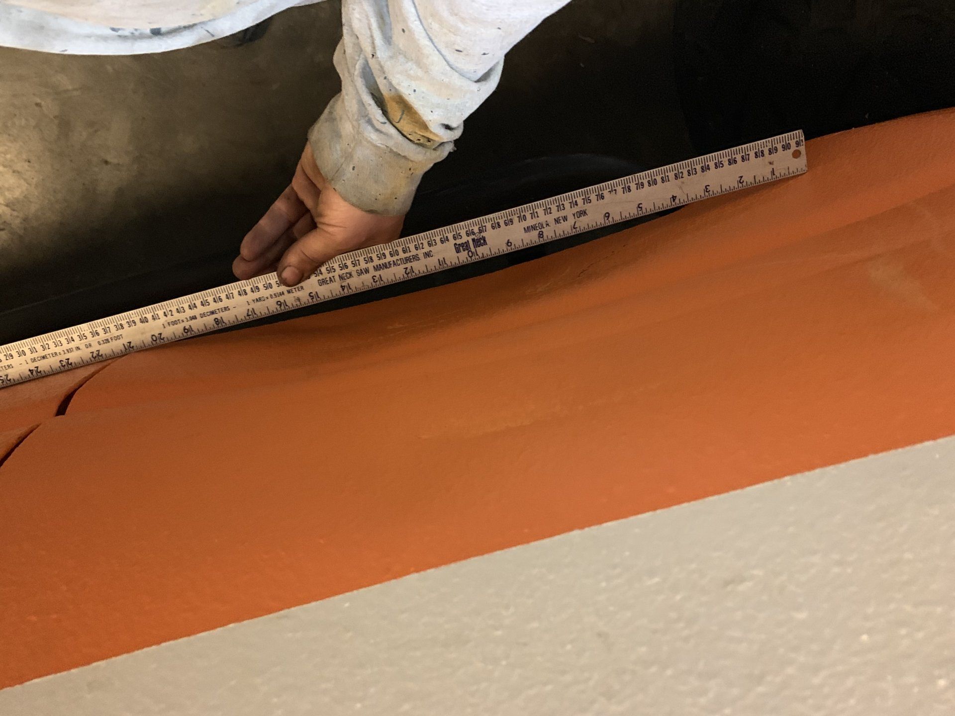

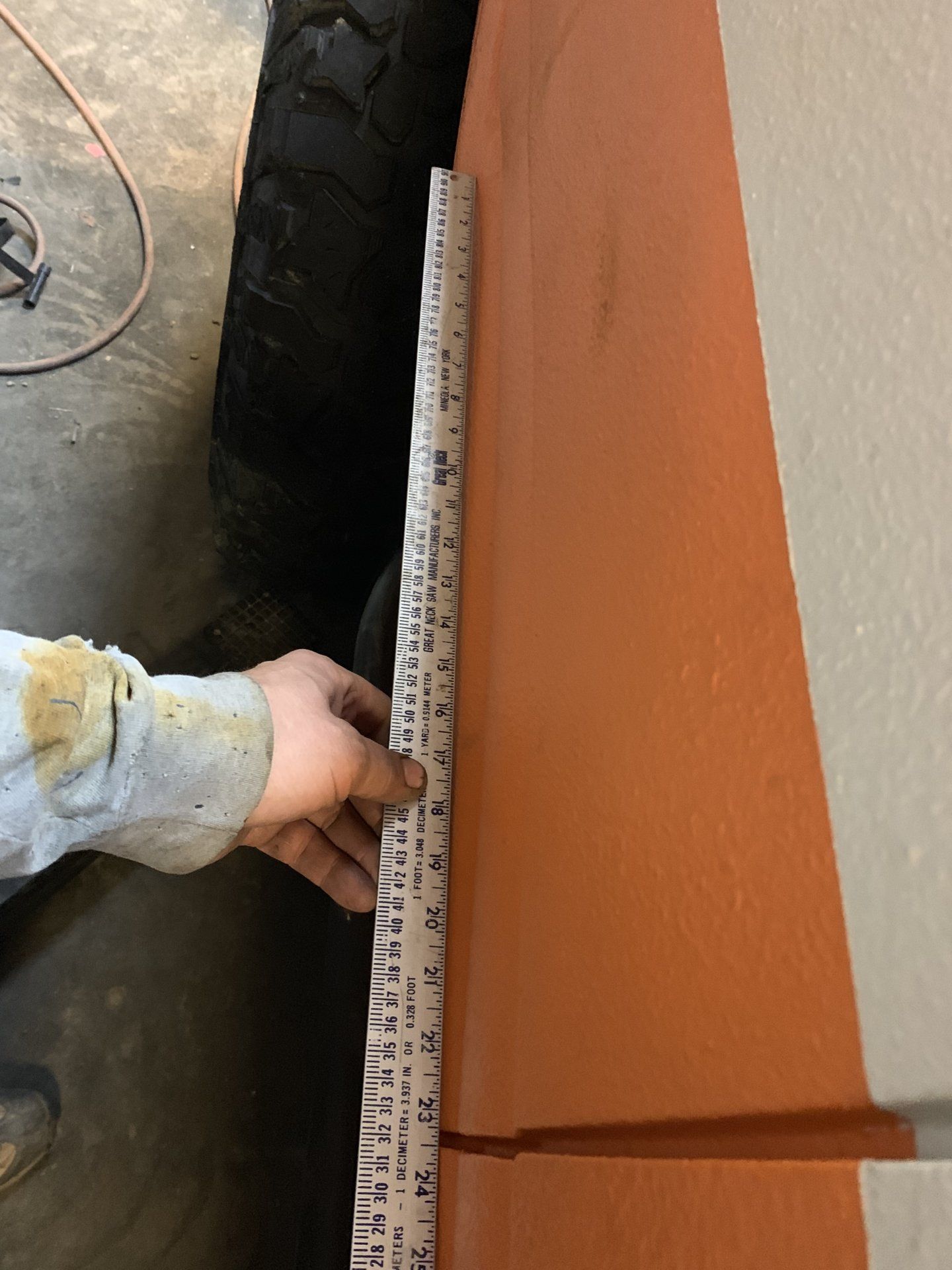

scary part was that I could not get the right angle clamp in the area I needed it, so I just fabbed up a puller.... It did not clamp down, so I shortened up the come-along, to increase power and lower the chance of it flying off....
Here is the clamp I bought that would not fit for this project.
