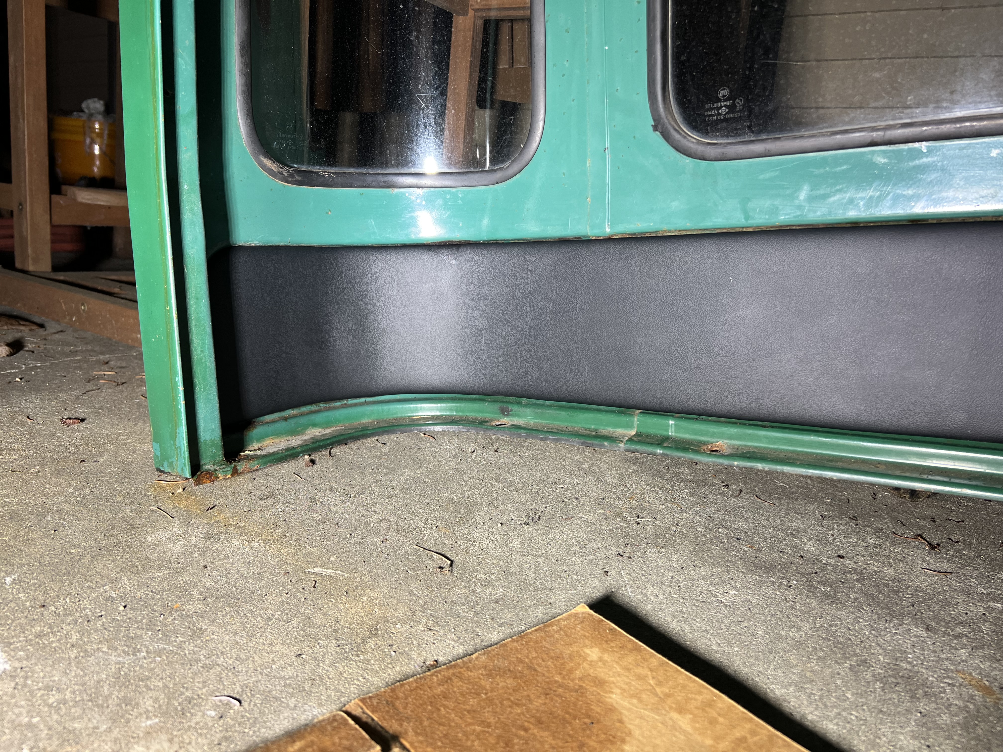

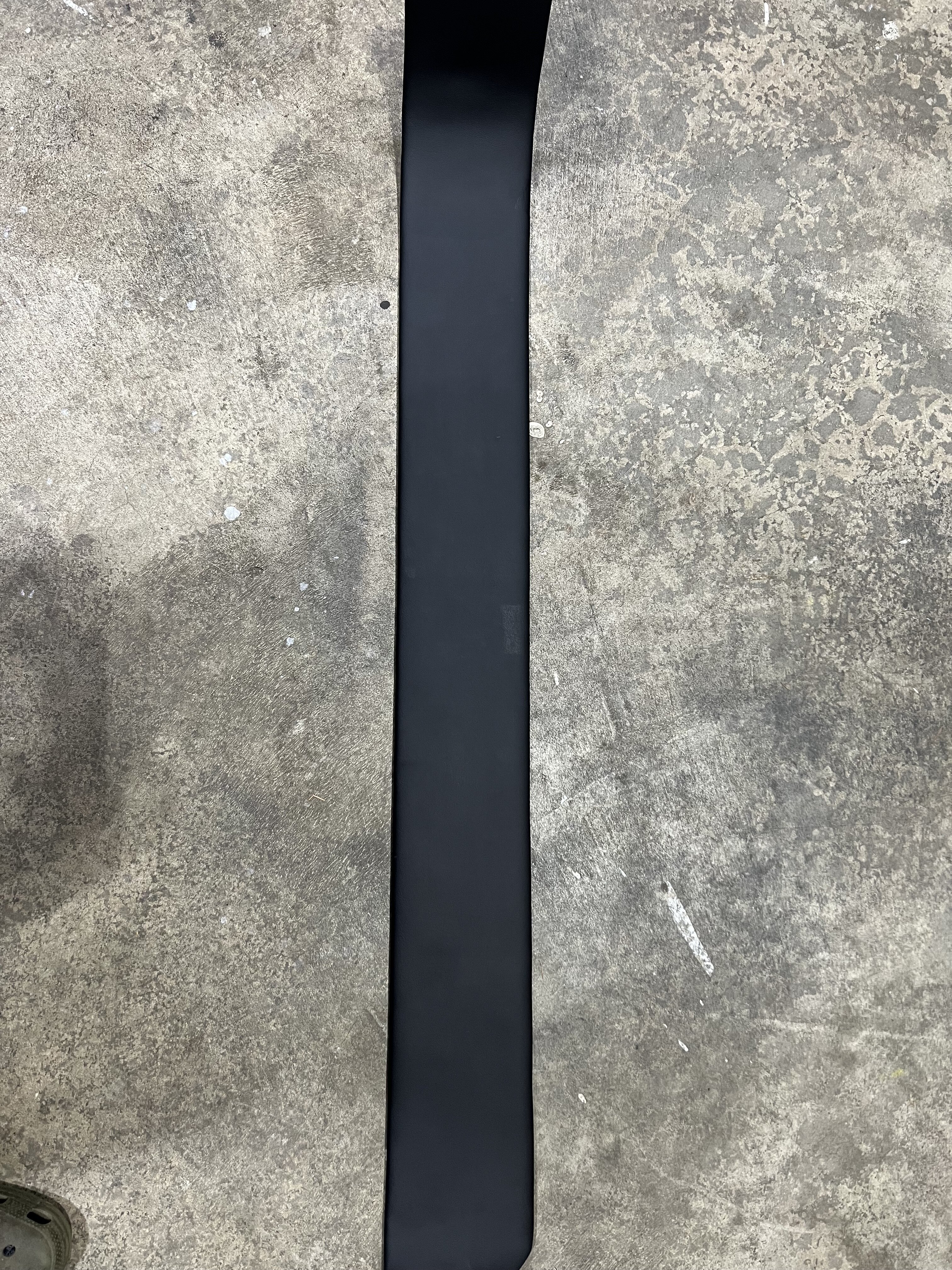

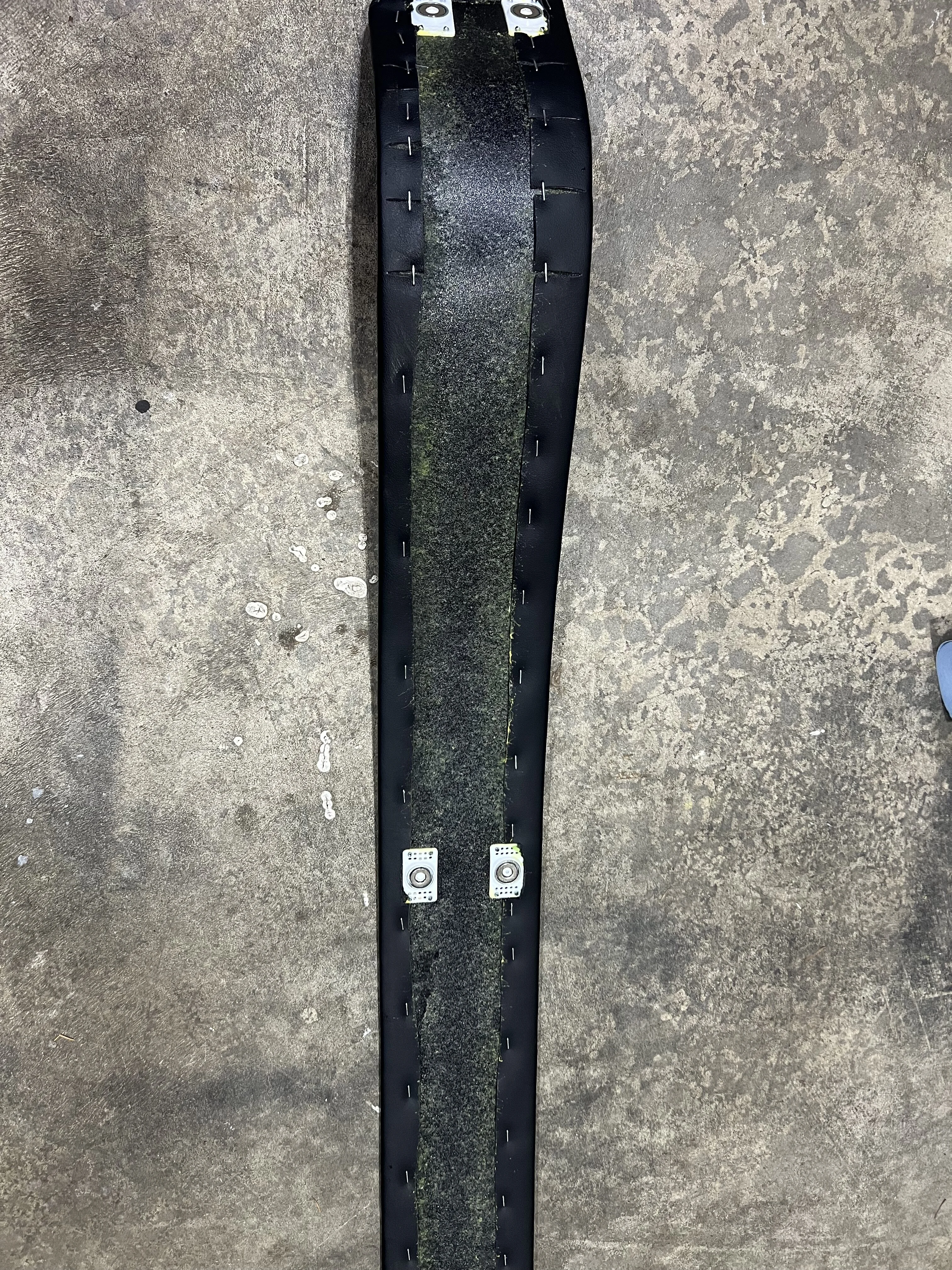

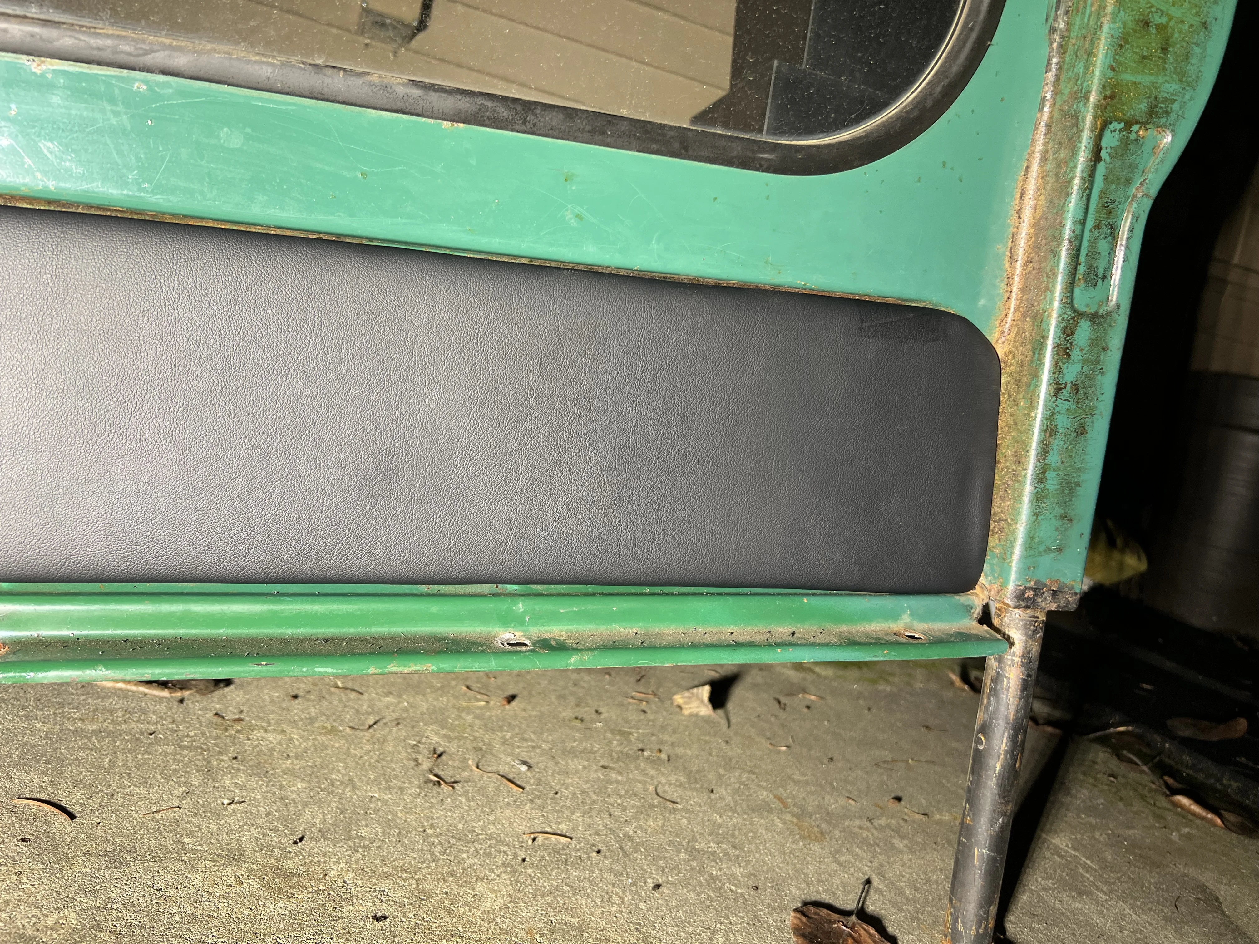

After a long mental block, I’ve finally finished my trim pieces for the top. I really need my garage back, but the tops off my FJ40 and the roll cage is preventing me from fitting these trim pieces.
Here is the finished product, sorry for the dark pics as the top is out in the dark.
The backer has magnets that hold it firmly in place.
I bought the material from Corbeau so it’s a match to my seats.
Door panels are next.
