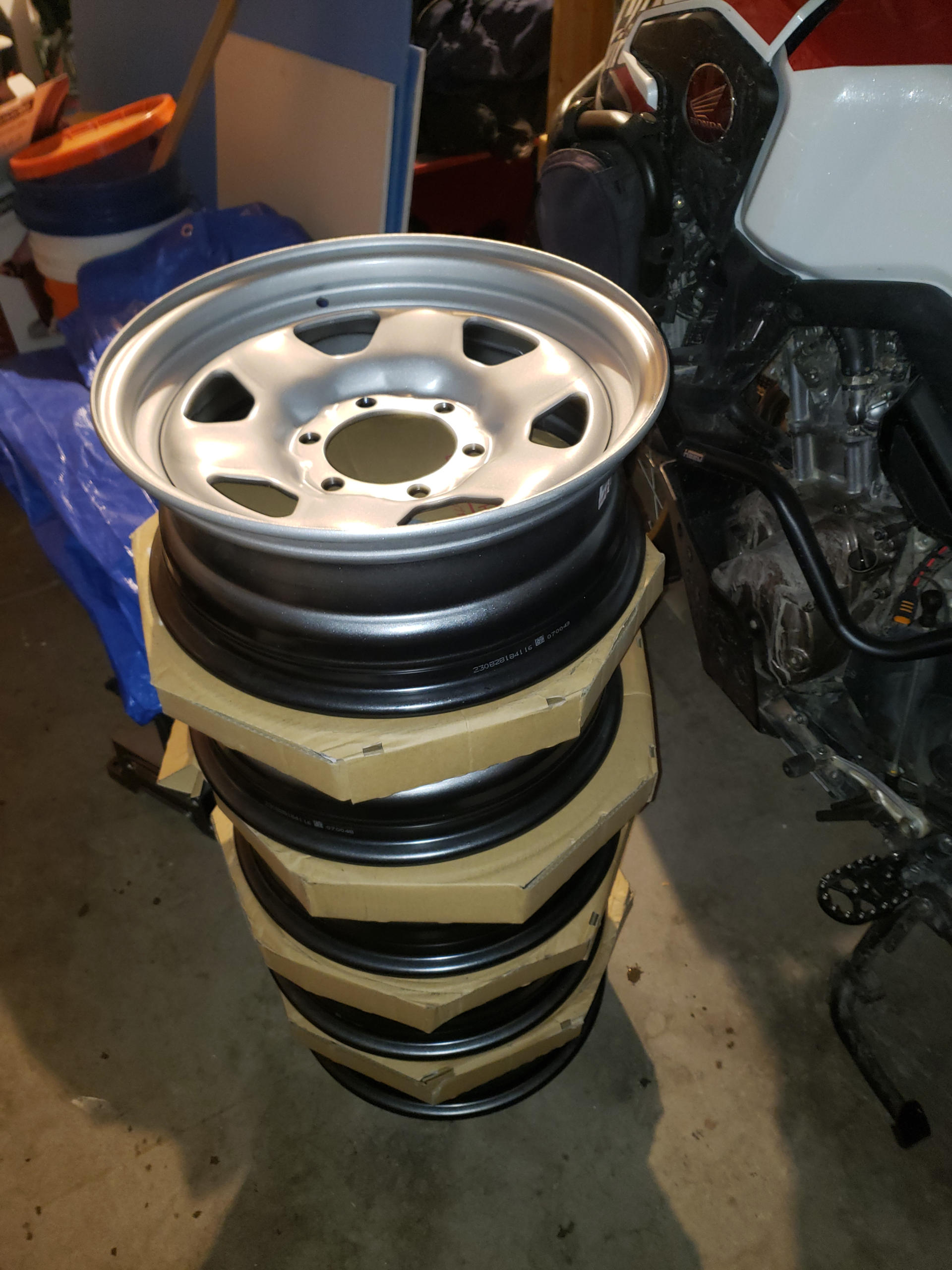

Sorry, what were you saying? I got distracted by something else in the lower right background of that last picture 😝.
