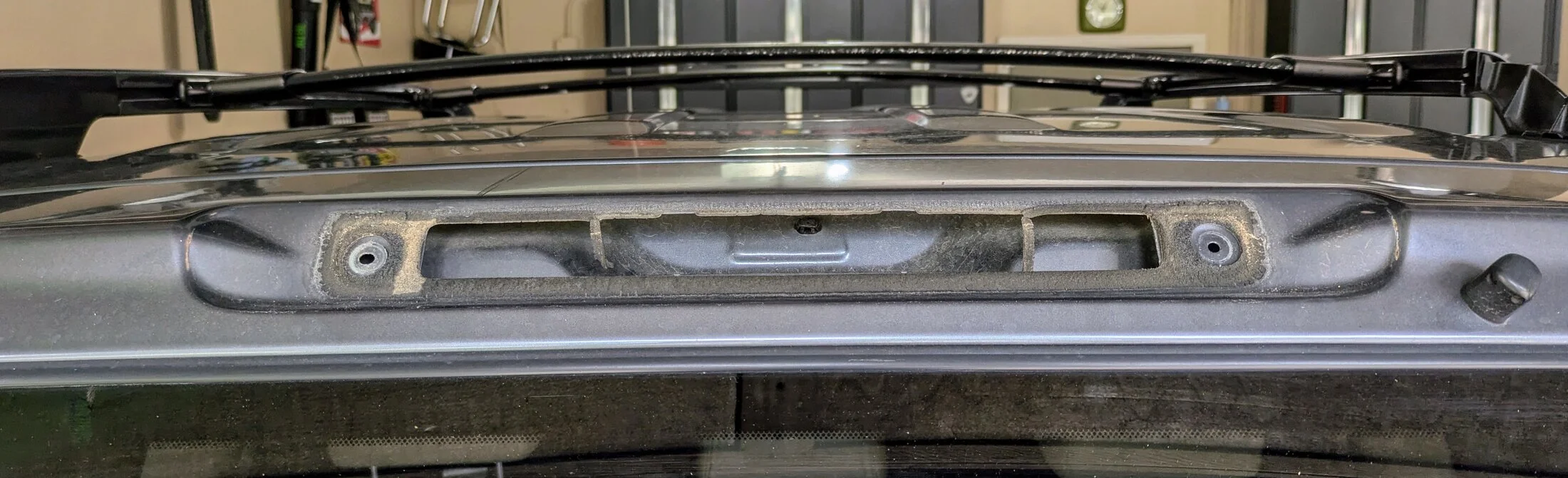

This weekend I replaced the cracked 3rd brake light. This was not something I had to do on my 1999 but after some research, it seems like this is not uncommon.
I decided to replace with the OEM part (Part number 81570-60061).
Pretty easy job. The majority of time was spent removing old adhesive from the original light.
IF ANYONE WANTS A CRACKED OEM 3RD BRAKE LIGHT, I'll happily send you mine for just the cost of shipping. If you didn't want to spend the $200+ on new OEM, seems like you could repair the crack, peel off this old adhesive seal, then reinstall with new sealant.

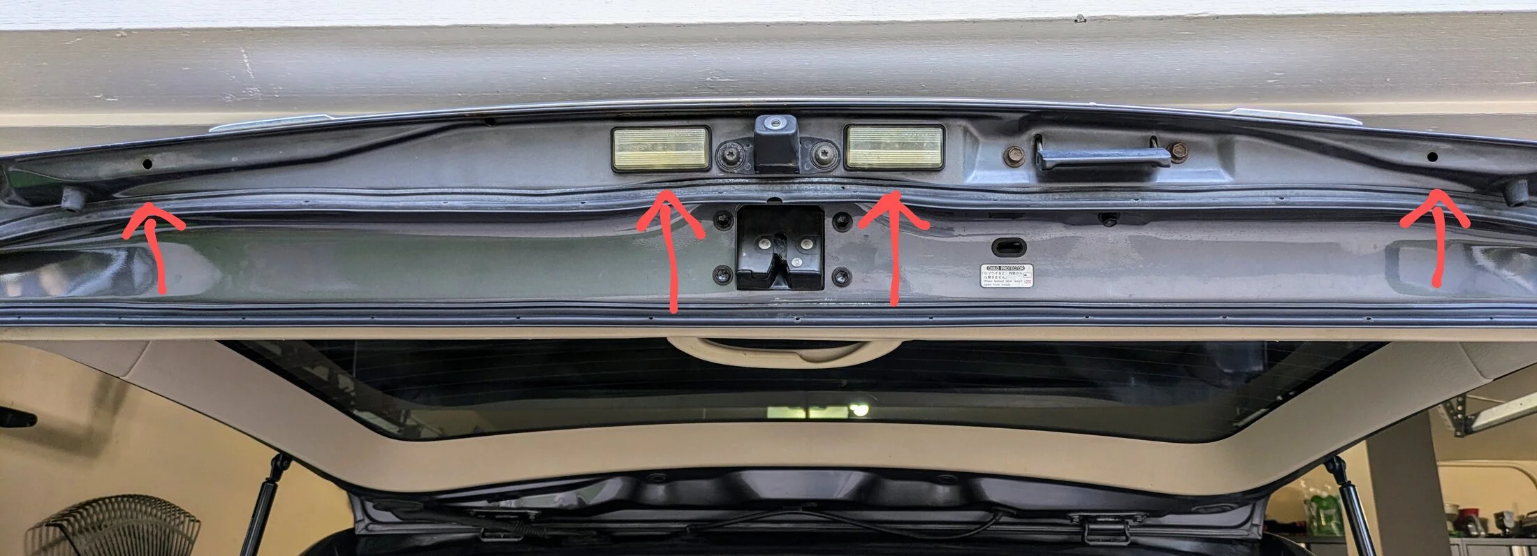

Unfortunately, addressing this issue exposed the worst rust present (that I am aware of) on this truck in the lower part of the upper hatch. I imagine the cracked 3rd brake light and deteriorating seal allowed water intrusion over an unknown amount of time.
To address this, I treated as much of the inside with Surface Shield as possible. I'll be working on the rust from the outside in the coming weeks.

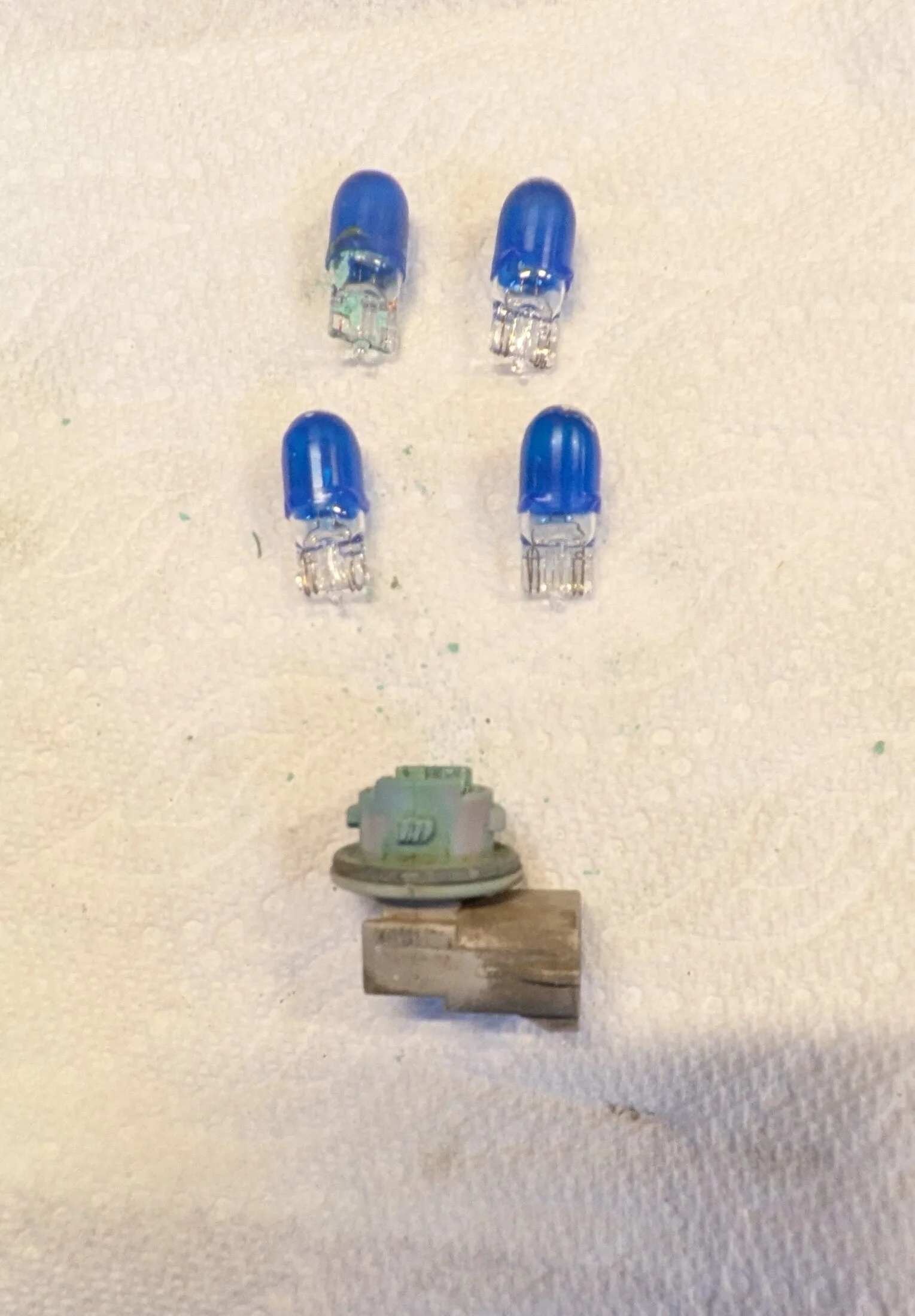

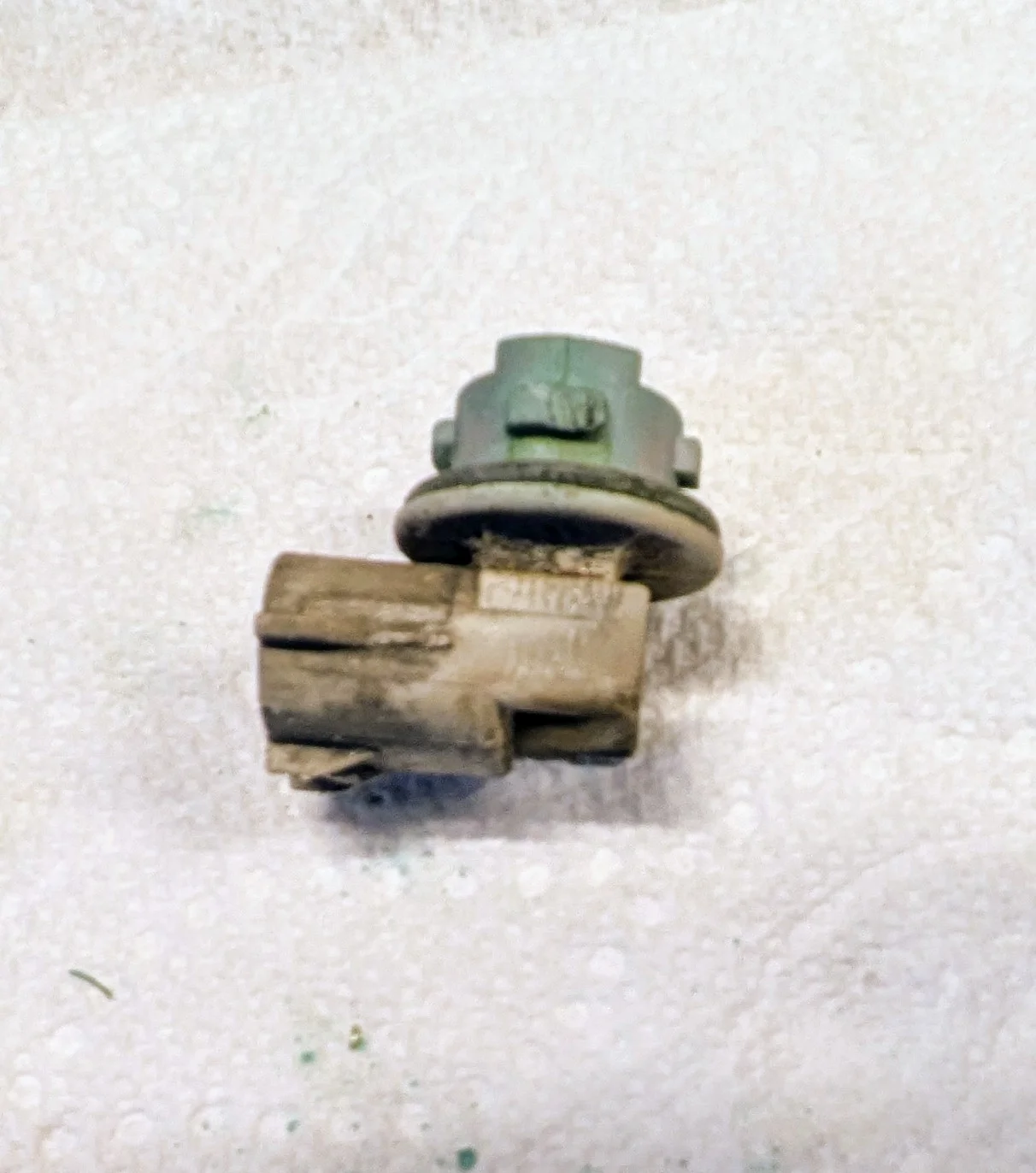

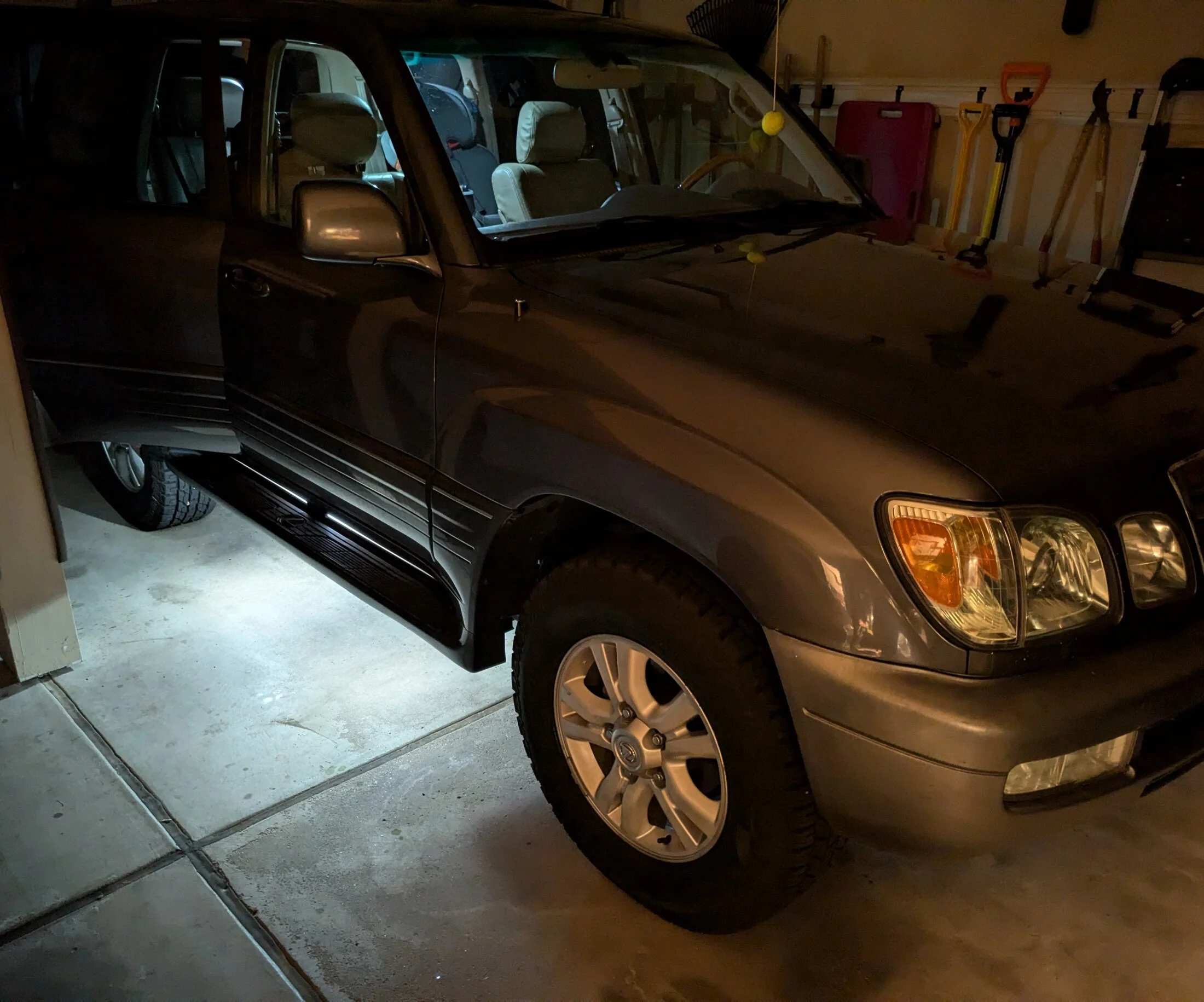

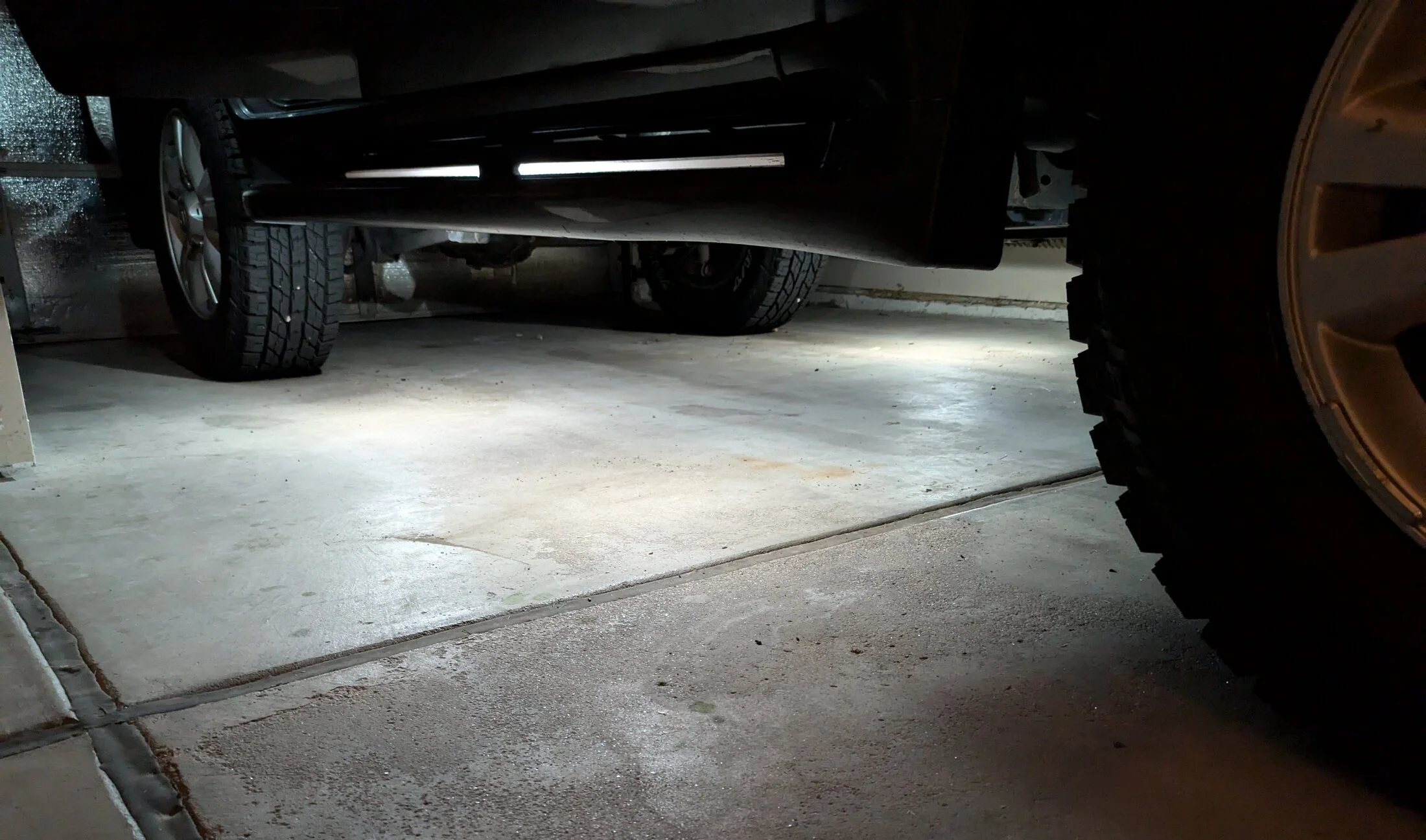

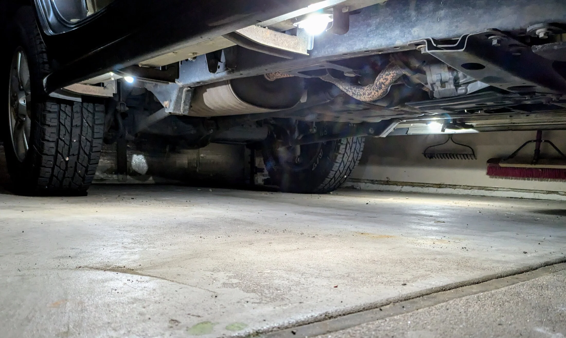

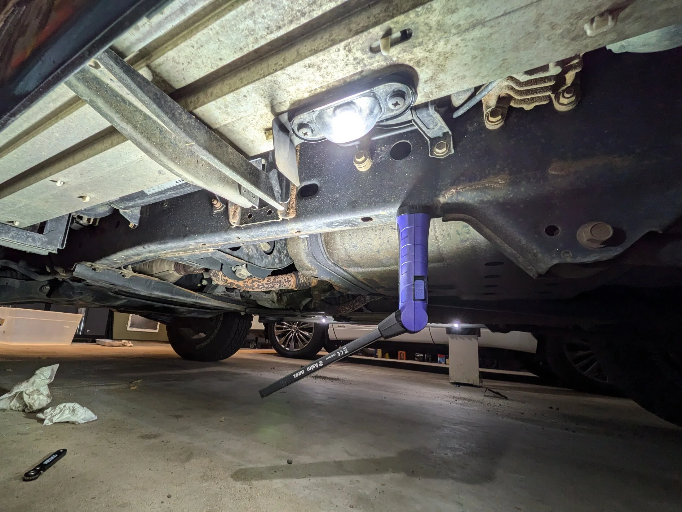

Replaced the running board courtesy or "puddle" light bulbs on my 2004 LX470. I replaced with Sylvania LEDs.

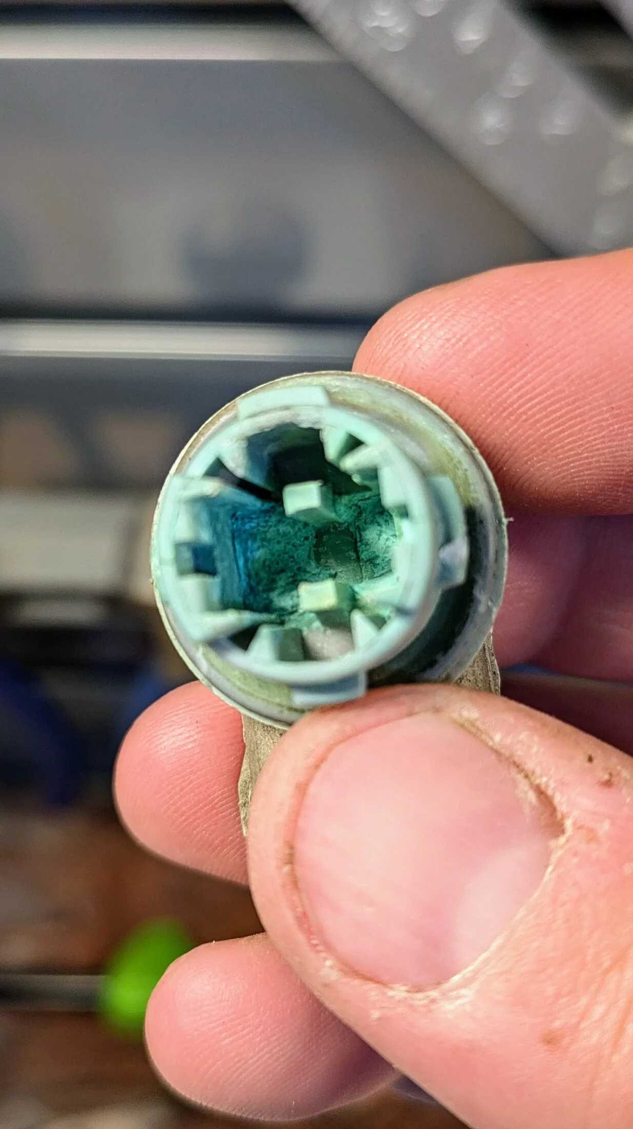

Three were simple "remove, clean, replace" operations. However, the driver front was not on and I quickly learned why.
The metal in the plug that holds and connects the bulb had completely dissolved.
Just ordered a replacement lamp assembly (part number: 8149060010). I hope simply replacing the plug is all that's need to get this light operational again.
Does anyone know the part number for this plug? I hope simply replacing the plug is all that's need to get this light operational again.
Let me check and see if I saved any of those. I removed my running boards a while back.
