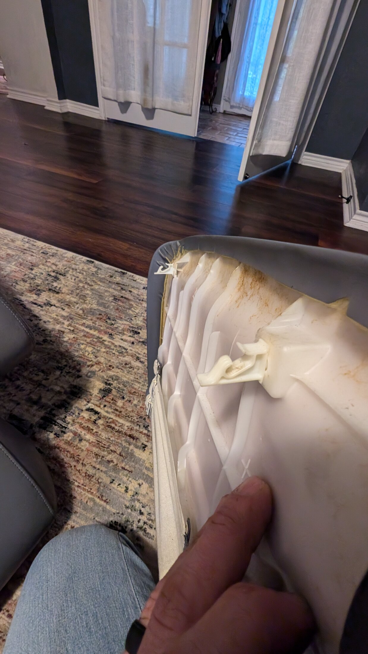

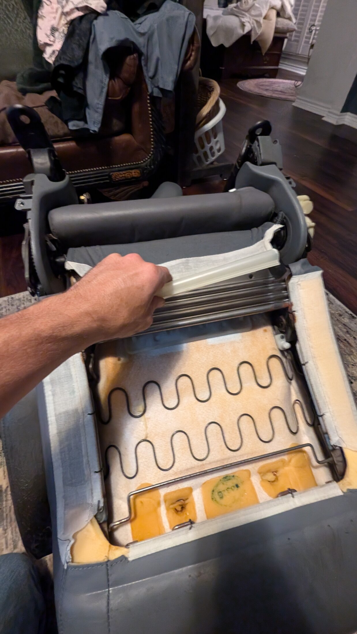

Driver's side seems the same as passenger so far... Figured I'd get pics of the process.
Removed trim pieces from bolts, move seat all the way forward and remove 2 rear 14mm bolts. Move seat rear ward to remove two front bolts. Make sure seat is raised all the way and back is in an upright position, then rock the whole seat back and disconnect the wiring connector (didn't get pics of that part...)
With the seat moved inside, remove the headrest and arm rest. Arm rest needs plastic cap gently popped out and the 14mm bolt removed with a socket. Make sure to keep track of the spacer ring.
The plastic side panels get removed from the seat base. 4 screws (philips head) hold the side with the switches, only two need to be fully removed. The two in the middle on the bottom side can simply be loosened. There's a course thread screw on the front side (just out of frame on the left side here) and a fine pitch on the back at the hinge cover (out of frame on right side).
There are a couple of tabs to carefully separate around the hinge. With the plastic trim piece free, disconnect the two wire connectors.
The other side is similar, with three screws getting removed and tabs at the hinge cover. The screw nearest the front of the seat is course pitch, the other two are fine pitch. If you adjusted the seat all the way up you can easily access the 14mm bolt securing the seat belt receiver to the seat frame. If you did not it might be slightly more difficult to access this bolt.
Disconnect the wiring connector for the belt latch receiver and it should easily come away with the panel.
Before removing the seat back, the pocket panel thing will need to be removed. There are two tabs to release at the top, and it can be tilted out and pulled up to free the bottom tabs. Release tabs in profile:
With the back panel removed, you need to undo the long clip on the seat base cover, then remove two hog rings.
Make sure to disconnect the two wire connectors for the seat heaters and lumbar adjustment. There is also a wire retaining clip that will need to be unhooked.
The seat back is held to the base by 4 (2 per side) 14mm bolts. Remove those and the back should be free from the base. Make sure the wires do not get hung up on the hinge covers as you pull the seat back away. The blue lines show the wire on one side routed through the hinge cover (the other side is similar).

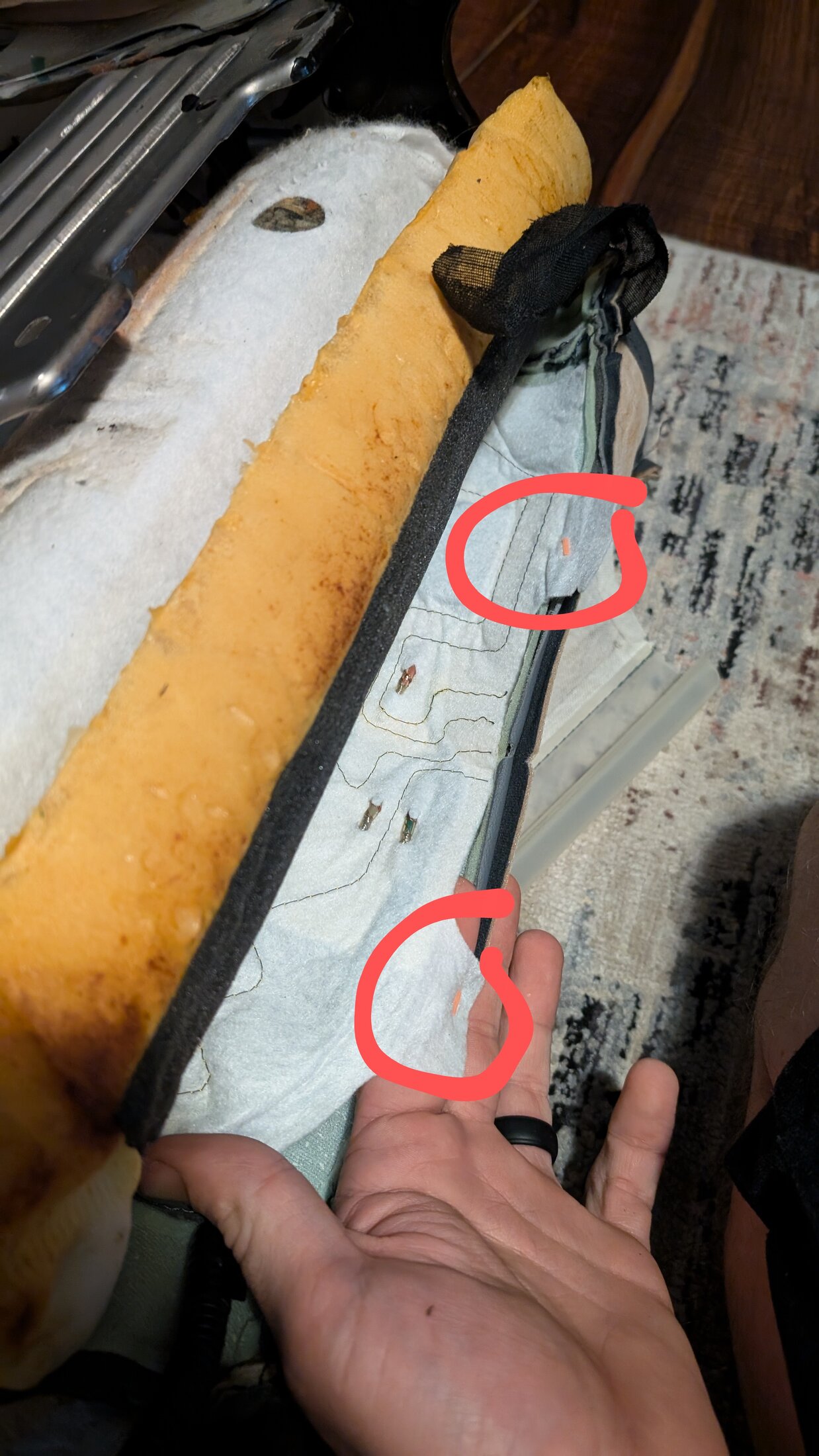

Make sure to note which parts of the cushion, cover, and wires are routed around the metal bar on the seat base for when you re-assemble. With the seat back free, I started at the back removing the 8 hog rings, then pulled the three metal rods and set them aside to reuse in the new cover.
Before continuing to remove hog rings on the front side, I cut the two plastic keepers holding the heater to the cover. There are multiple places these will need to be cut as we go.
