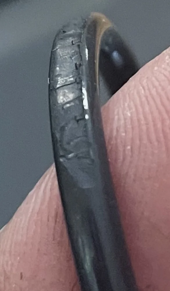

Then found that the o-ring on the water inlet housing has a very minor seep after about 200 miles. I don’t think I used enough lubrication when installing and must have damaged the o-ring.

I hope you didn’t damaged the o-ring because when I did mine I pinched it. Second time I did it was a charm as I made sure to apply die-electric grease on the o-ring. Best of luck!
I did damage it :(
It was pinched and shaved parts of it off. Had several flat spots. Bush League mistake.
I did damage it :(
No worries buddy we live and we learn. Was a lesson more than a mistake. Die electric grease on the o-ring and die electric grease on the housing and you should be good.

Damaged o-ring. It’s like that about 40% the way around the outside.

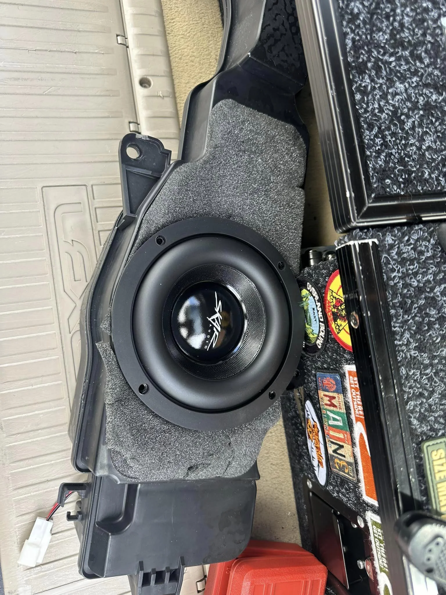

I got sick of the distortion coming from my ML sub. I've replaced all door speakers a while ago with I think JBL, I honestly don't remember. But, I re built the sub and it worked well for a while. The distortion has gotten worse so I replaced it with this. It's def. more clear now but it doesn't hit heavy with bass like the pictures suggest. Probably time for an amp upgrade but I'm not going that deep into the audio. I've got other stuff to address for now.
Hey how do get to the sub? Haven’t scoped it out yet but going to give my sun some fresh foam.
