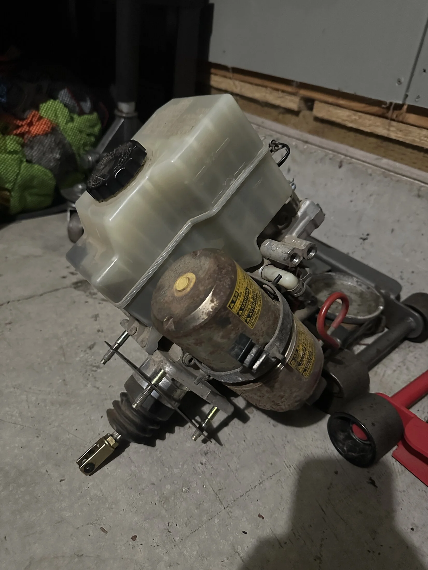

Clapped brake booster is out and now patiently waiting for the rebuilt one from Andy Le to show up tomorrow. Hopefully it arrives earlier in the day so I can get it installed and off to the dealer for fluid bleed.

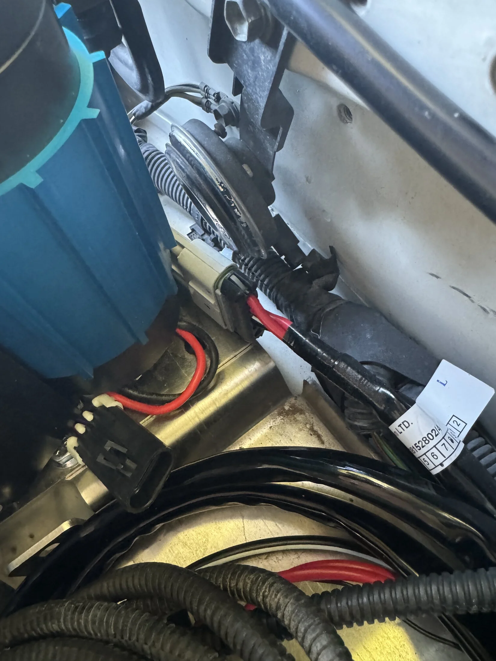

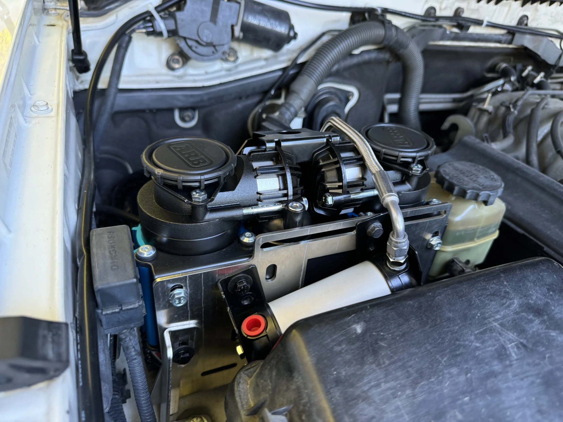

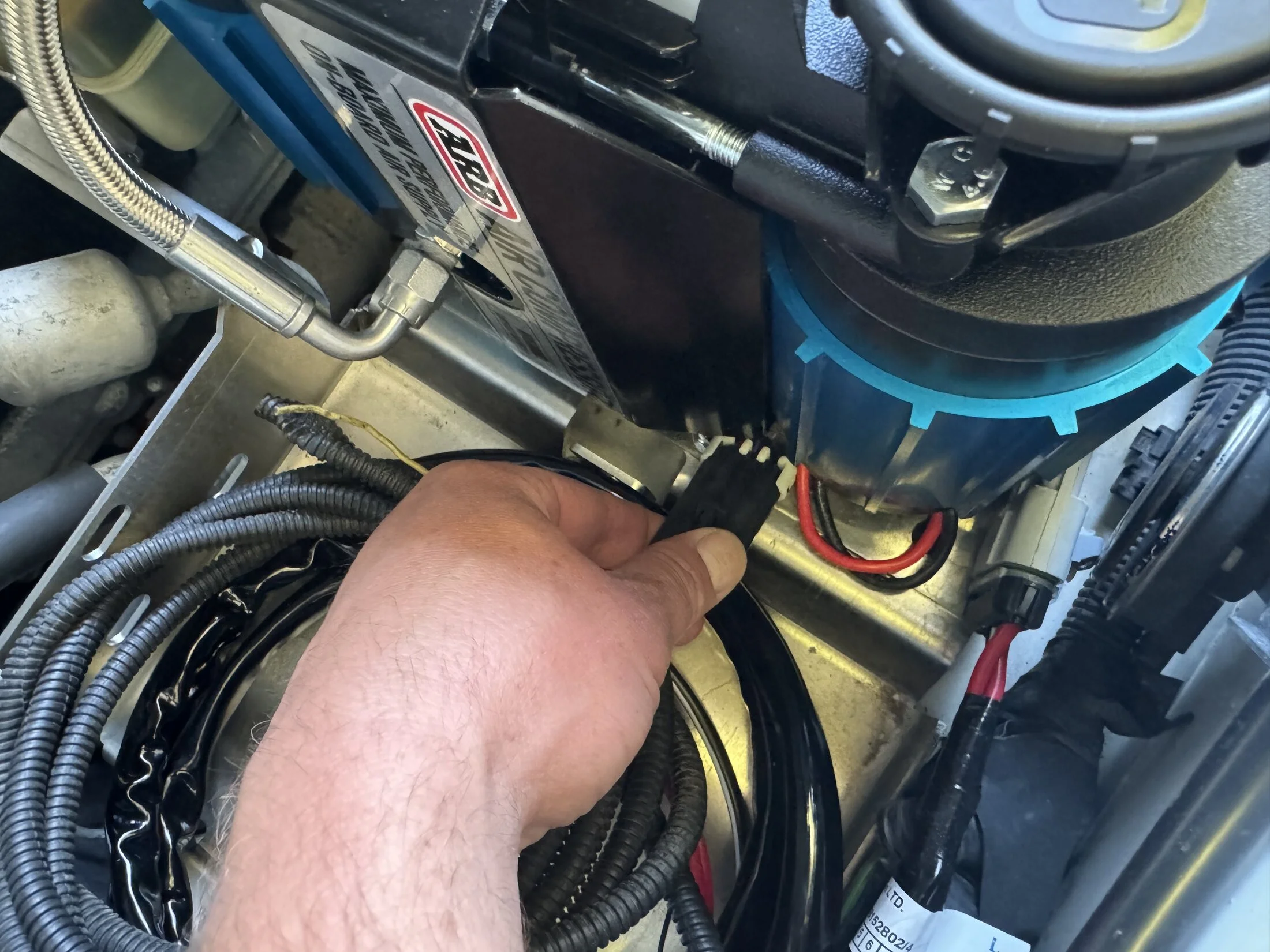

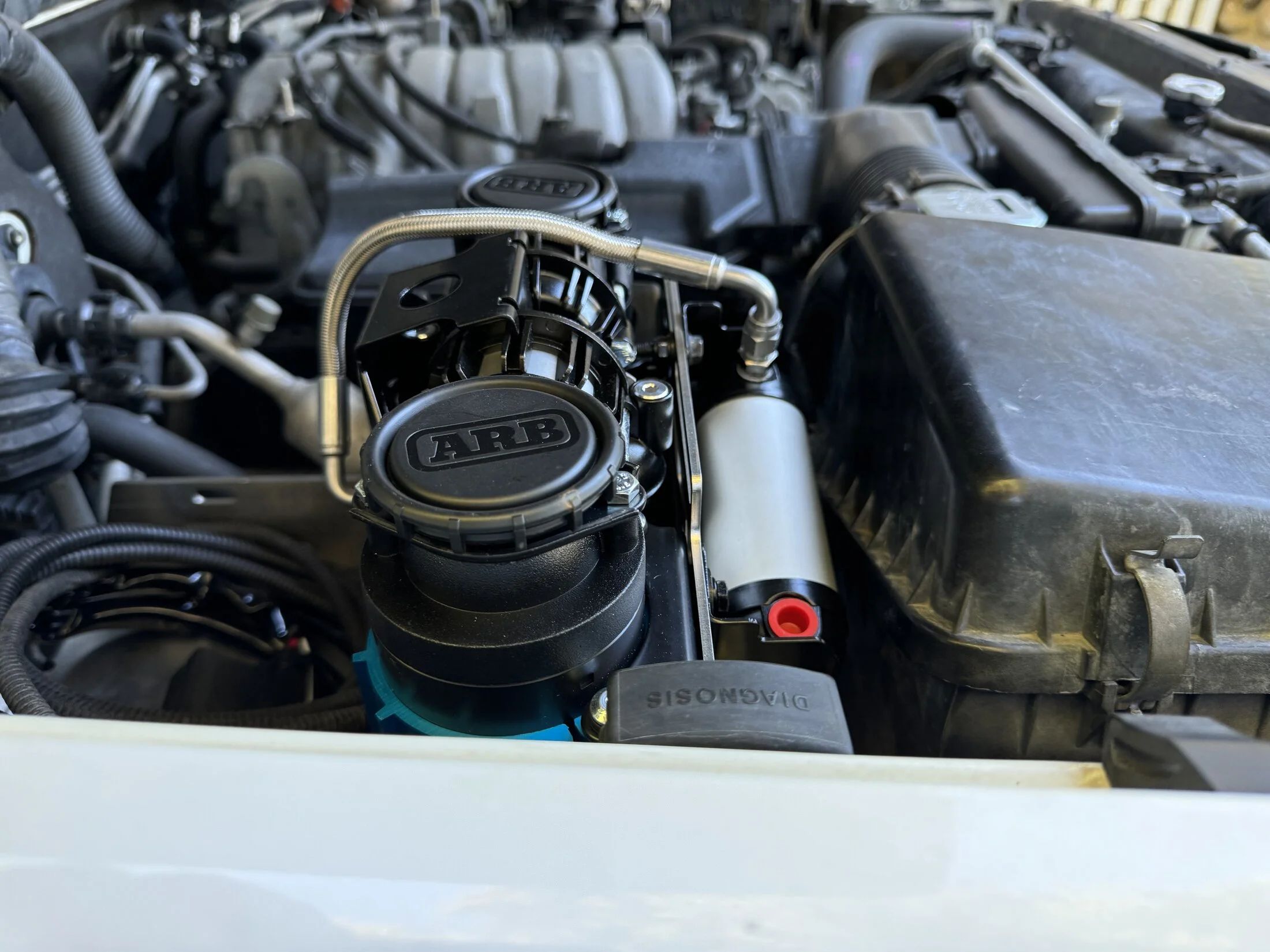

Knocking out some "leftover projects". First was installing the ARB Twin on the Slee Dual Battery Mount. Man... what a mass :-D took me ages to find a position where I could access all relevant bolts to secure it, have enough room to the hood, enough length of the tube from the compressor to the Manifold and the wiring on the ARB is so short I had to move the horn out of the way to plug the wiring loom in...
will need to see if I still get a battery in or not ^^
surely not my brightest hour, but should work now :-D

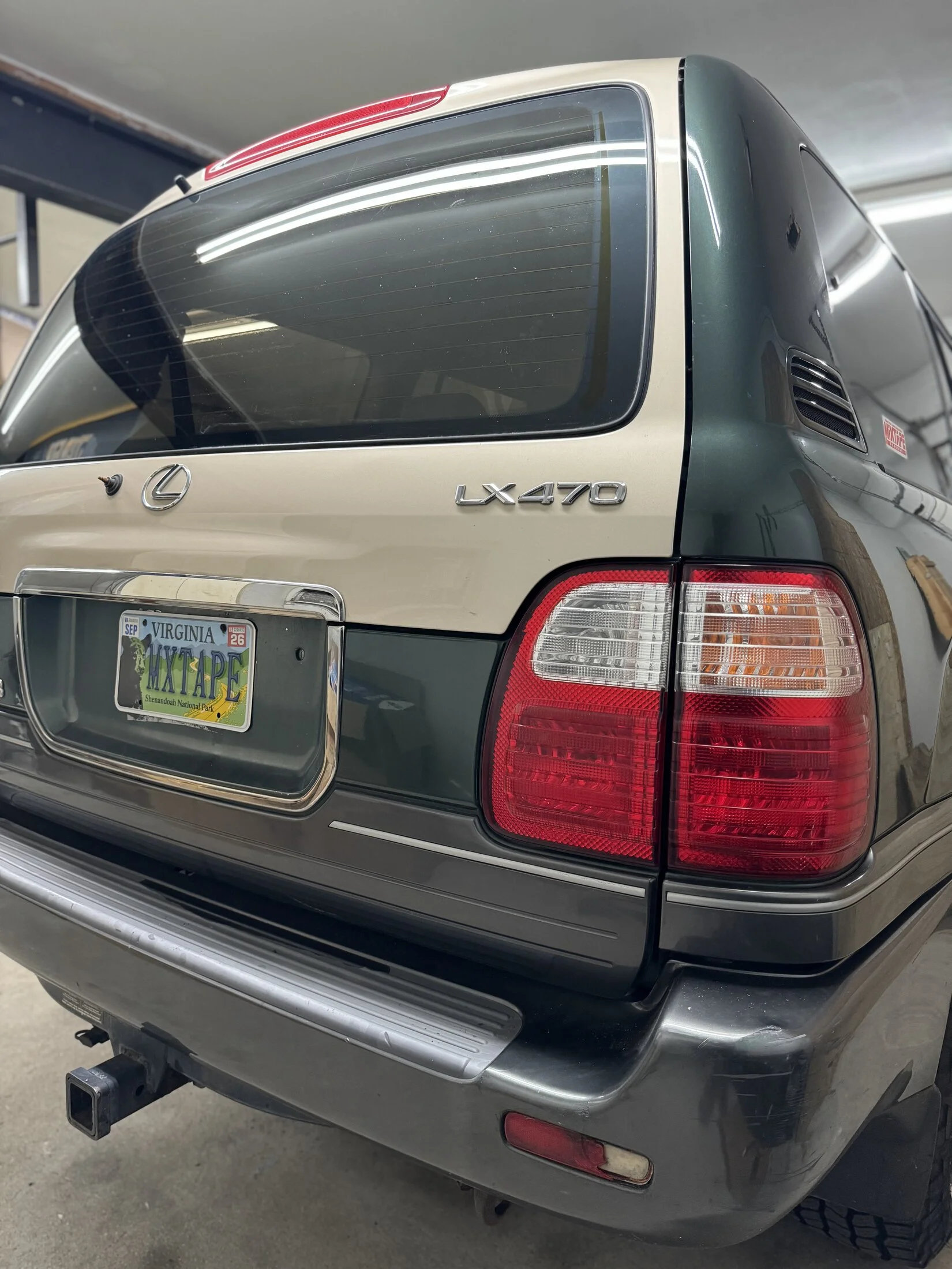

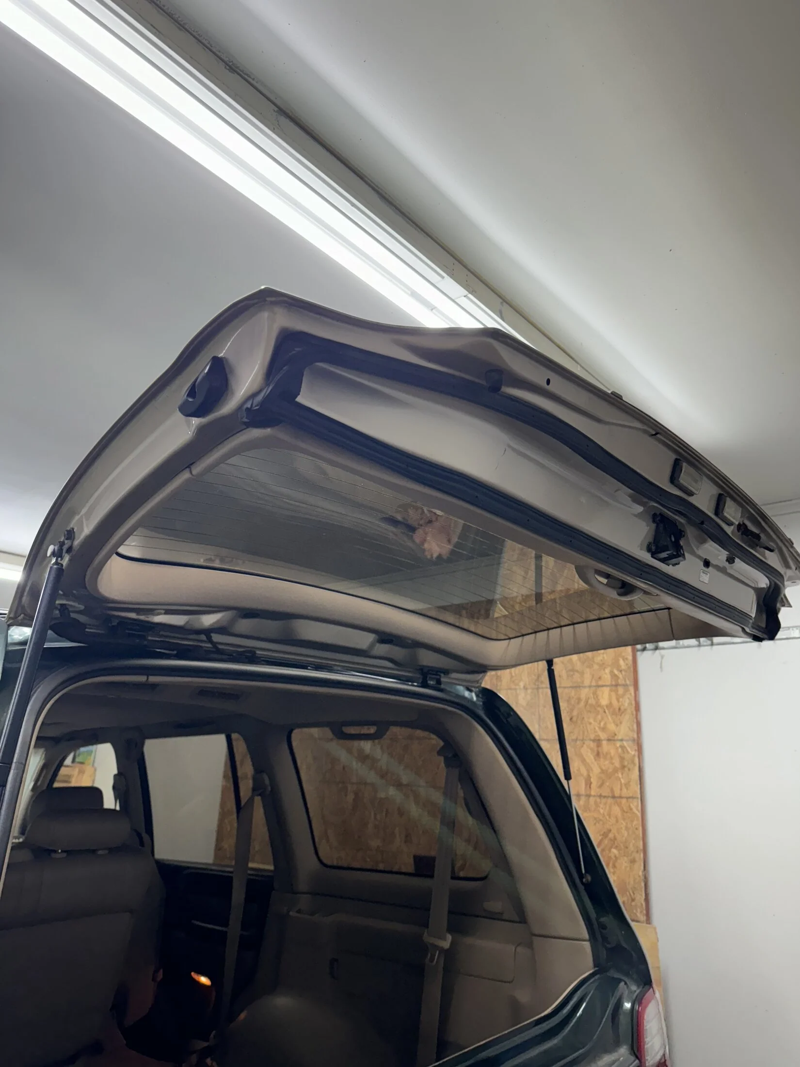

So far this week, I've done my high pressure power steering line and air control valve assembly and found a mint condition rear hatch and replaced my rusted out one. Not the same color, but I plan to repaint anyways.
Good job finding a rear hatch!

Now it's in and I don't care anymore, but I hear you. Just waiting for the quick connect, zip tie the wiring and I should be done. Only hope there's no reason to take it out again in the next 12 months or so ^^ But then I'd likely do it a bit different and just get a longer connection between compressor and manifold, so I can place it somewhere else.

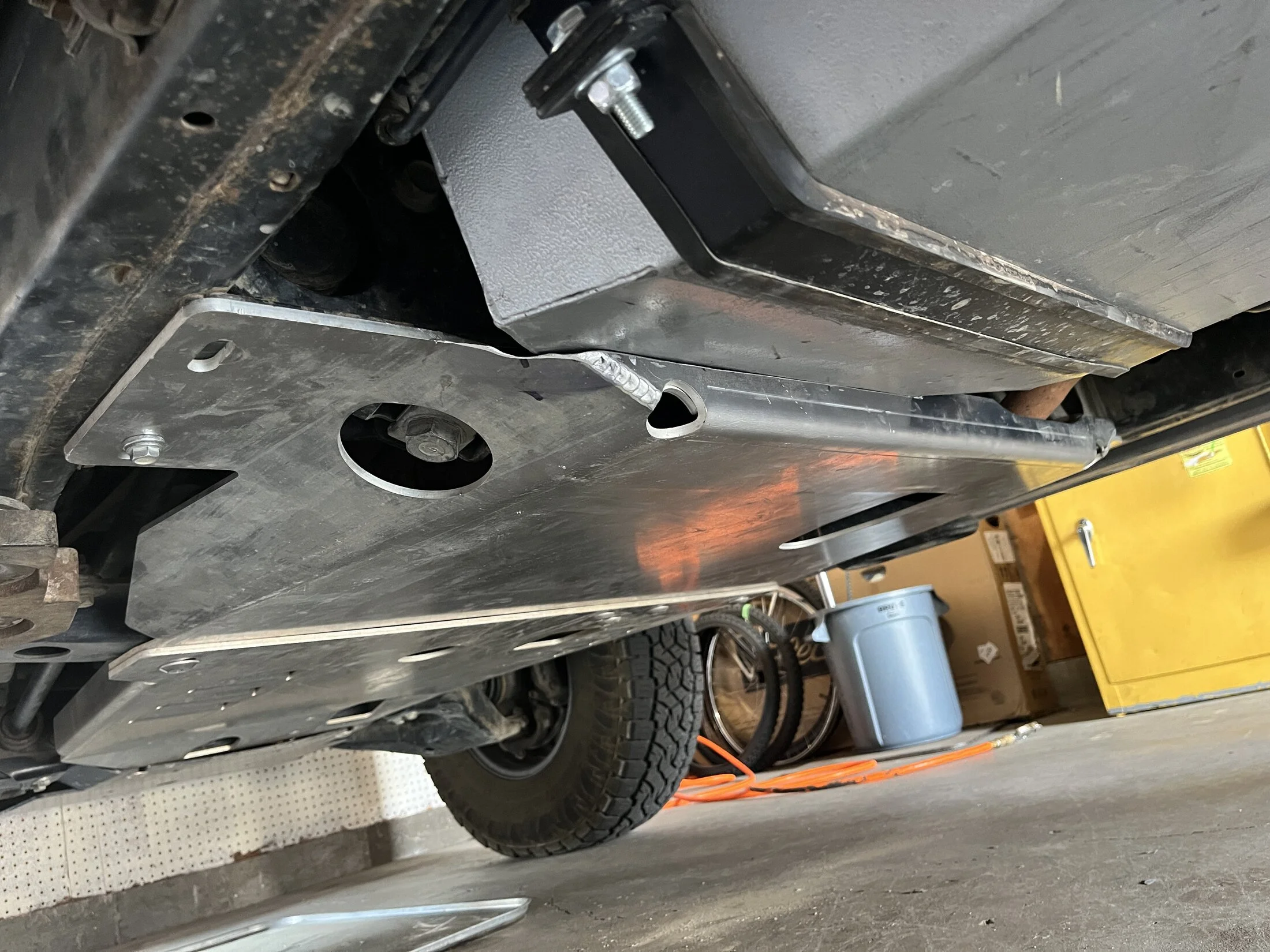

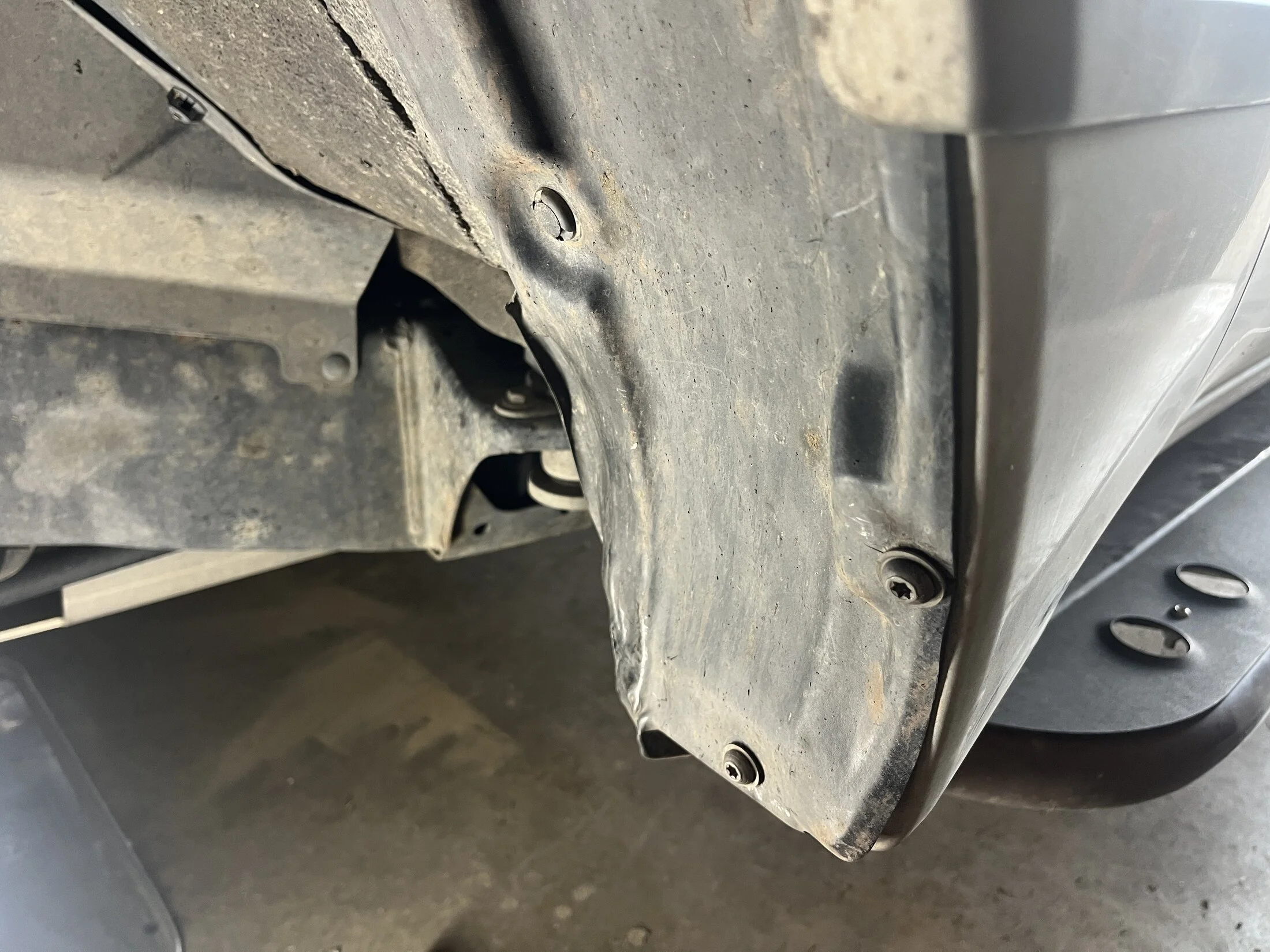

AFAIK all aftermarket skids are designed with diff drops in mind. The bumpers or a lift don’t come into play.
They are, but they also ship with spacers to mount it up if a diff drop is not used. At least the Dissent skids do. I'm running a diff drop so didn't need it.
