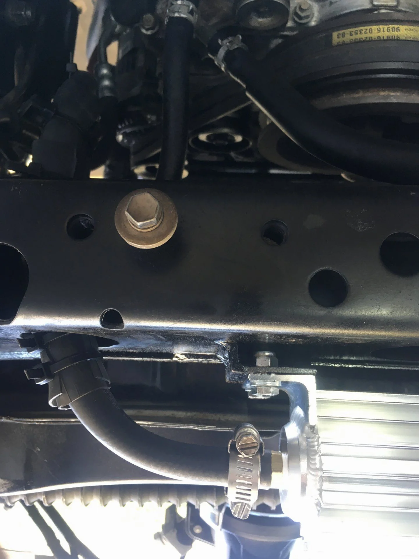

I have had a lot going on with my 80 on jackstands in the garage for weeks now. I think the most noteworthy thing I finished up this past weekend was an upgraded PS fluid cooler, the Derale 13261 heat sink. I had the entire steering system out from the column forward so I replaced the torn steering shaft/fire wall dust seal when I put it all back together. All new hoses for trans and PS cooler. The only hose that maybe needs to be actual oem is the one that carries trans fluid from the hard line to the passenger side of the radiator because it is specifically formed to keep it away from the crank pully and AC belt. The generic hose I use was 3/8" gates transmision cooler hose I purchased by the foot at a local parts house.

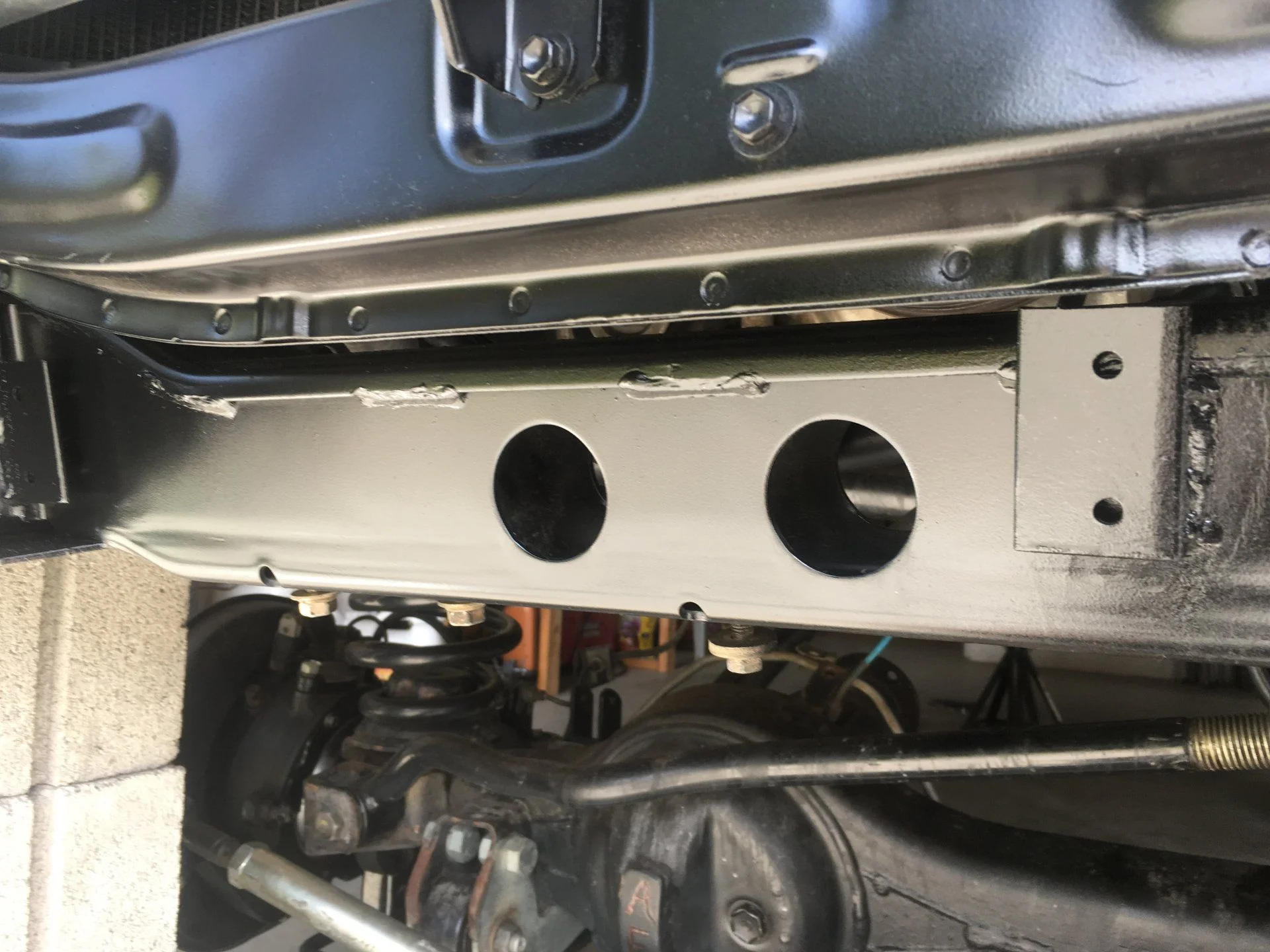

I needed to space my rear sway bar link brackets down. So rather than buy an extender, I welded up what you see in the pic in order space my stock bracket down 2.5". I had Slee extended brackets on my last 80 (RIP) and the additional leverage on the longer bracket caused the two small bolts at the frame end to come loose while wheeling. With my new solution here, the lower bolt will be 10mm grade 8.8 with a nut on the back side. I'm hoping this will remain secure.
