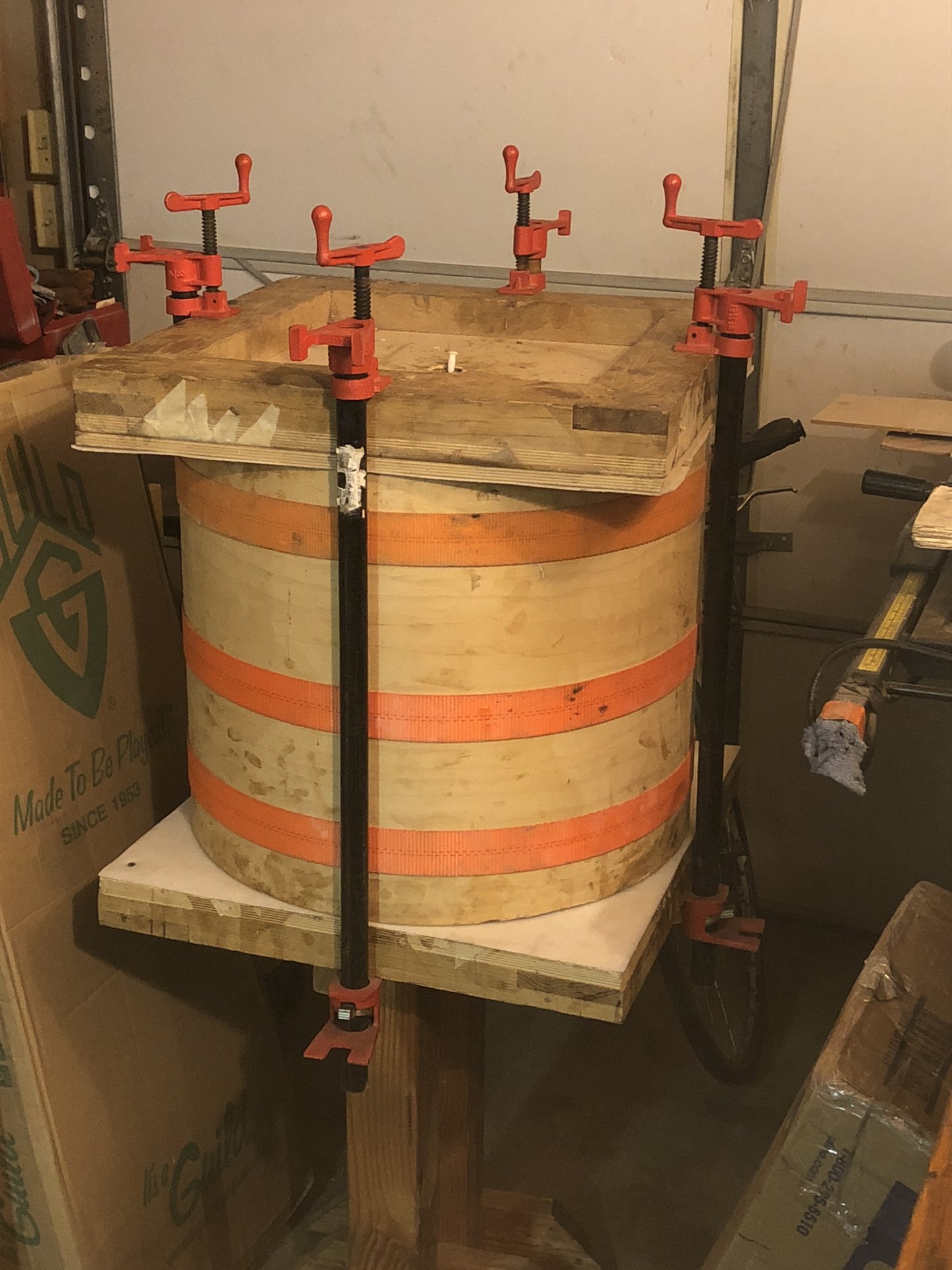

What is strapped on top? The curved thing.

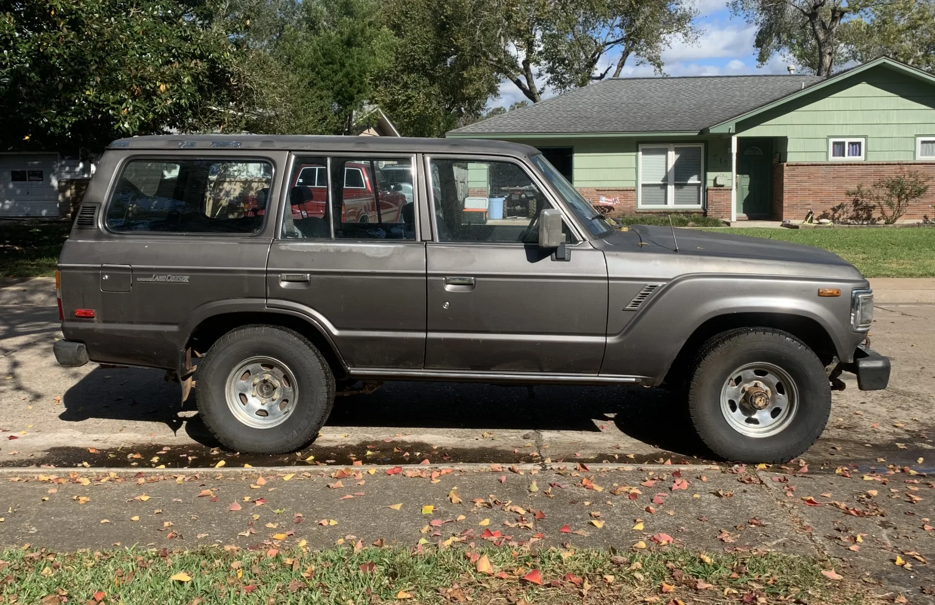

@js0k and I fixed up this old 62. Cooling system refresh, valve adjustment, 30 feet of vacuum hose and a little bit of restructuring inside my head.
Just need to do a Rodney flush, fix some odds and ends...and we can take it for a drive. Been sitting for ten years and its at 291,000 miles.

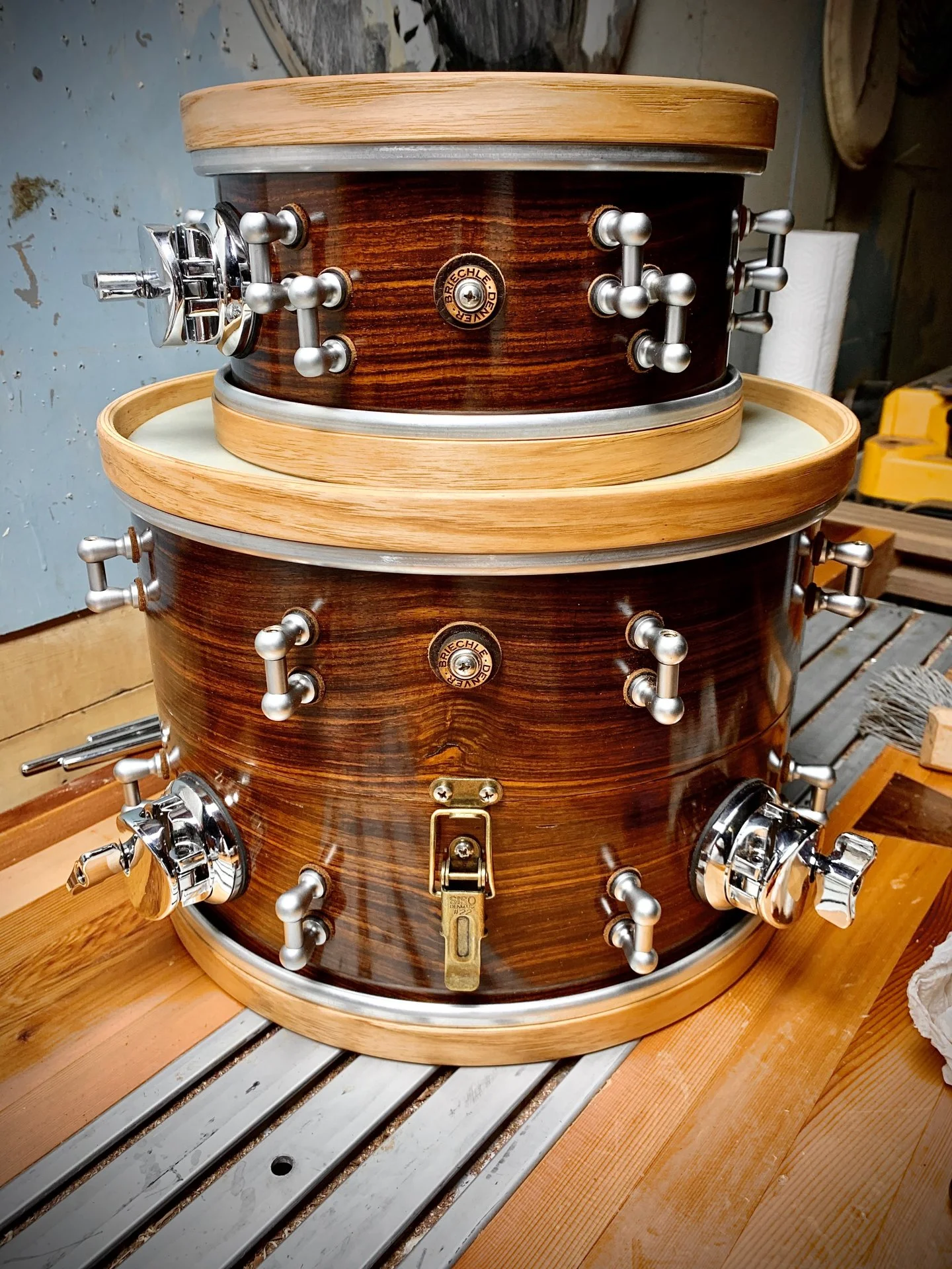

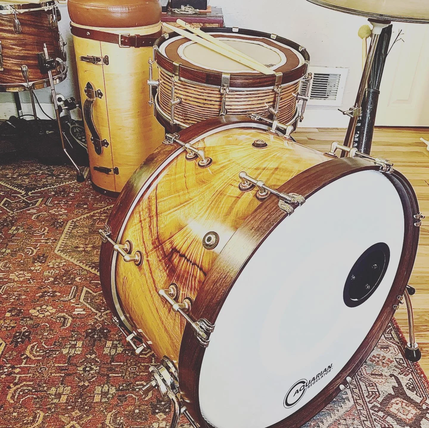

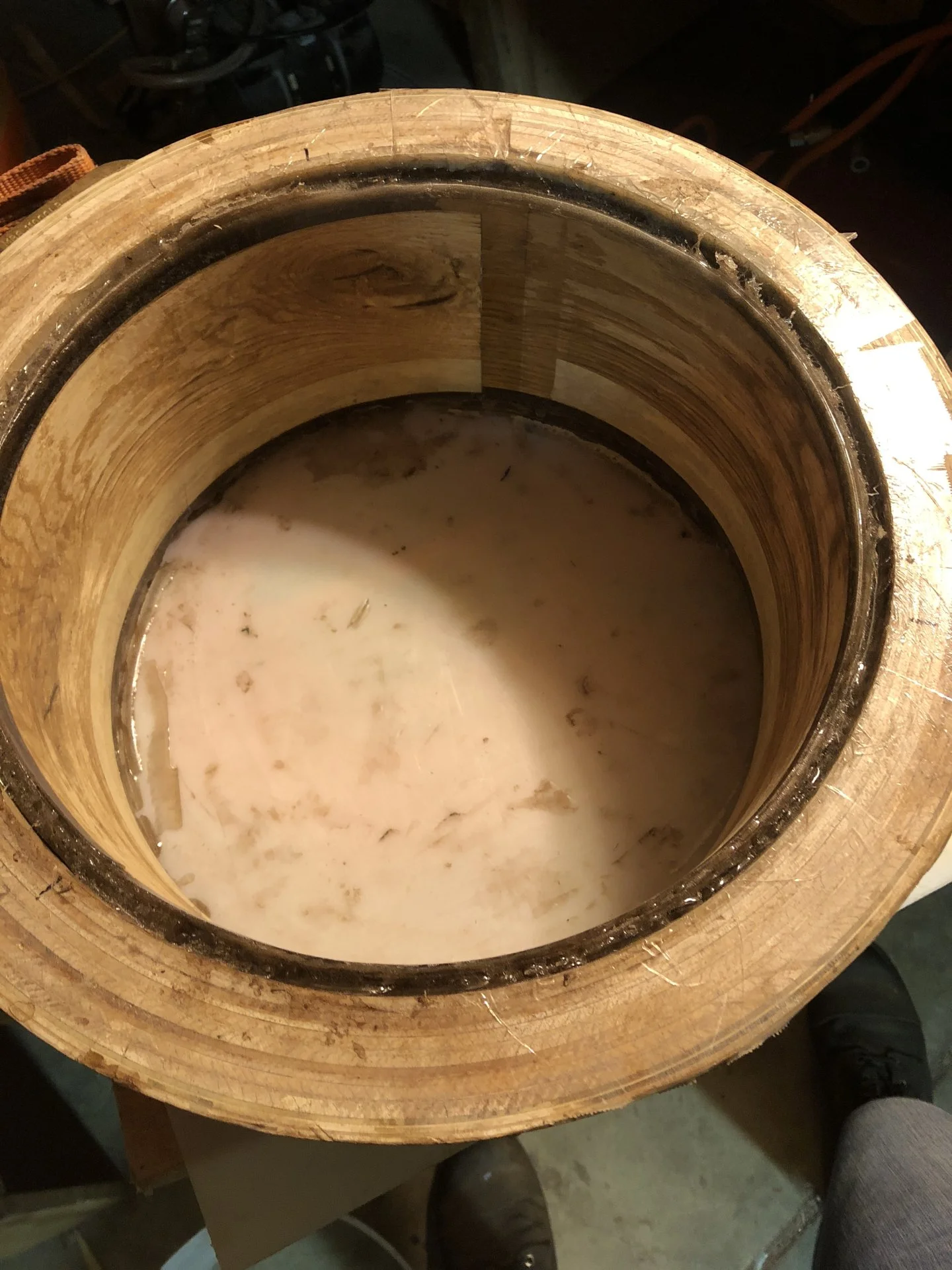

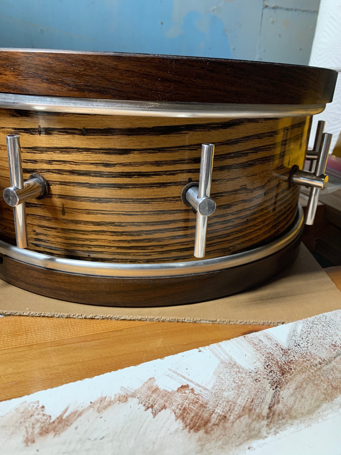

That’s a 14” drum mold. I make drums from scratch. I used to have an entire set for doing any size drum shell but I sold them to my business partner last year.

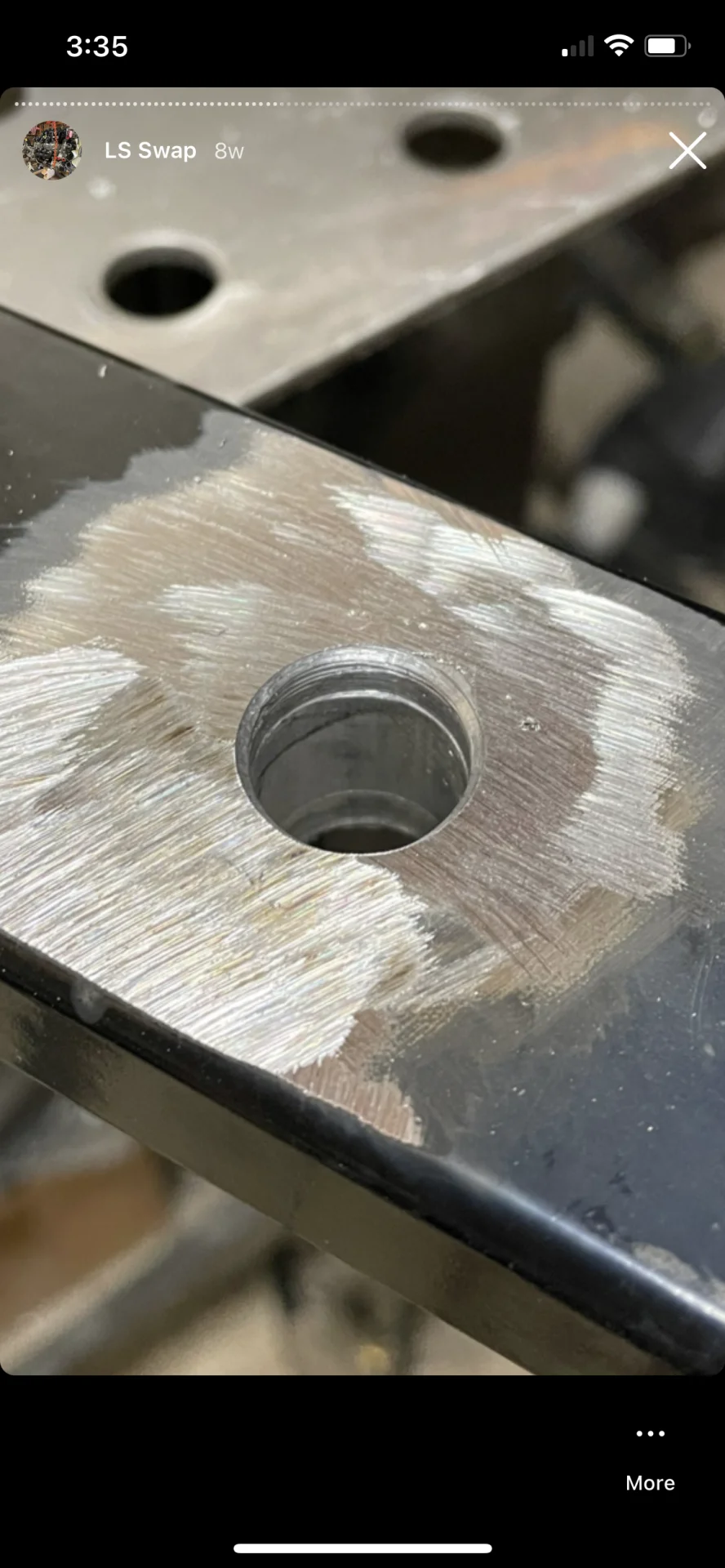

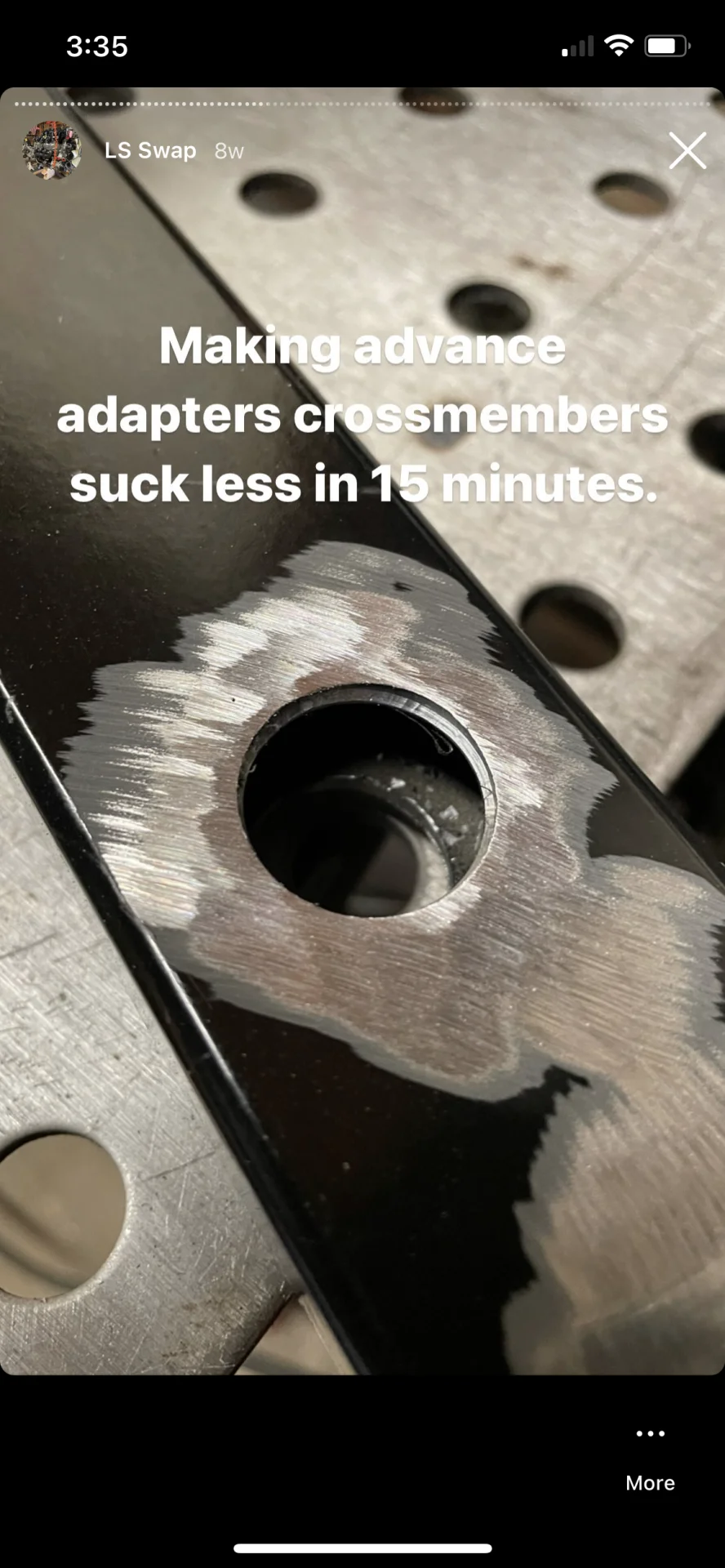

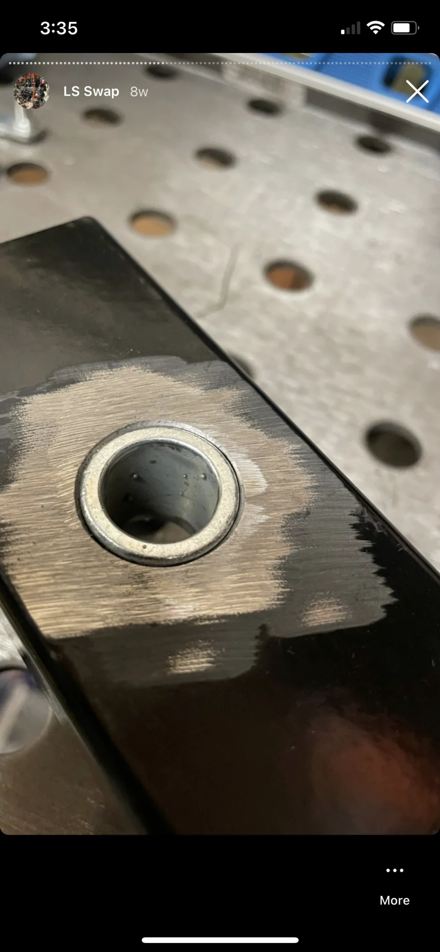

Cross member looks neat - was it custom made?

The crossmember is the Advance Adapters crossmember. I like it because it uses the OEM curved fj60 mount. I did drill out the holes and added steel sleeves to beef up the mounting surfaces. Before it was just a hole drilled in the crossmember and looked like it would crush with too much torque on the bolts.
