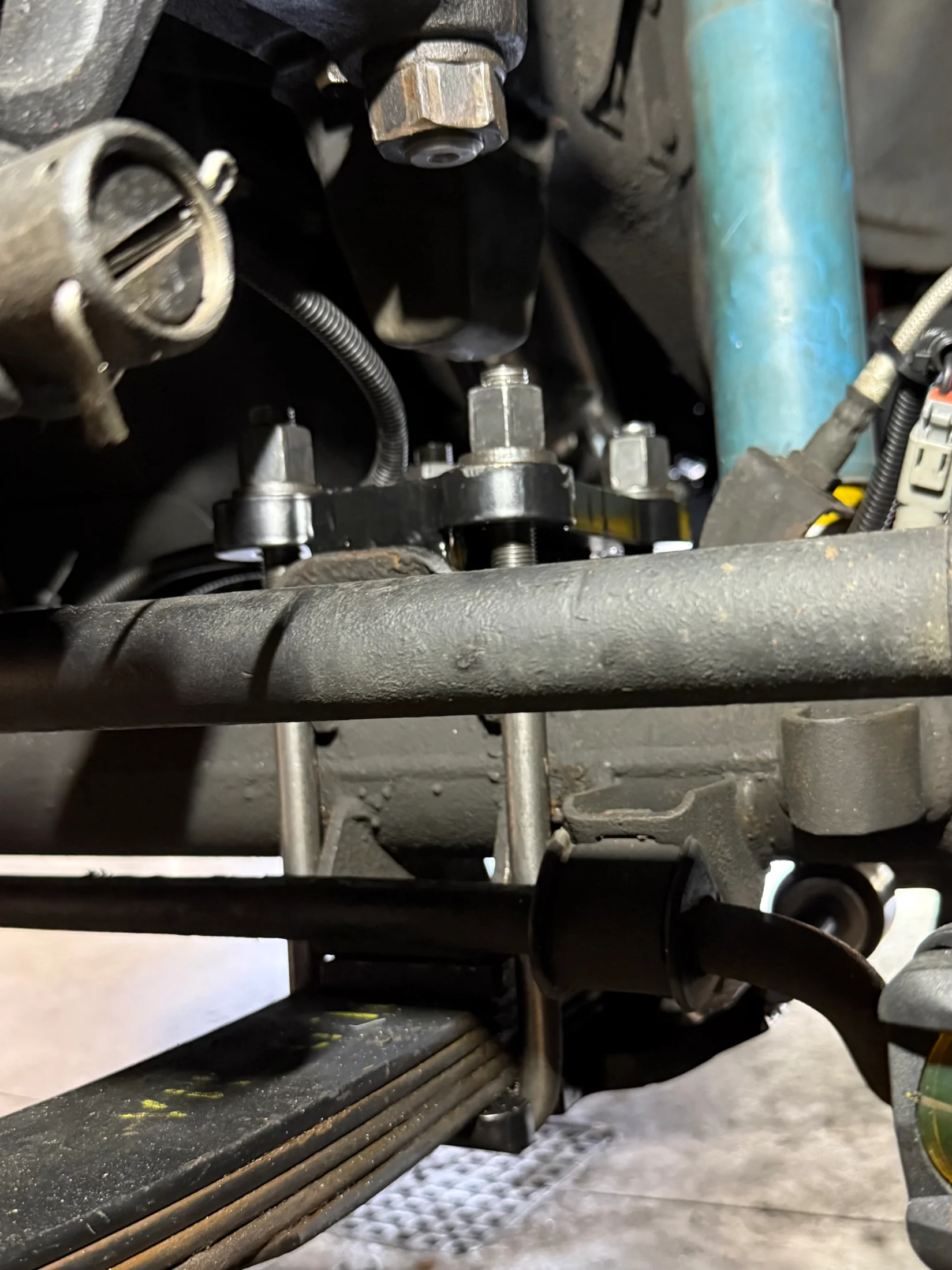

Not completed over the weekend, but completed in time for the weekend: Installed a 4Plus U-bolt flip kit. Cool upgrade and really well made. I appreciate how it tucks the lower shock mounts up higher on the axle and out of the way from rocks.

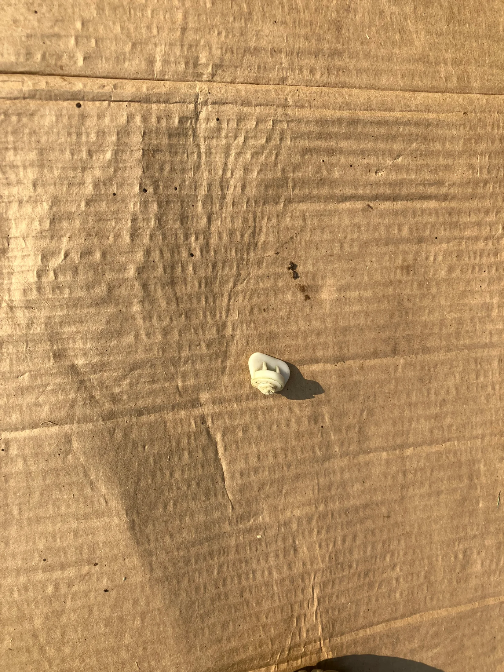

^that is the drain plug from a CSF 2708 (I think) replacement radiator which was installed ~ 1999, it failed yesterday. I was visiting my local TSC and when I returned to the parking lot there was a steady drip drip on the pavement :bang: , so I checked that plastic wingnut and it came right off, leaving the rest in the bunghole.
Welp, long story short - went back inside and bought a M10 - 1.25 x 20 hex cap screw, drove home and took a dremel to the plastic inside the threaded brass insert, drained the coolant, chased the threads and transferred the rubber grommet to the screw, liberally lubed the threads with copper anti-seize and installed it. Voila. No leaks 🤞🏼
I’m wondering if I should have used teflon tape instead?

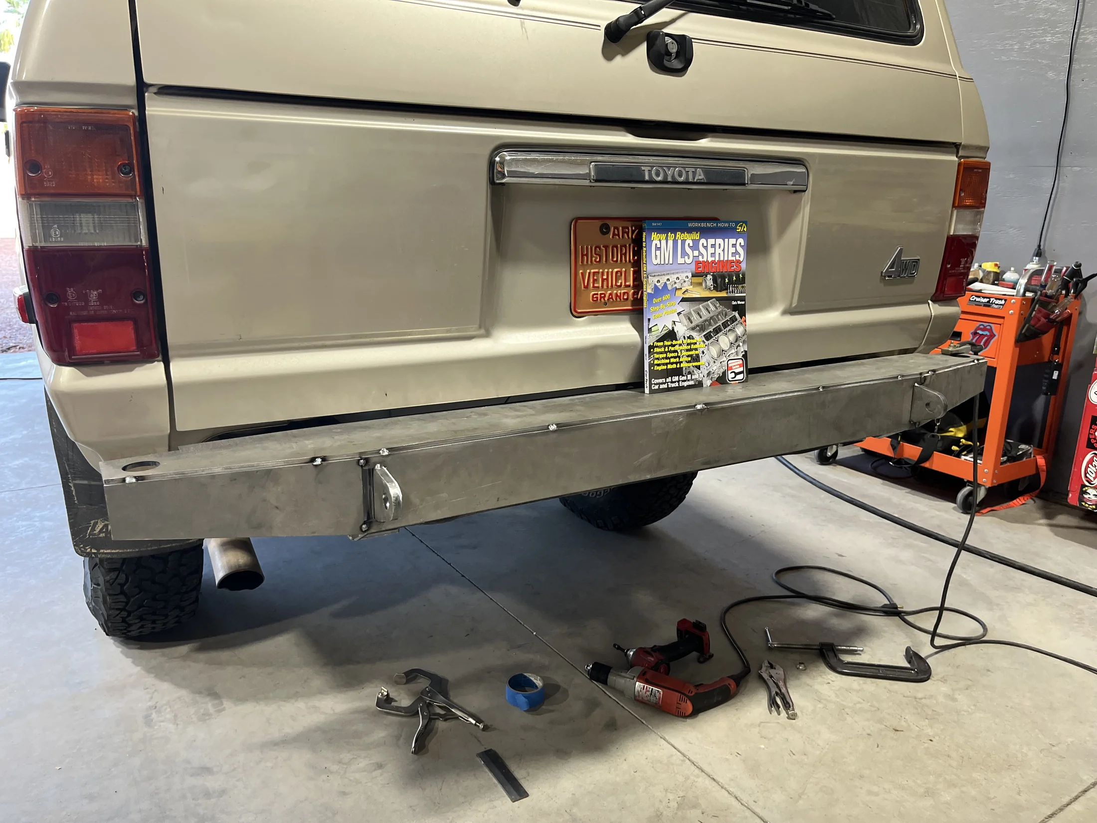

Started the rear bumper build w Mark’s (@Fourrunner) kit. Will be a single (half) swing out. Pic from yesterday but laid out and prepped all the hitch receiver bits today.
Just noticed a Mud vendor sticker peeking around the taillight 🤘🏽
