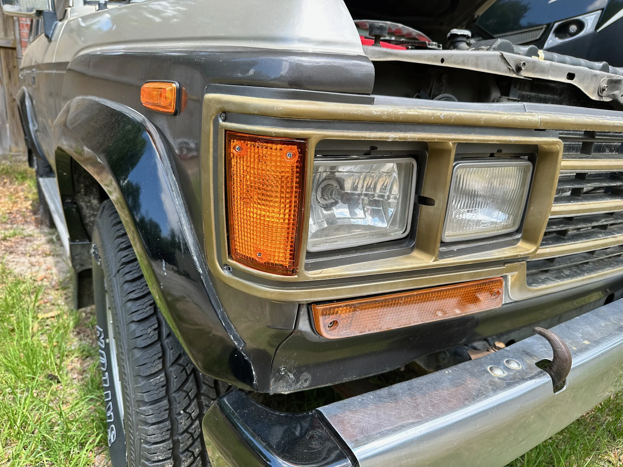

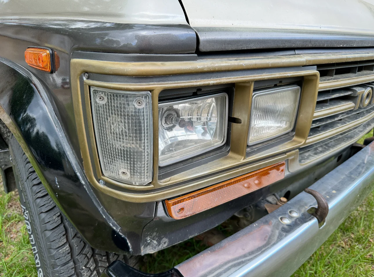

Cosmetic:
-Converting the two center vents to open and close.
-Rear sliding windows.
-JDM amber corner lights (see photos).
-70 series amber side markers. They have a boxy shape to them.

Hey. Love those amber sides.
Got parts numbers by chance? Been looking with no luck.
No part numbers. I have an extra set I’ve been holding for a future build.
