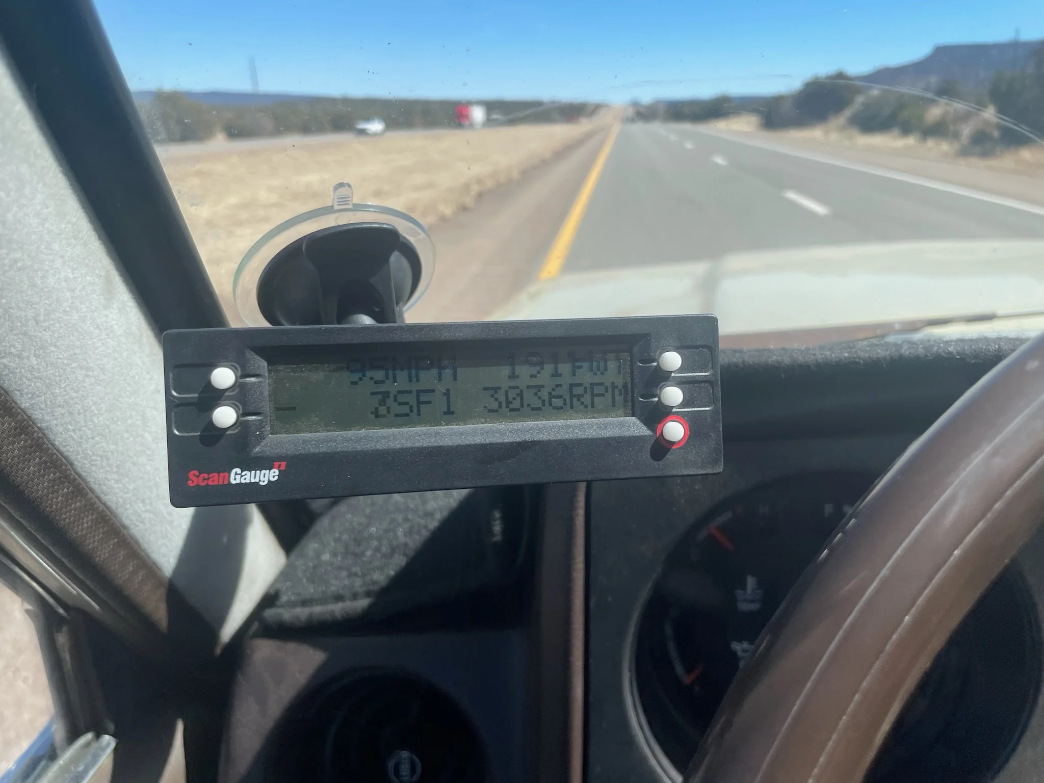

I'll second getting a Scangauge - I've got one in my 60 and it's been awesome. I just attached it to the windshield with their windshield mount.

Love the humble brag on your speed!!! 95mph??
