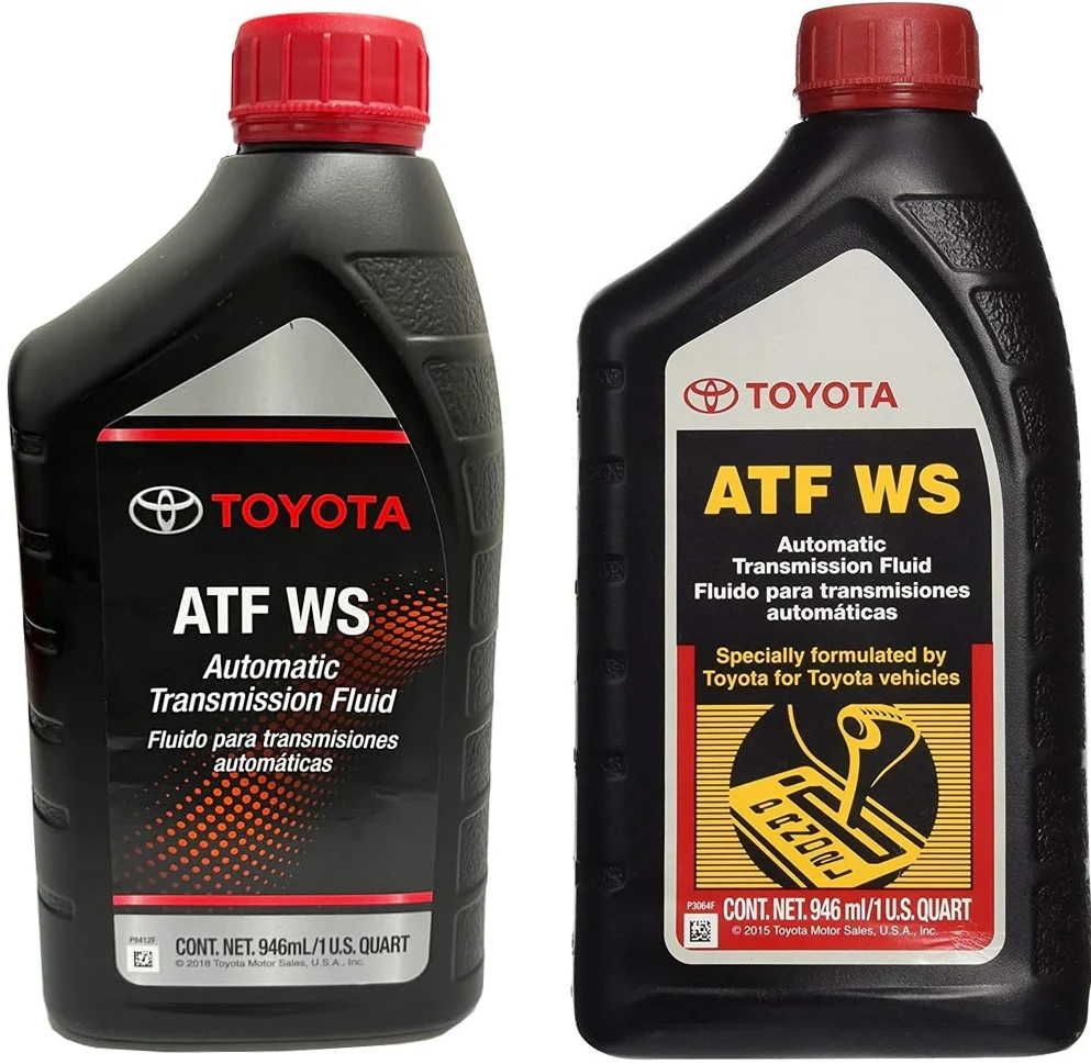

The part number for a quart of Toyota World Service transmission fluid is 0289-ATFWS. The part number you listed is not the correct fluid. You can get the number of quarts needed for each drain and refill cycle for your '14 by reading up on the transmission fluid exchange threads, which you will definitely want to do anyway. This is not something you want to mess up on, since getting the fluid level right is very important and you have to have a clean work area/tools to avoid contaminating the fluid.
I have two types of Toyota ATF WS. Which one should I be using? It seems that the one on the left is a newer version of the one that's on the right.
