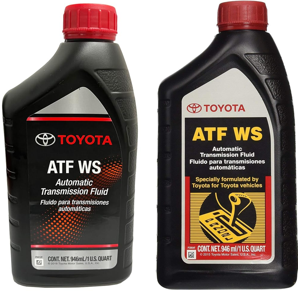

I have two types of Toyota ATF WS. Which one should I be using? It seems that the one on the left is a newer version of the one that's on the right.
Left is newer packaging and likely newer fluid. I doubt they changed anything with formulation, but supposedly there's a shelf life for this stuff (and oil in general). I don't know what that is, but if you search BITOG, etc you will find wildly varying ranges. Some of these ranges will be backed with data, others will not.
Same stuff, different labels. The one on the right is the old style label, probably been sitting around a while.
