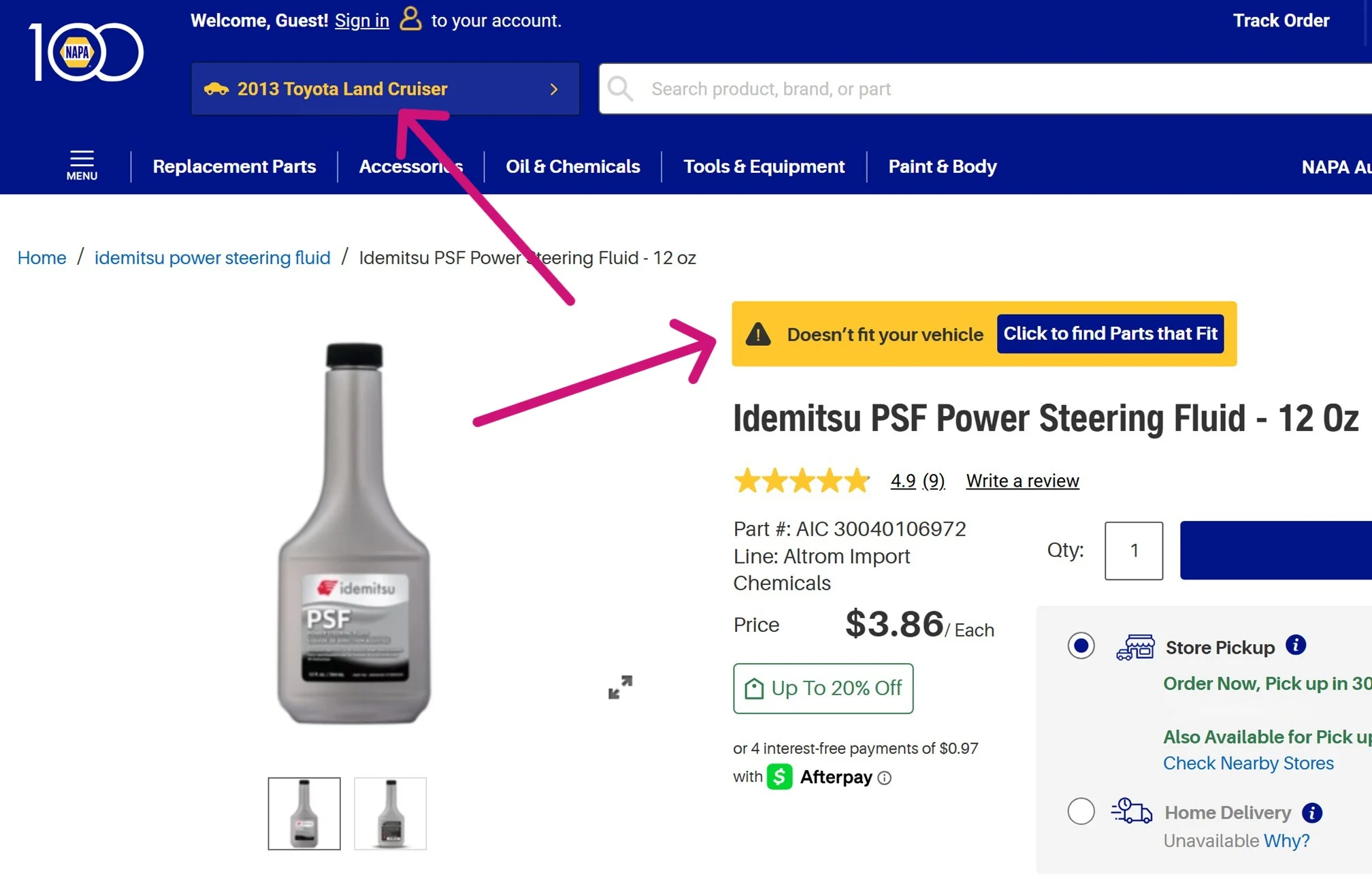

I agree. Also, just FYI, Napa does not recommend the Idemitsu Power Steering Fluid for use in my 2013 Land Cruiser:

Probably says that because the owner's manual doesn't explicitly allow it.
Then again the manual calls for DexIII which doesn't seem to be in a 200 from the factory.. Or if it is, they got it without the dye.
I wonder who in Toyota Engineering that CCN got that information from, or if he's just stating assumptions as fact.

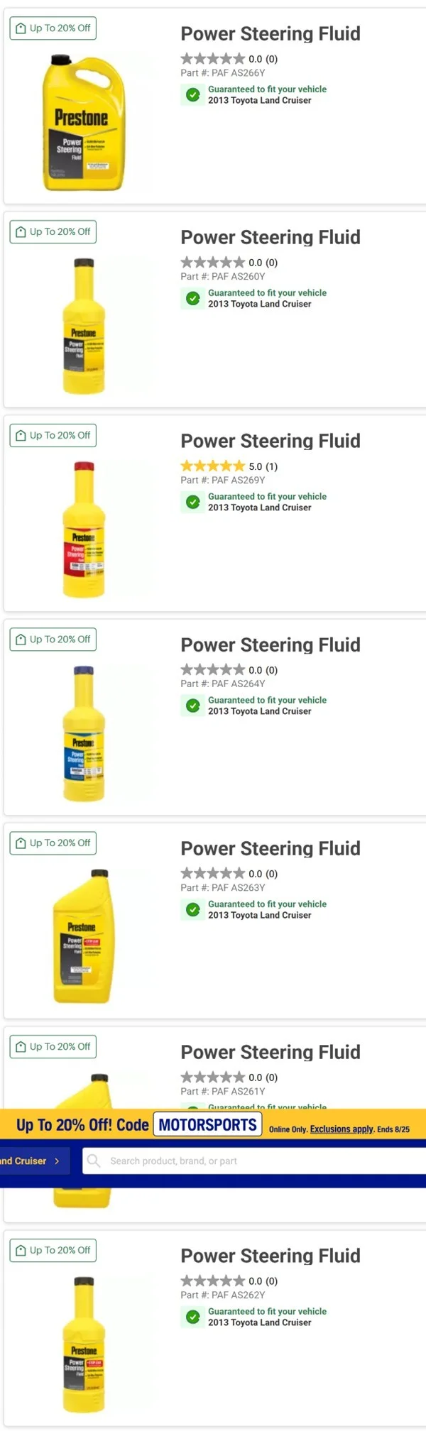

Napa do recommend other "Power Steering Fluid" products which make no reference to Dexron III compatibility:
Again ... :meh:
I decided on Mobil 1 Dexron III compatible ATF as my PSF substitute.
Again ... :meh:
