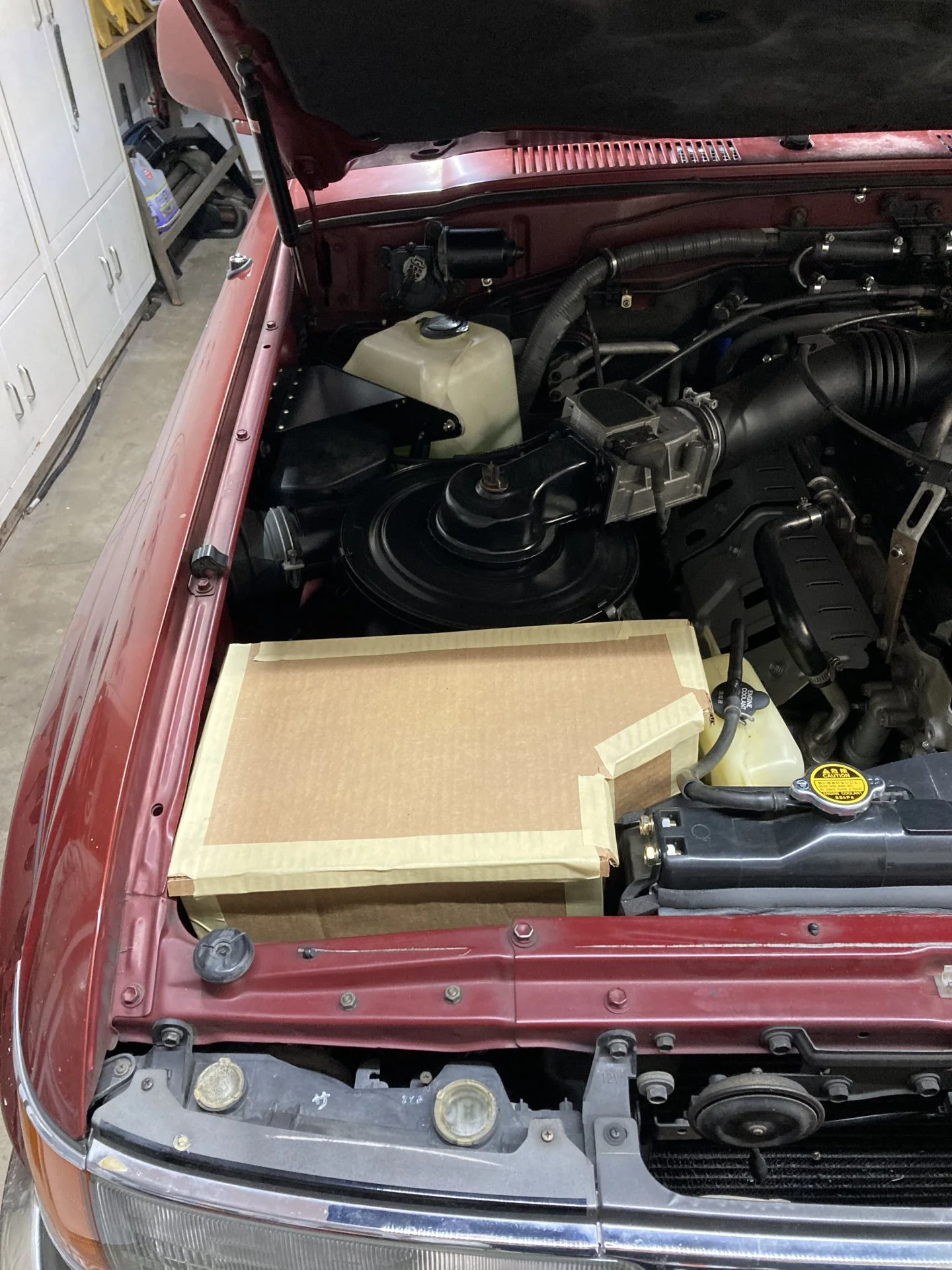

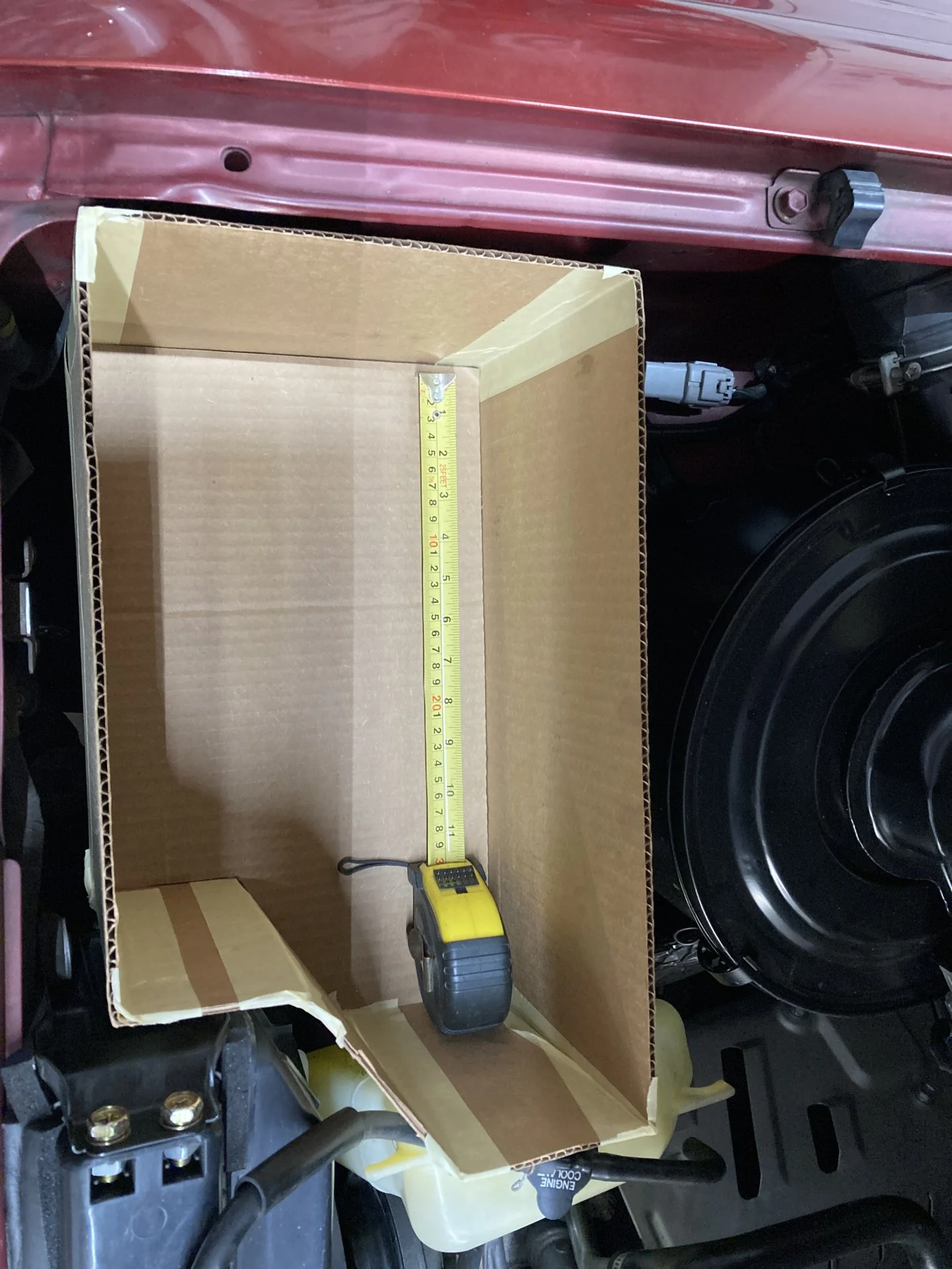

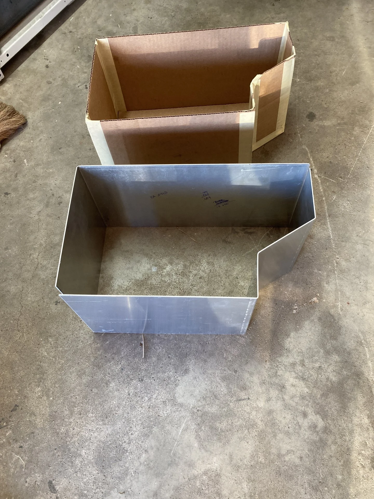

Prototype #1

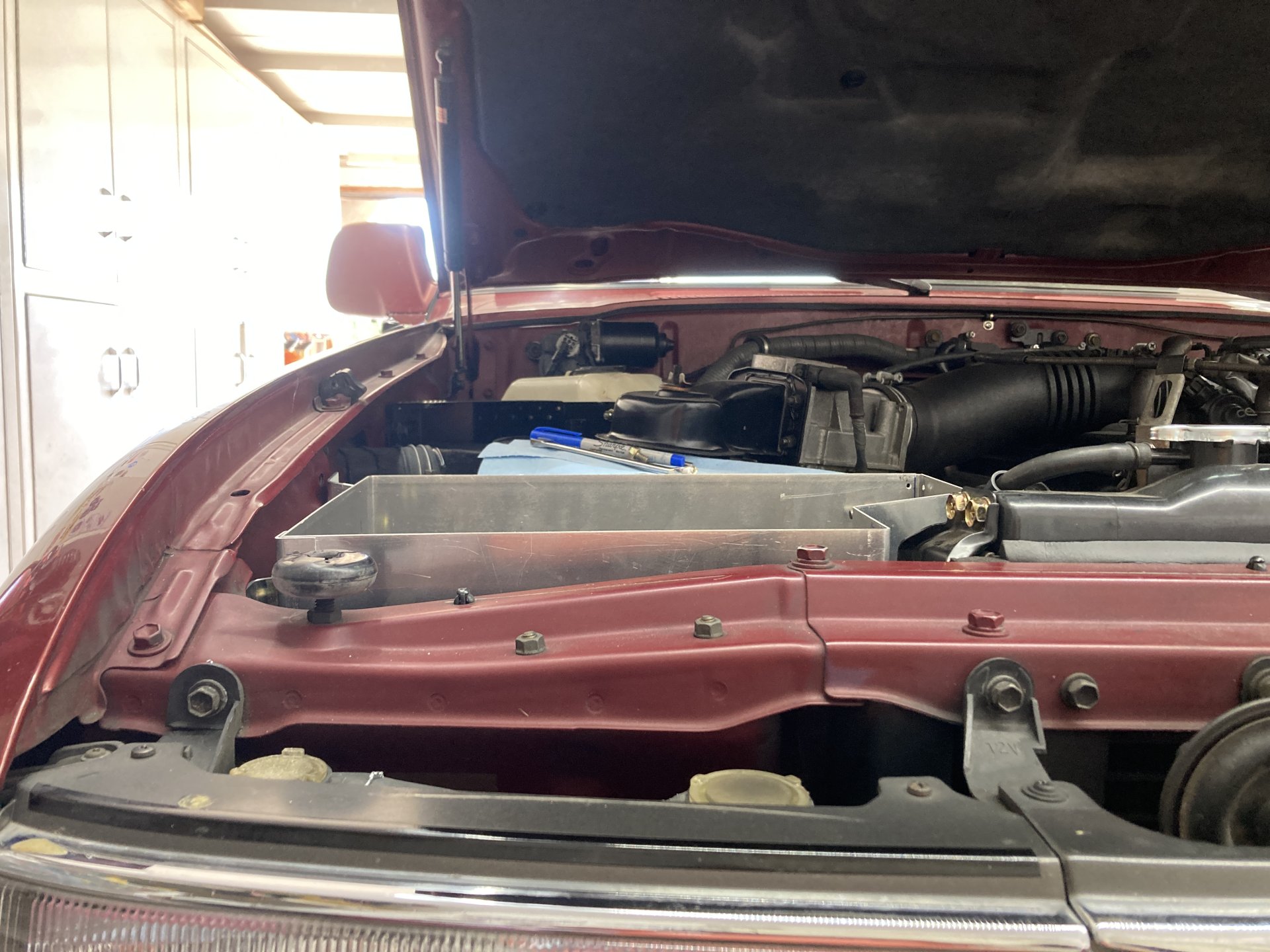

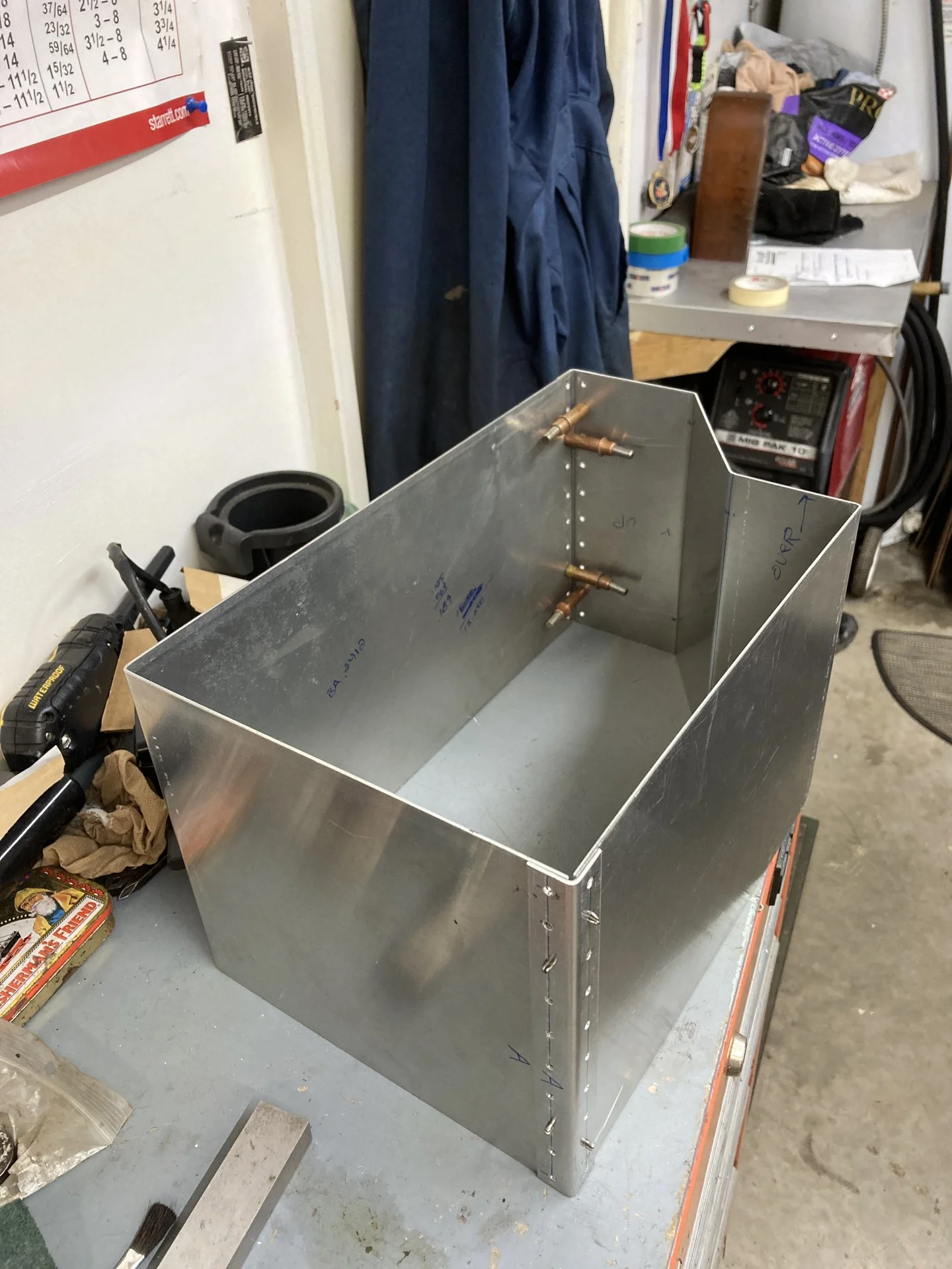

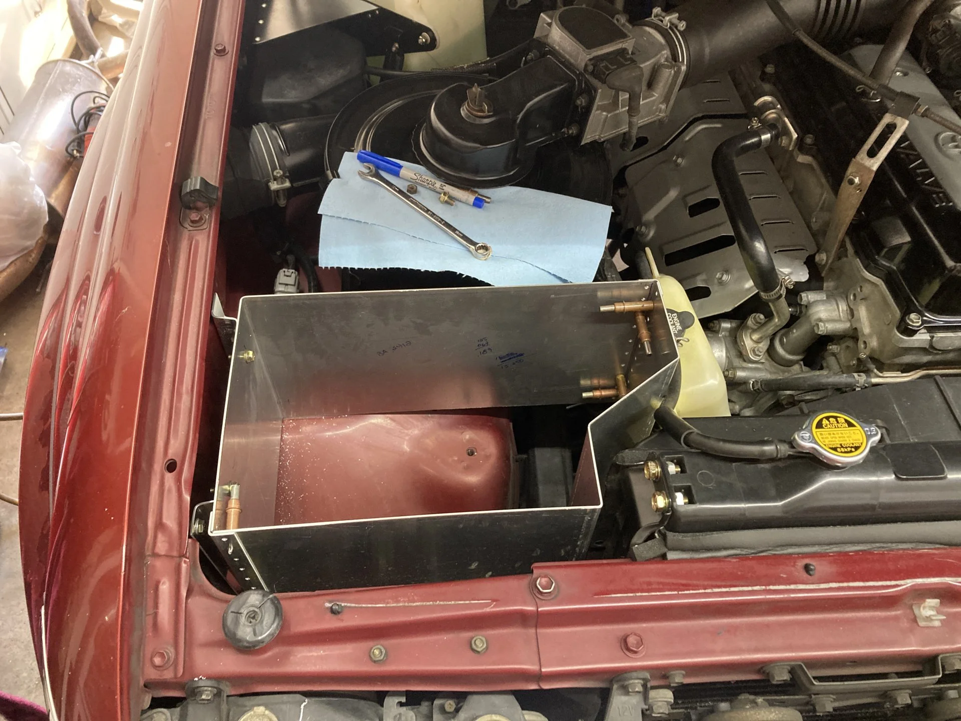

It can be a tool box/whatever, with a waterproof latching lid . Or I suppose one could leave the lid off and use as a second battery box? A group 27 will fit with ease.
15.5x9”x8”d
.050 5056 or maybe sheet fibreglass
