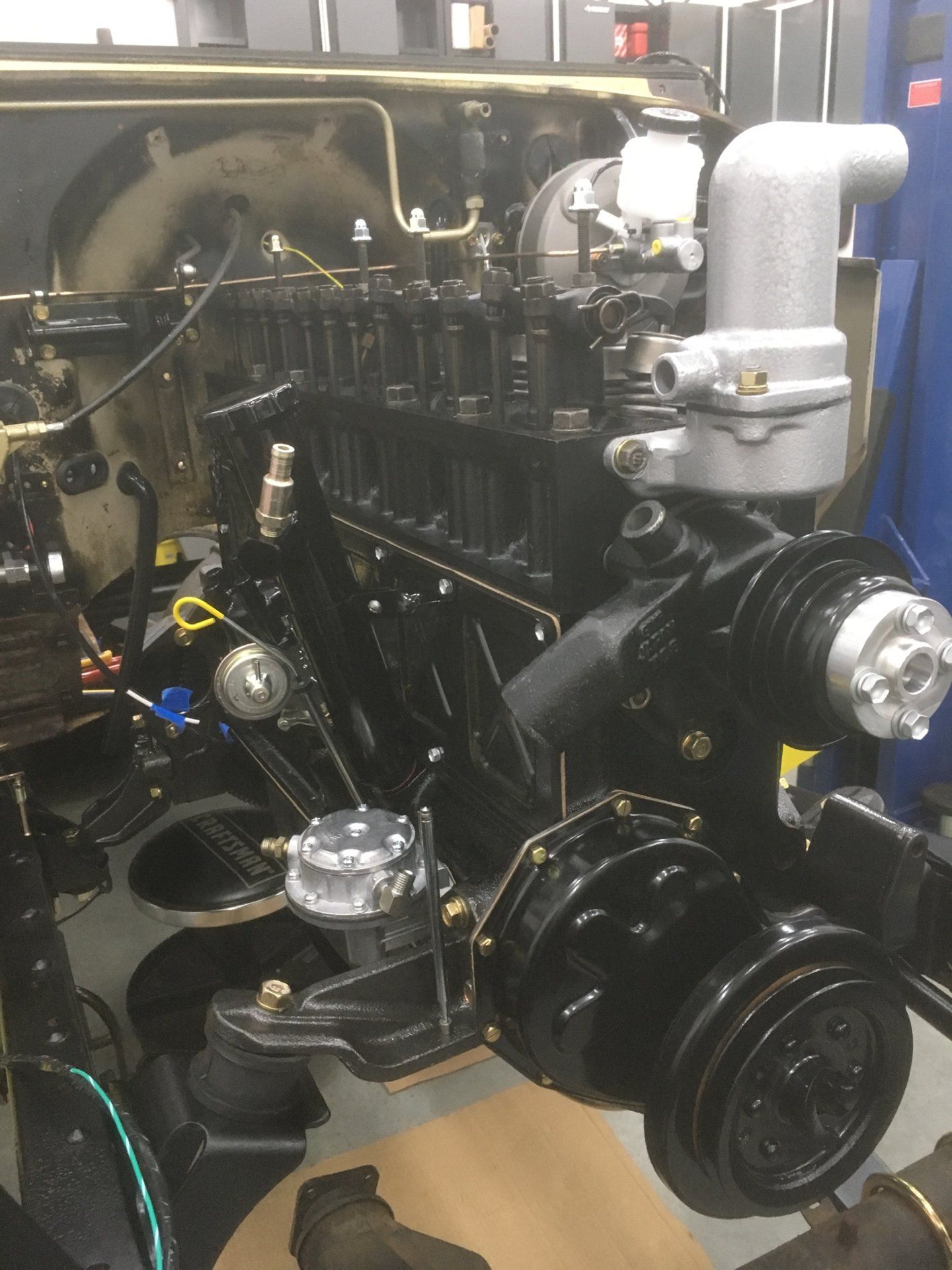

Stabbed the engine in this evening and got the pilot bearing and flywheel installed. Always be sure to pre-fit the pilot bearing onto the transmission input shaft...mine required significant sanding with an emory cloth. Probably since the previous pilot bearing was separated into two peices and some balls with the inner race almost welded to the input snout.
