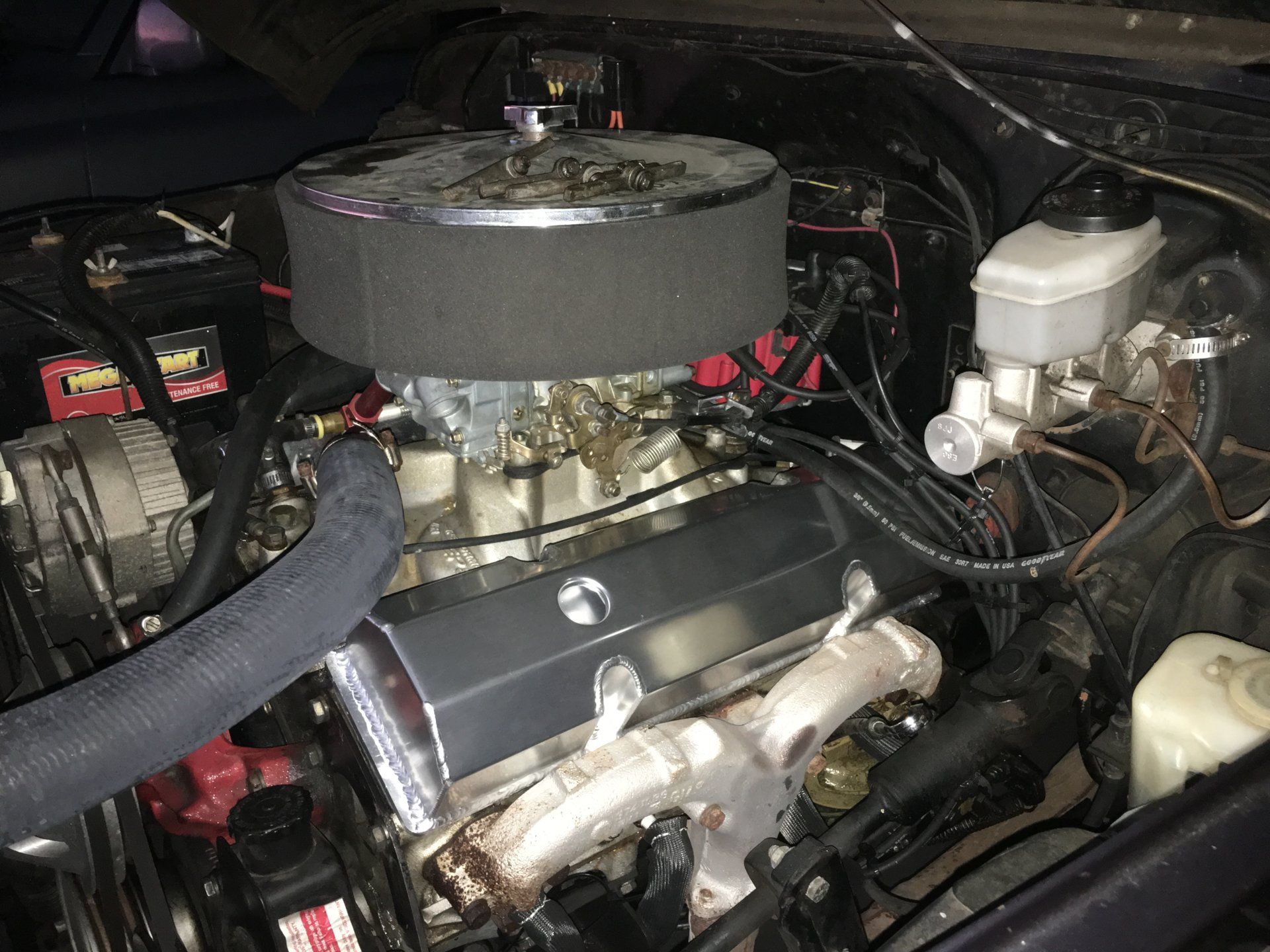

Ok. I got the tank al buttoned up on my 82 first gen.
Well for some reason I’m not getting any fuel from the tank to the fuel filter.
I figured I might of mixed the two fuel lines when I connected everything up so I switched them around and as well as the ones at the filter and still no fuel coming from the tank to the fuel filter right before the carb.
Another thing that I can try is to replace the mechanical fuel pump?
I figured it be a simple thing. Change out the tank and connect everything back the way it was. Just with a new tank. Well it didn’t work out that way and I’m kind of stumped now.
should I replace the fuel canister? I don’t think this would be the issue since it wasn’t a problem before but I could be wrong.
Any ideas or something obvious that I’m missing here?

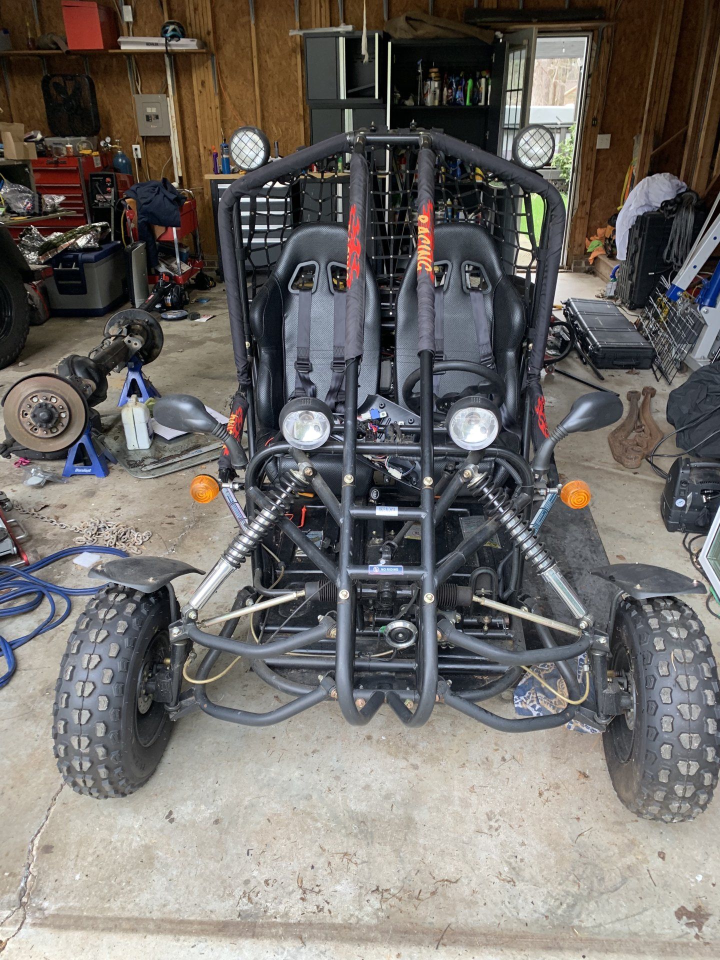

Thanks to the advise from Jonathan I bought and replaced the old carb on the go kart. Pretty easy swap. But I guess it’s not my day today. Have to replace the ignition switch now.
Tomorrow I will be replacing the drive belt on my riding lawnmower. Can’t wait to see what goes wrong with that. Haha
