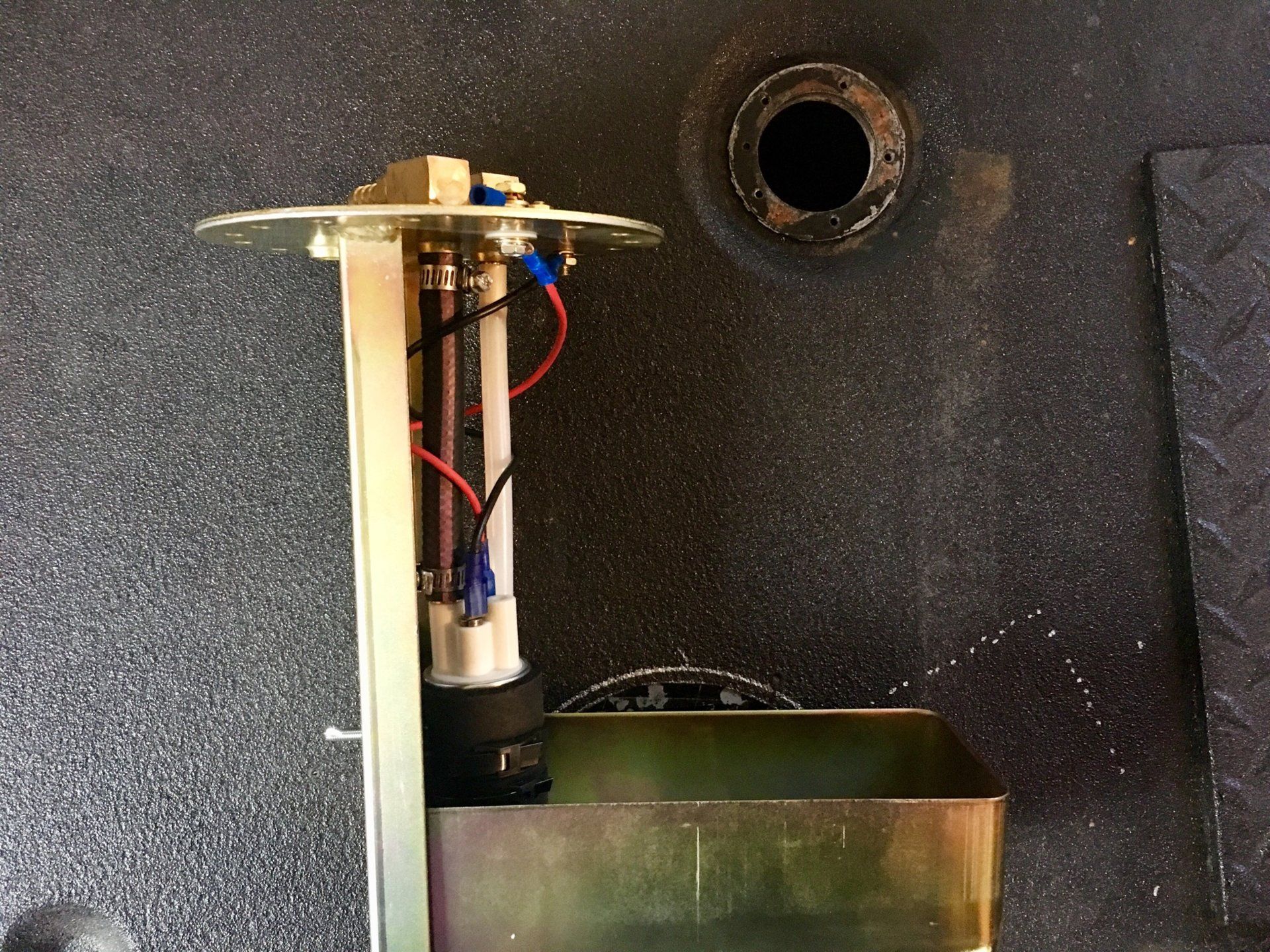

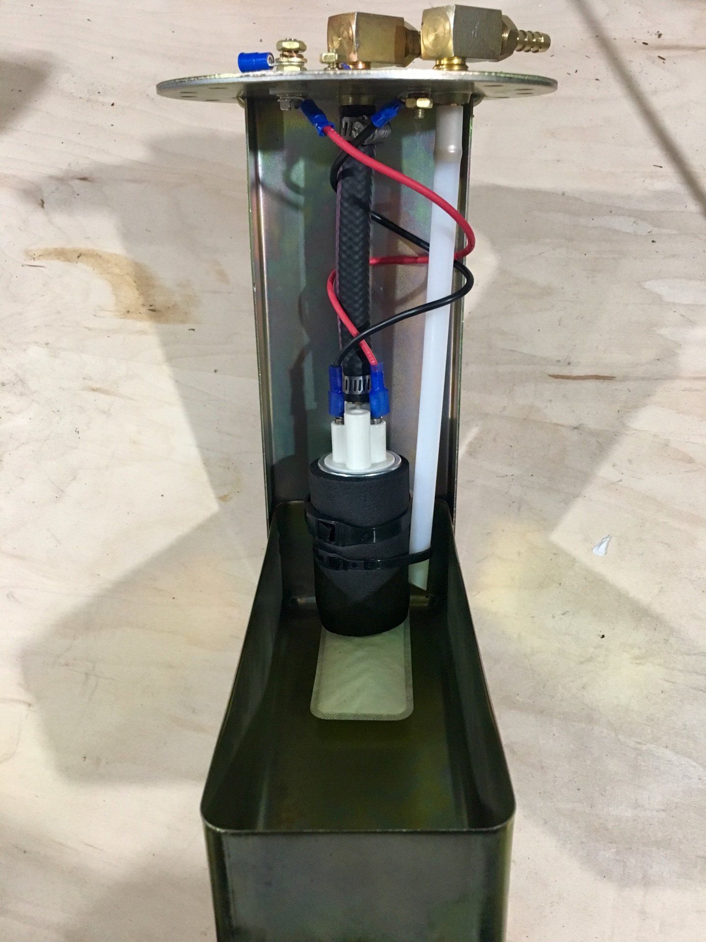

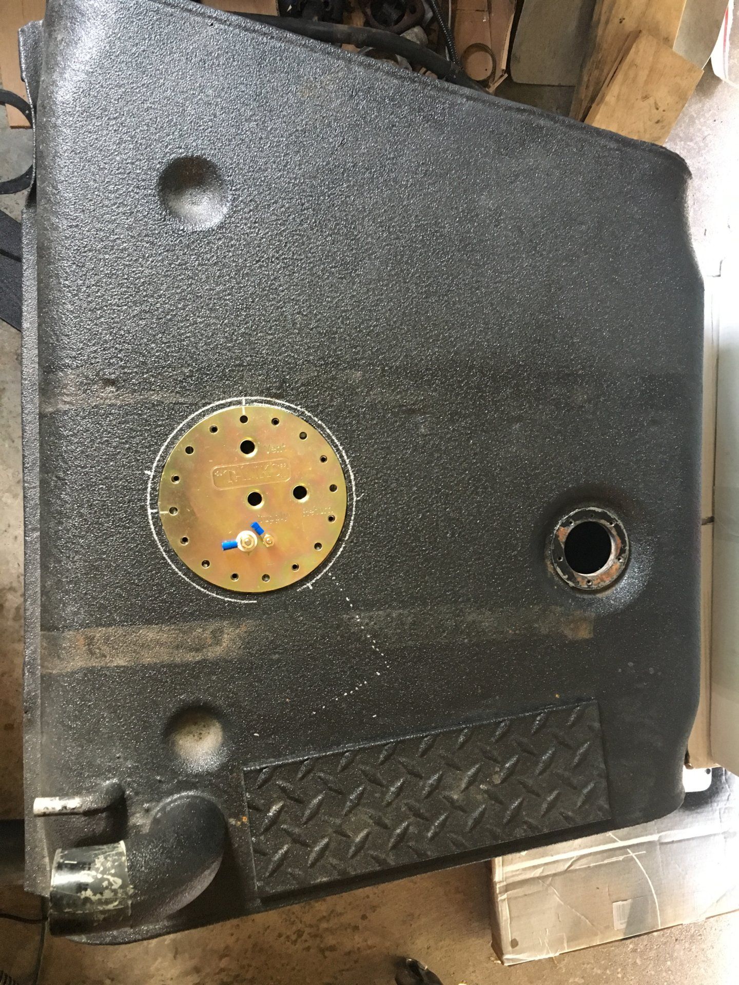

This is the same pump kit that Stan linked to. It’s a “drop-in” as you can get.
Just do it!
X2!!

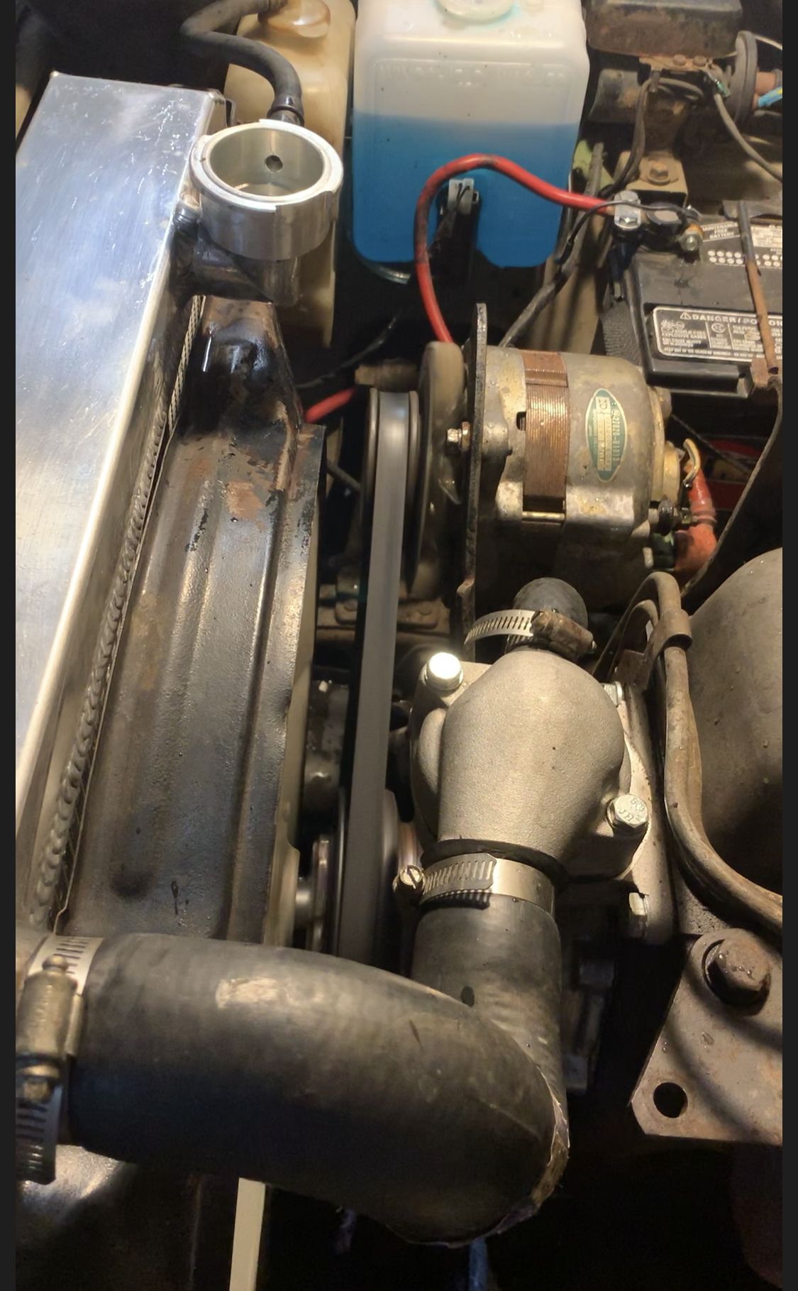

Reinstalled the water pump and burped the cooling system again. Started up great and ran cool so that’s all a plus. Now there’s a nasty whistle coming from somewhere behind the carb. Not clear if it’s the break booster, PCV or an exhaust leak though as squirting water didn’t change engine rpms or even change the whistling. Ear plugs, R2.8 swap or 2F rebuild look better by the day.
Probably between the carb and the intake manifold. Try tightening the carb down a little tighter and see if it goes away. That is the whistle problem 99 percent of the time with the factory carb. I know you have a weber, so it could be something different, but that's a good place to start.
