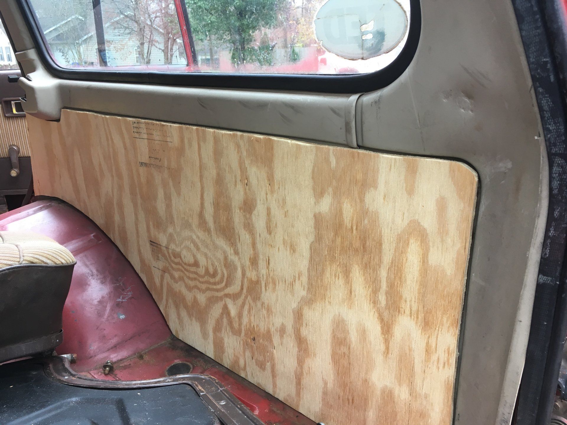

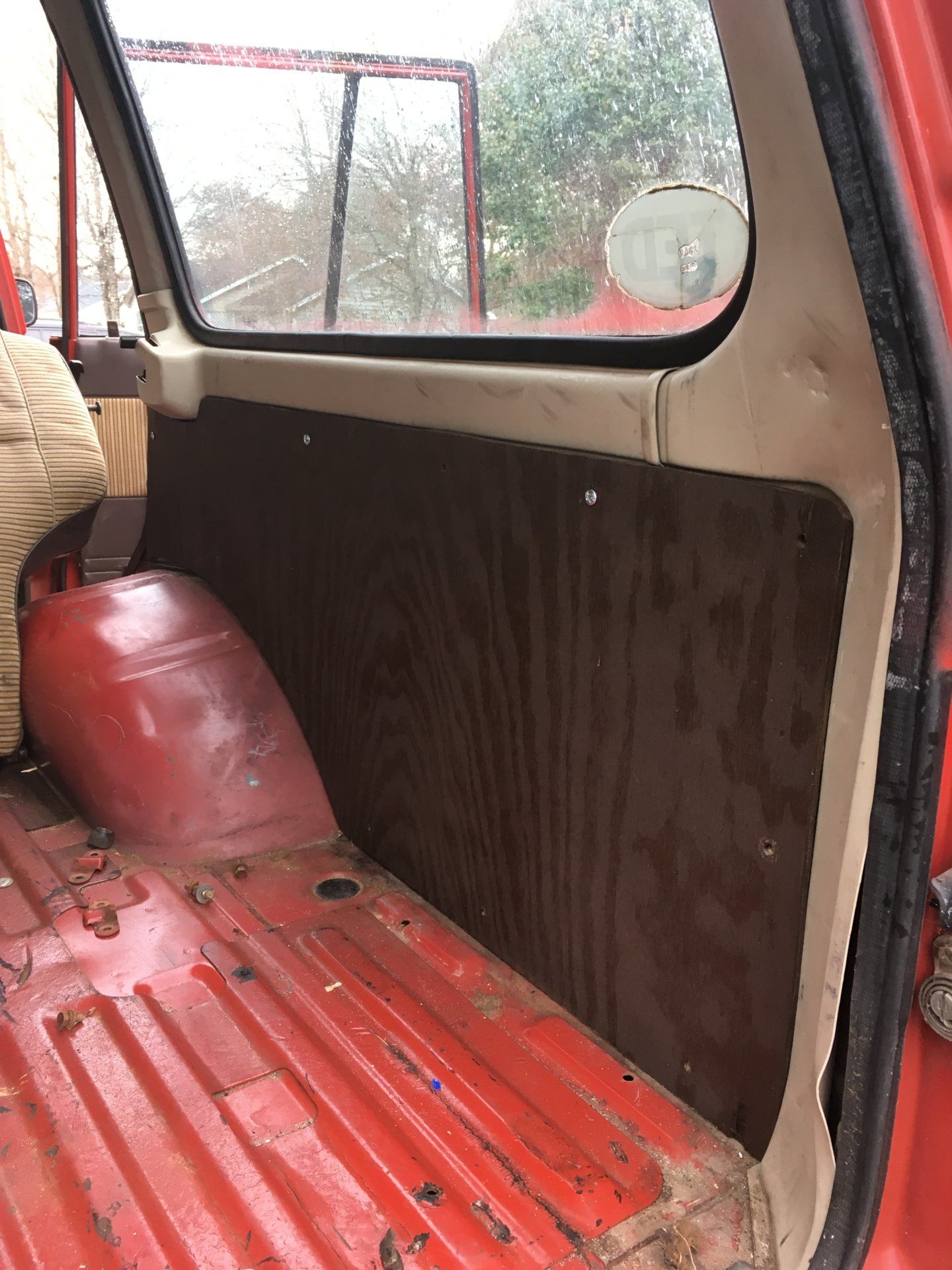

But hey on a brighter note got my panels done I’ve been planing to do since this spring! Carpet kit gets here tomorrow and I wanted to get these in so I can put the interior back together and see how everything looks.
Quick and dirty paint job to add alittle sorta matching color. Thanks to the paint can I saw from the rushing turtle threat @roadstr6
