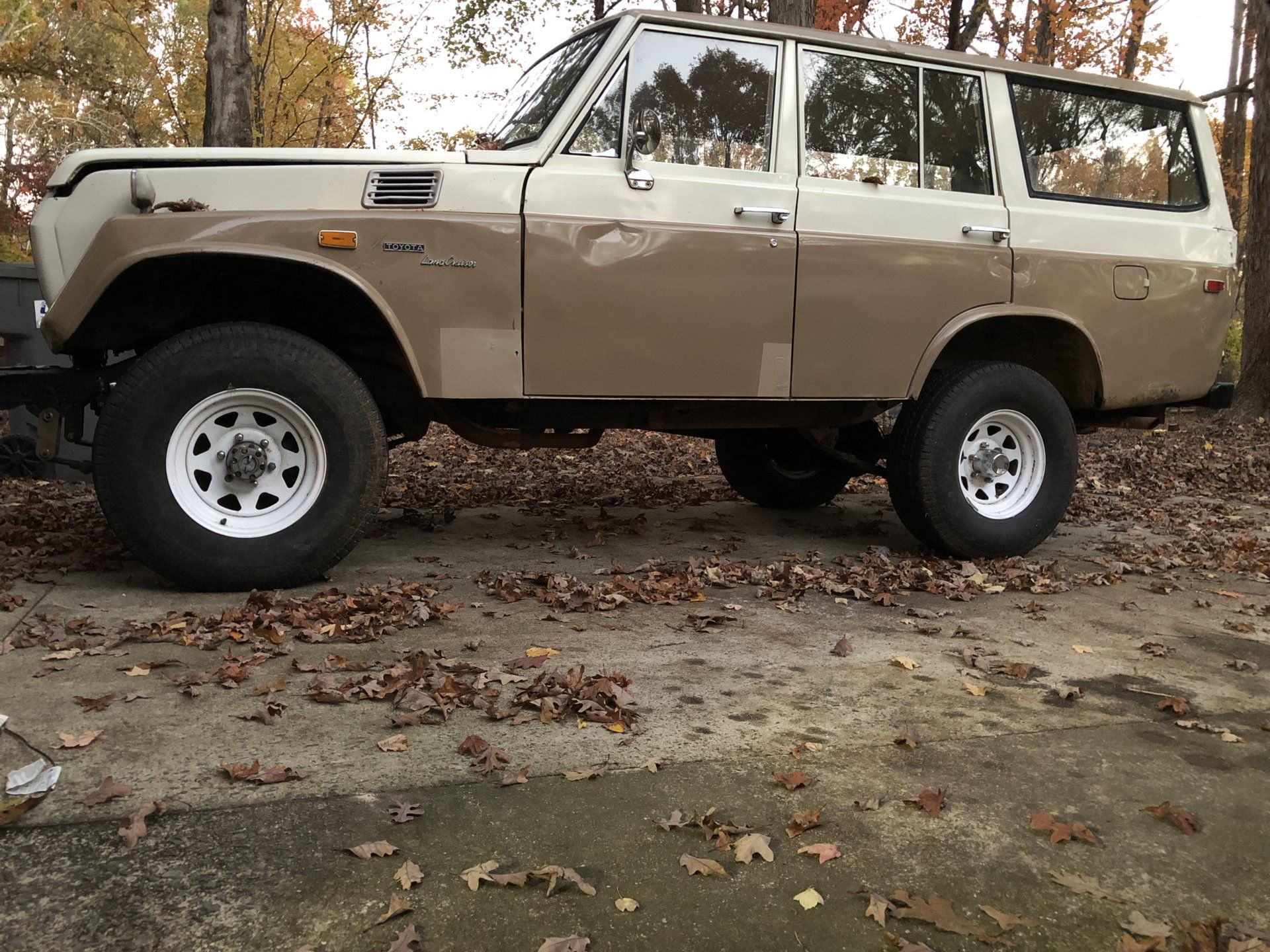

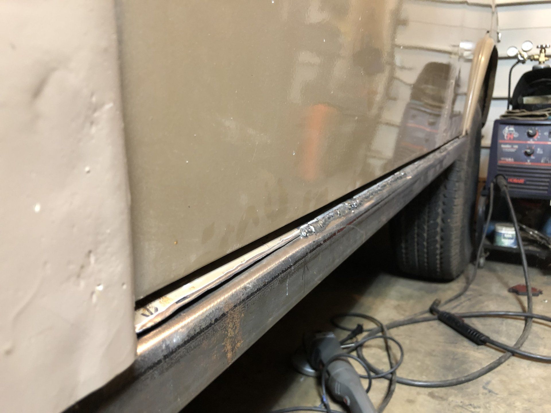

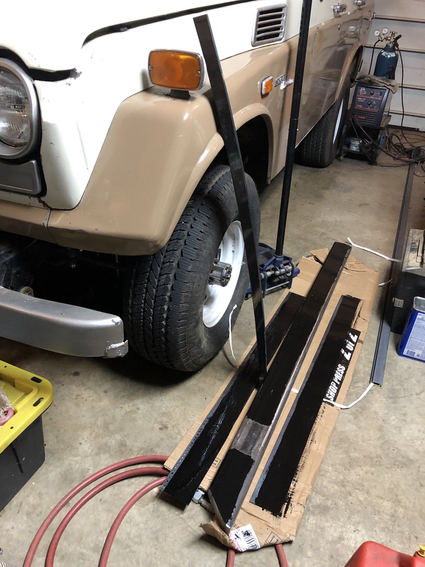

Piggy progress. More info in the “Bucky” thread in my sig:
