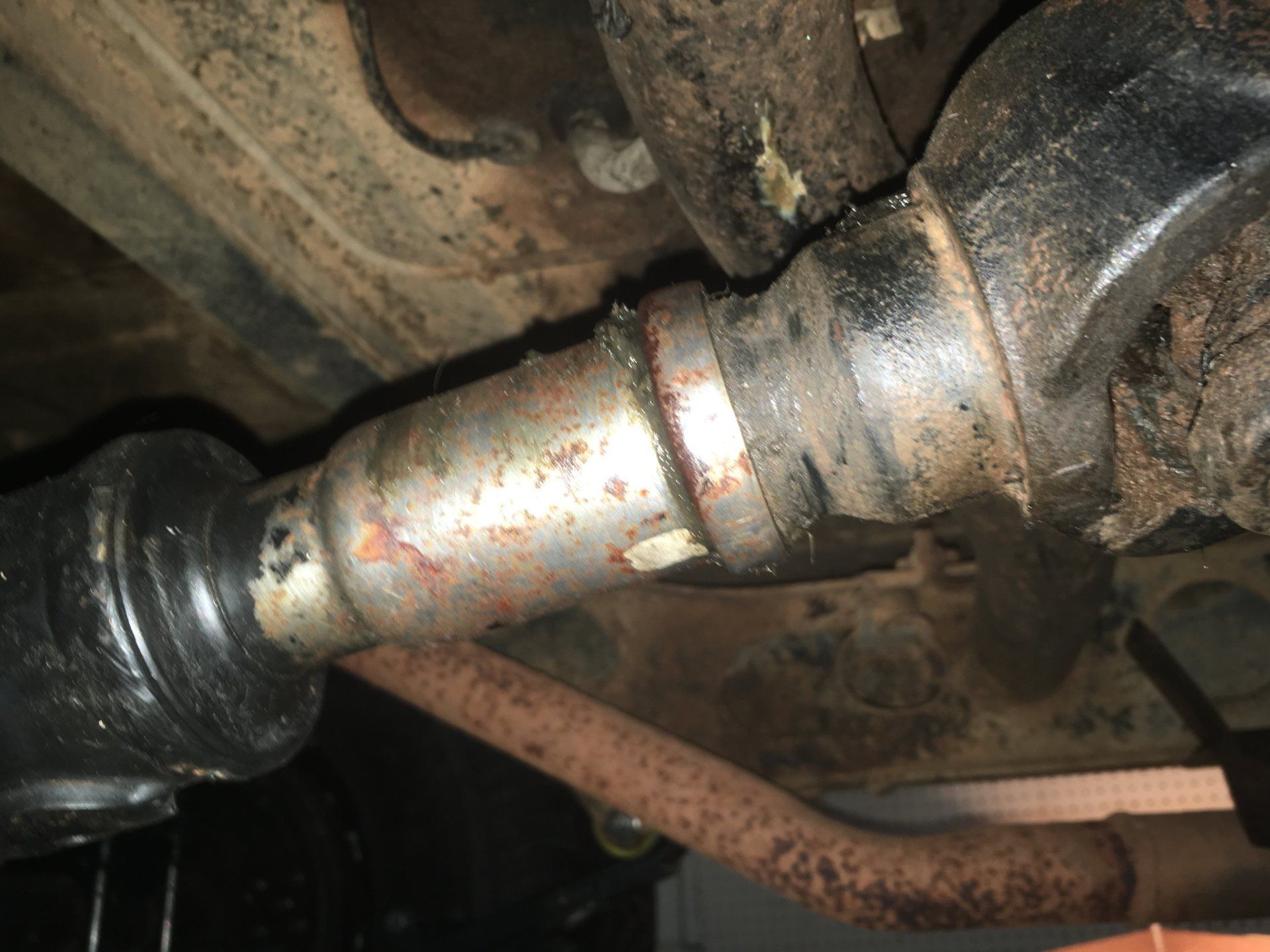

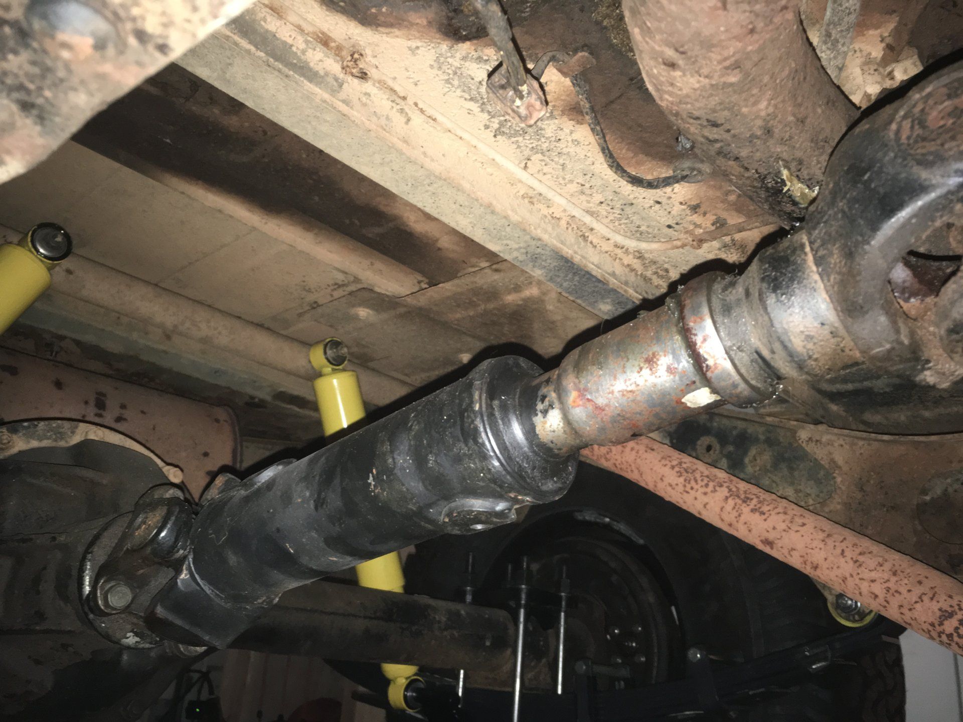

Installed a new OME suspension on the 40 this weekend. Lots of cursing and use of the bfh but it’s done. Now the only question/concern is that is the driveshaft too long.
Background is the PO put a set of extra long shackles then used a spacer below the axle perch to move the axle about an inch rear. This allows them to stuff 33s on it. The issue is that in installing the axles back on the rear I had to pull the Grease zerk off the drift shaft in order to release the pressure to get the yoke back in. However I had to really wail on the axle to get it to move into the spring pins. The driveshaft used to show about an 3/4 to 1 inch of splines now it looks like it’s showing nothing. It’s very possible they had it lengthened. I know compression should lengthen the shaft but it feels like I’m starting too far in and am worried about the t-case.

Anybody hillbilly enough to do a big shackle lift on a 40 and fab up homemade spring pin relocation brackets is not going to go to the trouble to have a driveshaft lengthened. I'd wager that your DS is all original. FWIW, the driveshaft actually lengthens as the suspension is compressed as a result of the rearward action of the shackles. Again, I think you are going to be okay. How does it drive? Any weird noises or vibes? Congrats on a tidy install and for correcting the PO mistakes.

I’m with you I can’t imagine that they would have spent the $$ on a new ds. My thought was maybe they grabbed one off another vehicle.
Didn’t drive it last night as I finished up late Sunday and also my garage door broke over the weekend. So no test drive yet.
Thanks for the confirmation gonna fix the door then take it for a spin.

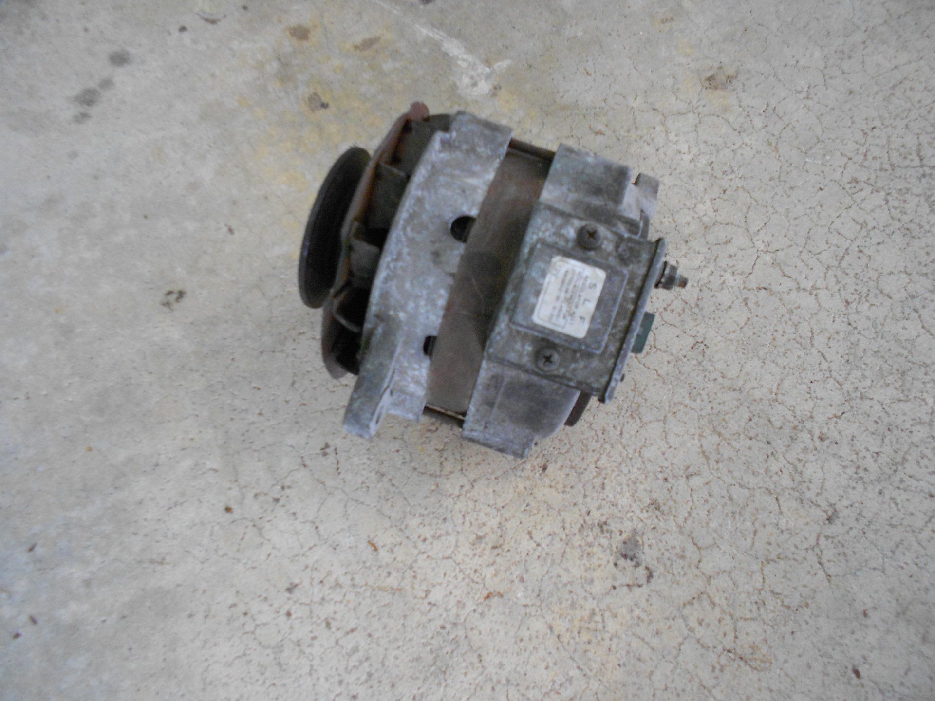

Thank you to @David1947 for selling me an alternator for my 60. Big thanks to @fj40z and @JohnVee for mudshipment.
Installing this killed three birds with one stone, gave me power again, miraculously fixed my mysteriously broken horn that has been wracking my brain and wrench confidence, and now that the horn works I can finally pass inspection and get state paperwork again!
