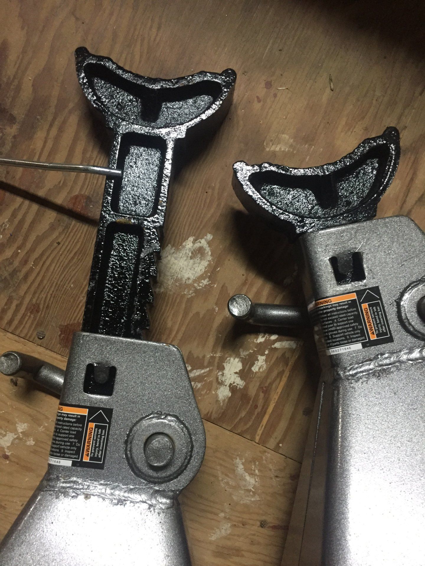

are you saying you can't get it up to stay up
or
it's stuck in the down position
and i really DON'T want to know the answer to either of those questions
looks like someone took it apart then put it in backwards.
you should be able to pry the tap out ( to straighten it ) with a largeish flathead screw driver or a tire iron. pull the head up past the ledge and then bend the tab back in.
if you have a welder weld a bolt to the tab, straighten it up, then cut the bolt off and bend the tab back in after you raise the head up past the ledge/lip.
if need be, bring it to the barn i'll fix it for you.
Ding Ding Ding Ding Ding! Yeah, some dumbass hammered in the retainer tab while the upper arm was all the way down, trapping the tab in between the upper and 'stupidly close to upper' stops. D'oh! Not enough room to get a screwdriver or prybar in there to lift the tab. He banged it in good. And, of course, it's too far of a reach to go in from the top. I tried to put a washer and nut inside and use a bolt to lift it up but the only bolts skinny enough to fit twisted right off. That's some damn strong Chinese metal. I thought about drilling and tapping a hole in the tab to use a screw to lift it but the welding a bolt to pry it up is a better idea that 'preserves the integrity of the product as designed'. HA!!! I was mostly interested in seeing if anybody could even identify the problem. I'll deal with it here one day.
Hmmm. Challenge: Can @Rice or @stevezero turn this into an enabled moment to justify a welder? I mean, that thing's like $15 if I had to replace it!
He could just JB Weld a bolt to that tab. Let it dry for a day or two and then bend it out.
Then cut it off with a hacksaw or a grinder and bend it back in.
