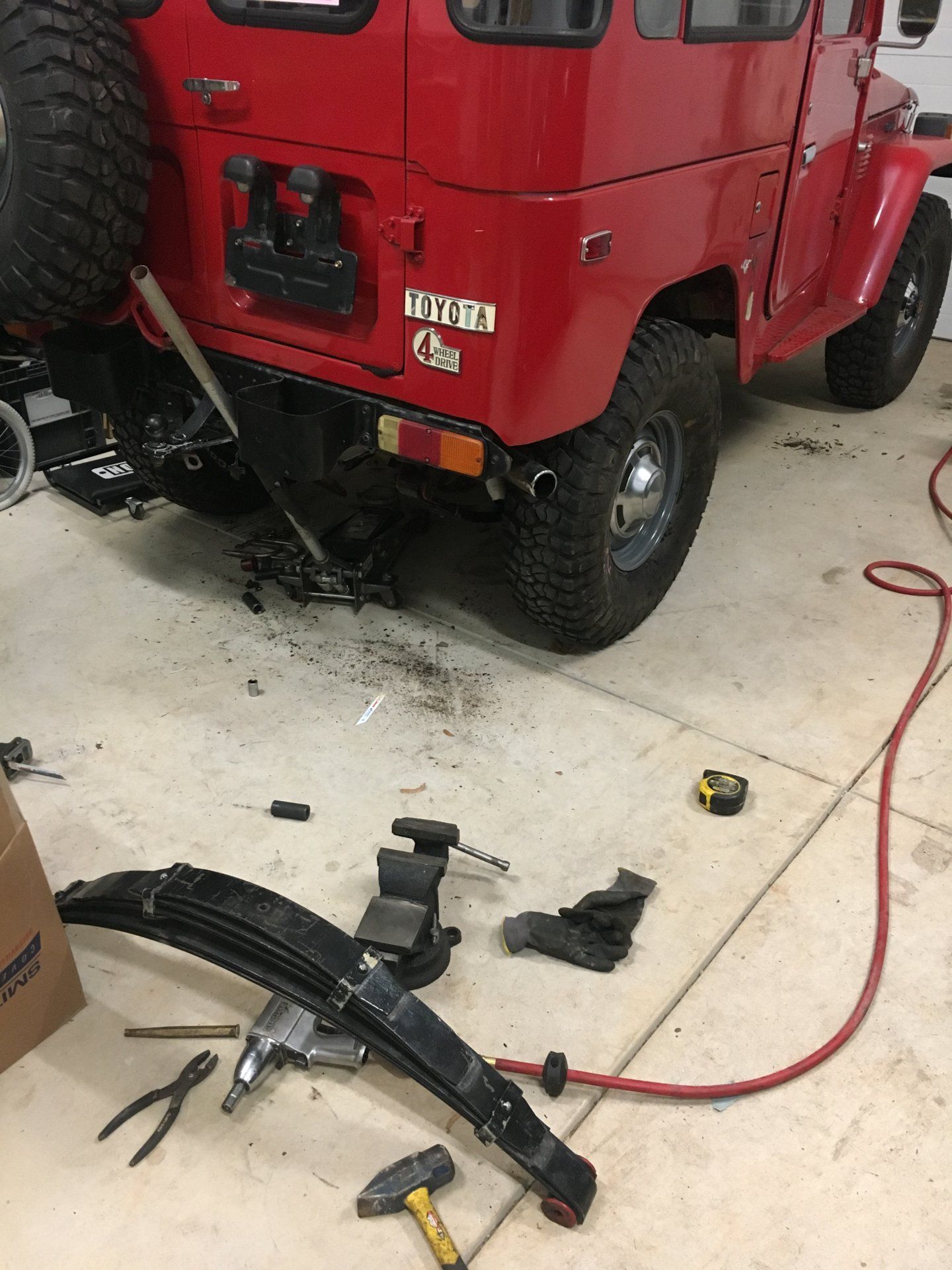

I am tired of the lean to the driver side. After all the work i decided to arch my rear left spring and try to get my truck straight.

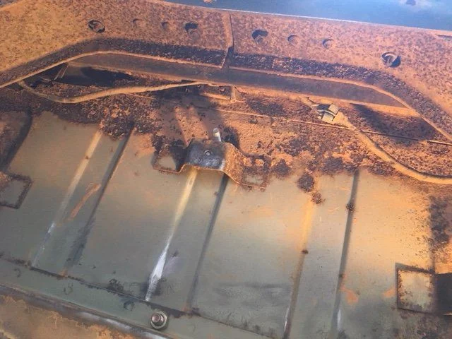

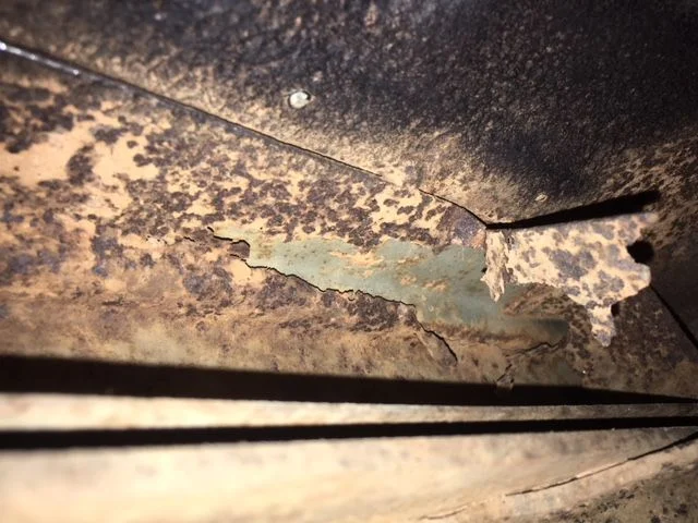

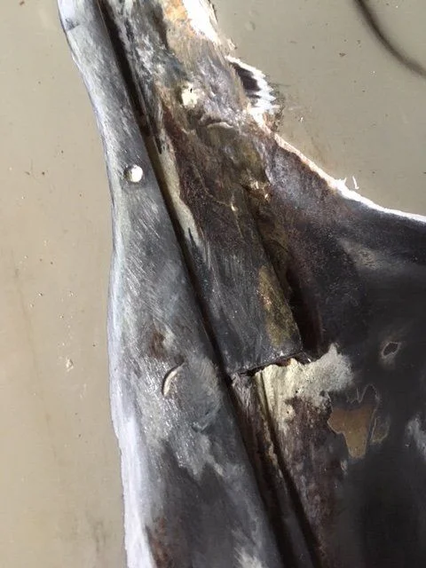

While awaiting the trimming of the POs prior custom drive shaft back to stock length, I decided to tackle a bit of the underbody rust today with the cup brush, angle grinder and patience. I was pleasantly surprised to find that 3/4 of what I thought was rust was actually crusted clay on top of black rubberized underbody spray that was peeling; however turns out from the bottom much of the rear sill is custom as well. To his credit he did tell me that the first owner told him he did the bottoms of the doors, a spot under the drivers pedals and he thought something to the rear sill. From what I can tell so far they just replaced new metal atop the old because after grinding away a glob of bondo where the rear sill meets the rear floor turns out to be just sandwiched metal with a few beads of welding. Made for a fun afternoon while I couldn't drive it anywhere. Always wanted to learn mig welding, guess now's my chance.

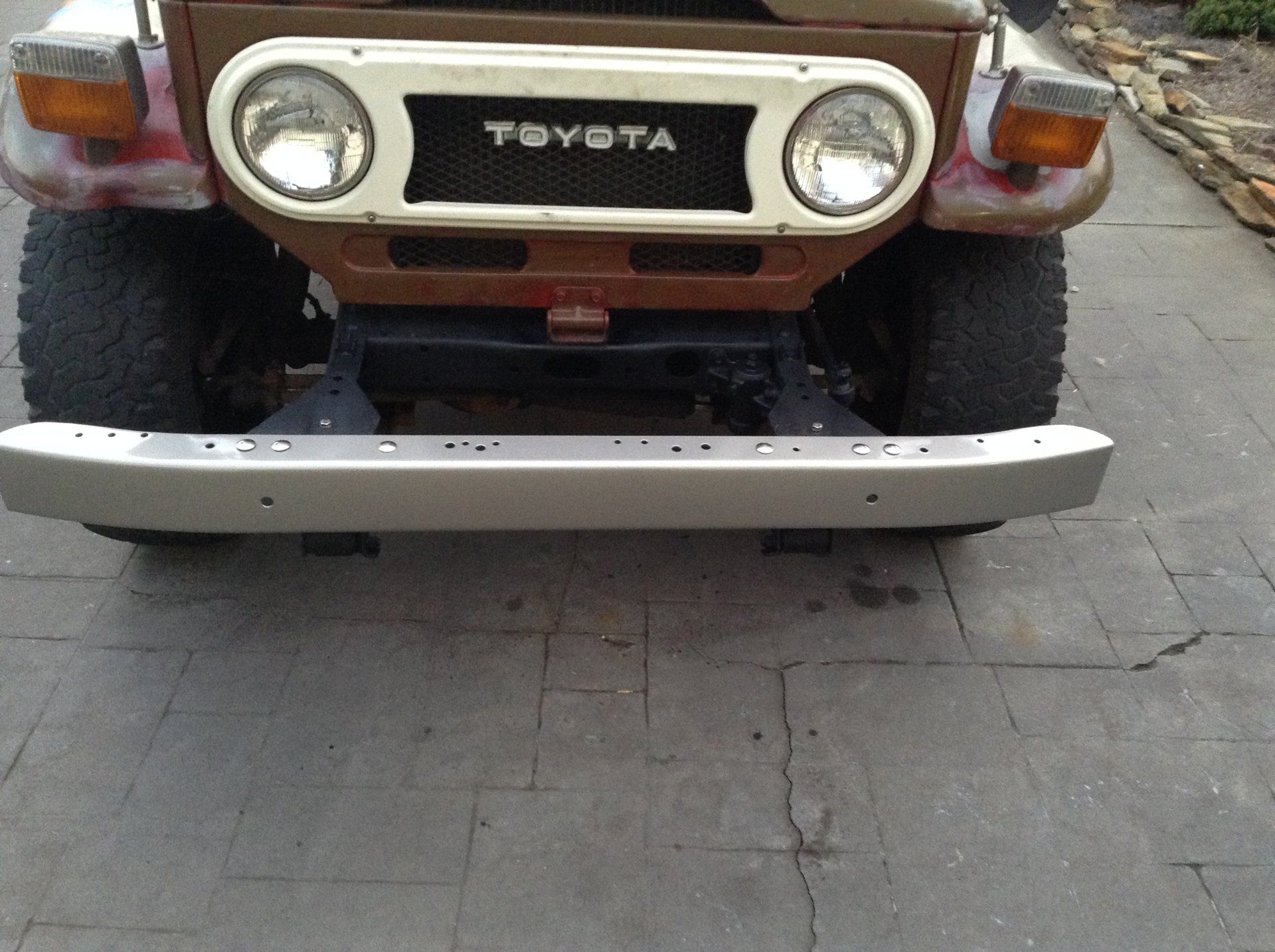

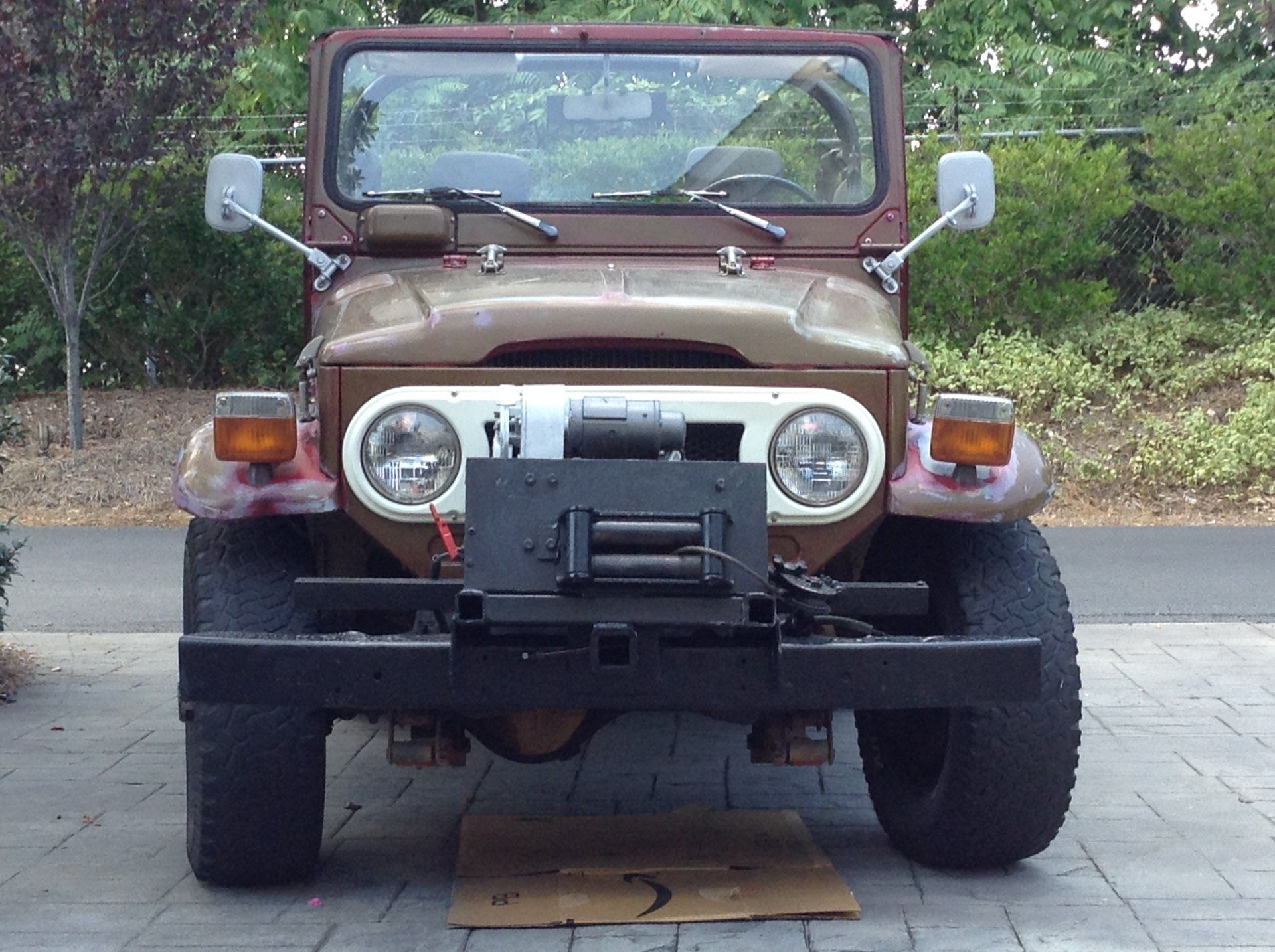

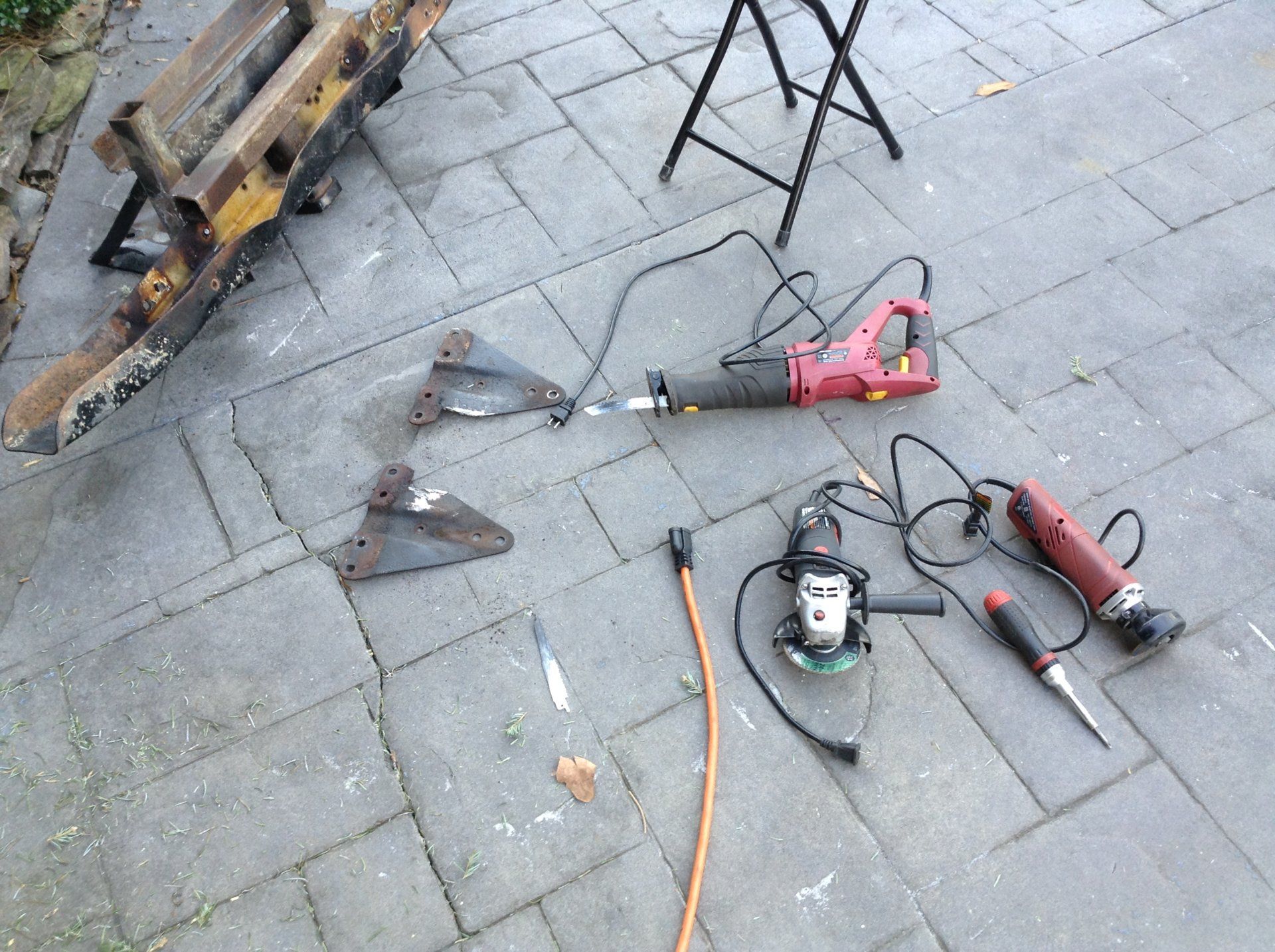

Gave my 40 a much needed face lift as my Christmas present to myself... finally hacked off the custom air restricting stadium seating style winch bimper and swapped in a new Oem bumper I bought from @tgadd several months ago.
Btw this process has taken me three days since the PO put this bumper on with no intention of it ever coming off... The weld beads were meaty as was his choice of steel supplies.
Today I salvaged the triangle brackets(kind of) and wire wheeled the sheet out of the front rails and hit it with some rust converter before installation.
I have dreams of welding a winch plate behind this bumper for my old pre-8274 warn (aka bell view or warn 5600) similar to how @Kayaker has his set up. But for now I will just bask in the glory of having a shiny part with a red and white Toyota sticker on my basket case of a rig.
The after - thankful for the guidance from @roadstr6 @fj40alex @Roxx @Rice @NCFJ @JohnVee
Btw why are ther so many holes, and even more bizarre is that there isn't any symmetry. Fog lights and license plate holder are the only factory add ons I can think of.
The before
In process
The before
In process
View attachment 1599713 View attachment 1599714
Very nice! That is odd how many extra holes there are. I'm picking up a new oem bumper one day next week and it'll be interesting if there are the same extra ones.
Btw, the triangle gussets are still available new. 52116-60010 $22.66 each from FAT.
