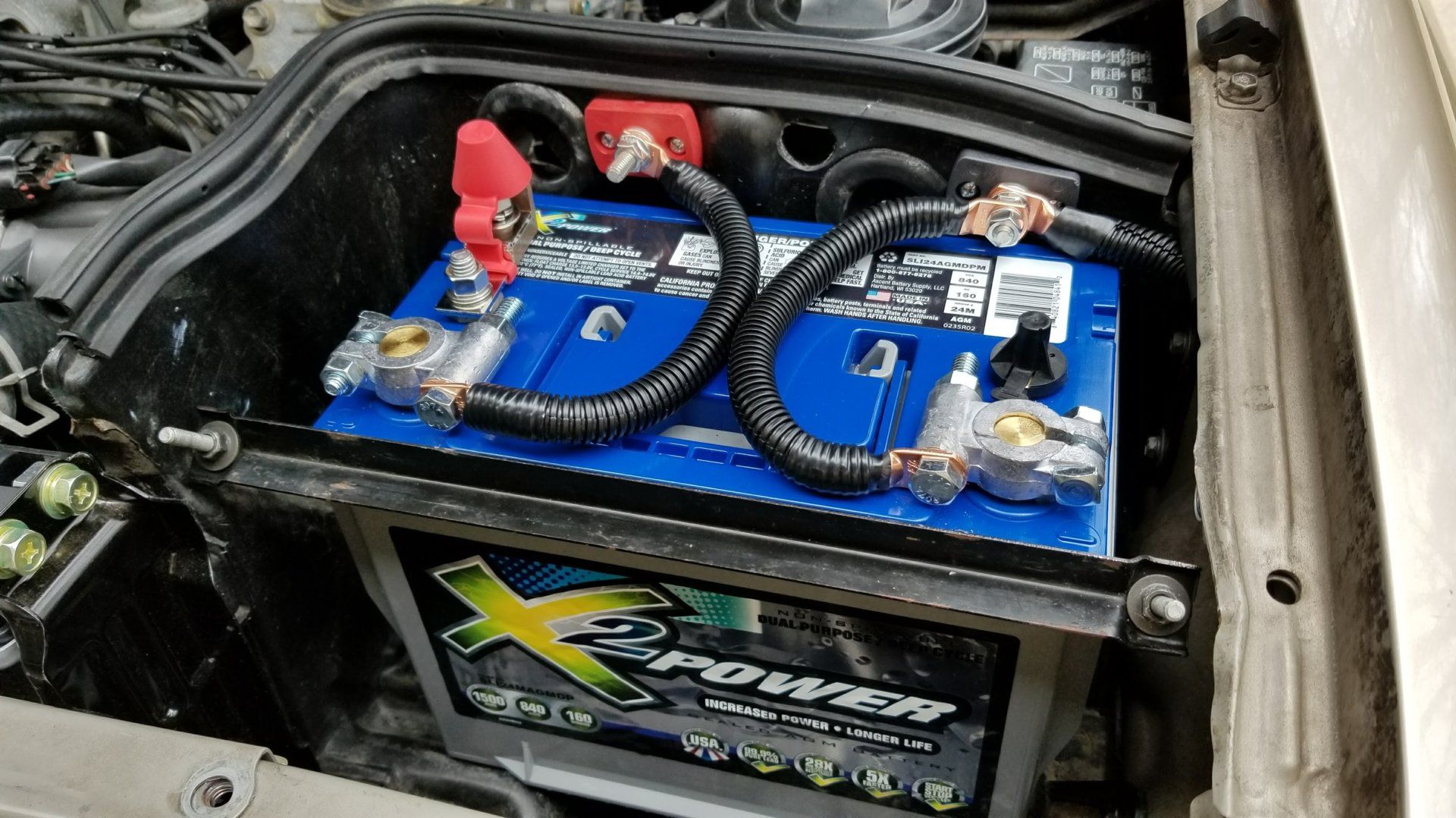

Completely re-arranged the battery on the '97 prepping for the dual battery as a next step.

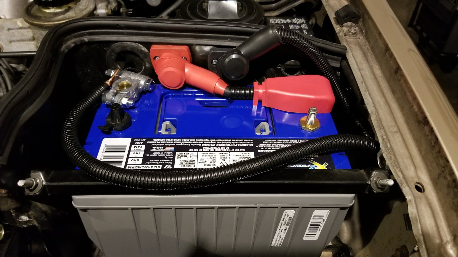

This was just not something I liked due to battery holder being close to terminals and flipped to fit (old set up):

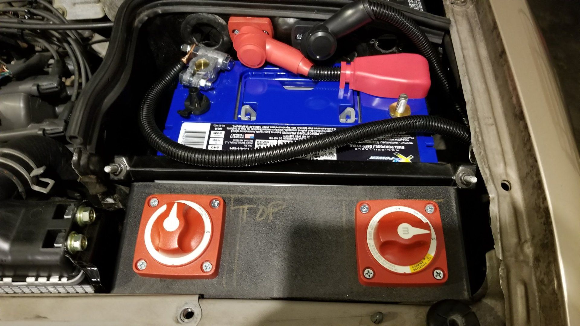

New set up with mock-up of switches for dual battery and winch - took a long time - had to do all new wiring to fit properly. Will use the 1/4" posts for the 2nd battery and ACR.

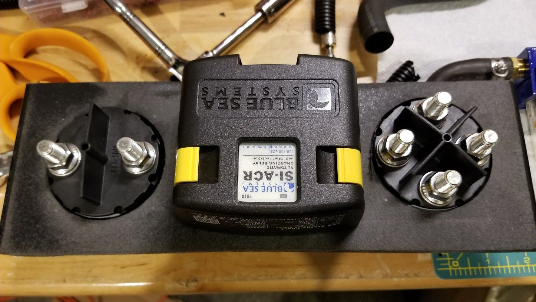

Underside of ACR set up - will mount the ACR underneath, upside down, and put the green light on top:
Good call getting the holder flipped back over and isolating the posts. Install looks great.

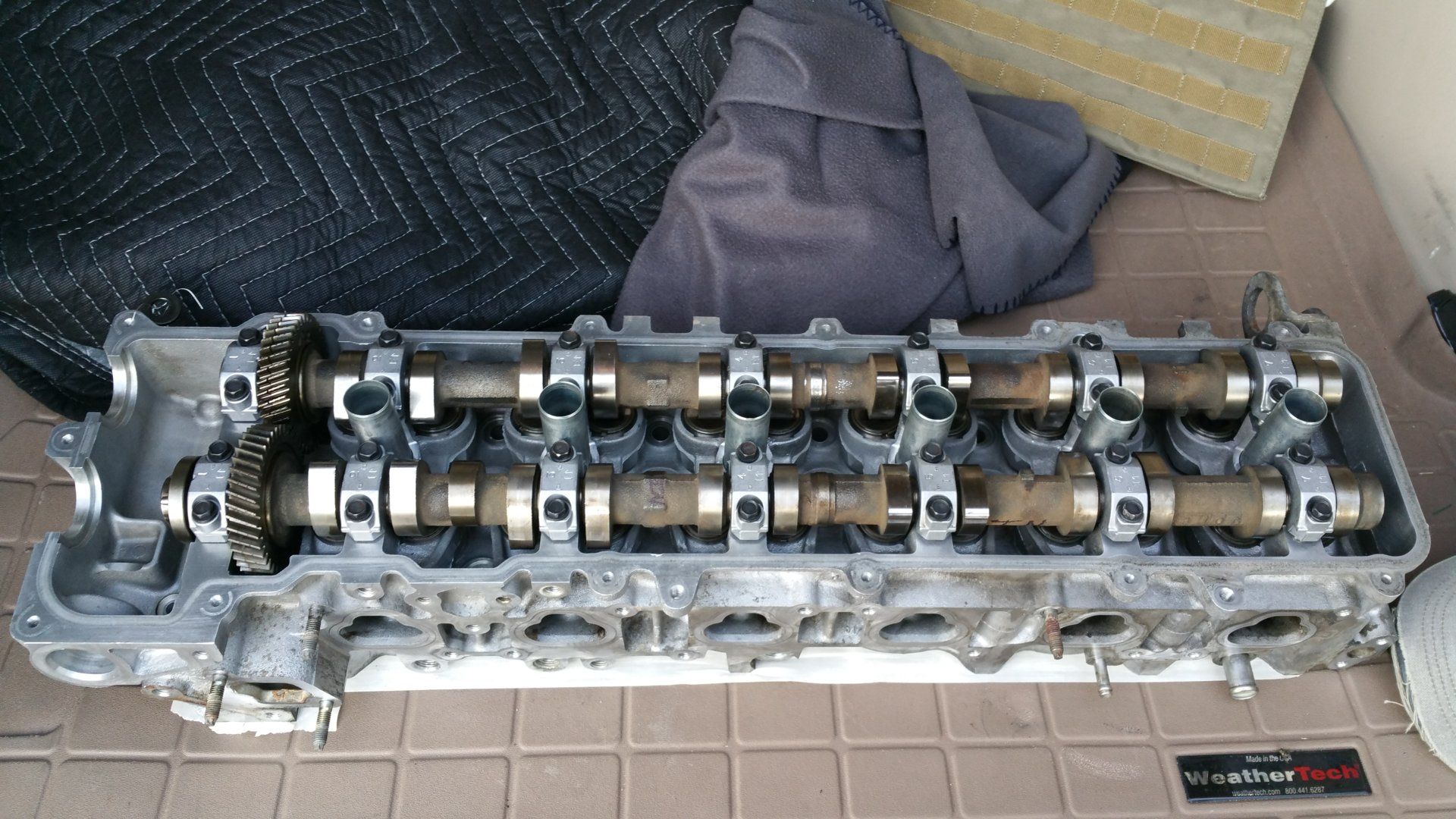

So, I picked this nugget up from the machine shop today... now what do I do with it? that's a heavy sumbeeyotch!
Actually, @Rice , do you remember when we tore it down if we got all the studs out? I havent looked in all the baggies i brought home yet.Will it need intake and exhaust studs?
No recollection.
Suggestion .... get some lube on those cams and be sure head is stored standing on end until ready to use (i.e. not laying flat)
They had it on end. it will get lubed and go on end if I can get a free moment where I dont have to watch something poop while attached to a leash
just for a learning moment.... why stand on end instead of flat? the mating surface?
I have some STP cam break in lube you are welcome too even though they arent new or polished.
Laying flat for extended periods can allow a head to warp under its own weight. The same goes for cranks.
