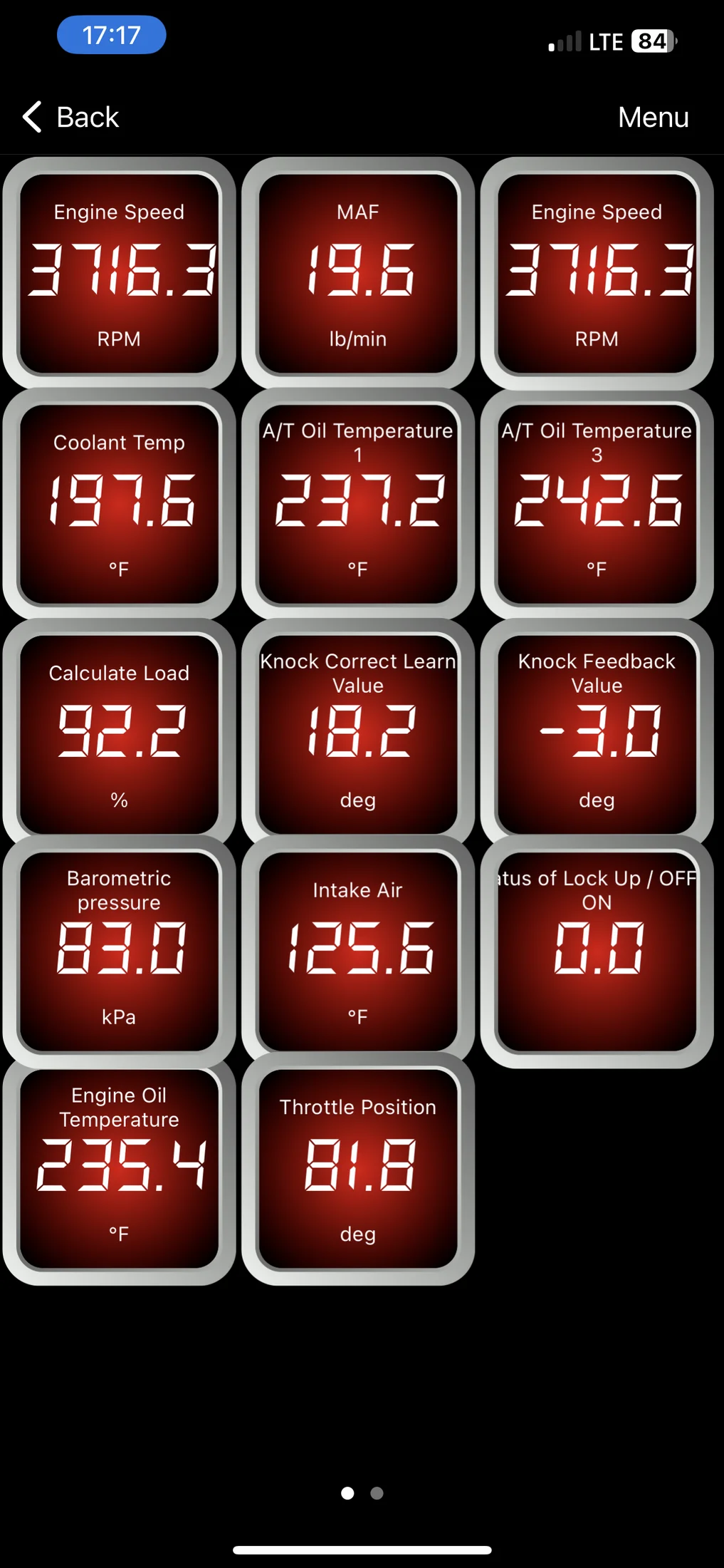

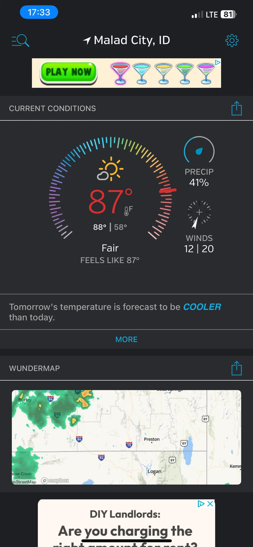

Was fighting a decent headwind and temperatures on the way home from Montana today. It was 94 on the dash. Keep in mind this was at 5000-6500’ of elevation.
Transmission temps with the 8 speed were no worse than previous trips and didn’t see much over 240 in the pan. This was with my 315/70’s so I was spending a lot more time in 4th and 3rd gear with the torque converter unlocked than previous tows. This seems weird to me that temps wouldn’t be higher but I also didn’t pull grades that were as long.
The truck pulled well with the 315/70’s overall but there was one big grade where I ended up in 3rd, and had my foot buried, but ended up around 50mph and 3700 rpm. The jump to 2nd gear was too big and was stuck in 3rd. So a shorter axle ratio would have helped there.
One thing I thought was weird was how high the intake air temps were. I was seeing well over 100F most of the drive and up close to 130F at some points. This seems really strange to me for an NA motor.
Is that just heat soak of the maf sensor? Has anyone tried insulating the intake tube? It’s probably getting blasted by hot air from the cooling stack.
View attachment 3651442View attachment 3651441

I would try to find a set of OEM 3.91gears from the earlier 200s and probably look into some supplemental transmission cooling, whether that’s an additional radiator or swapping in a larger radiator or adding an electric fan.
I want to say Teck has gone down that road. Not sure. If what you posted was typical use for my 200, I would at the very least be doing a drain and fill every 20k and looking at gears.
Just wait till your fuel boils in the fuel line. Haven’t seen a forum fix for that yet.

That is high for intake air temp. We run the fabulous fabrication snorkel and our intake temps are never more than a couple degrees from ambient. I would imagine drawing air closer to the engine, especially at the temps your showing, would have a drastic effect on intake air temp.
I can relate to the 3rd gear at 50mph power hole… it’s not fun.

Pretty consistent with what I see when the rigs doing work. The intake is pulling from within the fender which is outside the engine bay, but could still see some heat influence. Here's a snap pretty close to yours. Nothing to worry about IMO as it's been validated to work and work reliably.

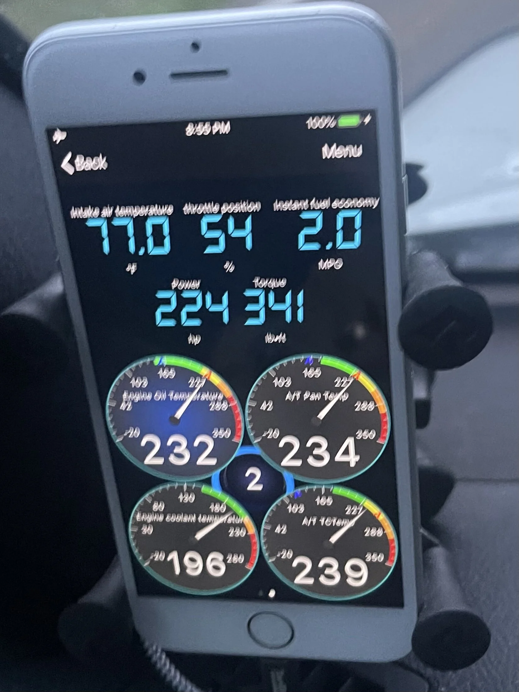

Just posted this in my other thread on my 2017 LX570. I think lots of this has been discussed in this towing thread already, but thought it's worth sharing. I have had several questions from folks on other videos asking for a more detailed in depth video to cover tips on towing with a 200 series Land Cruiser or an LX570. I hope this video is helpful for you all on tips for towing with a 200 series. This is more high level tips when towing with a 200 series, nothing mind blowing though :cool:
