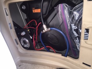

  16. Determine how you will mount the compressor. We mounted it to 2" wide x 10.5" long steel bar, and we drilled and bolted that to the mounting holes for the jack retaining bracket. If I had to do this in the future I might buy and cut a piece of sheet metal and mount the compressor to that ahead of time.
  17. Mount the gauge to the body. We used the shortest self-tapping screws we could find, since the gas filler neck is on the other side of the metal.
  18. Following the air compressor installation instructions, and using the additional union T fitting you purchased, attach all the air lines
  19. Attach the negative (black) wire to a solid ground screw
  20. Run the positive (red) wire to the engine bay. We ran the line underneath the vehicle, though at some point in the future I will probably re-run a bundle of wire from the front to the rear through the door sills. Either way, make sure you put the 15 Amp inline fuse inline just before you tie the compressor into the battery!
  21. Flip the switch and pressure test.
I kept any extra tubing and fittings in a quart size ziplock bag in the storage compartment, just in case.

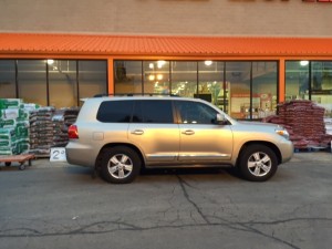

For those interested in before and after photos, the first photo is the LC hooked up to the trailer hitch, and the second photo is after setting the WD and putting 35psi in the helper air bags.
With 5psi in the bags and about 200lbs of gear (and dog) in the trunk, the top of the rear end wheel well sits 21.5" above the center of the axle:
Adding about 600lbs of tongue weight on the trailer, the rear end sinks to about 19.5":
Setting up the weight distribution bars on the 4th link bumped it up to 20":
Increasing the bags to 35psi, the rear sits at just under 21":
