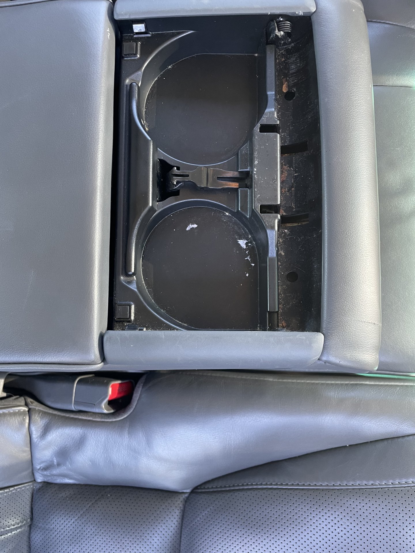

The one thing I'd love to find a part number for is the cupholder on the back of the fold down middle section of the second row seats. It's broken. May have to do some hunting around.

Congrats on the purchase.
I’d be surprised if you can find a single part of it. eBay is probably best bet.
Nice! Thanks for the link. Yeah, I was thinking this might be an eBay special...

In case you are wondering, if it’s available at Partsouq, they are a legit vendor with usually much better pricing than US vendors, as long as shipping costs make sense. 200 series are far more prevalent in Middle East, so parts are generally cheaper.
Looks like you can get that part here, at the ironically named "Discount Parts Monster" site - not much less than eBay for the entire console:

I also ordered a rear seat center console cupholder. McGeorge Toyota carries it as well, and yes it’s cheaper than every Lexus online storefront I could find. For Lexus-specific parts that a McGeorge might not carry, Lexus of West Kendall seemed to be the cheapest by a couple bucks. Previous owner had the LX detailed, but they didn‘t do a very deep dive.
