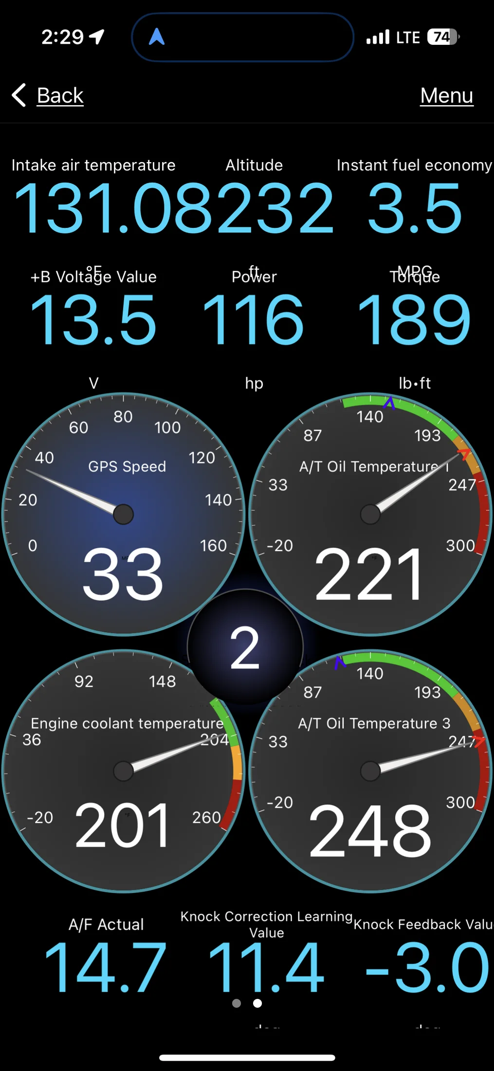

here are some temperatures (ambient air 80F) pulling up over Douglas pass (between Rangely and Montrose):

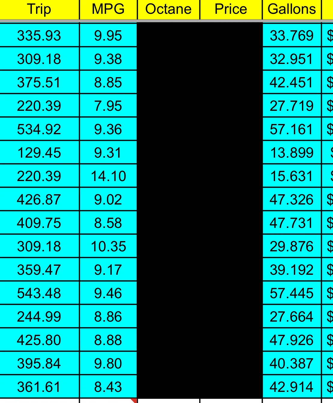

Since MPG and road trips are being discussed I’ll share my recent 5600 mile trip gas usage. I’ve blocked out the octane column to keep the discussion from veering off the rails. This trip earned roughly .5 MPG better than one to Wyoming last year and a similar trip 2 years ago. Less towing off road may be to blame for this, I didn’t track this particular item but we didn’t tow as much in 4LO as we have in the past. Easier roads are likely the cause, we stuck to mostly 1 and 2 rated roads with the trailer based from the trailsoffroad app. The previous 2 trips were more dirt focused with the camper.
Another thing to note is the 14.10 mpg anomaly… we had 2 short interval fill ups in a row. That one was just before a very long decent and all pavement.
I always love your attention to detail on this.

I honestly don’t know why I hoard data like I do, my wife has the same predilection. Dropping MPG’s is often a symptom of something a larger issue so it’s a good way to catch things early, failing PCV comes to mind.
Also, keeping the spreadsheet allows me to factor in tire size, something the onboard computer does not. The “sheets” app makes it very convenient… I have detailed files.
