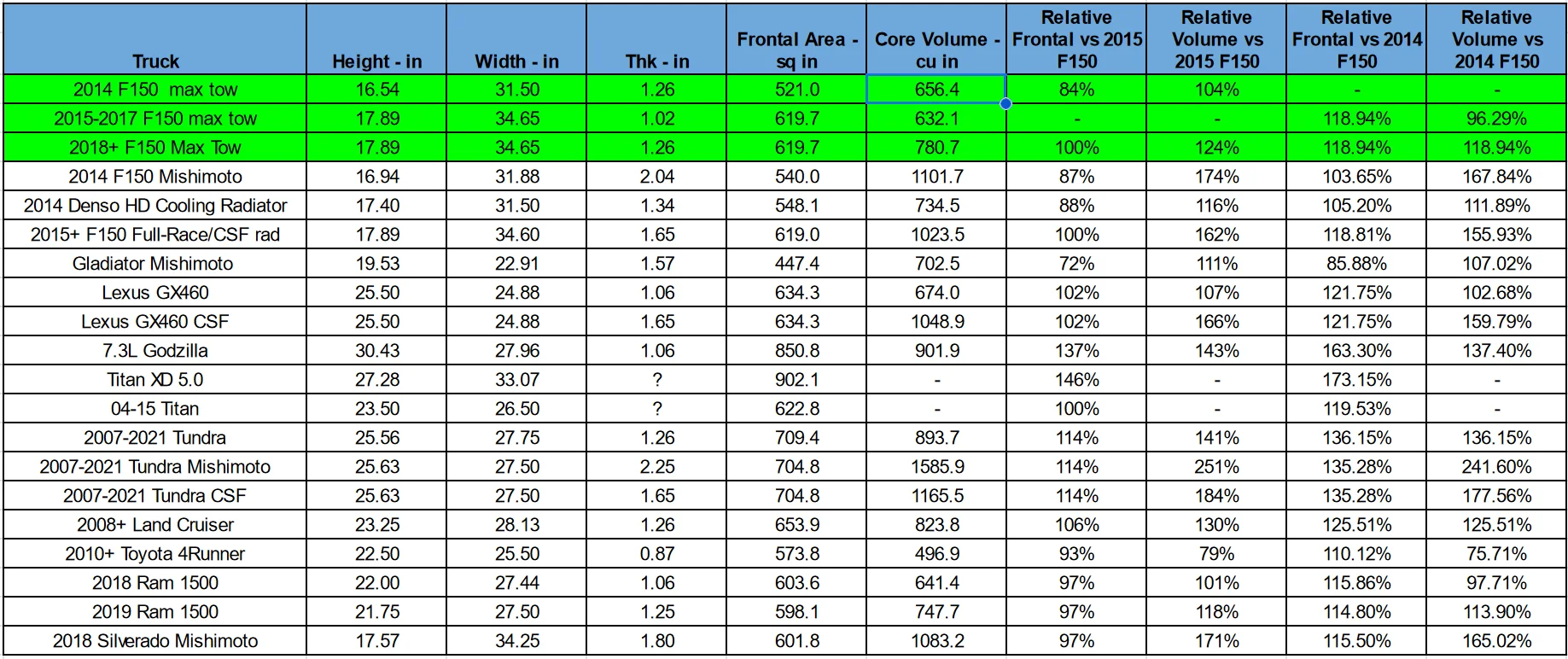

In my quest to figure out why my Ecoboost would overheat so easily, I started recording radiator core sizes from different trucks to compare. I believe the stock tundra is 25.56” x 27.75” x 1.26” HxWxD
I’ve not measured my LX core
Edit, actually, I had the 2008+ LC core size written down as well. 23.25”x28.13”x1.26” so it s a little smaller.
But I find the radiator size thing to be a tough one for me to buy. My F150’s trans temp never went over ~208 with a similar sized cooler to the LC200. My F150’s radiator was only 16.5”x31.5”x1.26” and I would regularly see coolant temps in the 230’s and 240’s and my transmission was always totally fine. In fact, I had a thermocouple just after the outlet of my radiator and my “cold” coolant would sometimes be leaving the radiator at 208-210F, just as hot as the trans fluid was.
At one point, in an effort to offload some heat from the coolant, I bypassed the transmission cooler in the radiator end tank and ran just the air cooler and found almost no difference in transmission temps. It pretty much stayed between 201 and 208F all the time.

Converting to volume, Tundra (894 cu in) vs 200-series (824 cu in) vs F150 (655 cu in)
Compared to the 200-series, the Tundra is 8% larger, and F150 is 27% smaller.
The 200-series coolant temp is imminently stable in low to mid 190* F. Evening caning the throttle for 10+ minutes at a time towing on grade, I've never seen it over 203*F. I always wonder how front bumpers and under armor might affect flow and max cooling capacity.
This is my full dataset:

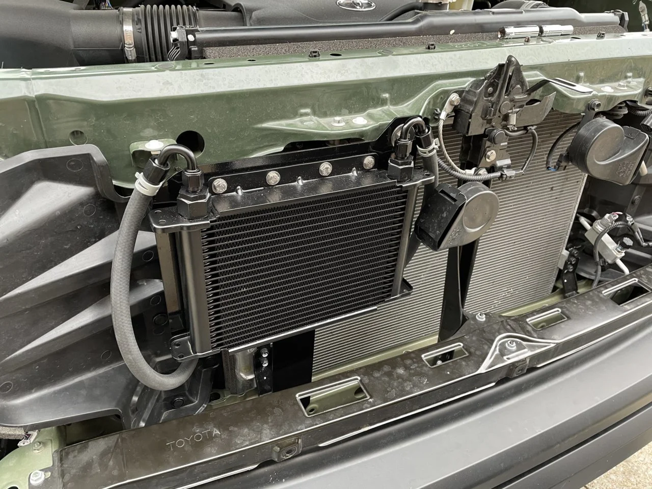

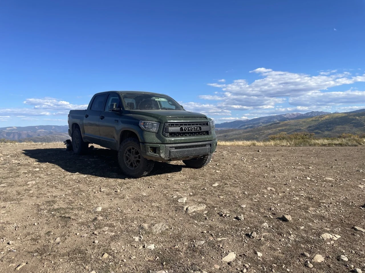

I’ve had a few different grilles and monitor temps all the time. Current grille is the old style TRD Pro with one giant bar across it. I was worried it might impede airflow, but I’ve noticed no change. Previous grille was the honeycomb.
Here’s my Hayden cooler.
