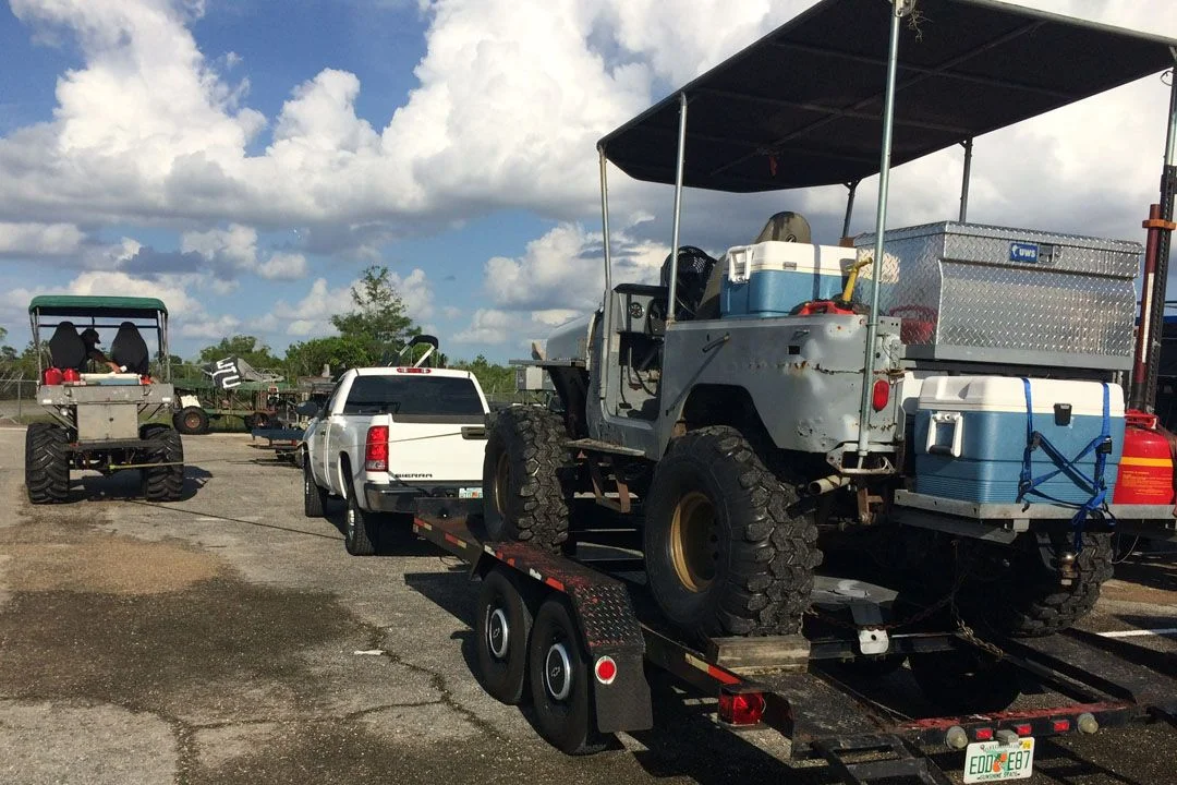

I got towed out of the swamp once when my Pertronix died. When we got out, the tow vehicle just drove by, along side my truck and trailer and I steered my dead rig right up onto the trailer. I was surprised at how easy it was. We used a 30' tow strap.
Gotta look close to see the strap.
